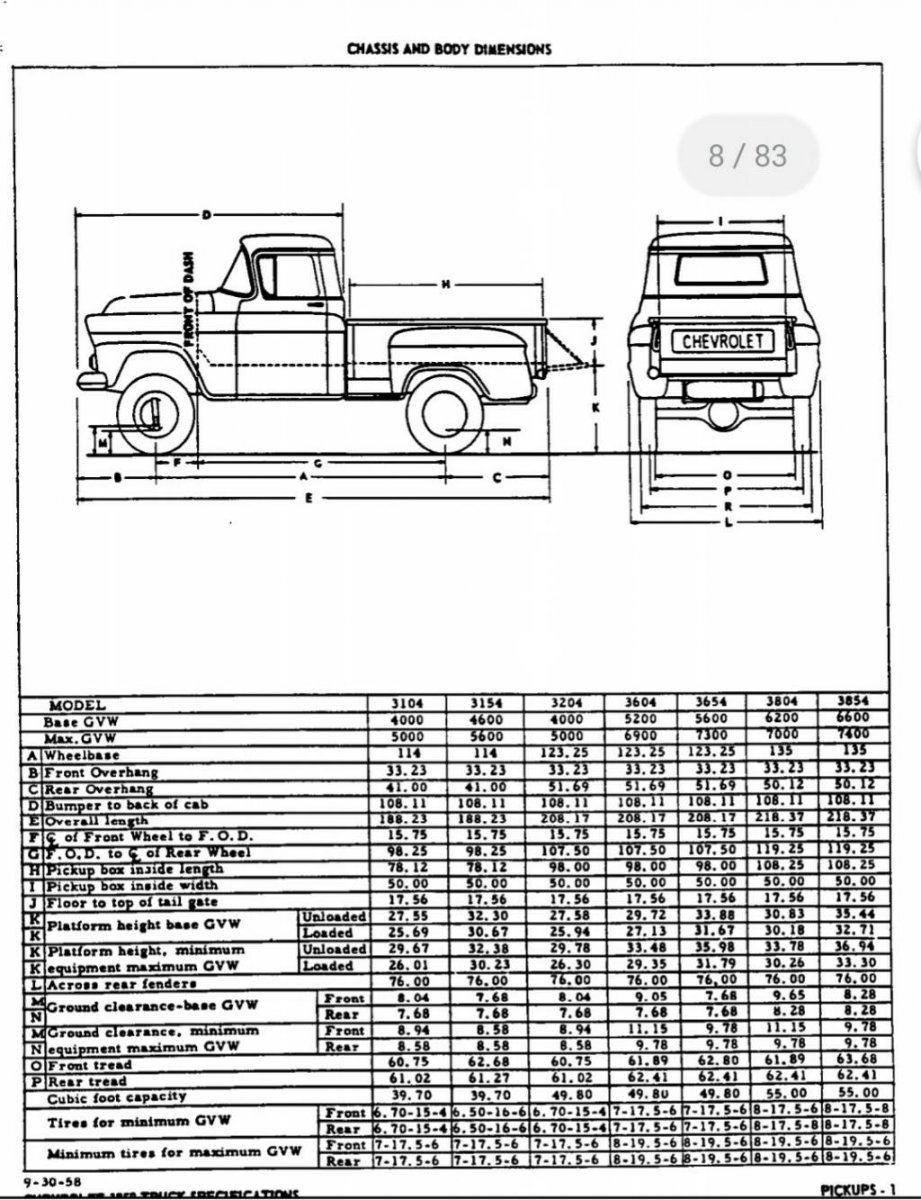

    Been looking around but cant seem to find a definitive answer.. Does anyone know a metric tire size for a 1959 chevy 3600? It seems that the size is a 8-19.5-6 but what in the hell is that in conversion?! Screenshot_20200914-143344_Drive~2.jpeg

    8-19.5 is the tire size. The -6 at the end is the ply rating.
    I think these old tires are pretty hard to find today...do you have a picture of your wheels?
  3. According to the chart, that would be a 8.00-19.5 in a six ply as Jim said. They're actually not uncommon, if you do a Google search for '800-19.5 tire' you'll get lots of results. There's some listed at that size, some listed in various metric sizes depending on aspect ratio. Prices from about $160 up.
