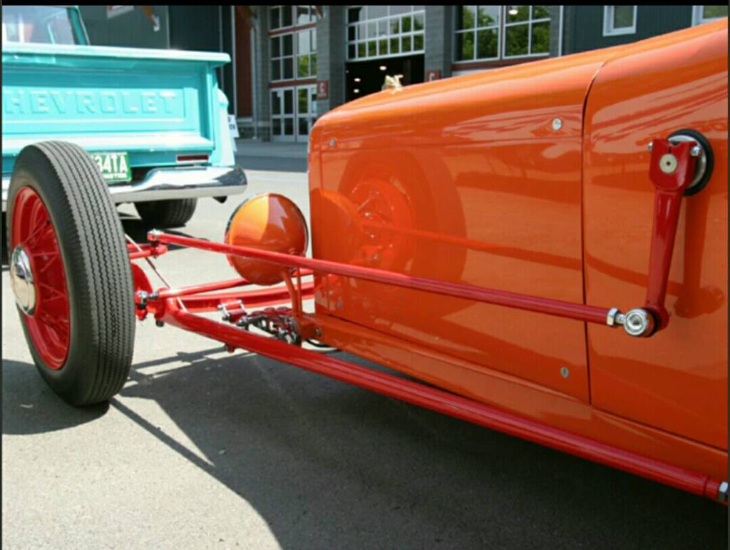

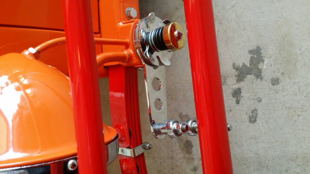

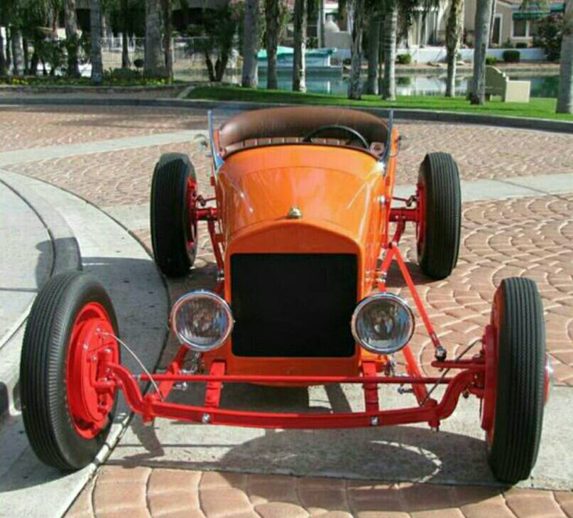

    & I must be blind - how about shock absorbers front & rear?
    loudbang, modified, TTR and 1 other person like this.
  16. modified
    Joined: Sep 21, 2006
    Posts: 326
    modified

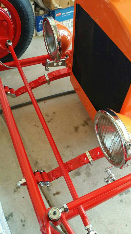

    Works just fine, no side to side movement that is detectable, I was concerned about that also but this is my 3rd Modified sprung like this.

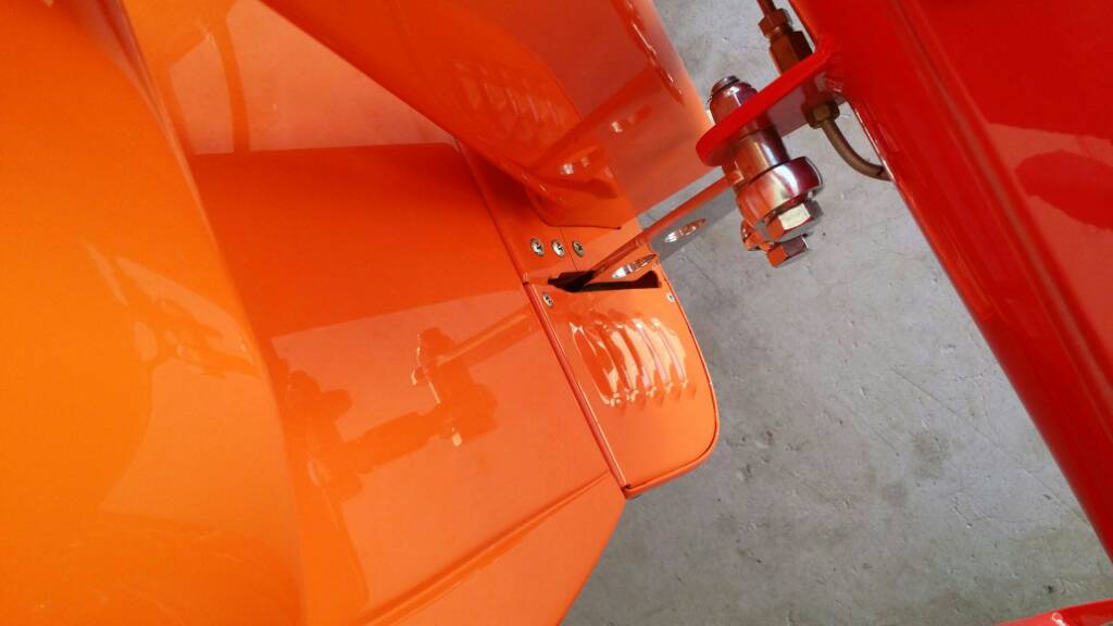

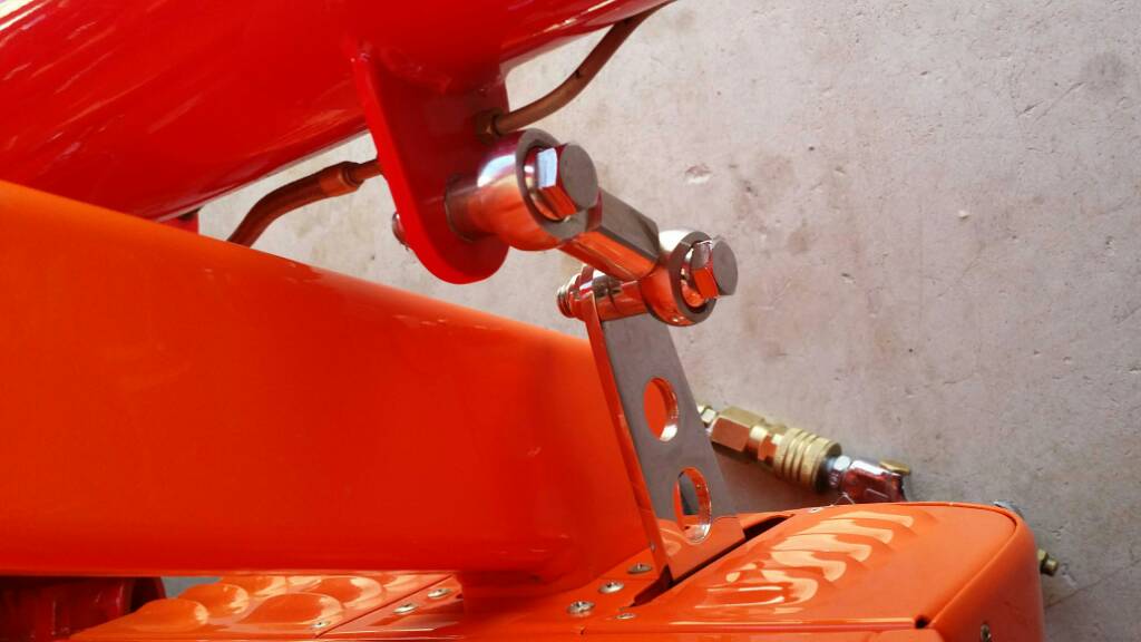

    I think there's a lever type shock being run...you can see it on the front suspension pic with the drilled holes.

    Lever shocks front and rear. 1535412614304.jpeg 1535412570728.jpeg 1535412629143.jpeg
