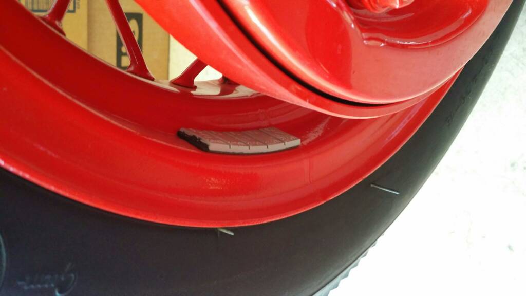

  7. Mr48chev
    Joined: Dec 28, 2007
    Posts: 36,519
    Mr48chev
    I took photos of that car at The Vintiques of Yakima show several years ago and to be truthful you have probably put more miles on it since you have owned it than were put on it before. Great car but it got treated as more of a show car than one that got out on the long roads and actually got driven.
    Have you had the wheel balance checked since you have had it/ Looking at the photos I don't see a wheel weight one and that may be all that is wrong. If your guy has an on the car spin balancer have him spin the tires up on the car and see what happens. If you jack a front tire off the shop floor does it stay in a static spot or does it want to rotate on it's own?
    I agree that there are probably some serious flat spots from just sitting all the time though. As many photos of the car as I have seen all over the place you would think it had some miles on it but it no doubt sat in the garage was cinched down in the trailer and then got to put put around the fair grounds for a weekend and repeat.

  8. Mr48chev
    Posts: 36,519
    Mr48chev
    In the photos you posted or the ones I took in 2010 I don't see a wheel weight on any wheel. That means the wheels were never balanced from the get go in favor of not having weights show on the wheels. Looks over ride. 010.jpg 011.jpg 013.jpg 014.jpg 015.jpg 016.jpg 017.jpg

  12. modified
    Joined: Sep 21, 2006
    Posts: 326
    modified
    The car was built (according to the tire date) 10 years ago for Roy Rockwell who couldn't drive it because of his hip replacements.
    I bought the car just over a year ago with less than 400 miles on it.
    I've been sorting it out since I bought it and it had never been done.
    Everything is new and tight including the Schroeder Steering box. I added valve springs to the friction shocks to make them work.
    I re-set the toe-in to 1/8".
    I am convinced it's a tire problem.
    The wheels are balanced with the stick on weighs on the back of the wheels. The wheels spin as true as you would expect for 1935.
    The tires look like new but as you say, I'm sure they are flat spotted!
    For what the car is, it rides and handles very well!
    Now if I can get rid of the hop with shaving and re-balancing.
    I have not been able to find anyone capable of spin balancing on the car, I wish I could! If anyone knows of anyone in the Phoenix area? 1535467800273.jpeg 1535467898027.jpeg 1535467836433.jpeg
