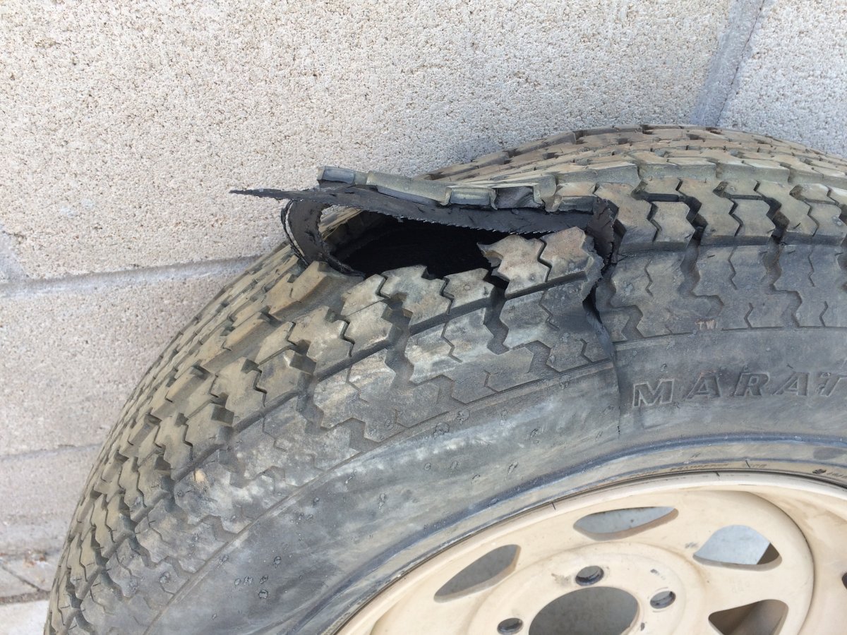

    Back in the day (50s, early 60s) dad always bought recap tires. I used to love watching the tire shop mount the tires and run them thru the shaving machine to true-up the tread. I was kind of scared they would shave off too much and the tire would explode but still fun to watch. That process is relegated to truing up recaps I suspect. Tire tech on new tires is way advanced from those early days.
    One caution with running vintage tires. I used to think tire shops refusing to work on tires over 5 yrs old was just to peddle new tires. After this happened to a new/old tire from the trailer I bought to transport my Mysterion, I have a new respect for the time limit on tire life. This one had never been on the road, always inside the trailer as a spare. I had it sitting in the Bakersfield summer sun while I was refinishing the trailer interior when I found it like this one morning.

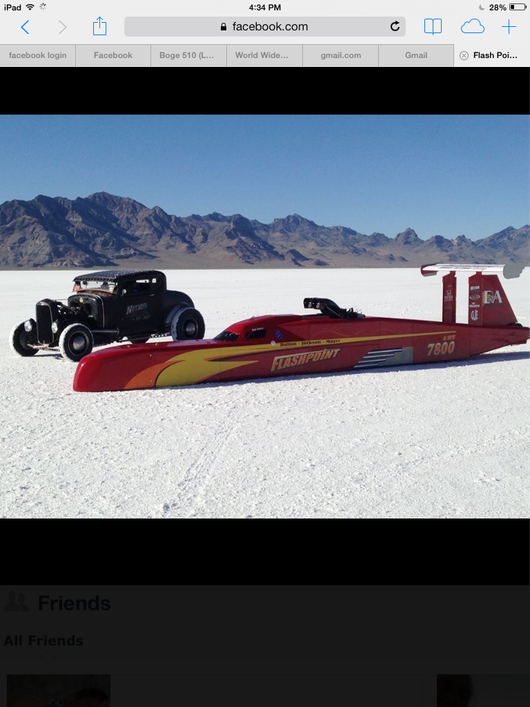

    First of Congrats on darn near being a Jet with no wings...You fellas provided lots of entertainment for us this year...
