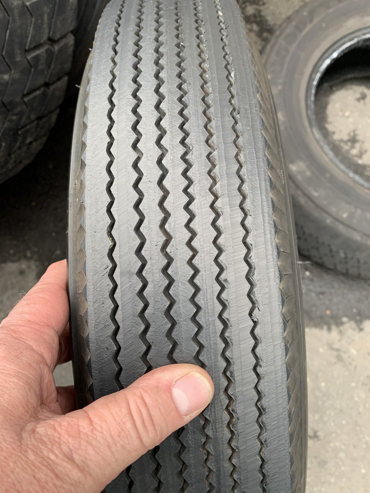

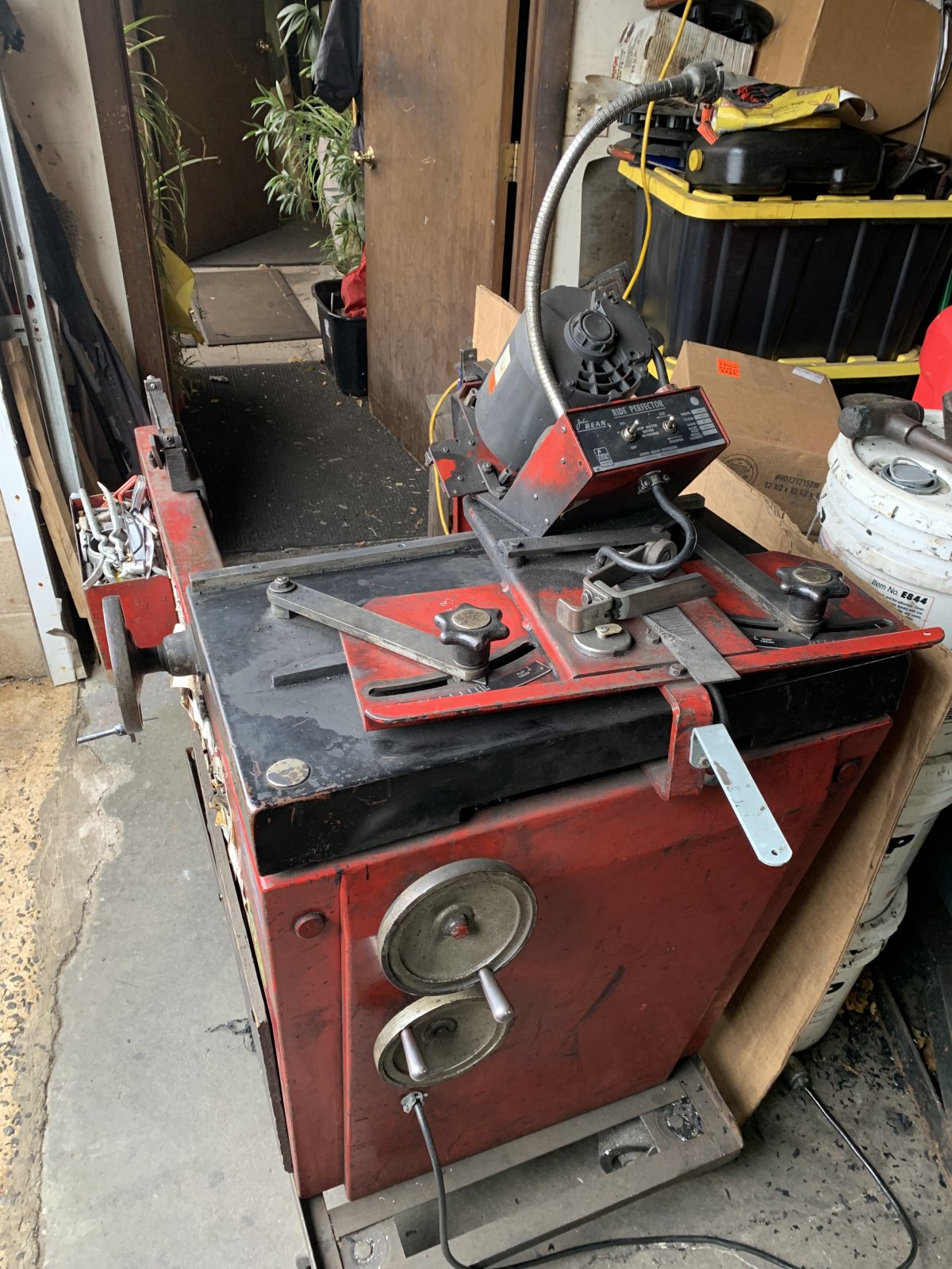

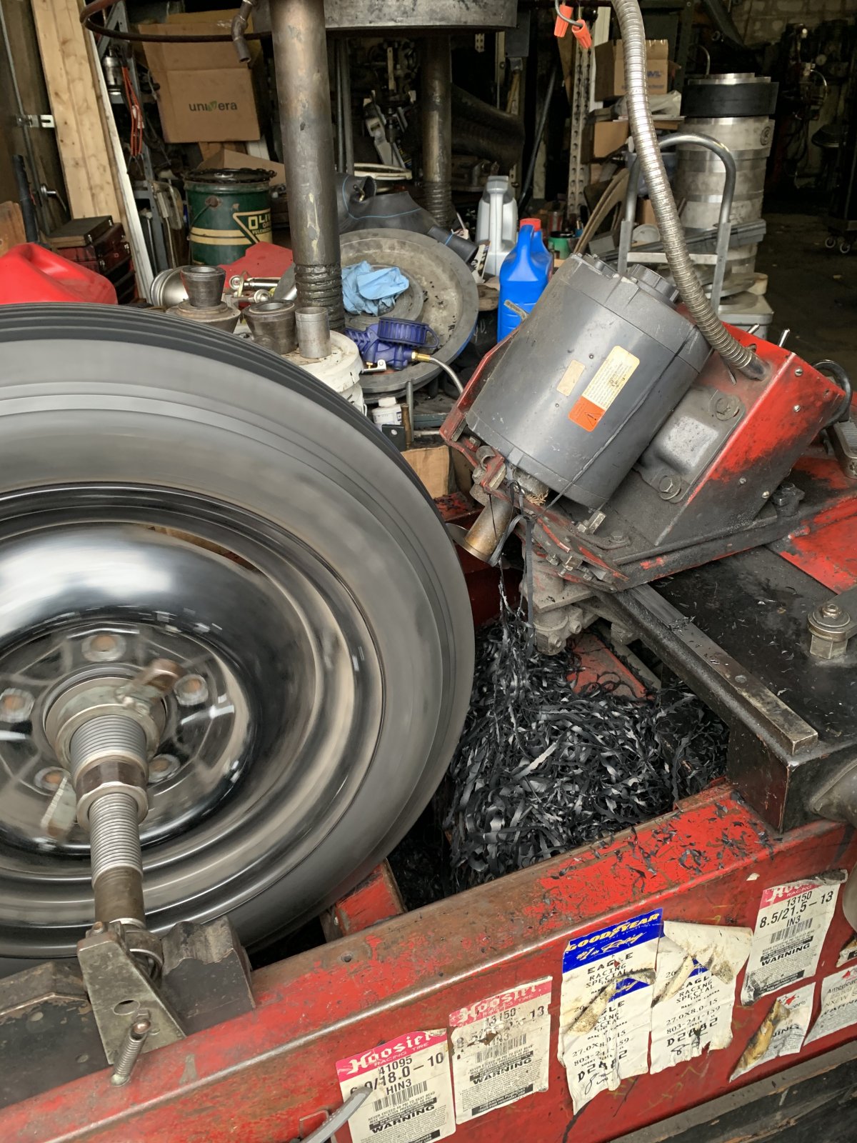

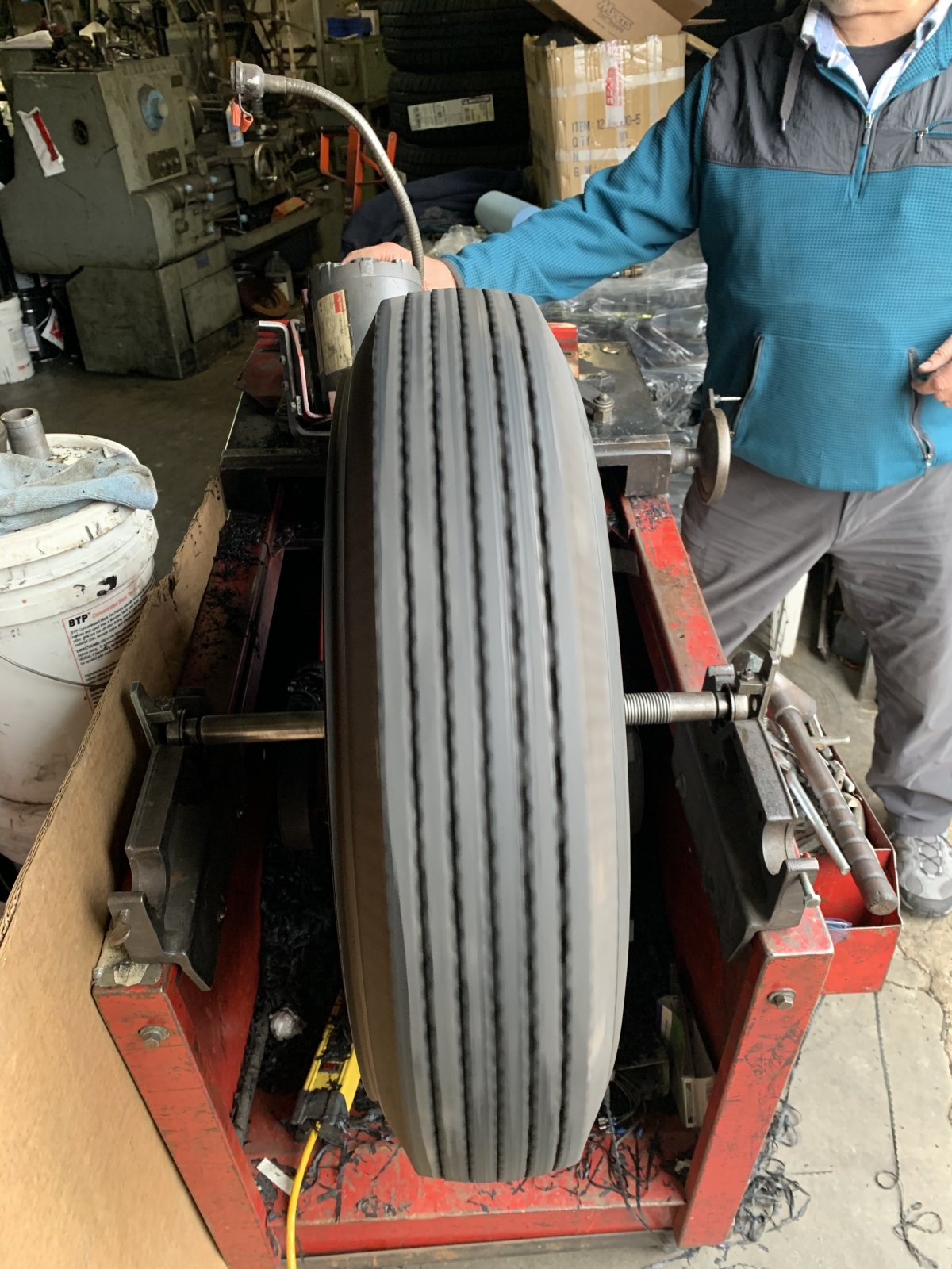

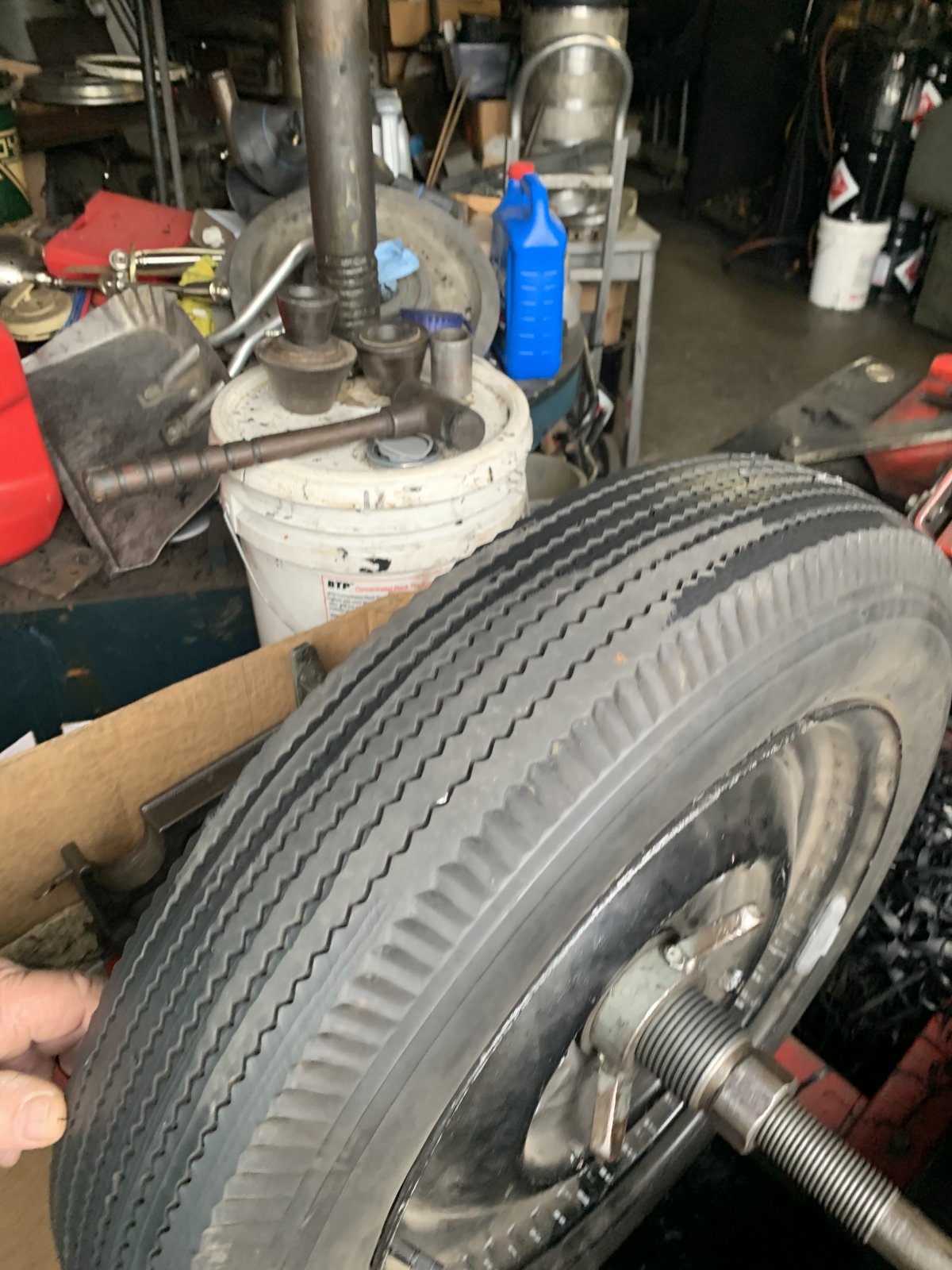

    Hi all,
    While putting up with the run out on my Coker repop bias ply tires I searched all over for a place that still does tire truing and found a place to do them.
    David at Major Tire, 80 Century drive, Stratford, CT. Hooked me up today, $40.00 a tire. He runs a tire shop that still does truing, makes racing go kart tires, ice racing tires and even still does retread tires with a contract for the postal service doing tires for the local delivery vans.
    I haven’t got the tires back on the car yet, this week but you could see how out of round they were and I’m looking forward to driving the car.
    Cliff Ramsdell
    AA6B7C76-A1FB-4FBC-963D-DB79A1BA381F.jpeg 7A6BAE24-4464-4A22-8432-A24A2288FF61.jpeg FF52485D-73FC-4410-9E2C-9865E5351A92.jpeg DE887C70-153C-4459-9E26-CA29391F3B8E.jpeg FBB8B3D6-7B26-4847-8F73-722B9FC0ACDB.jpeg E40D2159-6170-474A-A1E7-1B05054A87BB.jpeg 87720A43-5F24-4FA9-94CB-403E783593C3.jpeg FA1A0C5A-8511-4992-8D7C-851948E5F64F.jpeg

    I had a vibration that came in at around 45 mph and carried thru to almost 60. You could see the front tires “bouncing “ on the road.
    Tires were visually out of round, I measured them and found .085” and .090” out of round on both fronts. Rears were better at .045” for both.
    The guy doing the tires said it was a mold issue since the amount was the same. He explained that a tire that’s not true runs hotter because it doesn’t run smoothly down the road and the bouncing on the road builds tire heat.
    I’m going to check the run out once I reinstall them prior to driving and clock them on the hubs to get the best run out numbers.

    Ok, tire update. Before truing the tires both front tires were in the .080" to .090" out of round the the rears were about .050". I mounted everything up on the car yesterday and before driving checked the run out. both rears were .010" to .012", great. The LF was .025" and the RF was .012". I clocked the left front about 120 degrees and got .012" to .014". Road test ready. I adjusted the tire pressures and hit the road. Within a quarter mile I could tell the difference and after a nice roar test of about 10 miles it was clear that this was a 98% improvement over how the car drove before.
    I'm going to look at other factors on what else to improve like total caster and my toe in/out adjustment along with steering box adjustment for better road feel.
    As for the tires and such, before at 45 mph or so the car a very noticeable shake/shimmy/bounce and the radiator would dance around, this is all gone and the car just cruised right through this point all the way to 60 mph before I noticed that I was traveling that quickly. I haven't taken it down the highway yet, maybe this week as other home projects and a decent shop cleaning needed to be done this holiday weekend along with a bedroom overhaul for our two little granddaughters for their visits with us.
    So, was it worth removing some "life" to get a better ride, yes, 100%. would I do it again, Yes again. As stated its sad after paying good money for vintage tires you need to spend more but truing and match mounting tires is nothing new to the current makes of tires but is something that still my need to be done.
