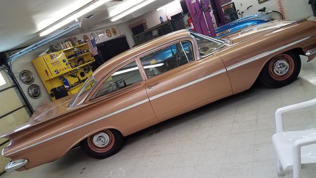

  1. I like the way this Nomad looks and am looking to do same on my 59 Bel Air. So, big/little? On tires? Or both rim and tire? Or all same frnt/rear? Also, rim tire sizes?? Radials. THX

    Love your car!

    That's one fine 59!! Going to be hard to improve on that look.

  6. I'm not trying to improve the look as much as have a couple different combos (including what's on there) to switch back and forth periodically.

    Fine looking car, I like a wider wheel in the rear, reversed for the deep look and taller wider tire than the front.
