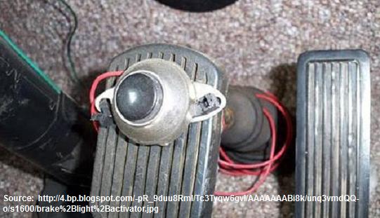

    Here's the perfect answer to the brake light switch problem:

  22. That would be a good case to use a relay.
  23. Moon50F3
    Joined: Sep 18, 2014
    Posts: 216
    Moon50F3
    That’s funny, right there

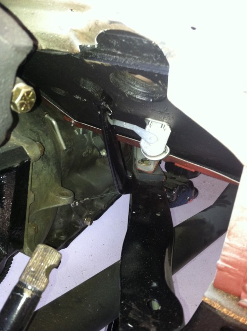

  26. BamaMav
    Joined: Jun 19, 2011
    Posts: 6,969
    BamaMav
    from Berry, AL
    I started out with a Speedway pressure switch mounted to a port on the master cylinder. You had to be at half pedal before it would turn on the brake lights. I changed to the mechanical style bobd1976 posted the pic of, once adjusted, no more problems. Barely mash the pedal, you have brake lights.
  27. The last one that just rolled out of here,,, I told him he needs a mechanical switch. He cheaped out at the very end and didn’t want to pay for that.
    I told him the pressure switch will fail, so at least I made it super easy “FOR YOU TO CHANGE” and don’t expect me to change it or warranty it or even look at.
