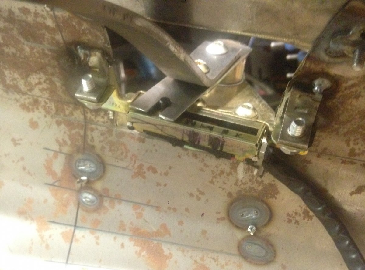

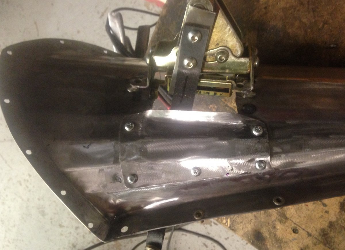

  9. Here's my NSS fix.
    It took me a while to figure out the best way, the best switch, the gear throw, and a super clean set up. Next one should take 30 mins & I bet it works on every Lokar shifter. No********* brackets, wild wires and an all in one switch.

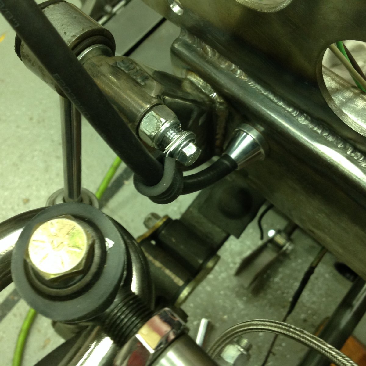

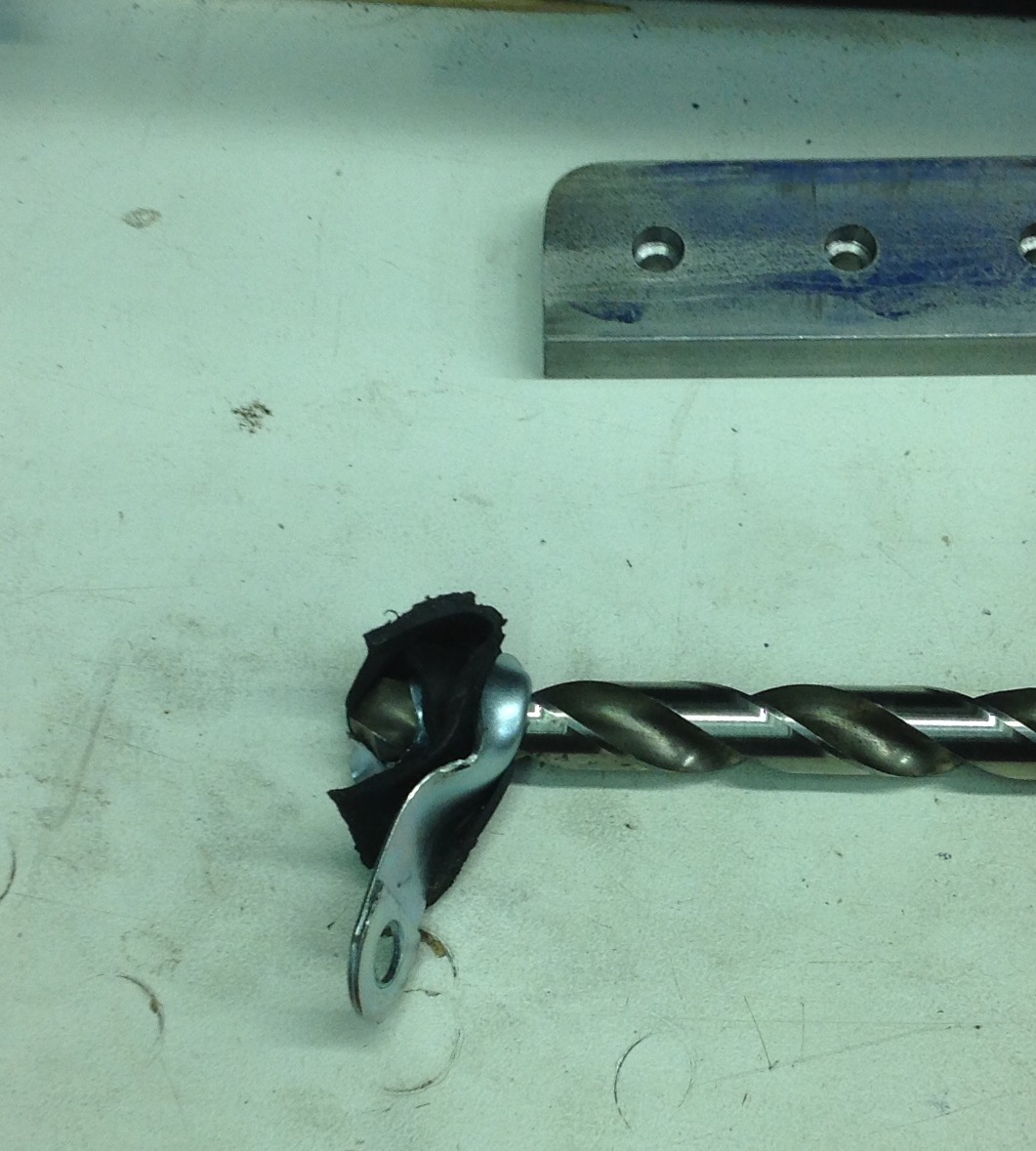

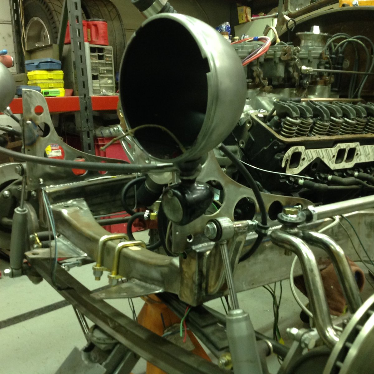

  25. You'd think I'd learn .
    Drilling P clamps is scary. This one turned the drill press vice into a helicopter wannabe.
    they ought to make them with a bigger hole.
    So, I took the shock bolts out. Chucked them up in a lathe and drilled them, tapped them to take a 1/4-20 bolt. Put the stuff back together.
    I'm getting to the end of this one, it's in its last days and every single thing little thing is a fight. That's one hell of a fight for a p clamp to keep the headlight wires away from the steering arm.
    Ok now making special bolts to get the bullet turn signals to work as the "nut" , well that was kinda fun and rewarding. Also less of a fight than the P clamps.

    Normally for me, drilling these clamps is an exercise in testing the durability of my fingers. They never do so well.
    geez brilliant. One of those "why didn't I think of that?" moments. Thanks for the tip!

    You got it...One of the uni-bits makes hole enlargement easier cause of existing size piloting...The hinge use is a very good idea..

    A tapered reamer is better than a drill when enlarging holes in P clamps.
