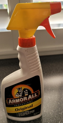

  29. jnaki
    Joined: Jan 1, 2015
    Posts: 11,408
    jnaki
    Hello,
    In the early days, we used the small blue/yellow can of RuGLYDE for just about anything. It was available at all auto parts stores, and neighborhood gas stations. It worked on everything. Clean and protected.
    But then, Armor All showed up and took over the process we were doing monthly on our hot rods. Armor All was like the word “Skippy Peanut ****er” or “Band-Aid” popularity. The brand's rubber protectant formula being invented in the early 1960s and it became popularized by the early ‘70s.
    upload_2022-6-21_4-16-1.png 22 year old spray bottle
    Its accessibility in any store of any kind played right into the everyday automotive uses. It was a one stop shopping experience. But, did it work? On leather upholstery, if one could get over the instant clean and shiny surface, along with the dry squeeky feel, then yes, it worked. The term almost had a life of its own... A noun became a verb... "Did you Armour All the tires?"
    On tires, it did the same thing, cleaned the surface and made it somewhat shiny. If the finish shine was too much, then a clean rag wiped off the glow. It protected and cleaned up anything on the rubber tires. Road grime, brake dust, and the weekly “browning” of the untreated tires.
    We used it on all of our cars, hot rods, El Camino tires, and radials when we put them on instead of bias ply. Now, the cars handled much better and still had the hot rod look with the blackwalls and painted rims.
    When we had the power spray machines nearby, they cleaned everything off and the new spray coating did its job. It protected and kept the blackwalls nice and black. But, nearing a month, the daily grind did its number on the tire surfaces and coating of what ever began to show up, again, brake dust, grime and brown coating that made blackwalls looking old.
    Jnaki
    So, by this time the monthly detailing began again. Everything we tried lasted about a month.
    upload_2022-6-21_4-19-22.png During our 20 year sailing adventures, we used different products from the local marine supply store. But eventually, ended up using the blue Meguiars Solution and the 303 Protectant. Since we have now retired from sailing, they got used on our daily drivers as tire cleaners and protectants. They worked just as good as Armor-All, but when they were empty, we reverted back to our tried and true, Armor-All spray/wipe solution.
    For some reason, the newer brand of tires now have lasted longer than a month of driving. Relatively, no cleaning is necessary and if I happen to rub on one tire with a leg, it does not get a film of anything on my skin. So, something in the newer tire compound is helping to keep the blackwalls black. We haven’t used the Armor All for awhile as our blackwalls are staying cleaner and show up as black.
