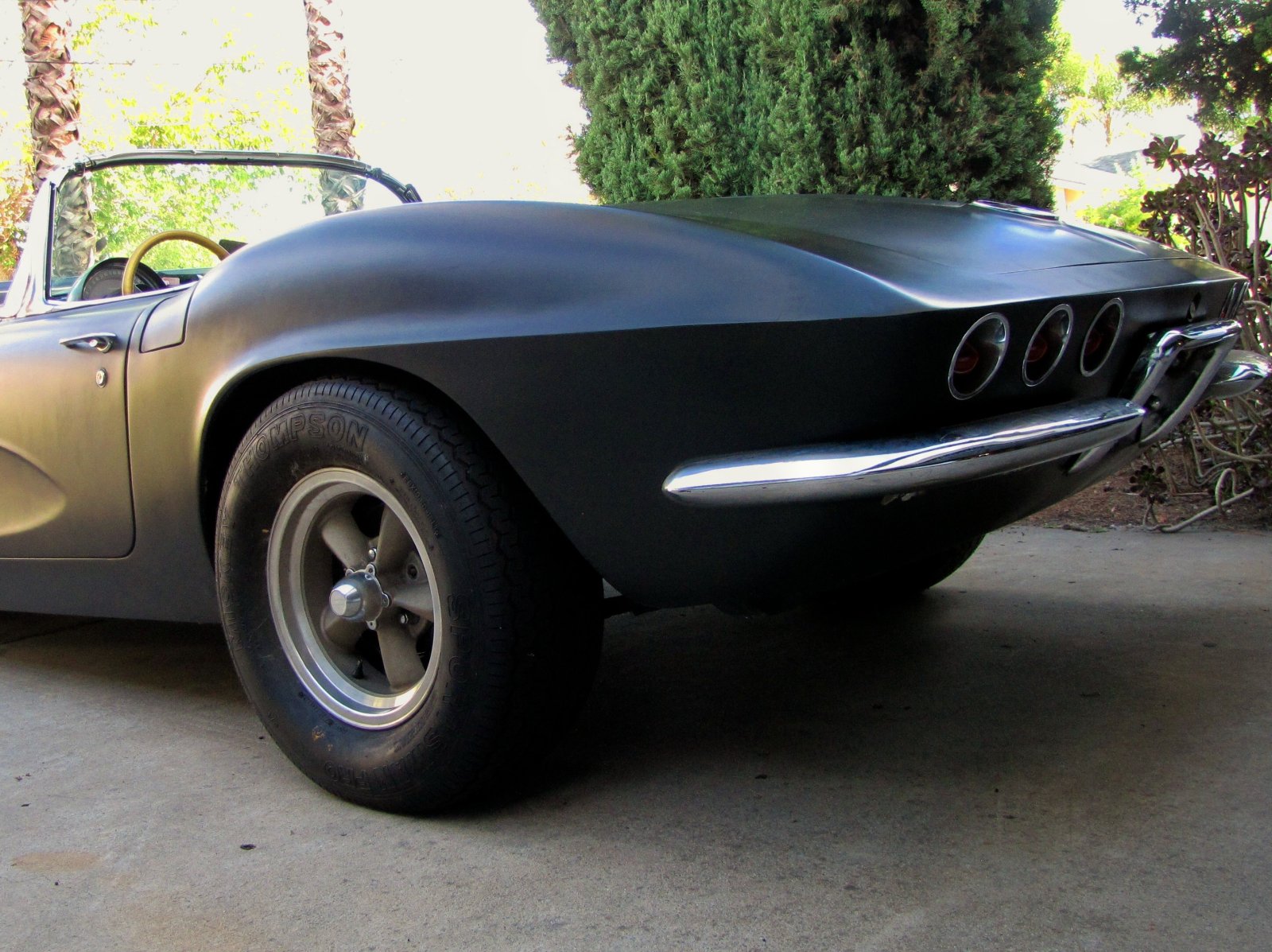

    10.5 X 15 M/T on low side of recommended wheel width...yes, I know a lug nut is missing. MT  (2).jpg

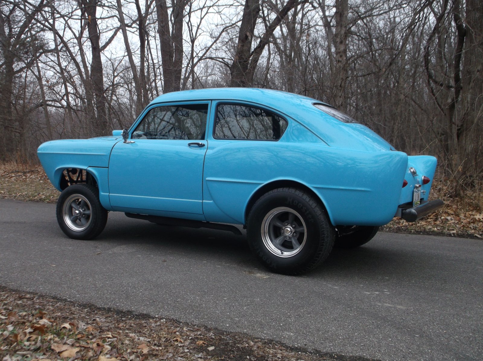

    I have n 50 15s on my 10 inch cragars on my Henry J. In the case of a car like this, it would likely have had slicks
