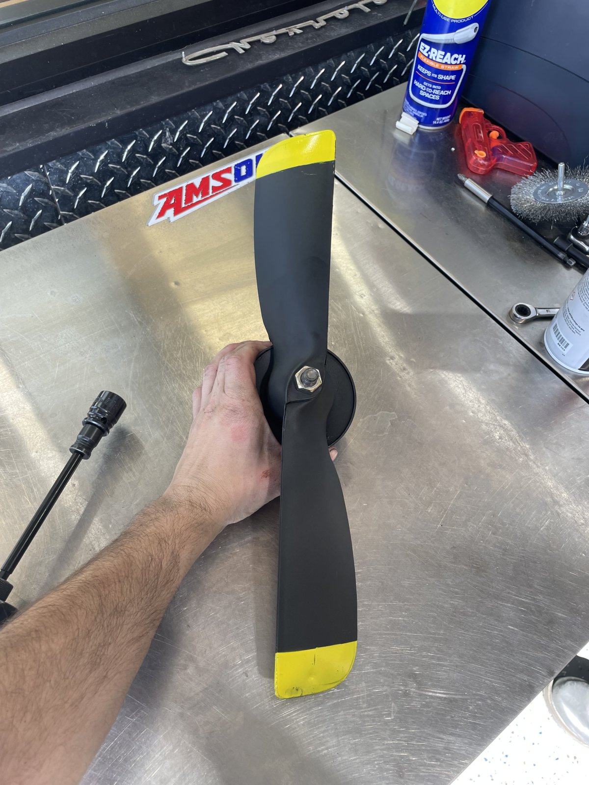

    After being told a hundred times that the four-blade fan on my car is a ticking time bomb and I should replace it ASAP, I finally found a two-blade fan! Which is, apparently, also a ticking time bomb to be replaced ASAP... :rolleyes: I'm gonna run the two-blade because it looks cooler and if it blows up, it blows up.

    Is that an original 2 blade fan? If it is, don't run it! They get fatigued and blow up! What's wrong with 4 blade? I run nothing but 4 blades on my Model A's and have for MANY years. Never a problem. Do check for cracks tho.

    I’ve heard the same about the 1933/34 service replacement bolt-together 4 blade fan, which is what’s on mine! I’m planning to get a cast alum fan but currently they are all backordered (or were a few weeks ago when I looked, and when I ordered this one a few days ago). Mainly, I am hoping it fits with my radiator setup just a little better. The four blade fan is scary close to the top tank on the T-bucket rad and I am worried it could flex and nick the tank.

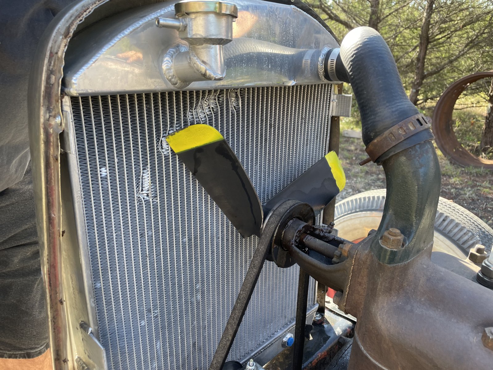

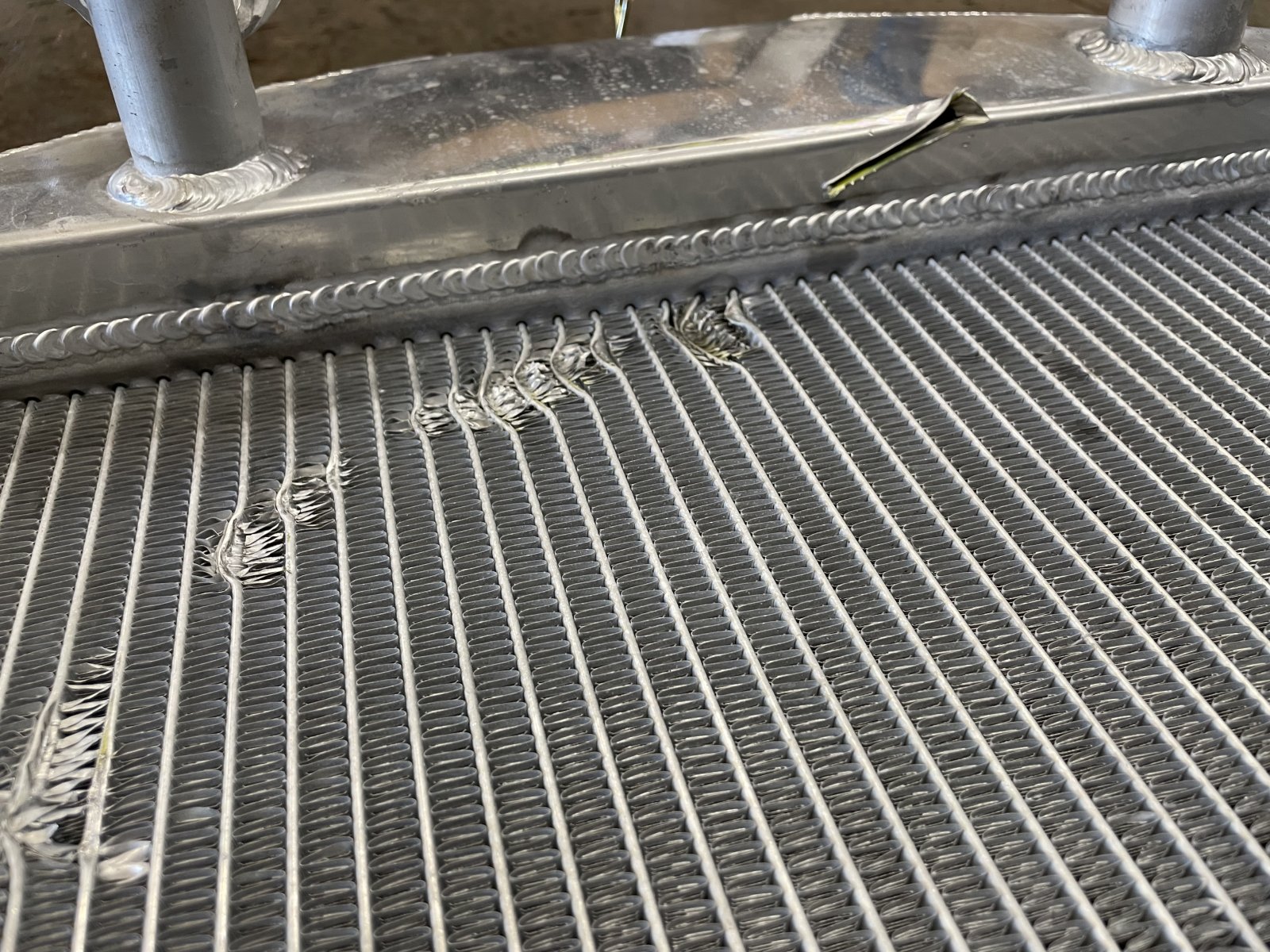

    Dave, I’m sorry to say I should have listened!! It lasted all of 30 seconds.
    My four blade fan is also catastrophically worn… so I thought maybe I’d run this one until the cast ones became available again and sneak by. It was not to be!

    In the before photo it looks like it's cracked running down the blade? This is really making me think I need to address my 2 blade fan....

    There were no observable cracks before I painted it - actually where it failed is a spot weld at the root. I have read rust builds up between the layers but this one is clean inside, the mother****er just broke. What can ya do?
    This is probably a new record for the machine gods serving me crow. I can't even be mad. I should have listened but I was ****y :D

    I haven't really touched the car since the rad popped. Not for lack of desire... The couple times I've been over there since my last post in this thread, we were more focused on getting his car ****oned up and running, since it has been neglected while we worked on my T.
    I ordered a new radiator and it is just sitting in my garage. Robin got sick after our roadtrip to pick up a front end for his car, so I didn't go over the week before Christmas. Obviously Christmas weekend I didn't go, and now I just got sick and can't go over tomorrow. Just terrible timing lol. I'll get back on track with it soon enough.
