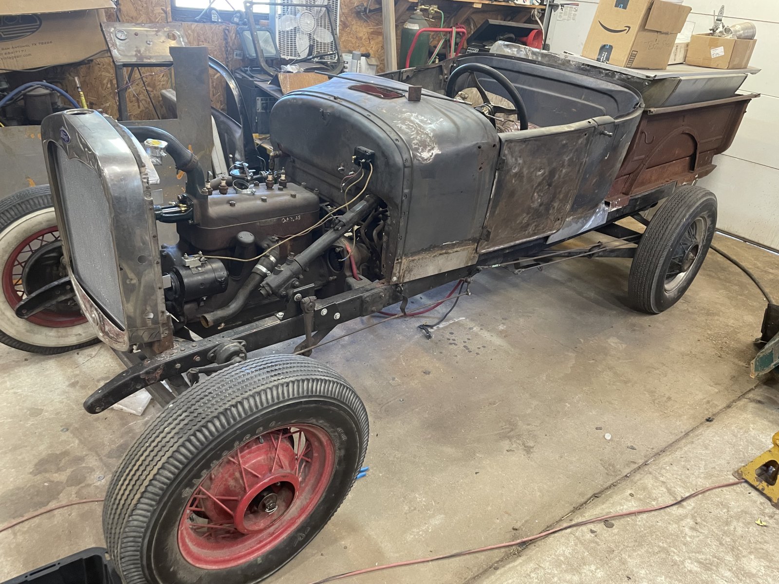

    Dusting this one off for a small progress report... finally done moving and life is slowing down again so I'm hopefully back on track working on old cars.
    I picked up a dinky farm trailer made out of a Model A truck bed a while back, I don't even remember when now- but it was cheap as hell and the bed was in reasonably good shape for $150 despite some booger welds and minor rust.
    Since I've long been tired of chasing my tail on this otherwise running/driving car with the turtle deck, this puts me close to the finish line.
    Well, once I bolt on the radiator... fix the doors... and paint it all one color.
    This is a Model A bed and still has the Model A aprons attached. In the A application, the aprons sit directly on wood pads on the frame. Ts do not have this apron because the bed has to sit on the body subframe, so with the A aprons it sits kinda high.
    I trimmed the aprons to let it sit down over the T subframe. This lowered the bed a couple inches... I think it's just about right and looks much less naked than it would without the aprons altogether.

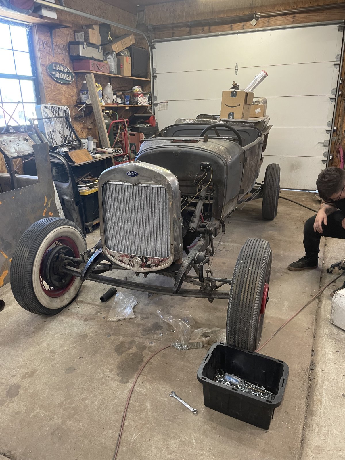

    We had an opportunity to get a little work done on the T today. We remade the radiator brackets to move it down and forward slightly, hopefully away from the fan, and I replaced the water pump with a new leakless unit to eliminate the thrust issue that was allowing the fan to walk forward and back.
    I need a fan and a starter and I think she'll be drivable again.

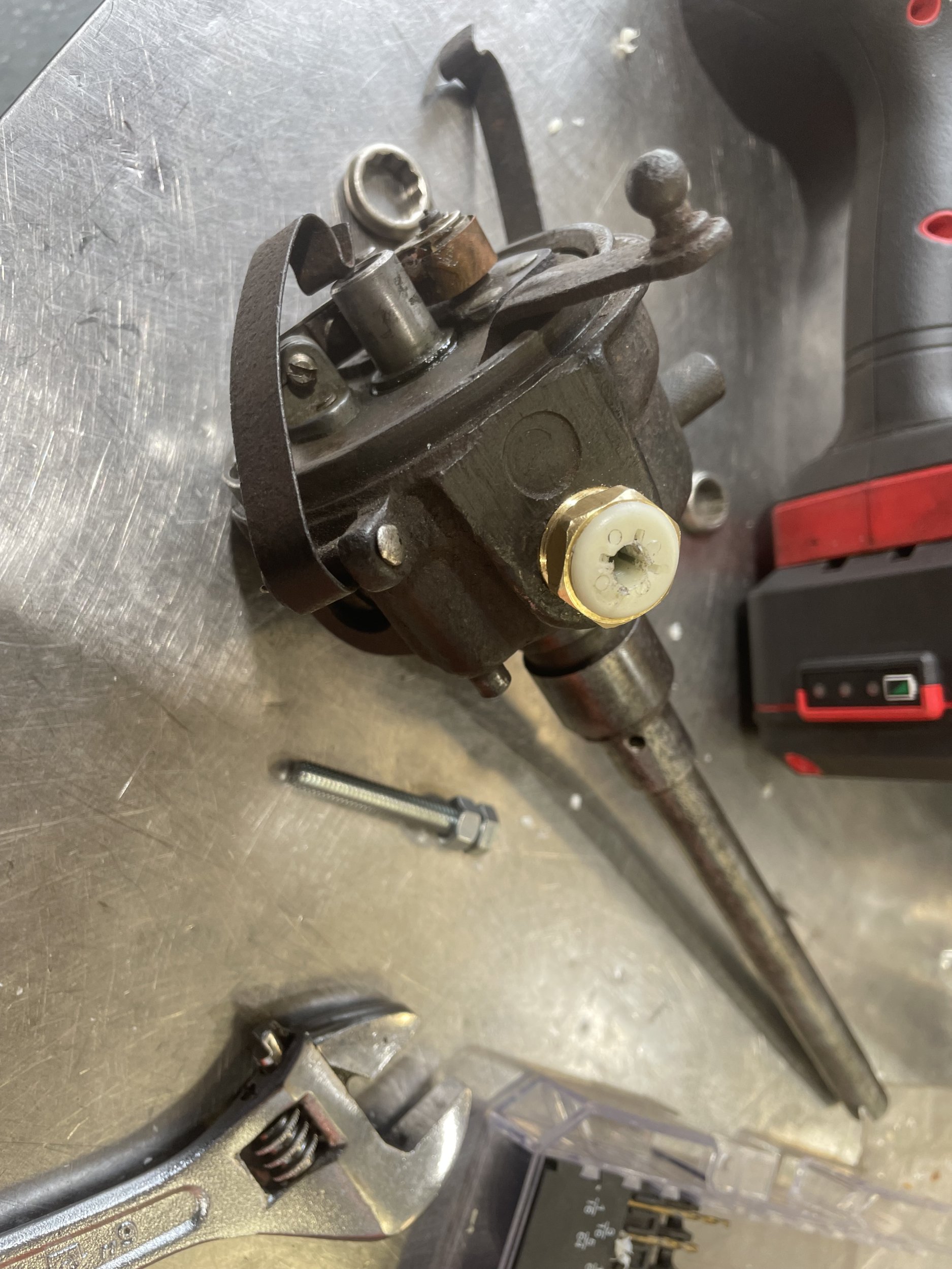

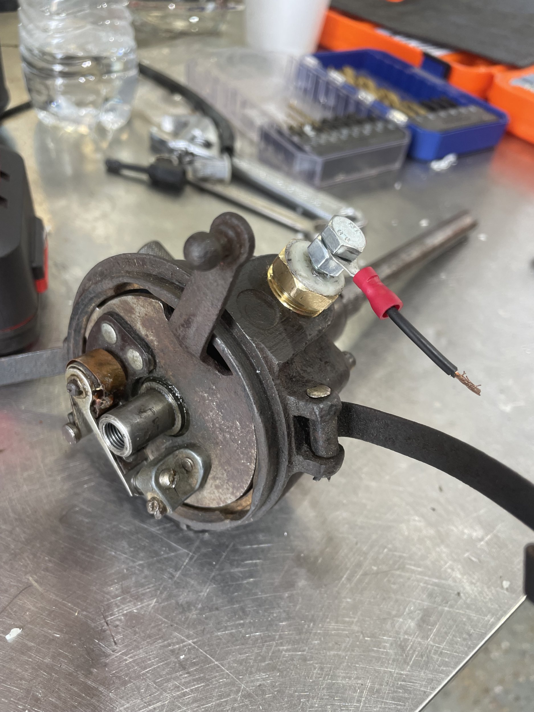

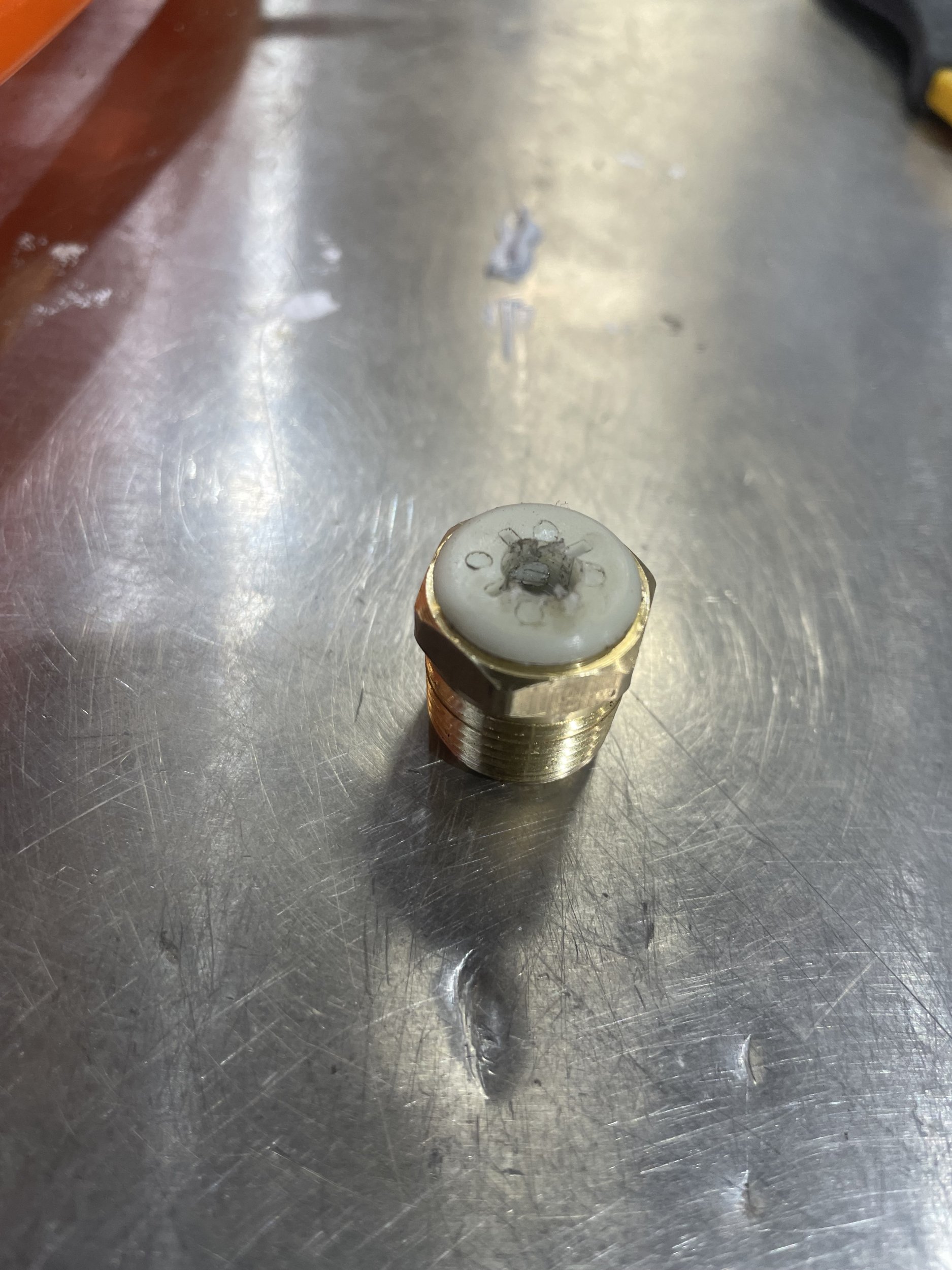

    Spent a little time trying to get it running. Re-wired it and picked up some parts. It should run... but it doesn't want to. I recall having trouble with the 1932 distributor previously and indeed it has some internal short.
    I also know now that the B timing curve is way wrong for an A and will just never run right, besides being difficult to time correctly in the first place. So, back to an A dist for now.
    I found the rebuilt A distributor that I initially removed from the car, but I had taken the special ignition wire out of it for my AA, which I need to keep running for the moment, and I didn't want to wait for another to ship, so I improvised...
    I epoxied a plastic trim retainer into a 3/8" br*** pipe bushing and tapped it for a long skinny bolt that I can put a ring terminal on. The plastic trim piece keeps the hot bolt which energizes the points isolated from the distributor body. This should get me going today... this is kinda ugly but once I heat shrink it it will look fine.

    And 5 years ago you didn't know anything except you liked old **** and you wanted a hot rod. Look at you go! Great improvisation on the distributor, man!

    A really elegant solution would be to just 3D print a nylon 3/8 to 1/4 adapter but I don't have that ability.
    Here it is all together. Can't wait to get home and slap it on the car!
    OFT, Okie Pete, brEad and 2 others like this.

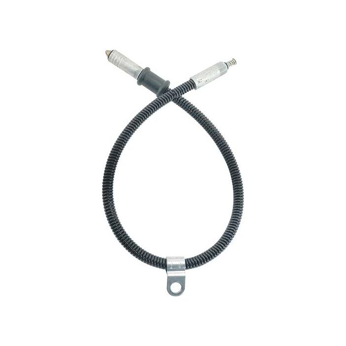

    Take or post a pic of what an original looks like when you have a moment please.

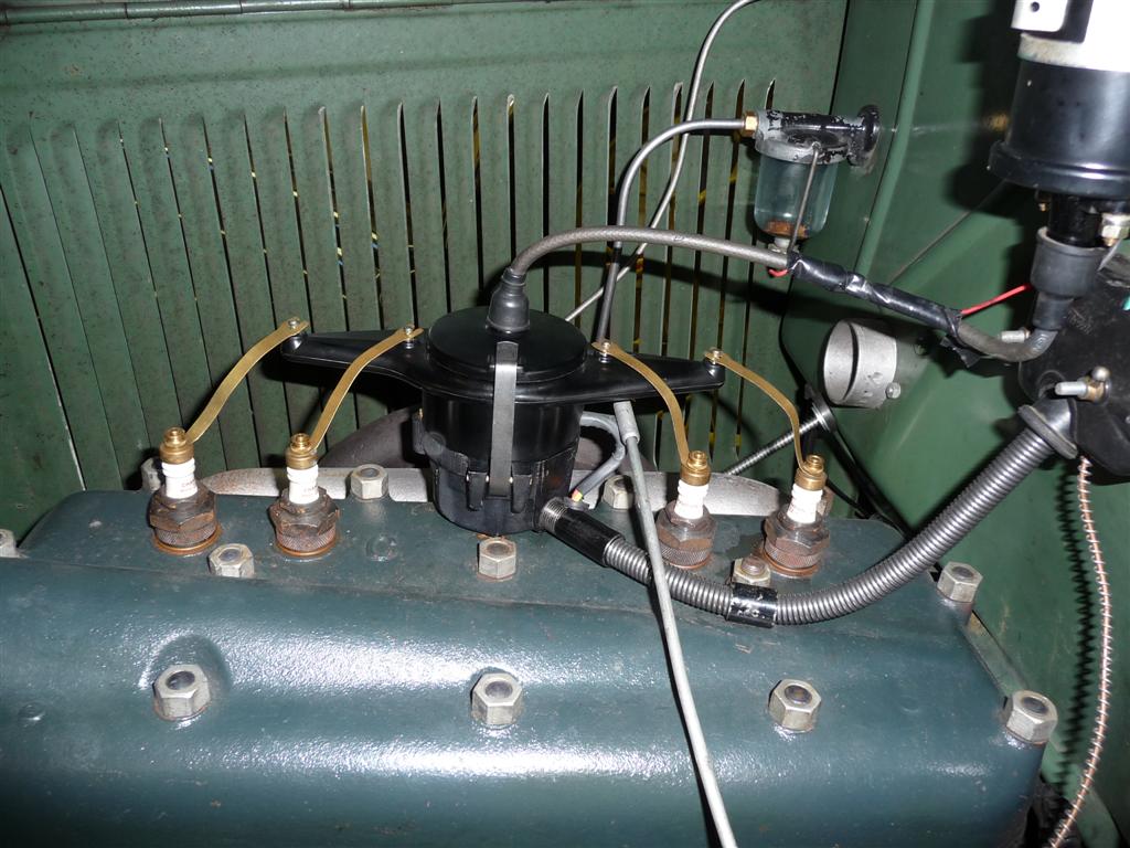

    Here is an original. You may remember how we cut & spliced the one that was on the car when I got it. I used that one on the AA, then replaced it and foolishly threw it away.
    An original type cable won't reach where my ignition switch goes so I was going to have to cut one up anyway. Might as well just do this. I don't have the spring loaded plunger but I don't think I need it because my contact is depth adjustable unlike the original...

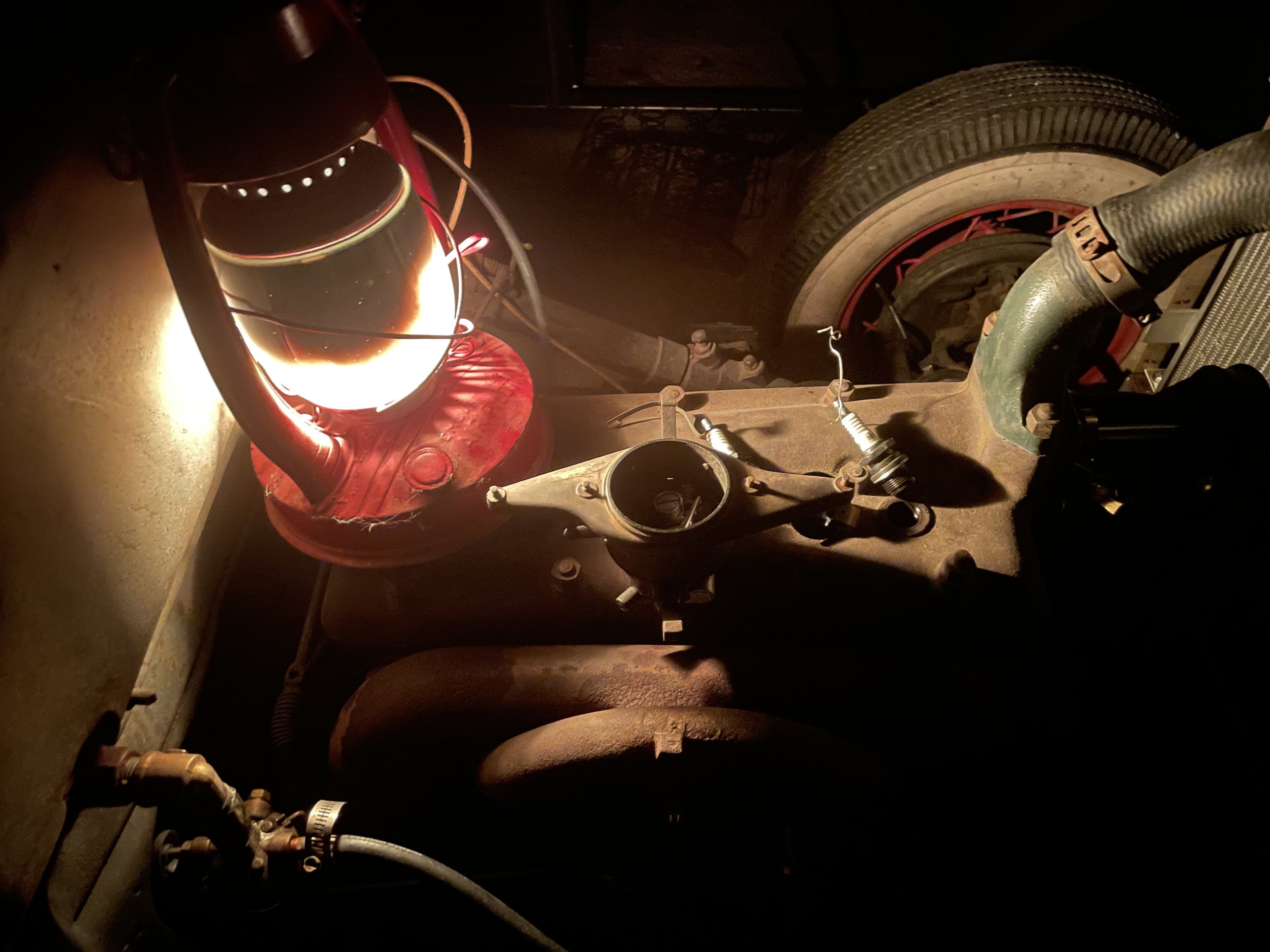

    Omg... had a brain blast and had to run back out to the shop. I was so laser focused on spark I forgot about fuel. The substance formerly known as gasoline that has been sitting in the tank for god knows how long is 100% not flammable and has plugged the sediment bowl to the point of barely allowing a trickle through. No wonder!!!! It ran very briefly earlier but wouldn't stay running... The timing is right, it's just flooded with **** that won't burn. I've drained it... I'll let it air out and come back with a new filter & some fresh gas tomorrow.

    @Ryan it may be a cell phone picture, but how many times was a banger engine repaired by lantern light?
