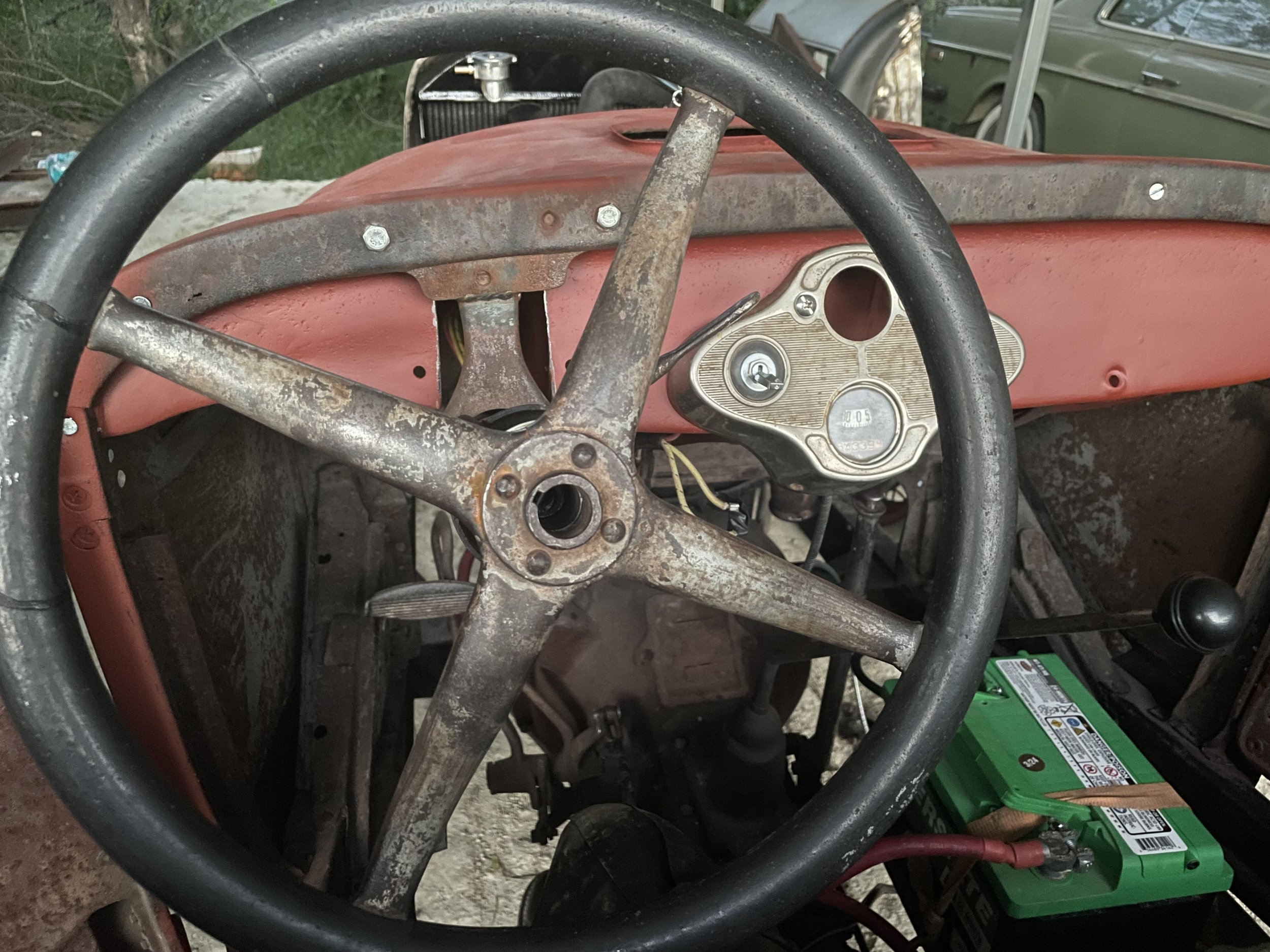

    I remember having concerns many moons ago that the A column drop and the T dash were not going to get along. I had to clear it for now; my welder isn't at home- since I have no power in the shop, I just left it at work. But I will make that area prettier. Also, the mystery key switch I had zip tied to the column turned out to not fit so I threw a toggle in it for now but will get a Model A switch on order like the one I have in my AA. Or maybe I won't. Who's stealing this junker?
    The speedometer works! I have had it all this time and never really knew if it would or not. Next up - I have to stretch the ammeter wires and figure out how to plumb in the temp gauge that will be going where the fuel gauge would have been.
    Speaking of fuel gauges... I don't know if there's a way to make that happen with the T tank, but I have been experimenting with the idea of a low fuel warning light... I found a fuel-resistant float switch that I guess is for agricultural applications. I can mount it in the tank and have it light up a warning light when the fuel level drops below a certain point. I'll just have to knock a hole in the tank... on which note, all that soldering and lining we did seems to be holding up. I really didn't think the tank was going to end up being any good but it's holding. So far so good!
    OFT, brEad, RodStRace and 4 others like this.

    Forgot to mention I fixed the e-brake too. Since I can't start the car from inside yet it was getting really annoying to find places to park where the car would not roll lmfao
    This car will be coming to work soonish so I can get some more welding done, start working on the floors (for the bed as well) and cleaning up the wiring.

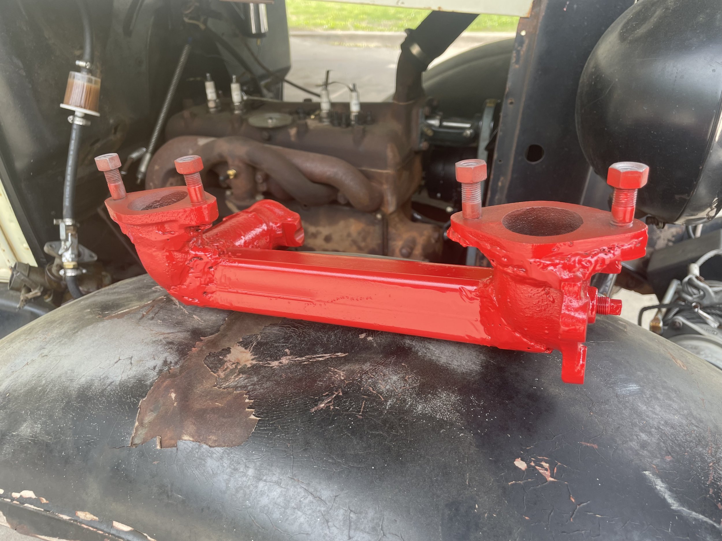

    Get a grinder or a flap disk after that intake! That thing is ugly!

    I was gonna, but those welds are pretty porous. Right now it seems to be airtight & being that this is cast iron I really am not set up to fix it if I knock a hole in it grinding on it. It painted up to about a six footer so I'm fine with it for what it is.
    I need to surface it before I leave work today but she's ready to run otherwise.

    I forgot the new manifold gaskets at work, 40 minutes away, so it was never gonna run today to begin with.
    I ended up needing to replace the studs for the manifolds because the original nuts have permanently melded with the studs. I was able to find three studs at NAPA but they did not have a fourth. I was confident I could find one at one of the other three auto parts stores in town. I could not.
    Undeterred, I figured I would go ahead and mock up the linkages. Did you know no parts store carries carb linkage kits anymore? I didn't. Now I do.
    No matter. Everyone carries fuel fittings... or do they? Out of four parts houses, I was able to find exactly two 1/8" MNPT to 5/16" fuel line elbows. I need four. The hoses are only temporary anyway - I will make up hard lines once I'm sure these carbs are actually going to be usable. But I don't want to buy the line and rent the flaring tool & bender if it's not gonna work out.
    Then I ran out of daylight before I could make up plug wires for the new distributor cap. Whomp whomp.
    No big deal. I'm taking the manifold with the carbs to work tomorrow. We are expecting to have a crazy slow day. We have a ton of stuff left over from my buddy's BMW we made linkages for, so we'll get that working there. I'll make up the plug wires using the AA there, and there are five parts houses in Weatherford, so I'm sure I'll be able to scrounge a stud and two more elbows.
    If all of this works out, when I get home tomorrow evening, I'll just need to install the intake, hook up the fuel lines, wire the fuel pump and let er rip. The only bad news?

    Mocked up on the blown engine in the AA. I have full throttle travel. When I get home all I need to do is slap this on the T, hook up fuel, and see what happens...

    It ran pretty well at first crack. Not perfect, but pretty good... had some issues with the carbs that cleared up after running. Float stuck in one and something leaking internally in the other for a bit. They have sat ever since I rebuilt them so I was expecting some issues.
    The power jump is crazy. It pulls pretty hard for a banger... let's be honest, it's not fast but it's no slouch.
    Unfortunately I'm gonna have to pull the manifolds again and have them machined, I guess. I am having some vacuum leaks and I can see a leak around the no4 exhaust port. Also, I've got some kind of high speed miss under load. That feels electrical - just suddenly quits running and then catches once RPMs come down. Might be related to the new distributor cap but could also be something to do with the vacuum leaks.
