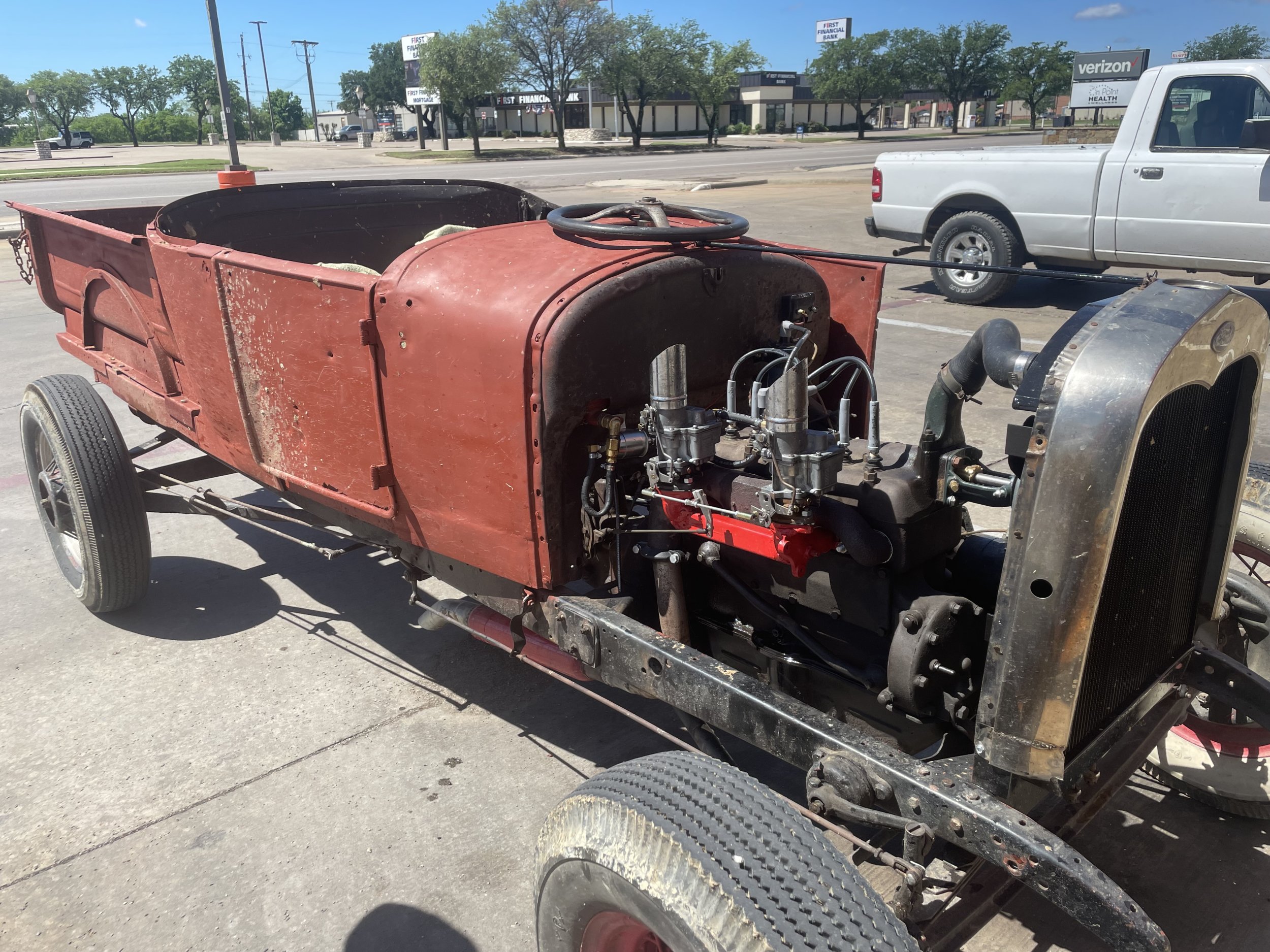

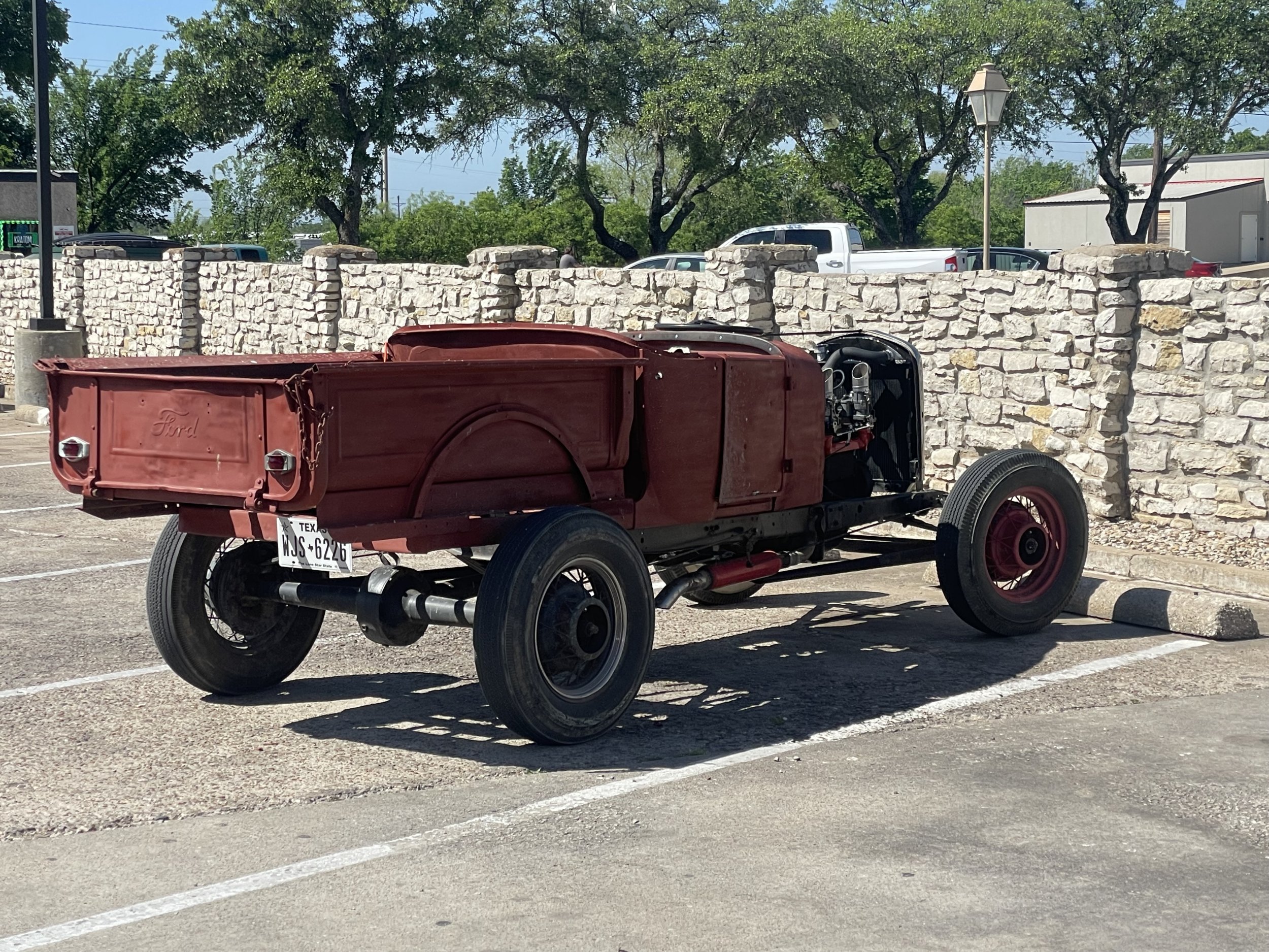

    Working out the bugs one by one. Got the manifolds sealed up good. Fixed a spot where the fuel line was kinking. Now suspecting float level, or some trash in the carb. Seems like it does it after hard pulls or taking corners. I realized I forgot to put a filter back inline... still doesn't have any trouble ******* out the 80 mph speedo and still pulls past that.
    Figured out the accelerator pumps are leaking- gotta yank the carbs again. It's a beast though. When everything works right it really is kinda fast...

    I think I figured it out. Maybe I'm way off here... I thought that was like a 3.5 psi fuel pump but the do***entation with it says 5-9. I can only ***ume that voltage to the pump is what determines the output. If that's the case, that's probably the issue. Right now the hot wire off the pump goes straight to the battery and the generator is making right at 14.5 volts when it's wound out. So it will idle all day without a problem and work fine puttering around the yard slowly, but once I get out onto the road and wind it up, that little pump is feeding 10 pounds to the carbs and probably overwhelming the needles.
    It flooded and died on me and after letting it dry out I got it home without issue by toggling the fuel pump on and off. It will run for over a minute without the pump, the bowls are huge on those YFs.
    Long story short, I think I need to put a fuel regulator in line and just to be safe I should probably limit the voltage the pump receives.

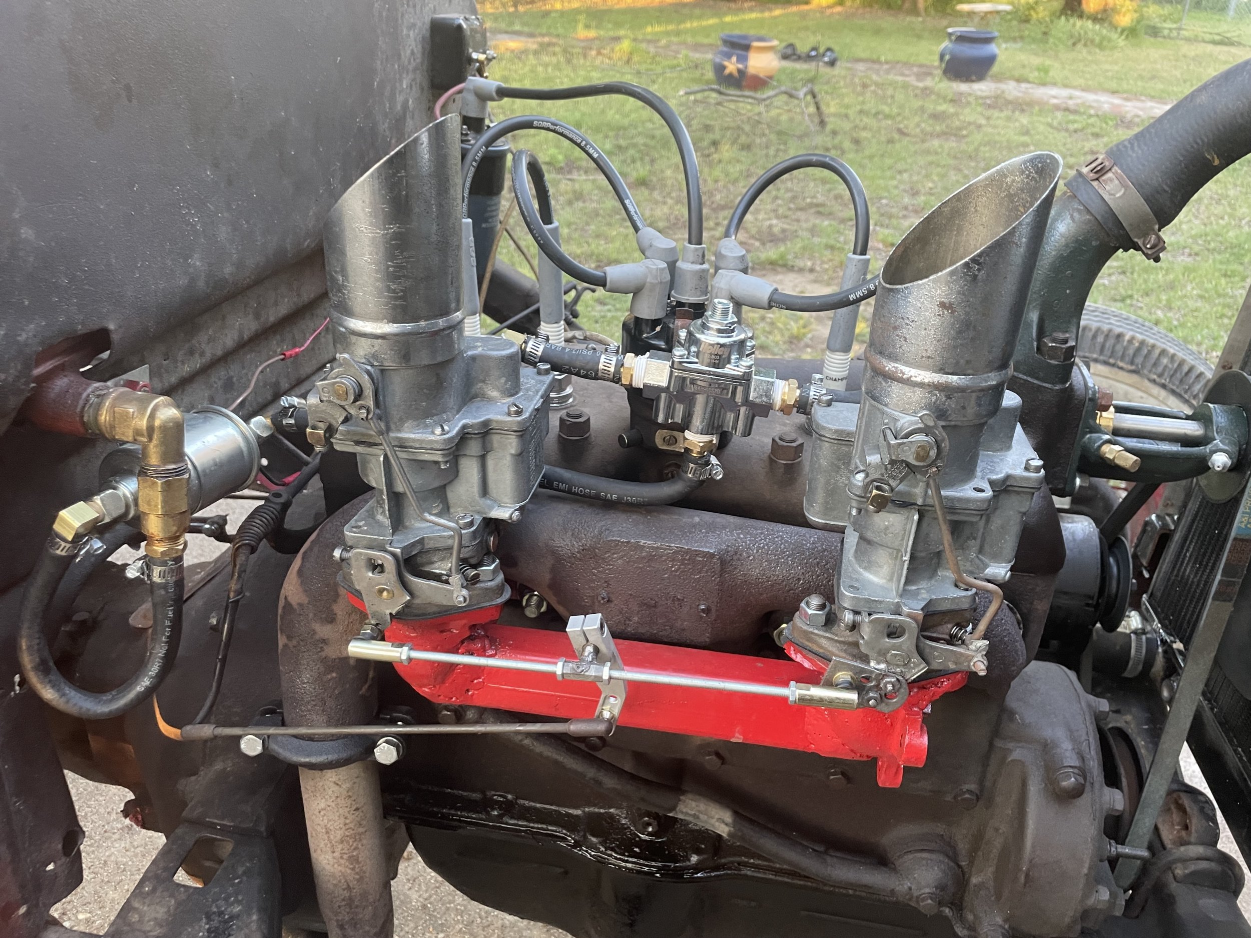

    Regulator did the trick.
    Drives like a dream! Now I know this setup will work, it's time to start figuring out permanent homes for all these components and running hard lines. I don't like the rubber line half an inch off the exhaust manifold!
    I also ditched the autolite plugs and put some champ W16Ys in it.

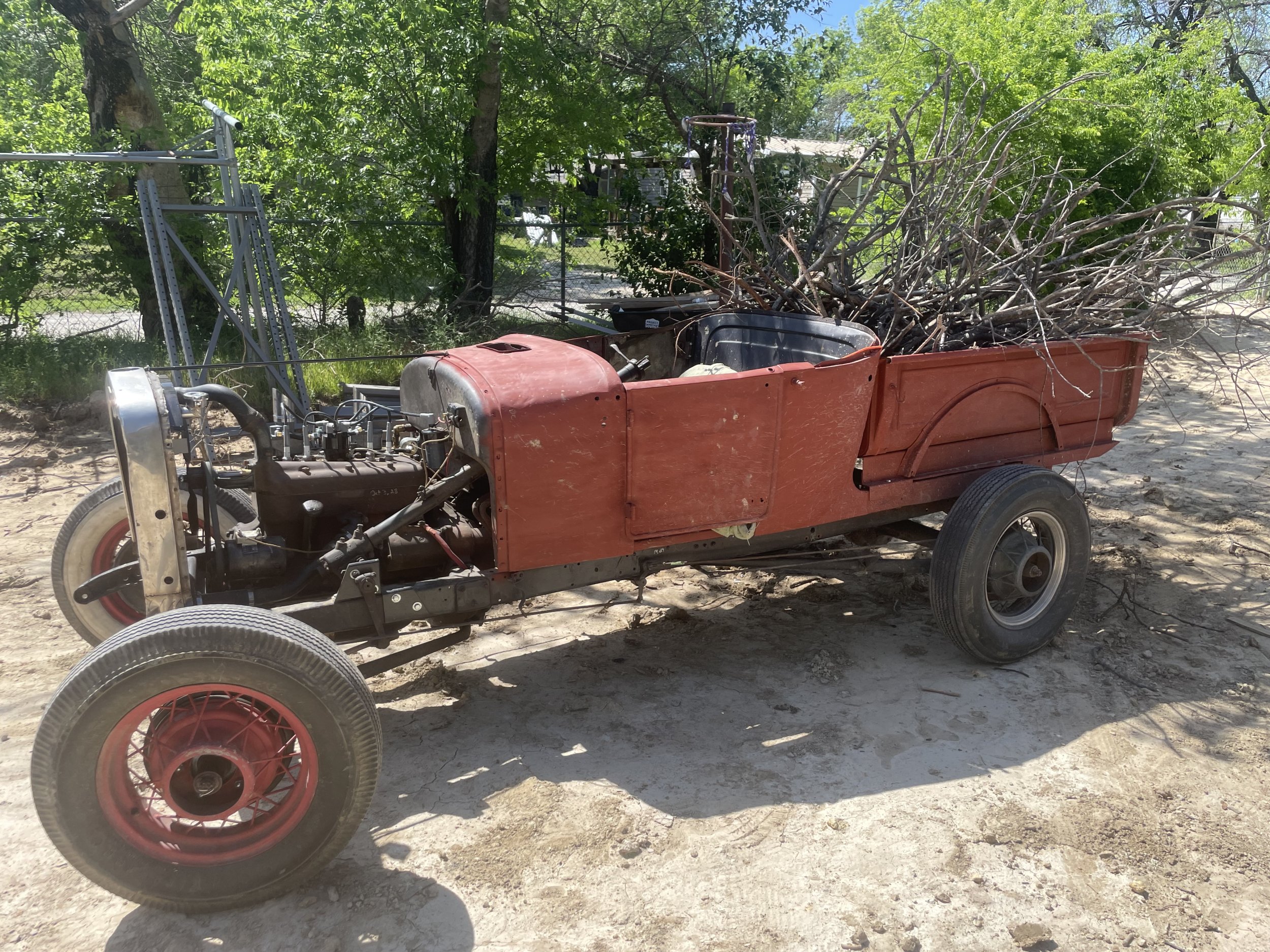

    I have created a very practical vehicle. Yard work is fun now!
    This was about an hour of real driving back and forth on a couple trips to the local yard waste dump. Lots of traffic, idling, acceleration, and even a little highway cruising - so it was a perfect way to get to know the car in real world conditions.
    By the time I got back it was pretty warm - 216 degrees at the water neck. Not hot enough to hurt anything I think, with the pressurized cooling system the water should not have been quite boiling yet, but definitely too hot. It's also nearly 100 degrees outside.
    I'm not sure how much good that fan is doing. It's the stamped two-piece four-blade fan that came off the AA (not the one that is prone to suddenly fragmenting but the later replacement that is only a single layer of metal), with the damaged piece (two blades) removed. I tweaked the remaining blades a little to encourage more air flow but I don't think it's enough to do much at idle. I should start looking for a better fan and probably try to come up with some kind of shroud.

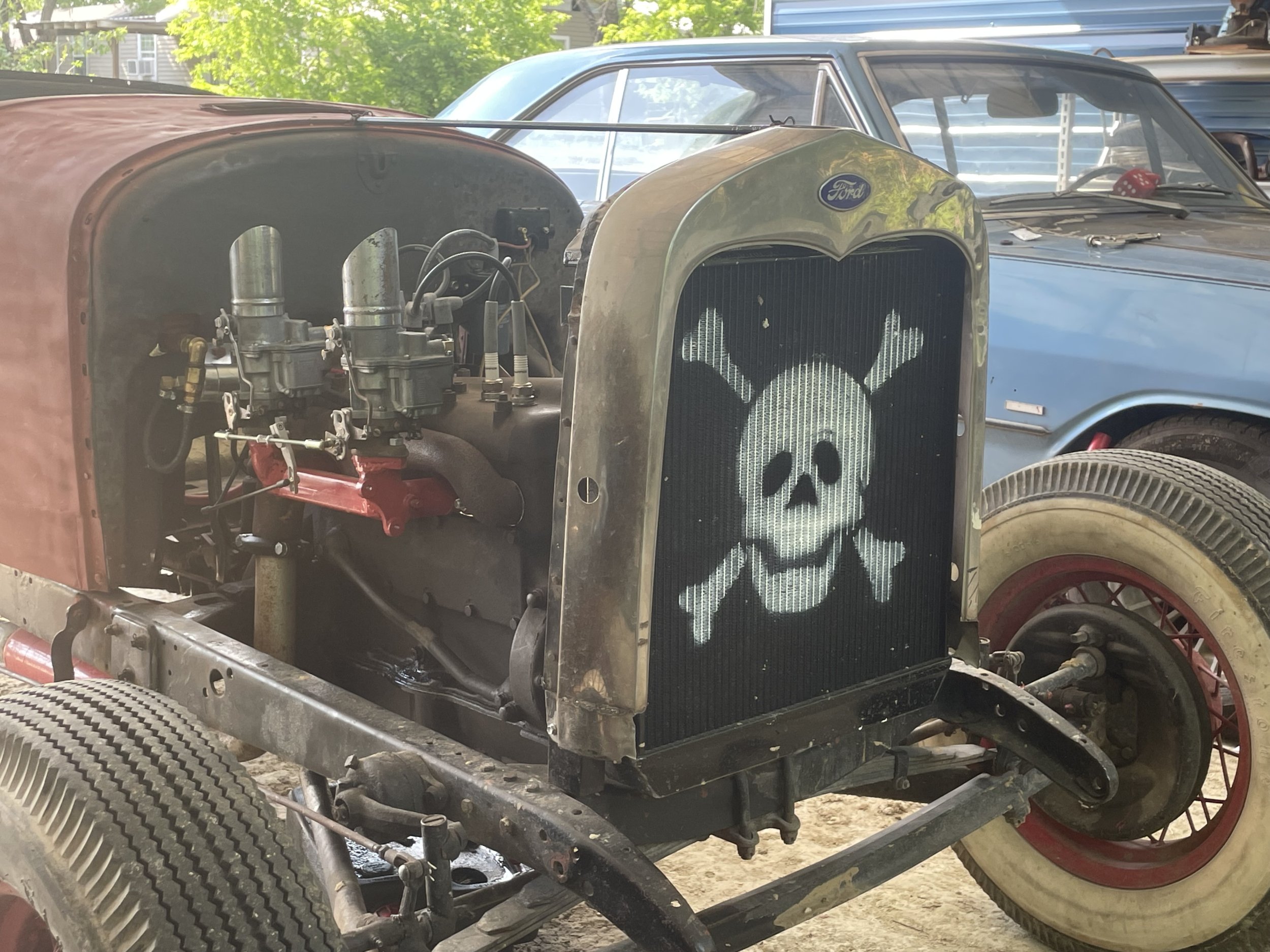

    Saul made me a stencil today.

    Not a fan? :p
    It needs a couple touch ups. I needed to get the stencil away because I **** at using paint and it was getting wet.
