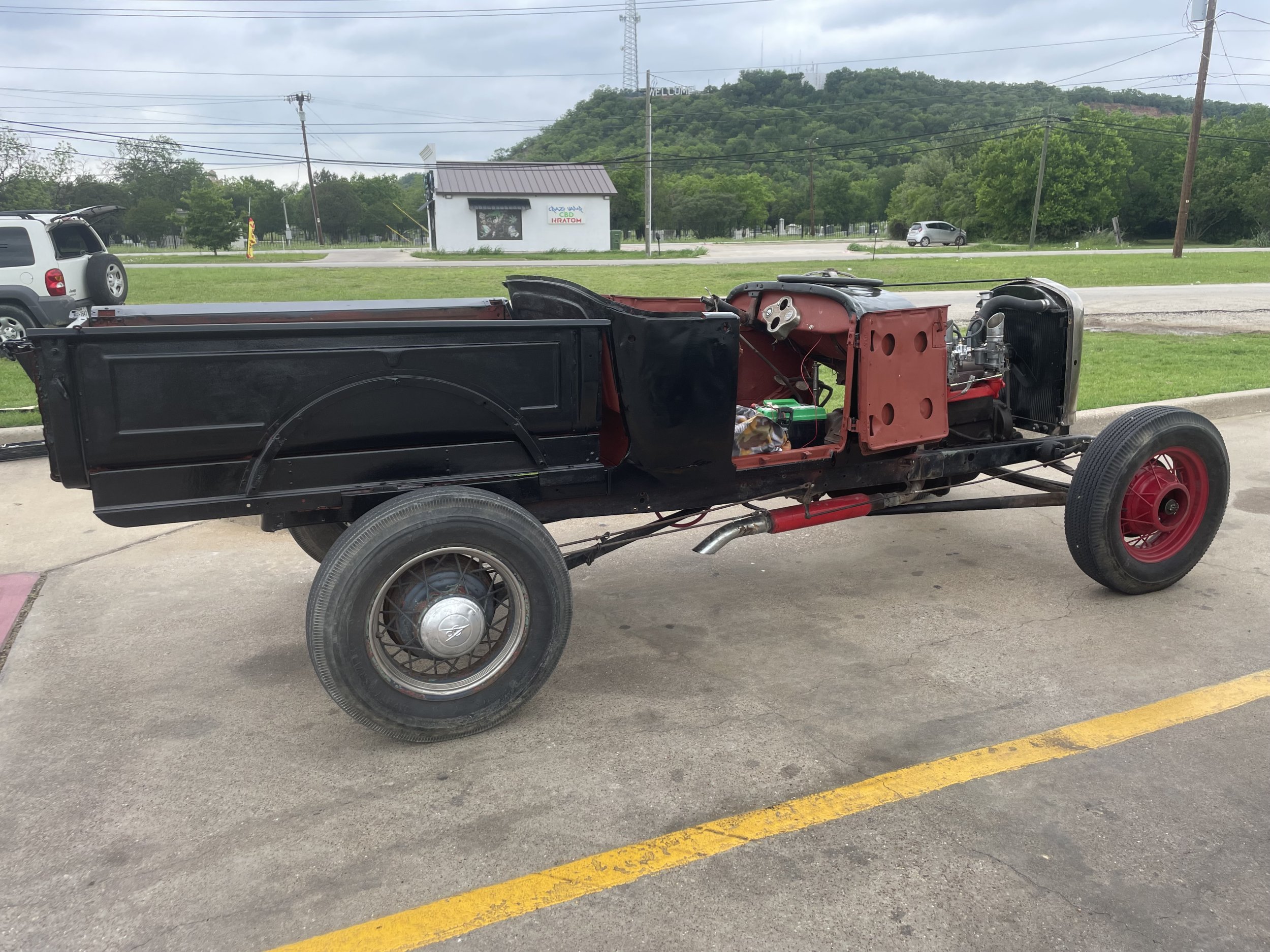

    Yesterday, the generator had quit charging. I took it apart and tested it and it tested fine, so I put it back together and it worked suddenly. Then I was letting the car run to charge the battery and both carburetors started dumping fuel out of the vents. Got the floats unstuck but it was badly flooded by that point so I came back to it today, fired it up and it ran great for a while until the brand new fuel pump just quit working altogether. :rolleyes: Took it to autozone and got a refund and replaced it with an Edelbrock one - the kind that comes in that ugly hunk of red plastic. That wasn't doing it for me so I took a hacksaw to it.
    This is not the most elegant mount but it will work.
    With all that ******** sorted out Saul helped me smooth out the cowl. We worked on the metal a little more, then did a skim coat of filler for the pits and shot some more primer on it.
    Then it was time for a bath...

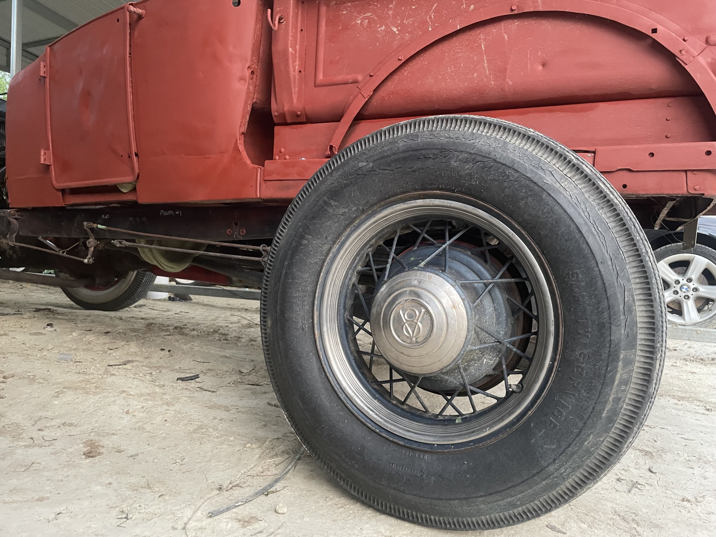

    And then I remembered I had some hubcaps.
    Hopefully nobody notices that it's not really a V8... :p
    Tomorrow we are gonna work on smoothing it out some more and hopefully do a color coat. I'm just going for a gloss lacquer black. Cliche, but **** it. I can always change it later.

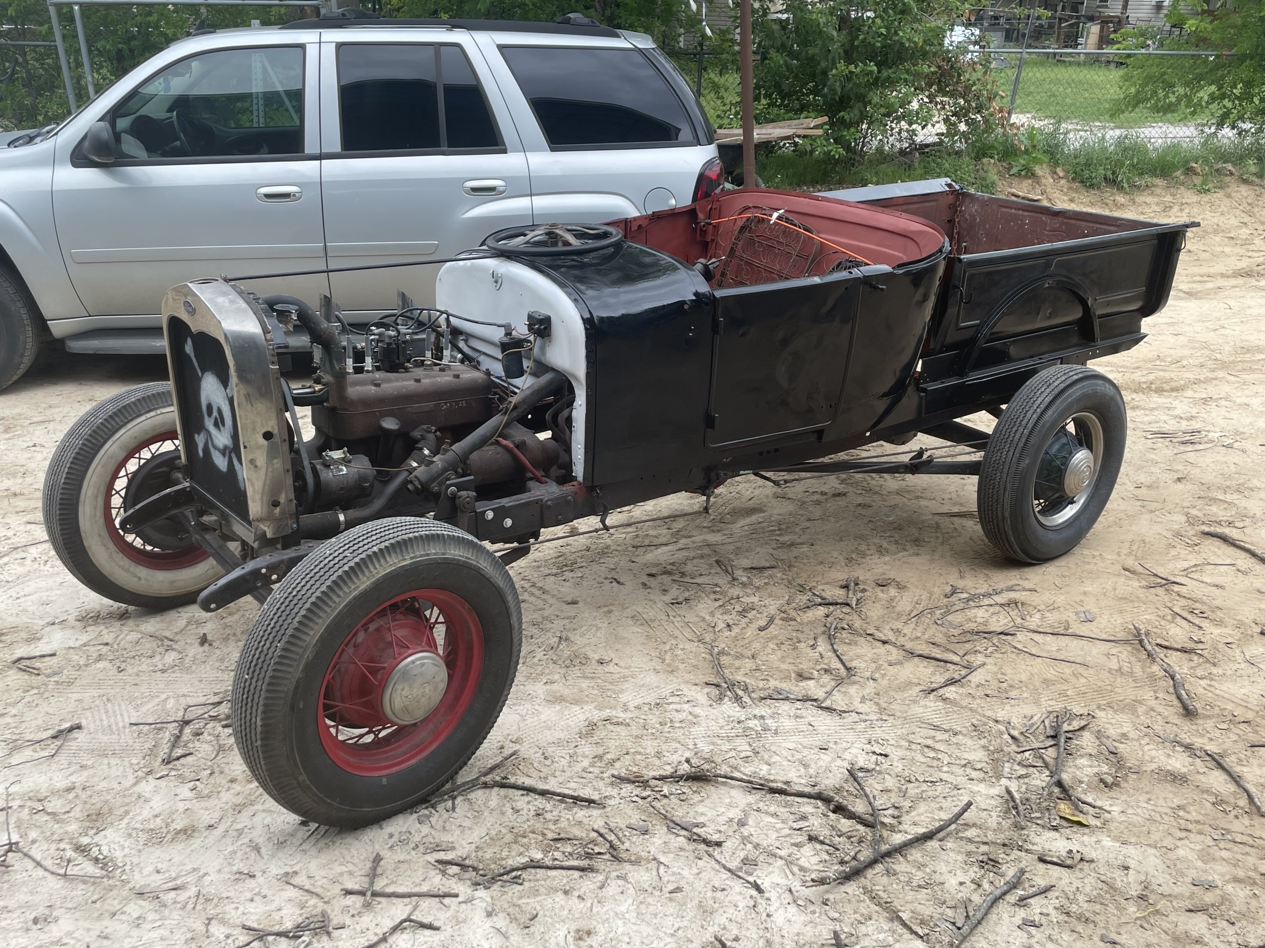

    Working on tuning it today and stopped at a friend's house to check out the Scout he was working on. A bunch of neighborhood kids wanted to check it out and sit in it which turned into wanting to ride in it so she got a pretty good workout today.
    I've noticed the radiator shell seems to be leaning more and more forward lol. Need to figure out how to get it to fit better.

    How the hell is it leaning forward with that 1/4" rod fastened at both ends? Didn't we get that thing solidly mounted?
    brEad likes this.
  25. trevorsworth
    Joined: Aug 3, 2020
    Posts: 2,056
    trevorsworth
    I don't know if it has actually gone anywhere since I put it on but it definitely has a bit of a lean. We never mounted it with this specific radiator and it doesn't fit very well. The shell is bottomed out on the top tank and doesn't want to sit all the way back. I need to pull it back off and see where it's rubbing and maybe just try to cave the aluminum tank in a little to clear. The shell is fastened to the radiator at the bottom but there is no common ground anywhere above that point so nothing else to attach it to. It is rigid enough that the fan never comes anywhere near it but I don't like it. I need to make up some tabs.
    If I could raise the shell a little it would sit level but then it stands even further above the cowl. This is the same issue Sid's car has and the fix would be the same. What I need is a '30/31 crossmember to lower the radiator a little.

    Slice out the radiator mounts on the crossmember and lower them down and weld back in. Works fine.

    If I remember right Trevor fabricated some brackets and bolted them through holes in the crossmember. I don't recall seeing a way to "slice and lower" as mentioned above.

    The pads that I used as mounting points can be cut out and welded in lower, which dwollam did on his car and is what I'll need to do on Sid's. But it occurred to me that the bottom of the radiator is already very close to hitting the crossmember as it is, so it wouldn't get me anywhere.

    I used a 30-31 radiator on a 28 frame so when I lowered the mounting pads the raditor and shell fit properly.

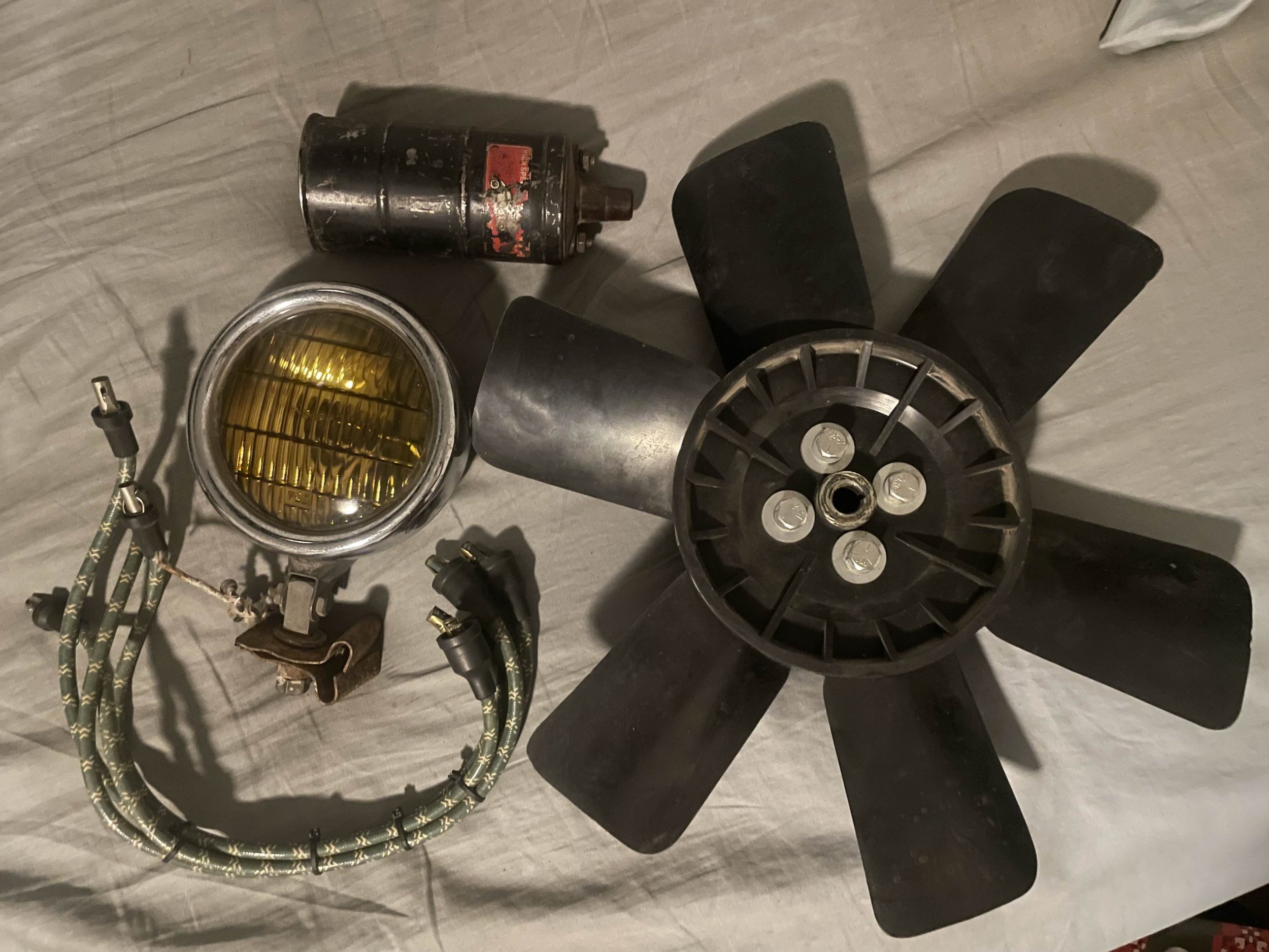

    Little bit of loot for the T from the Stray Kat. Thanks @winduptoy for the fan!!!
    Need to find exactly one rajah terminal.
