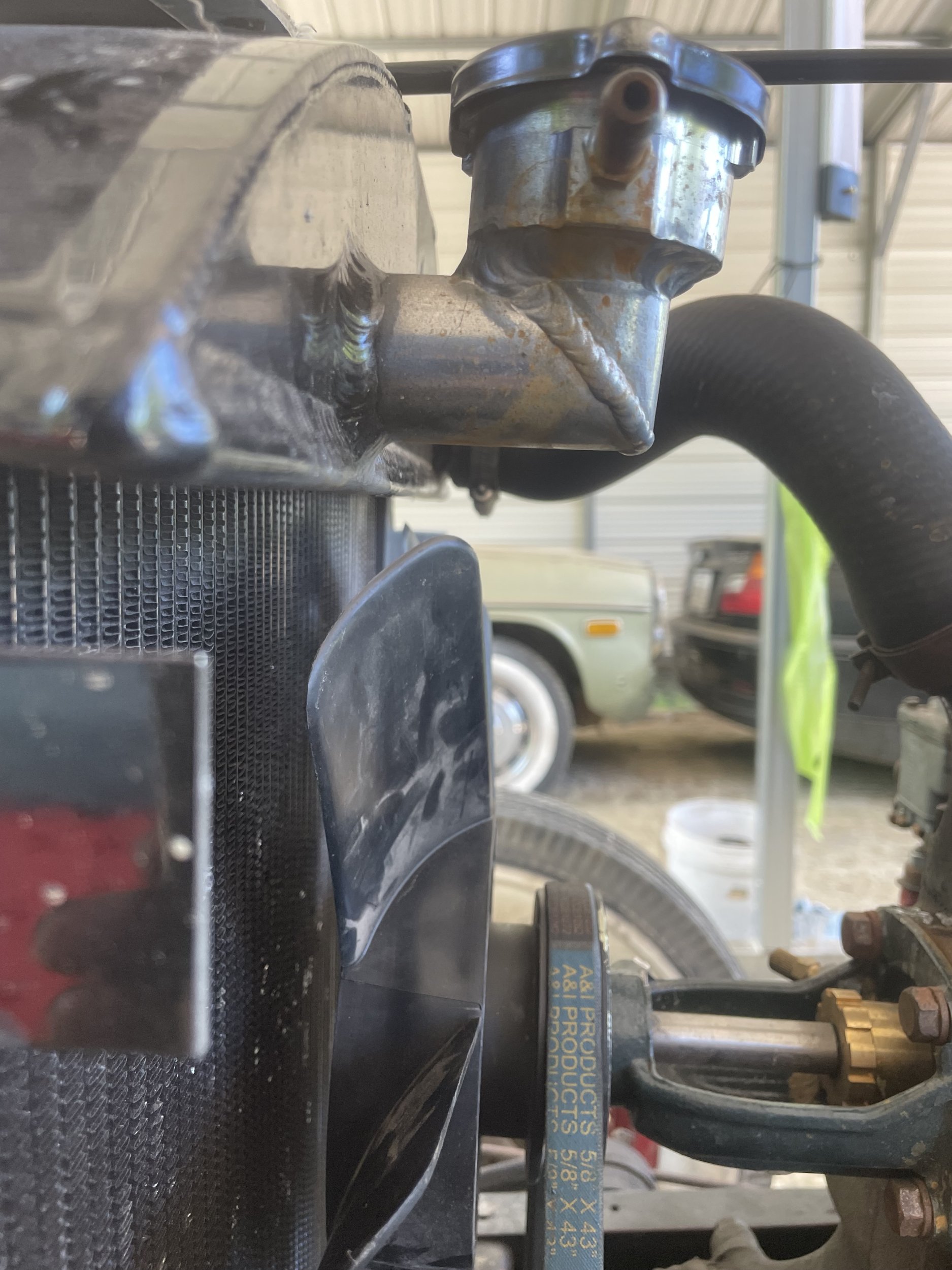

    I didn't waste any time installing Larry's fan this morning. This allowed me to straighten up the radiator, which corrects the appearance of the grille shell leaning forward. I took almost an inch out of the support rod, so the front angle is much better now. Most importantly, it corrects a vibration the tweaked stamped fan apparently had been causing.

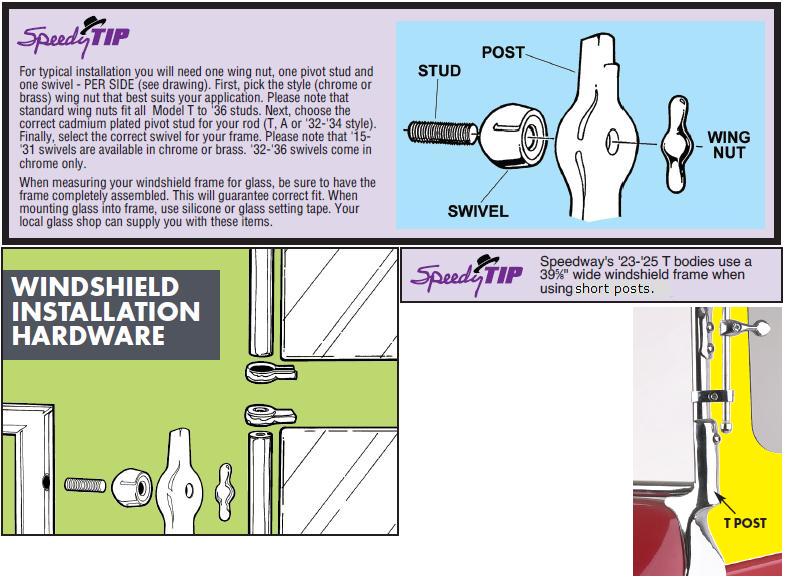

    Dug out my windshield chit. What am I missing that would allow me to affix this frame to the stanchion? I am envisioning some kind of clamp with a threaded rod for the windshield to pivot on? Can't find any clear pictures on the web.
    Thor1 likes this.
  13. GuyW
    Joined: Feb 23, 2007
    Posts: 839
    GuyW
  14. trevorsworth
    Joined: Aug 3, 2020
    Posts: 2,056
    trevorsworth
    Couldn't have asked for a better diagram. Thanks!!! Found everything I needed with Speedway. I didn't realize I had to drill & tap holes into the aluminum slugs on the end caps but that makes sense lol.

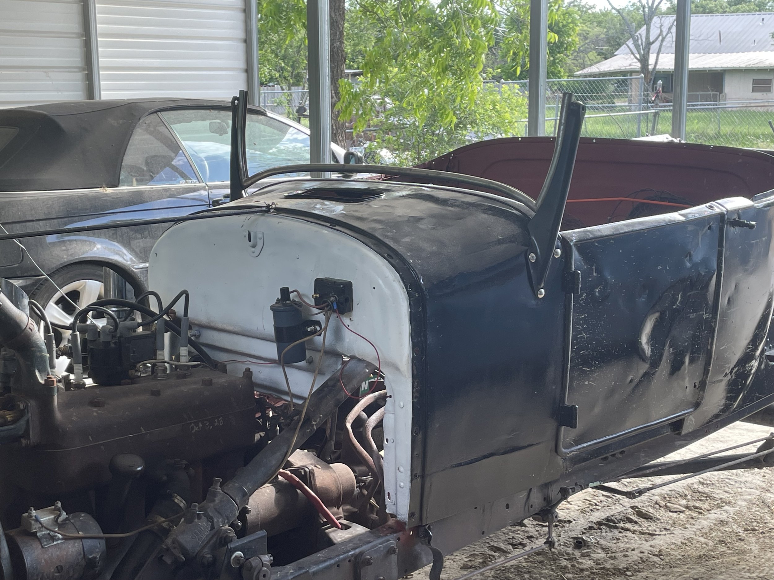

    Started mocking up. Had to straighten up the cowl a lot to get these stanchions even but starting to get there.
    When I chopped these stanchions I kept the tippy tops to weld back on. Once I get the windshield in I'll start looking at how to chop the original folding top I have...

    Side pro with the stanchions looks good. Splurged a little on the pretty stainless carriage bolts ($2.19 a pop :eek:) but it looks right.
    I need to do some more tweaking on the cowl, it's slanted a bit, but I figured out the method. Using a ratchet strap on the end of the stanchions to a good anchor point I am able to pull the cowl into shape pretty easily.

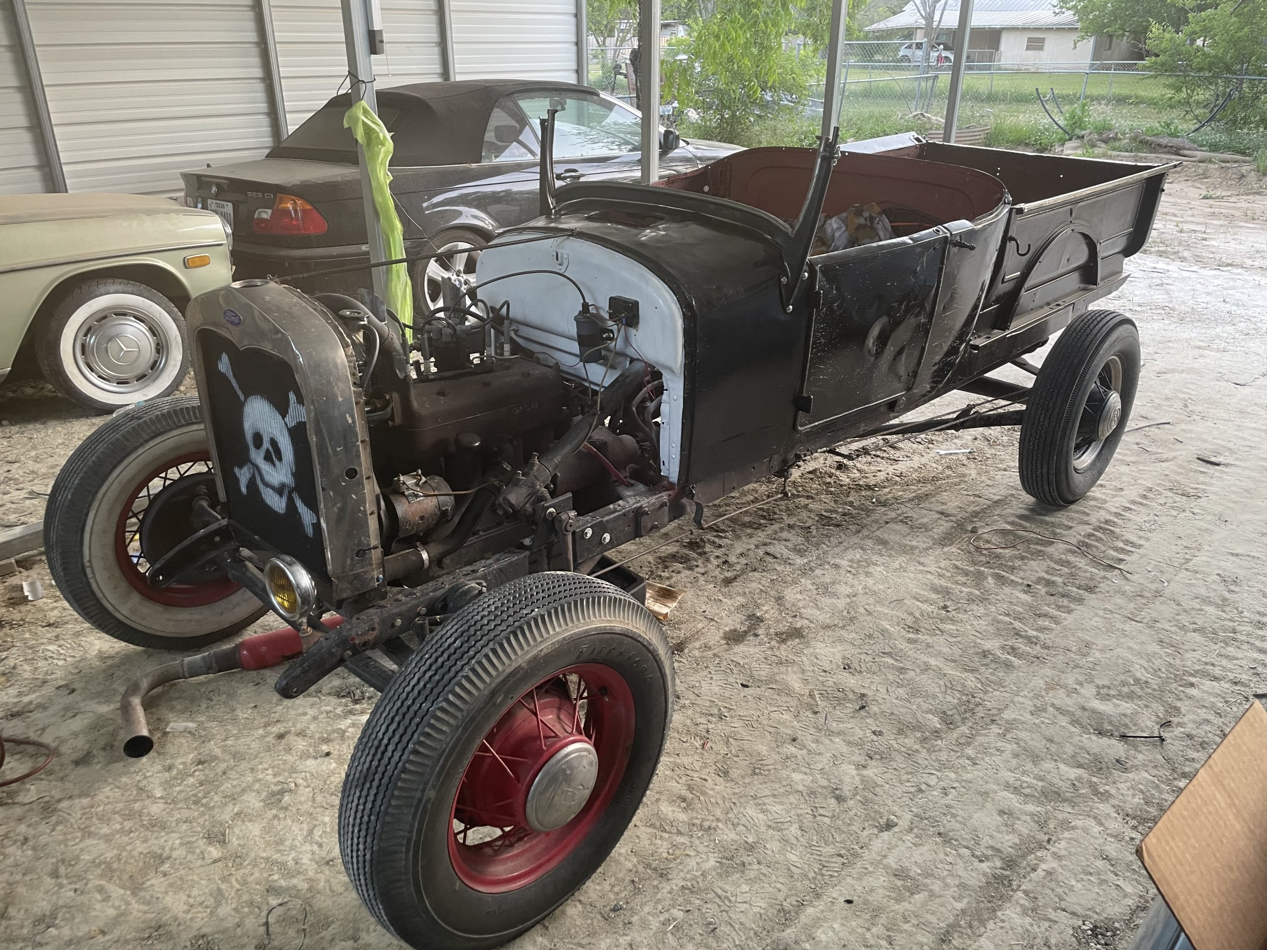

    Took the car to another historic burger/shake joint in town and it made some friends there. Damn good burgers!!!
    I'm starting to rack up some real miles on the car and it's been pretty trouble-free. I am trying to work up the nerve to drive it the 30 or so miles to work once I get the windshield installed. It was my only car over the weekend as I've loaned out my modern truck and the Dart is currently down and it hasn't given me any trouble using it for my regular errands. Got the speedometer back in and according to GPS, it is pretty close to correct at around-town speeds but will read 80 when I am doing 70.
    I ran out of room to see how fast the car would actually go. It doesn't rev that much higher than it did before and 69 mph was the fastest I got it with the 1 barrel, so I expect its true top speed with the A transmission is about 75. Around there it starts floating valves and doesn't want to pull any more.
    It is pretty happy cruising at 55 or so but I think the engine has plenty of power and certainly will once I put a 6.5:1 head on it. I happen to have the hogshead I need to bolt a T5 into this thing so I'm starting to consider my options there... this transmission I fear is not long for this world. My "gentle" driving habits notwithstanding, it has a second-gear ejection issue and a pretty good rear leak has developed.
    One concerning thing I've noticed is that every once in a while it pushes some water out of the overflow and eventually it runs itself low and starts running on the hot side. Not overheating, but it will run 150-160 right after I put water in it and eventually it pushes enough water out and wants to run about 200, sometimes up to 210. This radiator is designed to be pressurized and I have a 9lb cap on it right now. The water in the radiator is staying nice and clean.

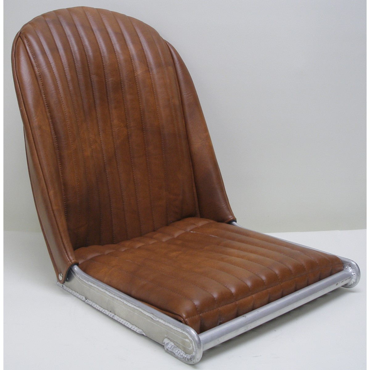

    Did some thinking on the seat situation. I knew I wanted a bomber style seat, but I don't like many of the options out there right now.
    I started thinking about the time and material cost of building my own, then having someone upholster them.
    I figured if I did it myself I might save what, $200?
    Speedway has a couple options... but one comes without upholstery, and is a little too smooth. The other has lightening holes but for two it'd be like $600 before upholstery.
    They have one I could rivet together, but it looks a little rat roddy...
    Long story short, $780 for a pair of these in red seemed like a good deal.

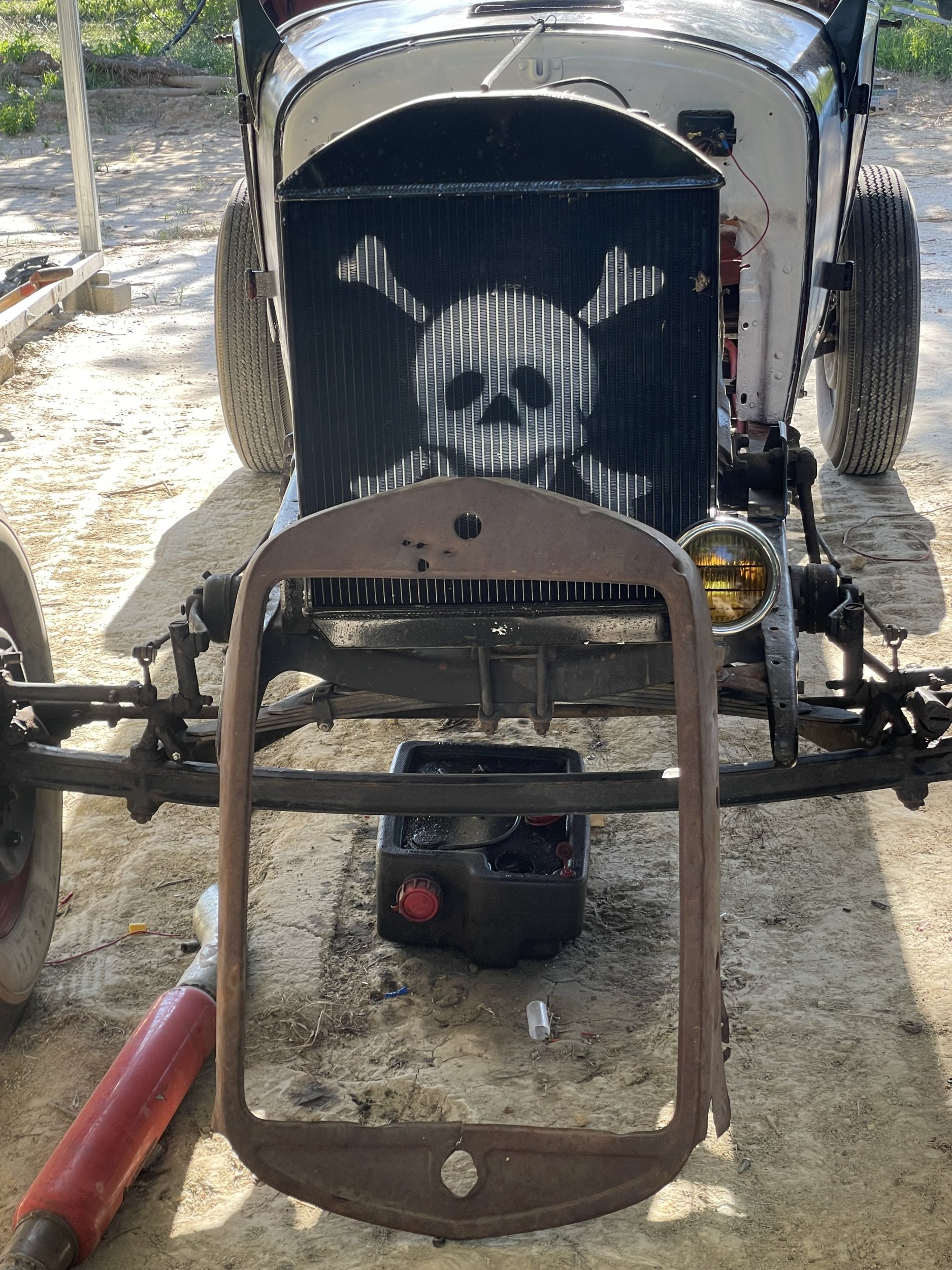

    I was scrolling through marketplace a while back and saw a listing for an unknown grille shell. He was pretty far away, further than I wanted to drive, but I could tell the guy was a fellow rodder so I let him know it was a commercial shell and he had it way cheap. After chatting for a bit he said if it didn't sell at LSRU he'd hang on to it, because he frequently roadtrips through my neck of the woods, and I could have it for his too cheap price.
    Ordinarily that's the kind of deal you never expect to close but Hayden followed through and now I've got a pretty nice commercial shell for the car.
    It has some bullet holes, but it isn't thin, so they will be easy to pound out and fill. I'll section it and paint it. I think it will probably look better than the widow's peak shell. If not I'll weld it back together and keep it as a backup for my AA or a future project.
