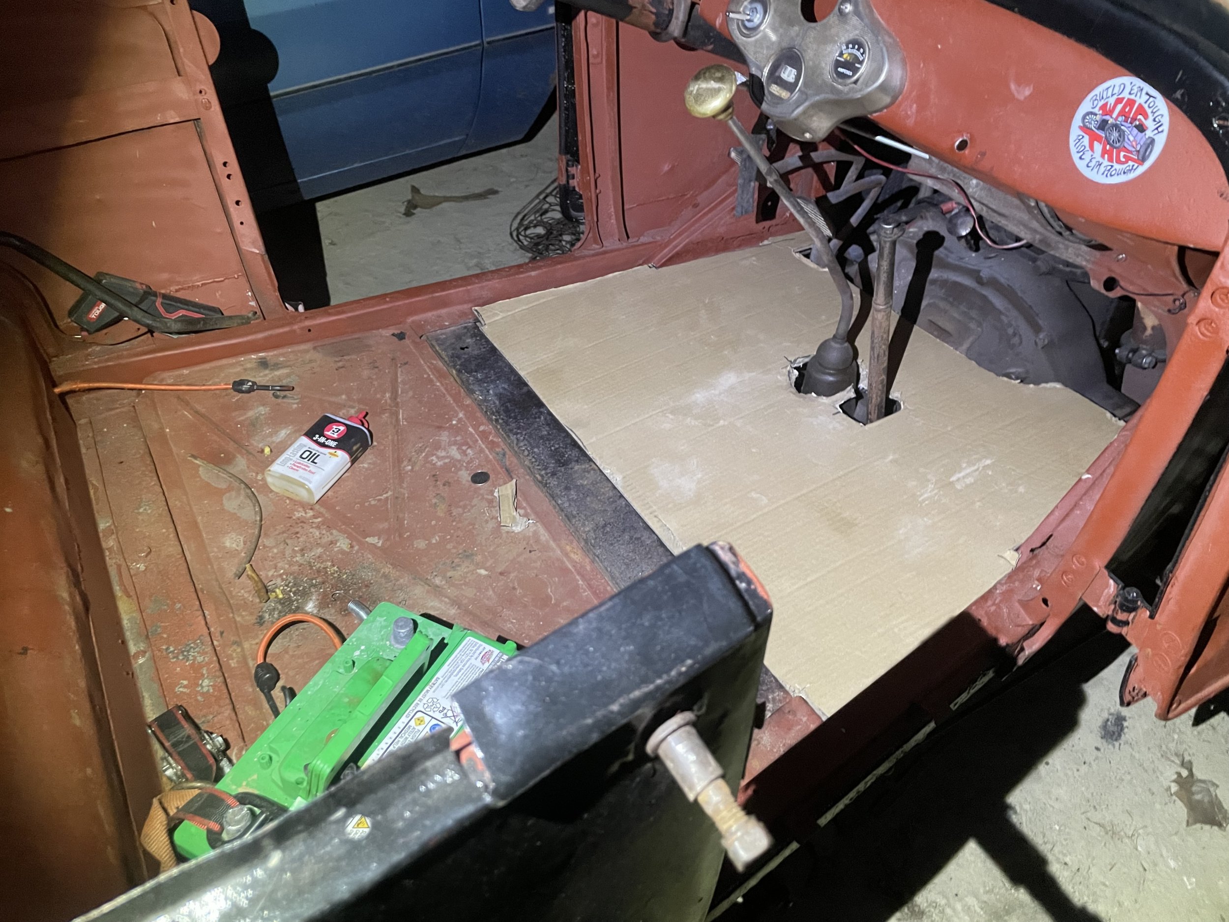

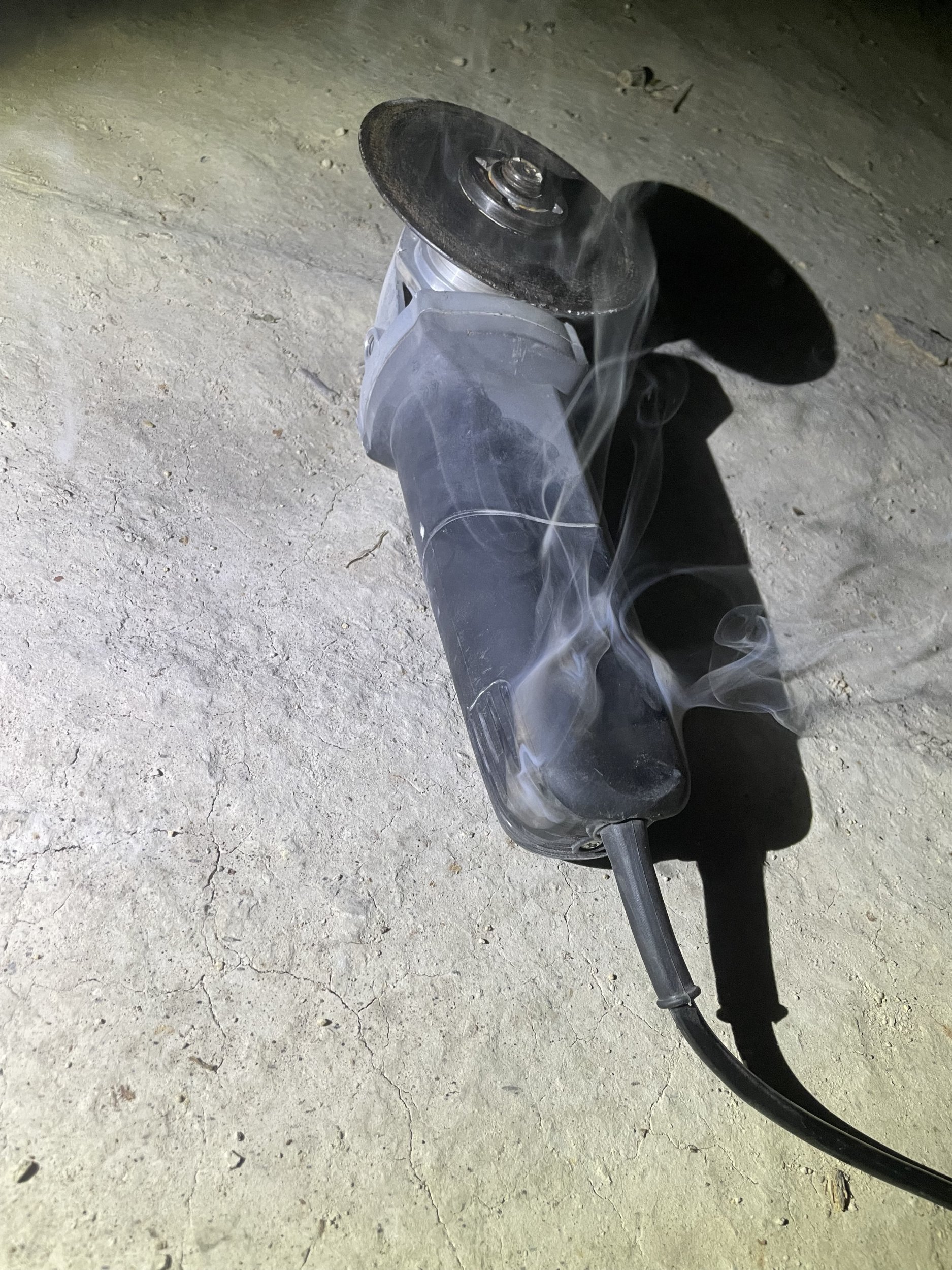

    Had a little energy still, so I employed CAD to make a floor template.
    Should you use an angle grinder to cut plywood?
    No.
    Toms Dogs, Okie Pete, brEad and 4 others like this.

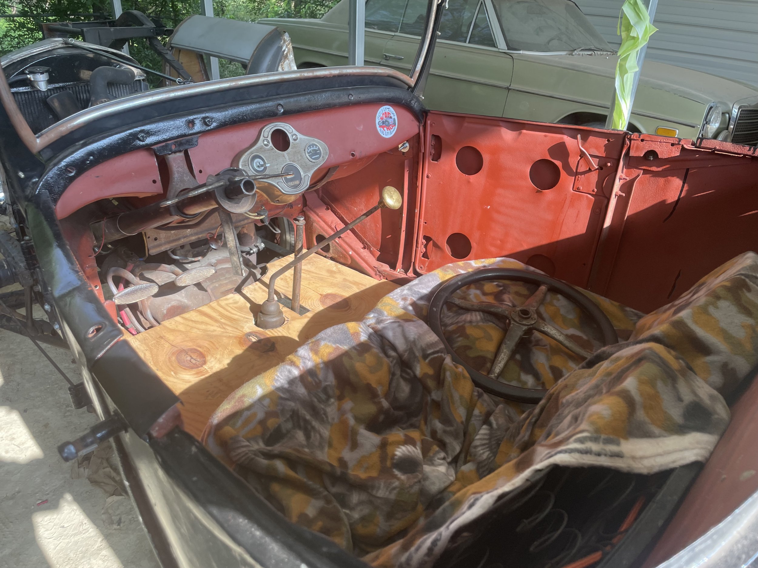

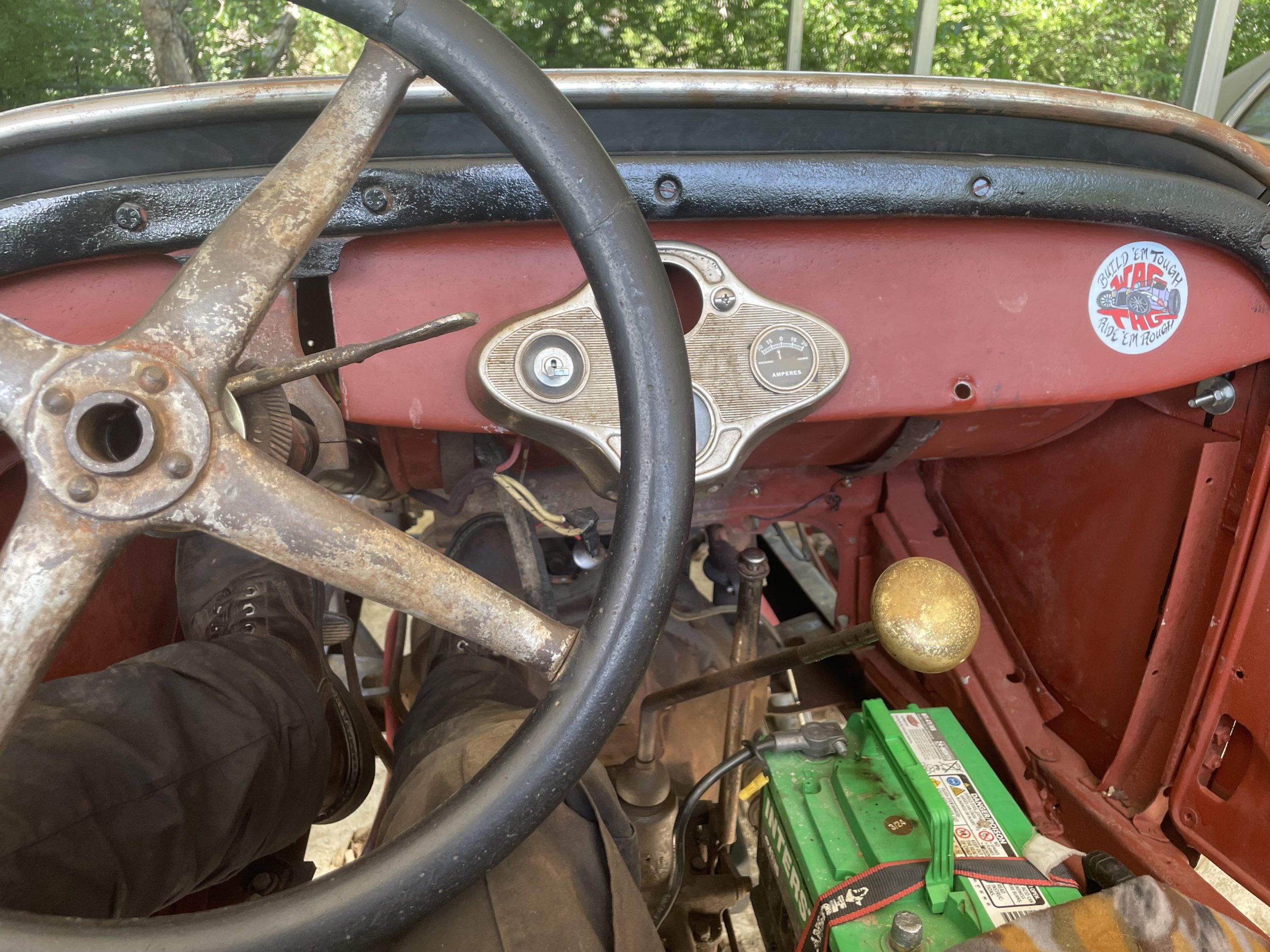

    Floor fits good but it's too high lol. My foot can get wedged between the floor and the gas tank. Probably gonna use this wood piece as a template and make a dished metal floor at Robin's.
  22. Bigcheese327
    Joined: Sep 16, 2001
    Posts: 6,740
    Bigcheese327
    I once sat in a chopped Deuce five-window that had a depression for your heels just around the pedals. Seemed pretty slick, at least sitting still.
    trevorsworth likes this.

    That would be easy enough to do. I should probably hold off on spending hours on a permanent floor until I get the permanent seats in so I know exactly where my heel will rest. In the meantime maybe I'll just cut a hole in the floor for my feet and zip screw a s**** of metal under it to buy myself 3/4".
    I was envisioning a depression in both footwells with a bit of a "transmission tunnel" in the center but I'm not sure if I know how to form that with the tools we have access to.
    Bigcheese327 and Outback like this.

    I don't have a jigsaw period. I cut that 3/4" plywood with an angle grinder. Two angle grinders, technically. :D

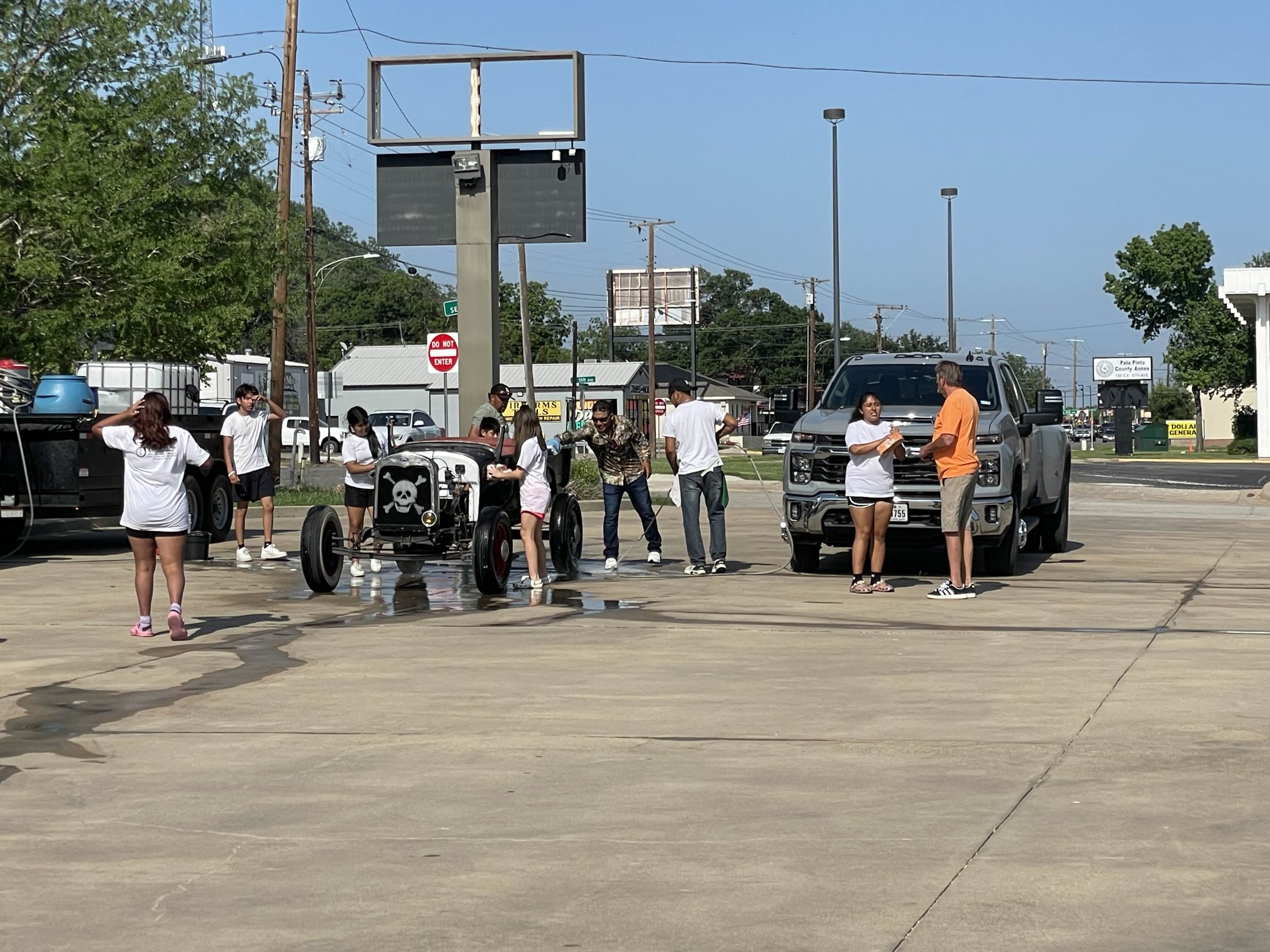

    Took the hot rod to the bar today with Saul and on the way in, a girl with a sign reading "FREE CAR WASH!!!" waved us in to a bank parking lot. Her church was doing car washes and hot dogs for donations, so we availed ourselves of the dogs and the car got a quick spa.
    I am pretty impressed with how good the paint looks overall once cleaned. I donated the tips from today that were in my pocket for that good bacon-wrapped hot dog and hand wash, which came out to $40.
