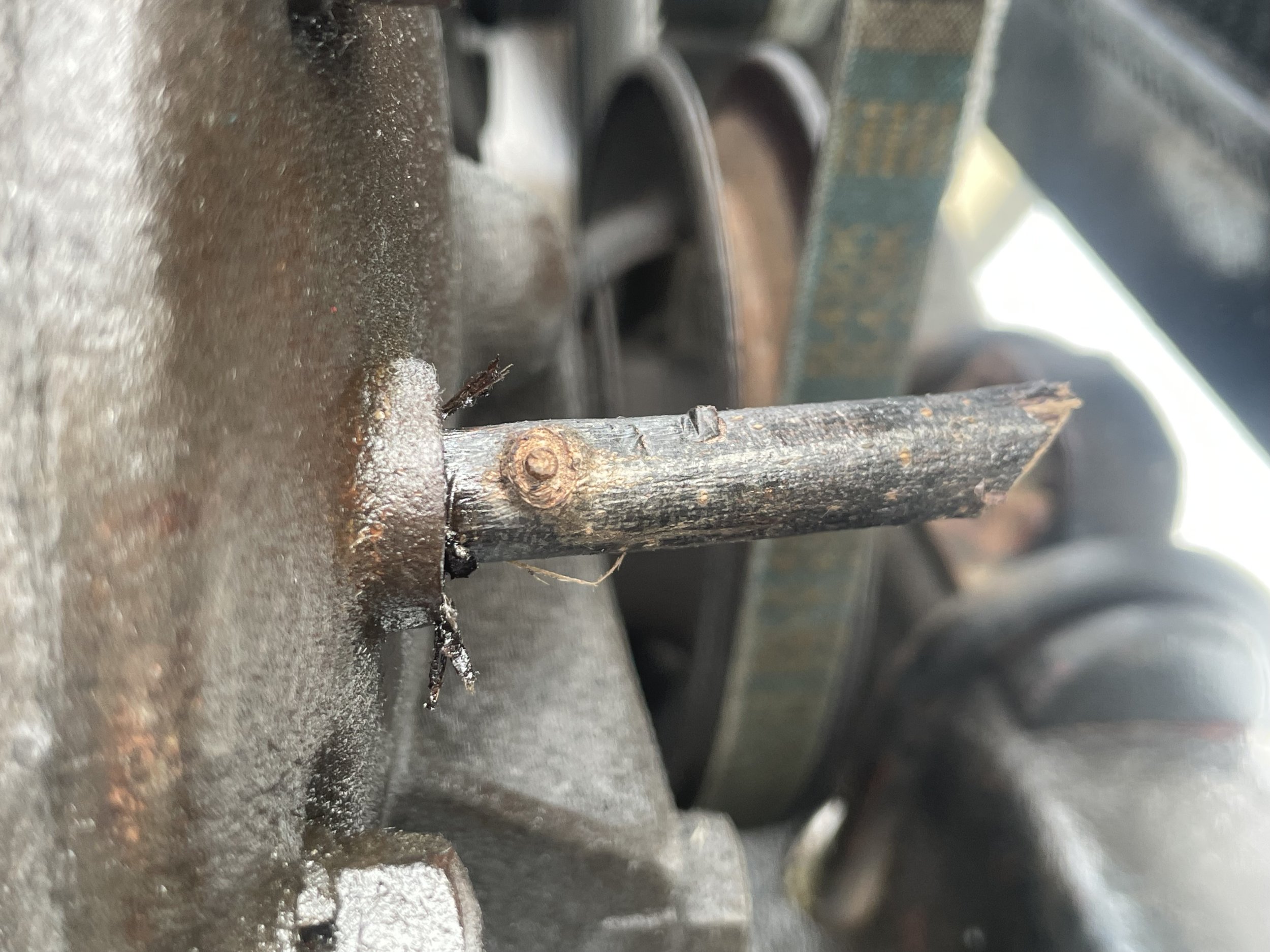

    We had to order a hose for a modern Volkswagen, which was only available at the VW dealer nearby. This is about a 10 mile highway run so I figured it would be a great opportunity to verify the head gasket took.
    I made the common Model A rookie error of forgetting to put the timing pin back in and about halfway there I suddenly had a windshield covered in oil. As I pulled over to a local 1950s diner to evaluate my options (how traditional!) I suddenly had the left rear brake lock up. Skidded to a dramatic stop and had to make some roadside repairs.
    Plugged the hole with a stick and moved on to the brake. We could not get the car to roll for ****. The service brake was hung up and won't retract, but I was able to dial the adjuster all the way back to get it freed up. It still doesn't work but I was able to complete the trip at highway speeds.

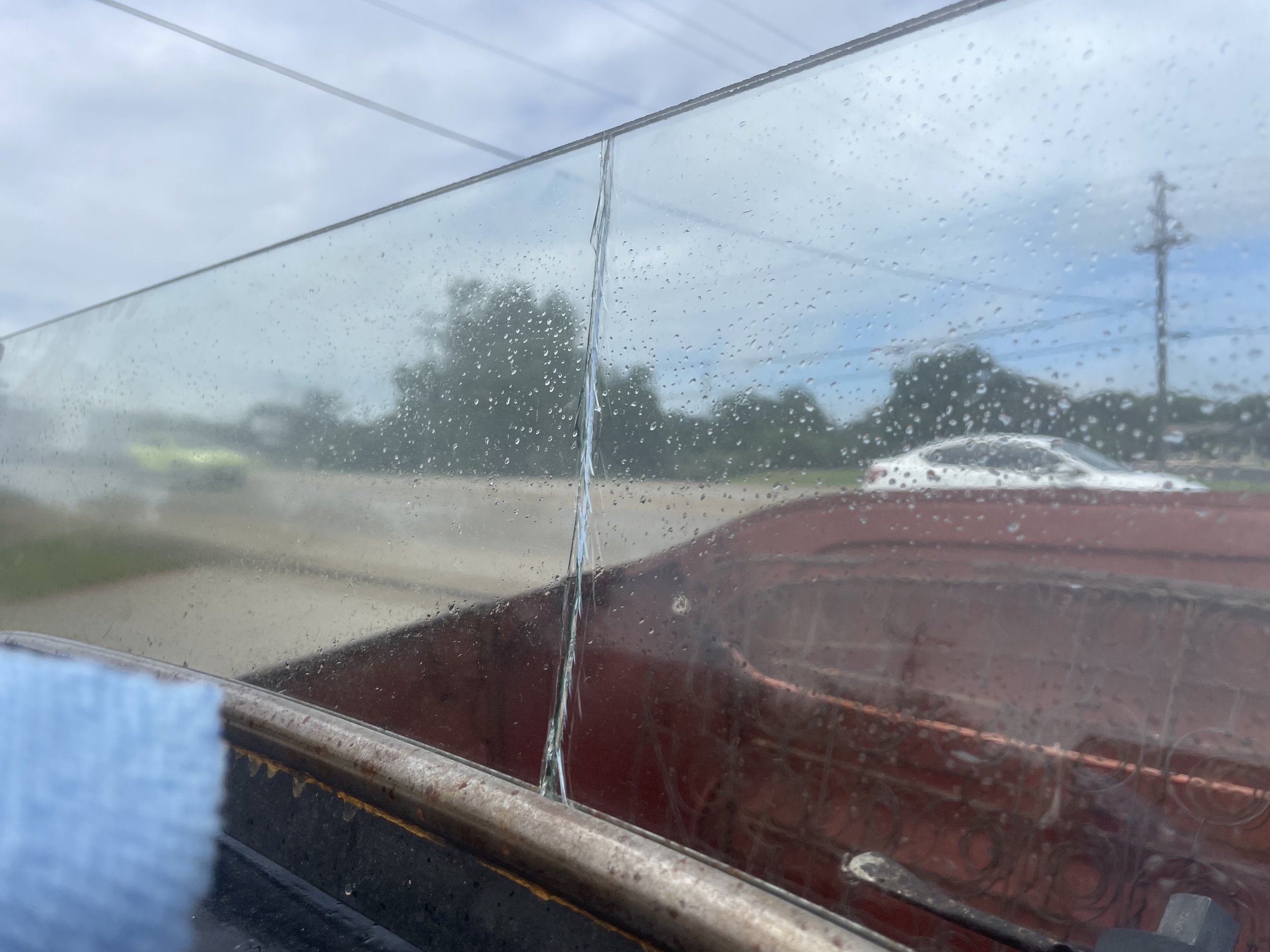

    Unfortunately while at the dealership, this happened!
    My boss slipped trying to get in the car and grabbed the windshield in a panic. We'll get that taken care of, but I'll probably need to beg @BigJoeArt for a new club plaque...

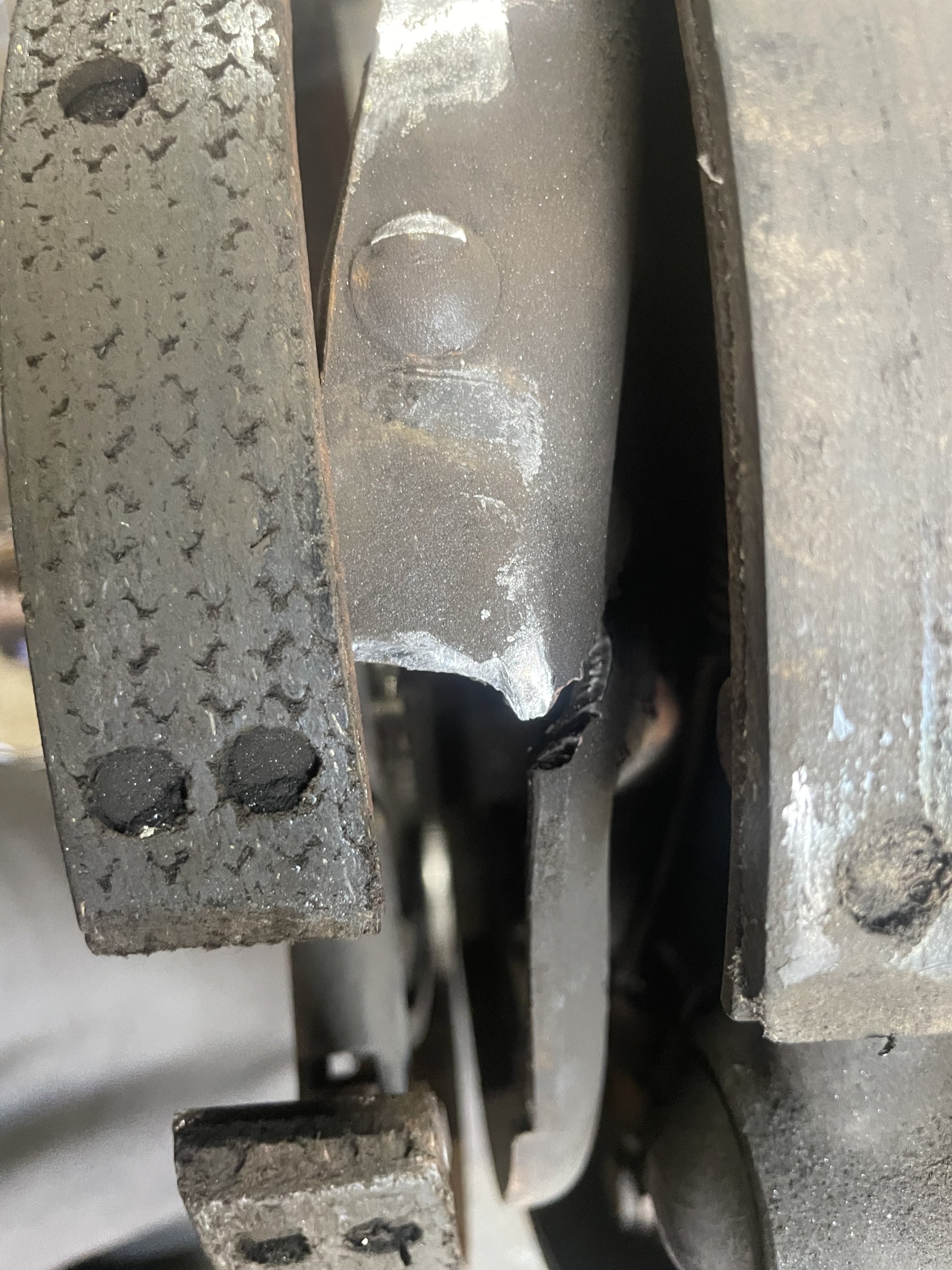

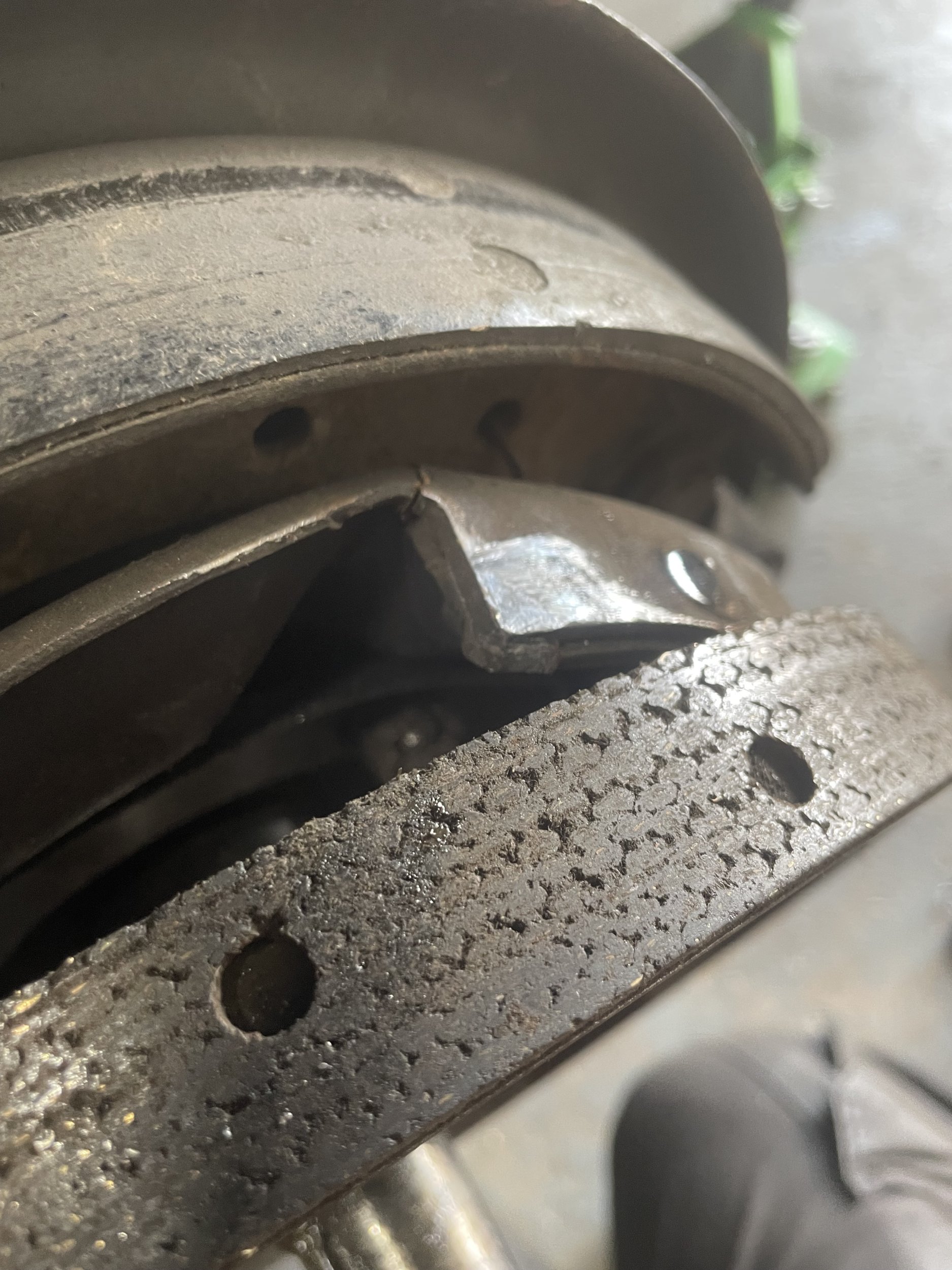

    Figured out why the brake locked on the way to Hudson Oaks.
    E-brake carrier exploded. Yikes. It's blown out enough that it contacts the drum even with the e brake shoes removed. Very very lucky we made it back to the shop. Before I pulled the drum off I used it to run to Autozone and back across the street. I figured since we completed the earlier trip without issue I'd be OK and could mess with it later. It locked on me at about 20 mph and spun me out. Imagine that happening at 60...

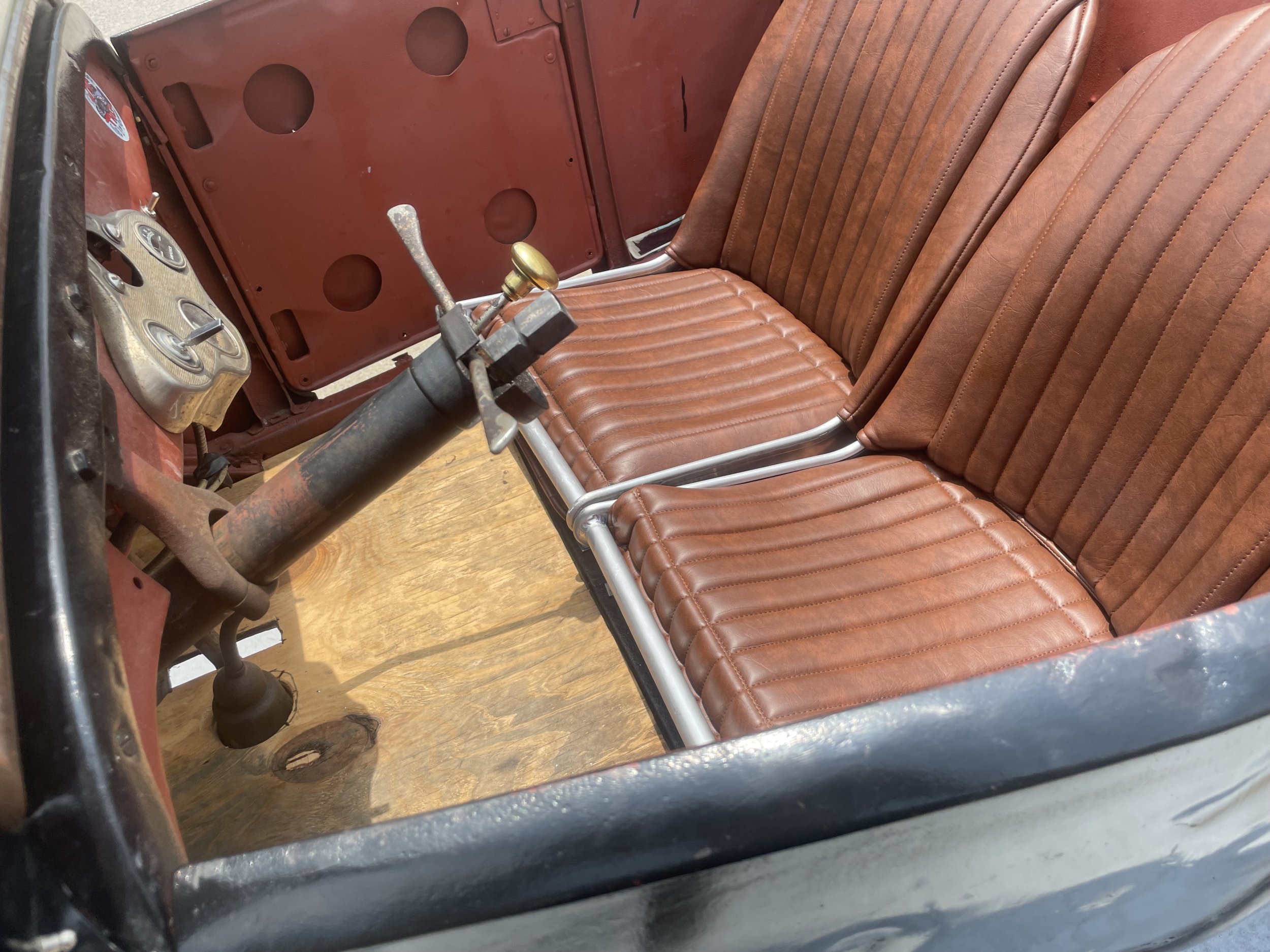

    The Ultra-Shield seats came in. Can't wait to start installing them tomorrow.

  20. MojoRacing
    Joined: Mar 24, 2013
    Posts: 150
    MojoRacing
    Wow! That's a pretty cool looking seat! I love the brown leather look, what color is that?
    trevorsworth likes this.
  21. trevorsworth
    Joined: Aug 3, 2020
    Posts: 2,046
    trevorsworth
    Oh man. Getcha some of that.
    Not bolted in yet, just sitting, have to fine tune everything. But man.
  22. MojoRacing
    Posts: 150
    MojoRacing
    They are perfect!!!
    RodStRace and trevorsworth like this.
  23. trevorsworth
    Joined: Aug 3, 2020
    Posts: 2,046
    trevorsworth
    Thanks! I almost missed your previous post. This is Ultra Shield's rawhide buckskin (medium brown). I was going to get them in red but the red doesn't have a leather texture and I felt the bright red, 50s diner seat look didn't suit the car.
    They are really nicely put together and weigh literally nothing. The two of them with the upholstered inserts weigh less than the bare bench spring frames I had in the car. Probably added 50 horsepower right there!!!
    Deutscher, Okie Pete, Jrs50 and 3 others like this.

  25. I’ve had a couple of handbrake carriers crack and tip the shoe into the drum. Had the hub puller with me the first time. Reversed home the second time…
