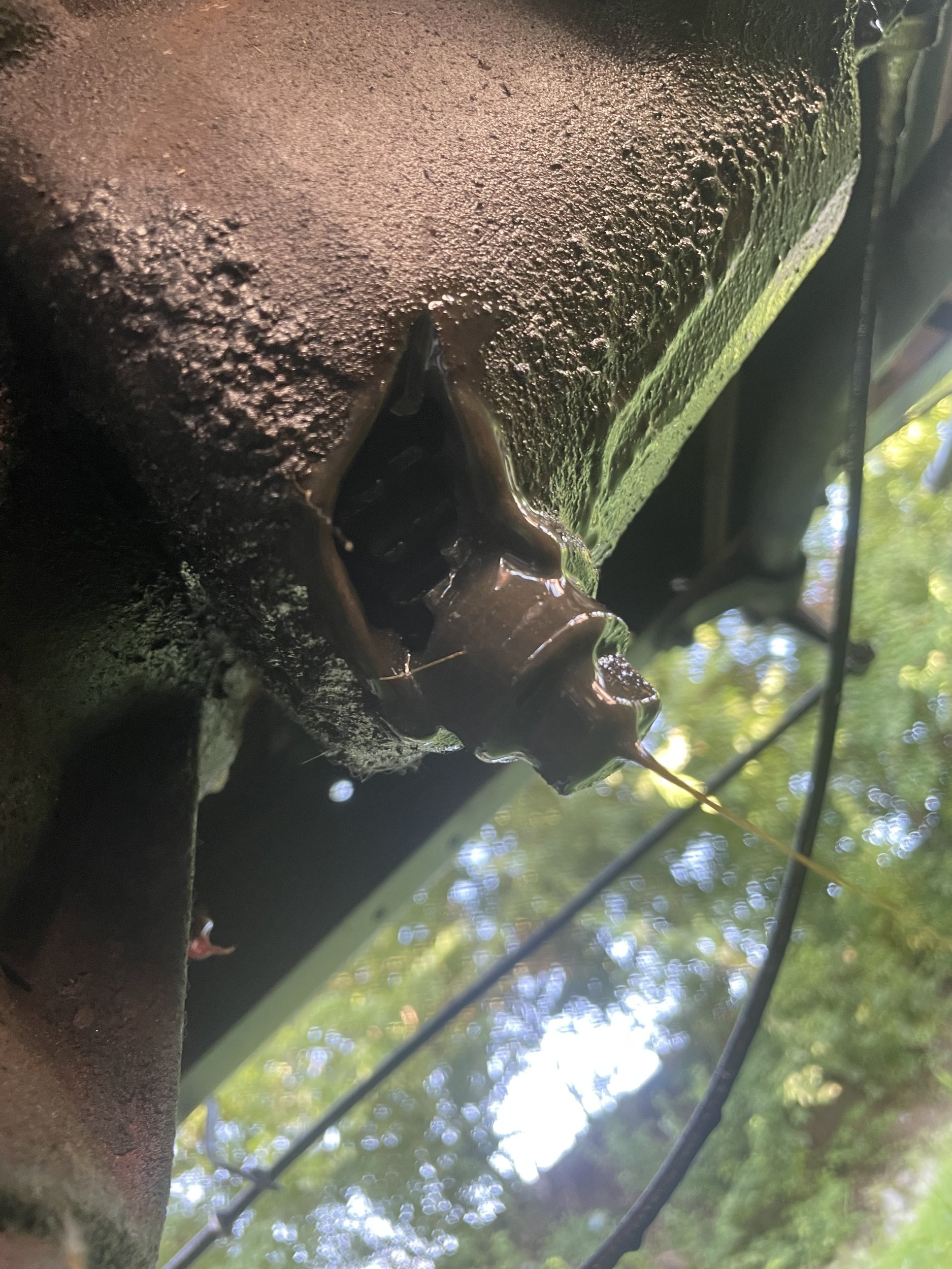

    Gained an inspection window this morning trying to pull it out of the garage. Lol

  5. RodStRace
    Joined: Dec 7, 2007
    Posts: 8,757
    RodStRace
    Those were built for little to no roads. How is it garage extraction caused that!?!
    Leaving extra parts under it?

    I’m gonna say the inside parts aren’t inside anymore @RodStRace

    trevorsworth
    Chunks from the broken 2nd gear falling into the reverse gear at the bottom of the case & binding up between the gear and the case wall is my guess.

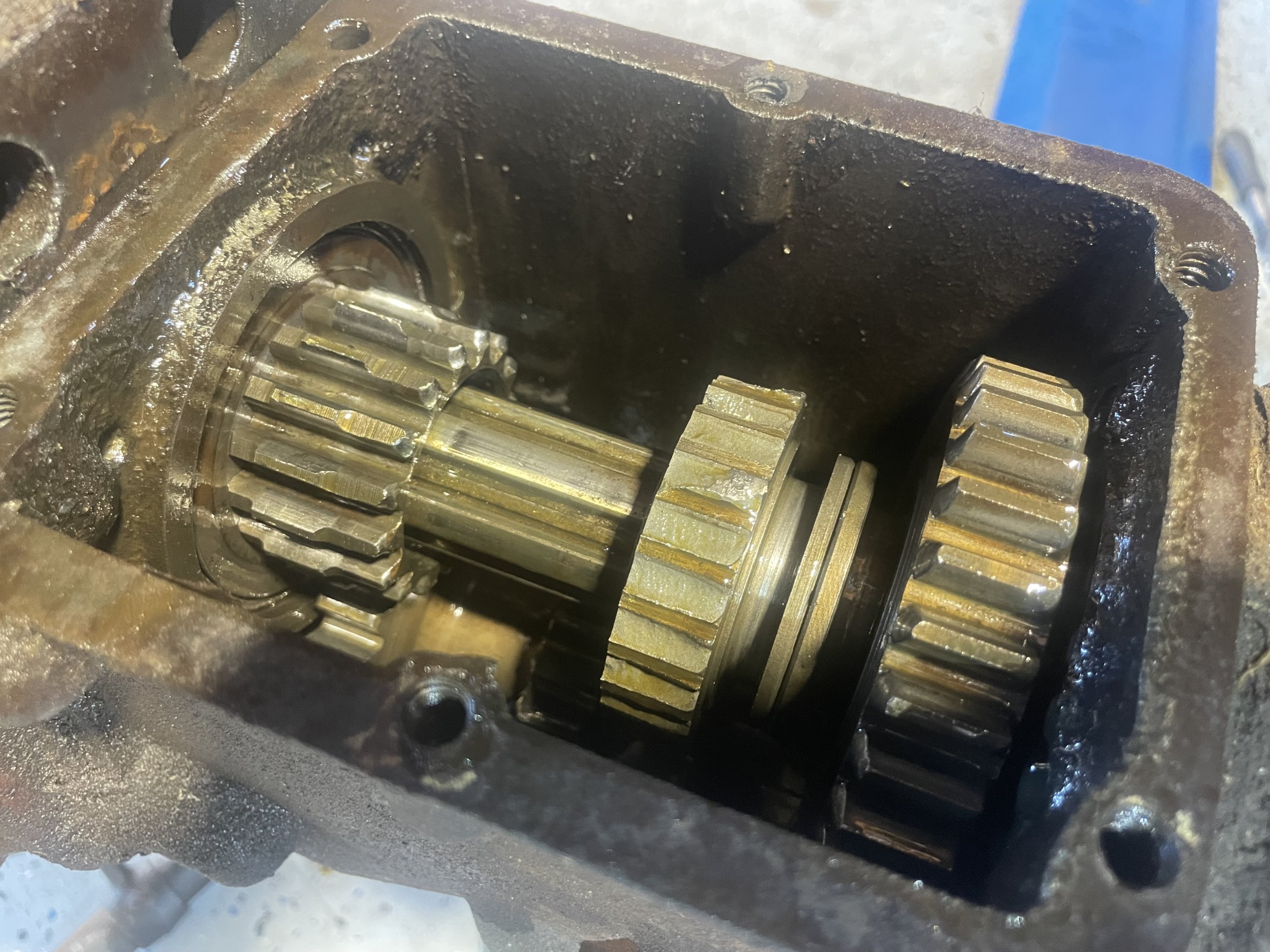

    Oh man... gear soup!!!

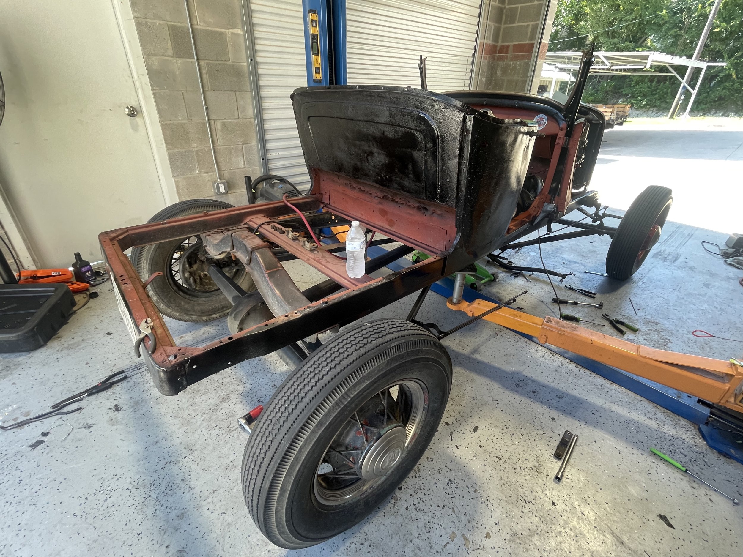

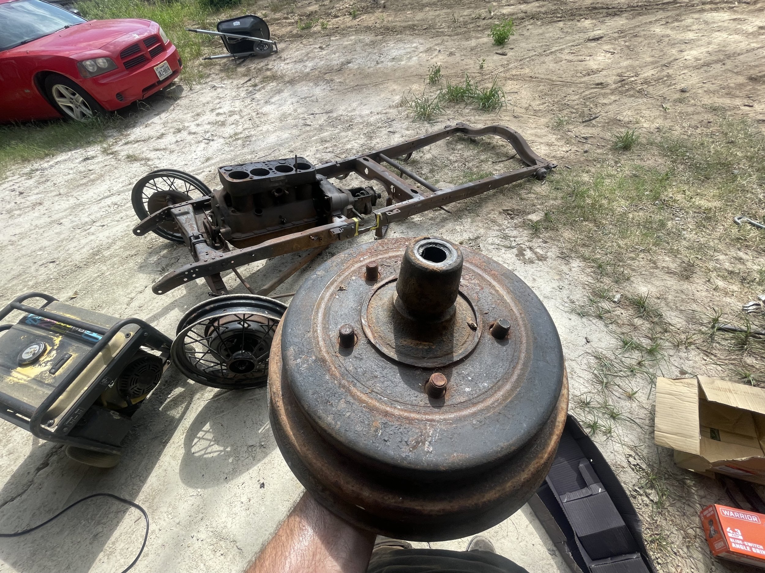

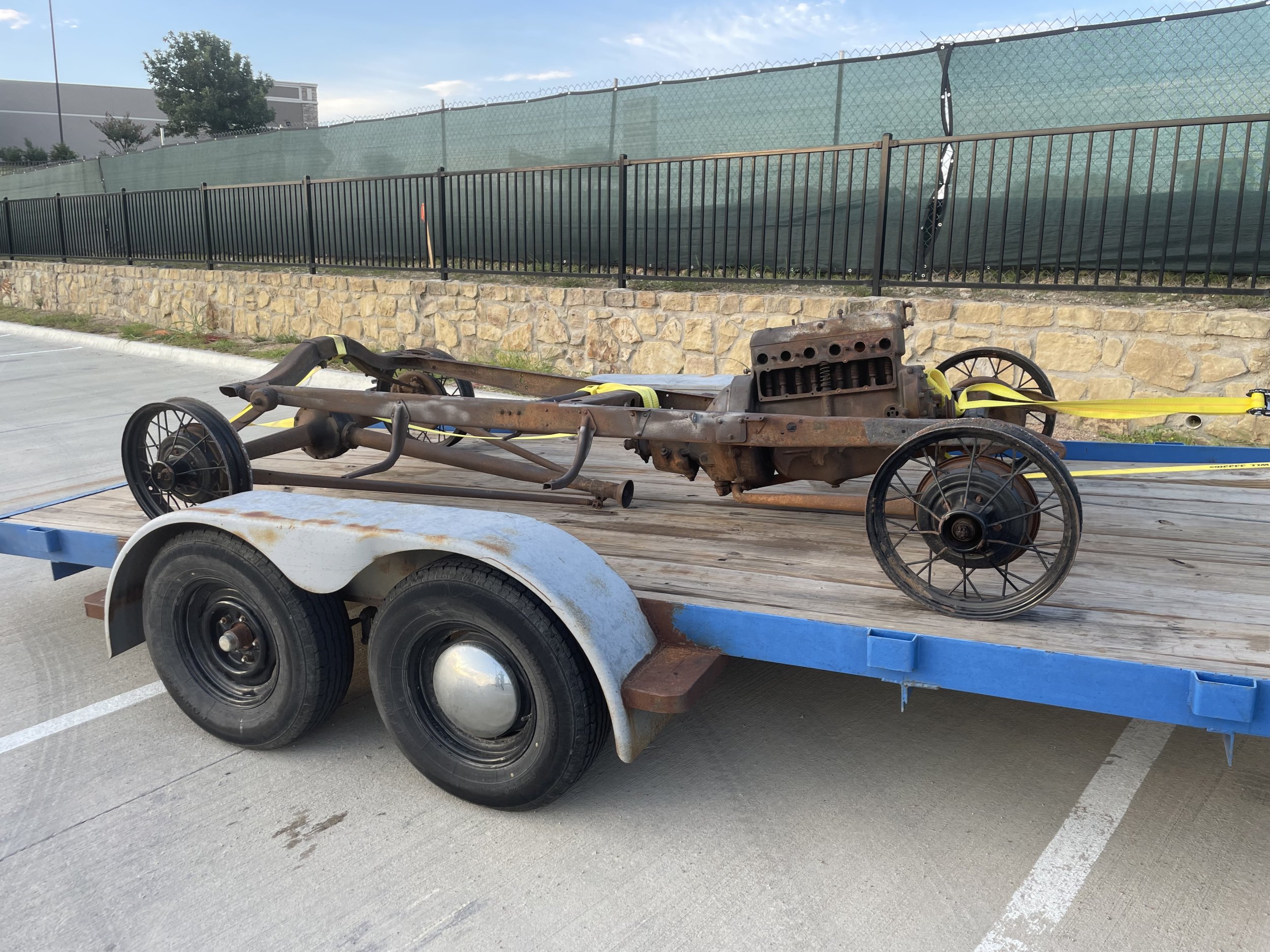

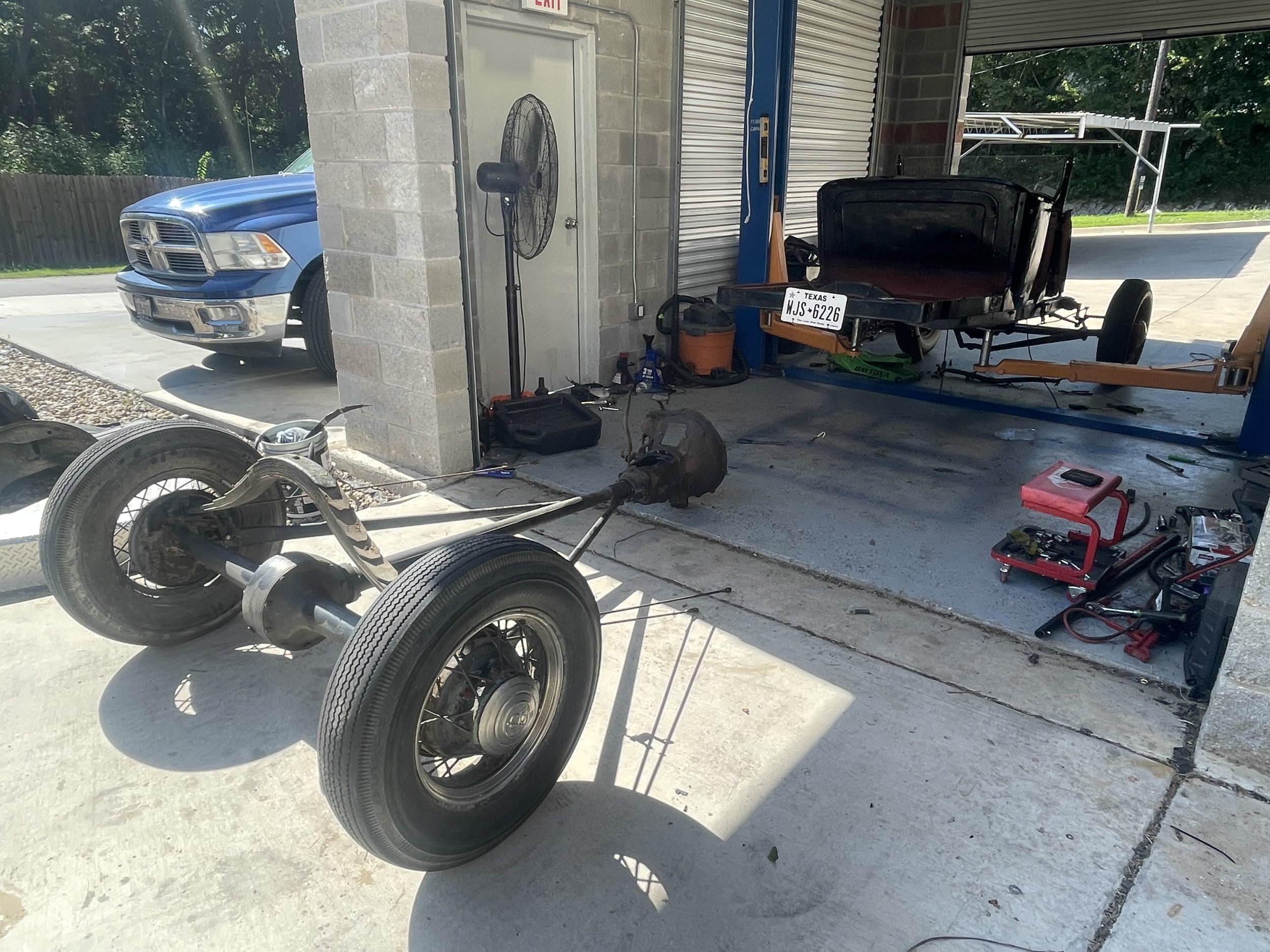

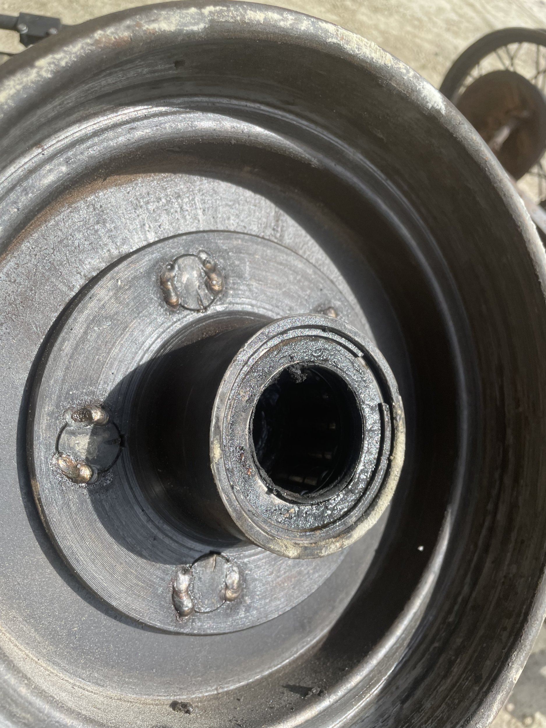

    Put out a feeler this morning to see if anyone had some drums (my rears have some bad studs) and a fellow HAMBer said he had some... but I had to take the ch***is they were on! Not bad for two benjamins, considering there is a lot here I can use. Engine & transmission aren't locked up and the rear end seems OK from what we can tell so far. The frame was twisted pretty bad up front but it has some usable parts - the crossmembers are in great shape, and the axle appears to be straight. I'll rob the wishbone ball swivel thing to put on the AA, since I had to steal the AA's to replace the one I broke on the T.
    Tomorrow Saul and I are going to start breaking it up and properly ***essing it.

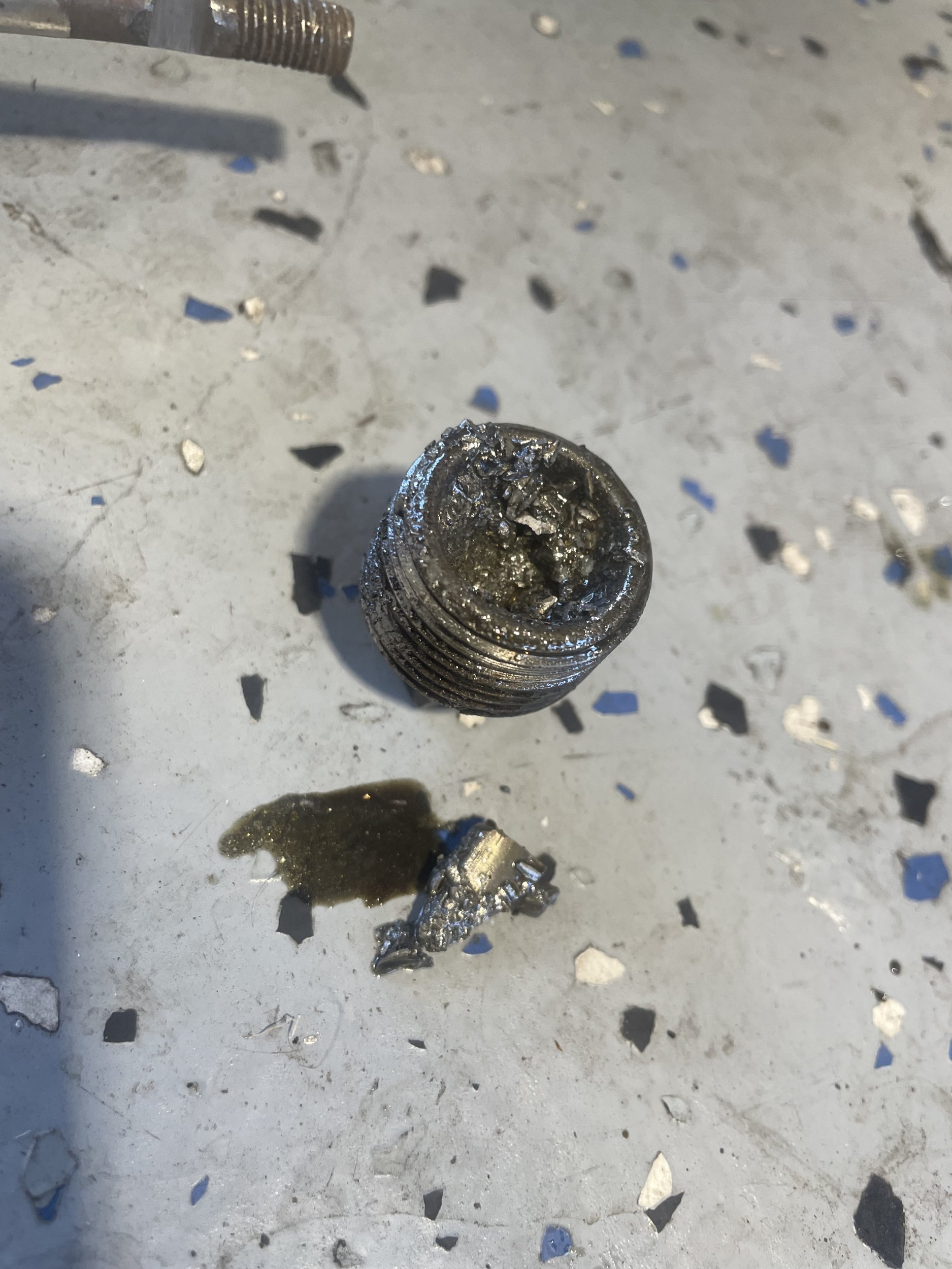

    Got what I needed. Looks like I'm not the only one who can't swage studs. Guess if it worked for that guy it will work for me. We'll clean this up and return it to service.

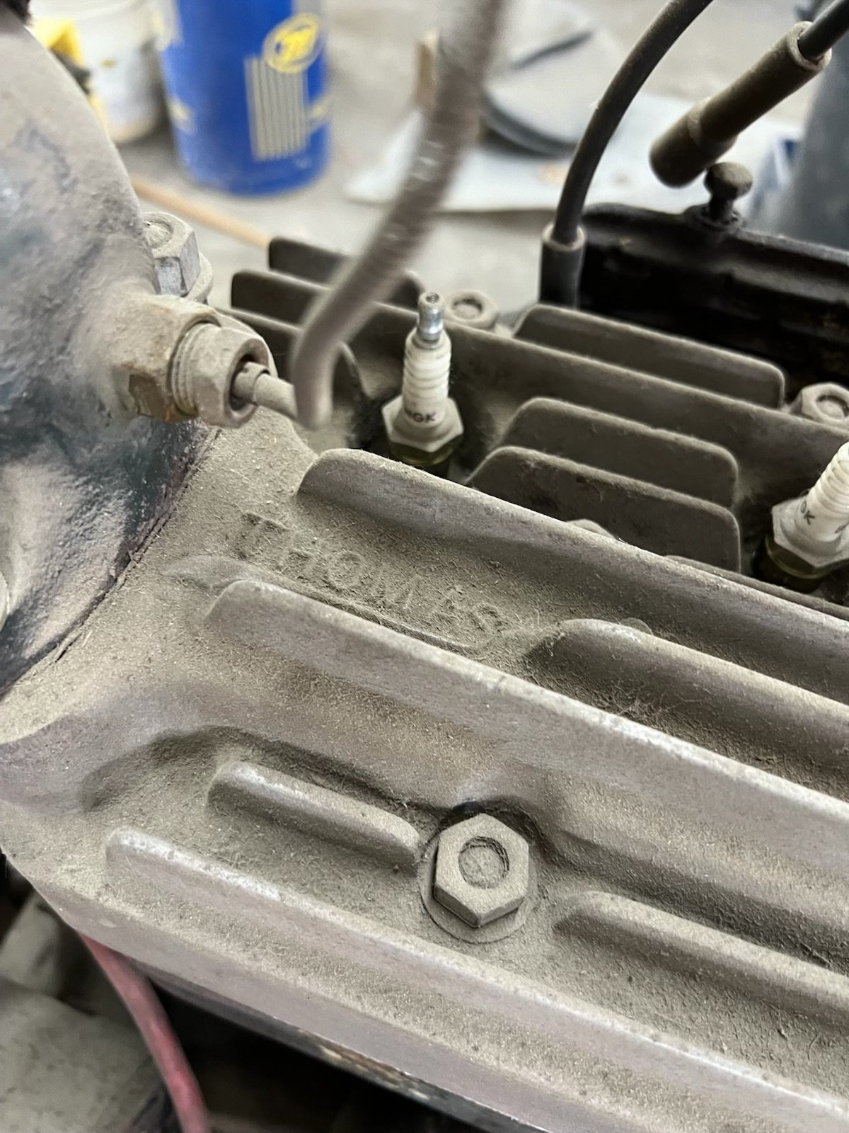

    As if I needed any more help breaking ****, I'll be installing a Thomas high compression head soon. Got a great deal from a friend on the head off this engine he picked up.
    I know there are some corrosion issues with aluminum heads on iron blocks. Something about an anode... Got some homework to do.

    I bought some zinc anodes from Amazon for cheap. Used for marine applications. Way cheaper than a “head saver” and the same thing pretty much. Also make sure your radiator is grounded. I ran into corrosion issues on my v8 from that

    How does that work? Just plonk em in there? Do they need to be grounded to something to work?
  26. Texas36
    Joined: Oct 20, 2012
    Posts: 502
    Texas36
    On mine I drilled a hole on one end and tied a piece of safety wire on it then hooked it over the outlet on the head. Once you put the radiator hose on and clamp it down it holds in place. This is on a v8 though so there may be some difference on a banger as I dont have much banger experience. The anode is sacrificial and mine was pretty chewed up after 3-ish years so they really do work

    You can get threaded ones like this and thread them into the water jacket
    https://boatzincs.com/e-0b/

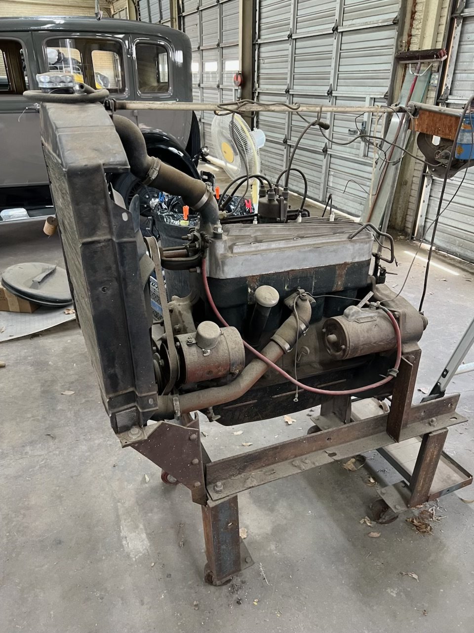

    We got the engine out & apart. It took some soaking to get it all the way freed up but it broke loose and spins over smoothly now. I have seen worse engines than this run. Crank thrust is good and the bearings feel fine, although there are no shims left. The cylinder walls are a little scored up but........ it's a Model A. It'd run if I asked it to. Maybe have my machinist bore it to .060 and put these NOS pistons I've had sitting around in it and it can be a backup.

    I would just make sure the bearings aren't breaking up.
