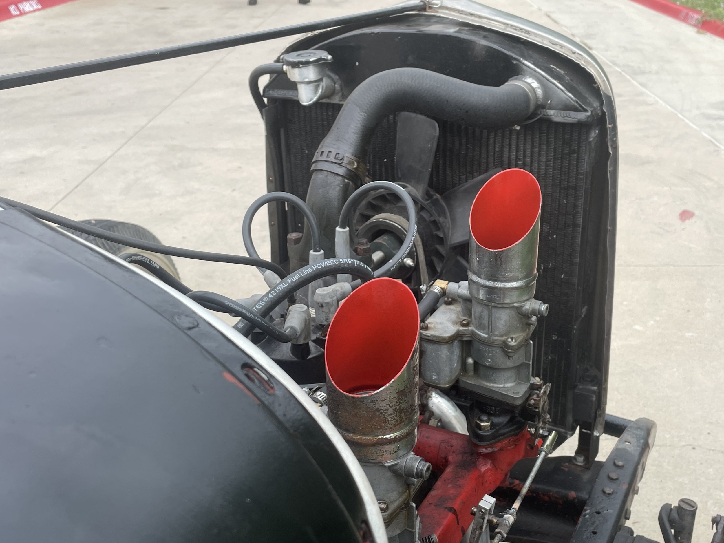

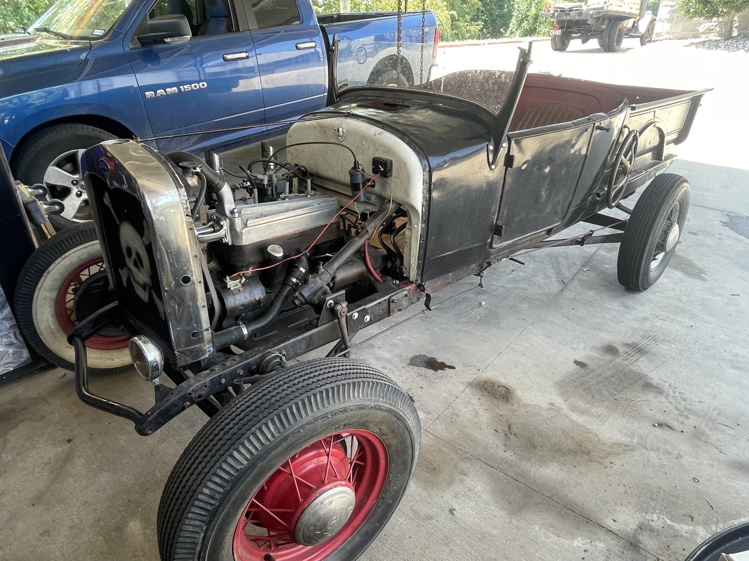

    Me and Saul knocked a few things out on the car today. Made a spreader bar out of a brake cross shaft and painted the insides of the air horns.
    We also did some electrical work. Item one was to add an electric solenoid for the starter. This removes the ****on from the firewall, which was easy to hit while braking. Item two was wiring up an old delco remy horn I found.
    For some reason the starter solenoid keeps trying to stick on, as if the contacts are welding closed, and I'm afraid it may have damaged the starter. Need to pull it off and check it out.

    you are using 12 v. on a 12v solenoid? not 6v?

    Yeah... basically I trusted a parts store monkey and I shouldn't have. Told him I needed a steal me solenoid. He knew what I was asking for. Said I wanted a good one because it would be in the weather. He said oh, I've got this mercury marine one that's waterproof. I said perfect (I'm thinking inboard engines). Box didn't have any specs on it, I figured he wouldn't have sold it to me if it couldn't handle a starter. I looked it up earlier after running into the problem. It can only handle 7 amps continuously and 30 amps momentarily. Blah

    Replaced the Mercruiser solenoid with a Ford one yesterday and everything's golden. Basically I just flipped the Model A starter ****on around 180 degrees which caused the screw post to be constantly in contact with the lug on the starter and ran a short cable from it over to the solenoid.

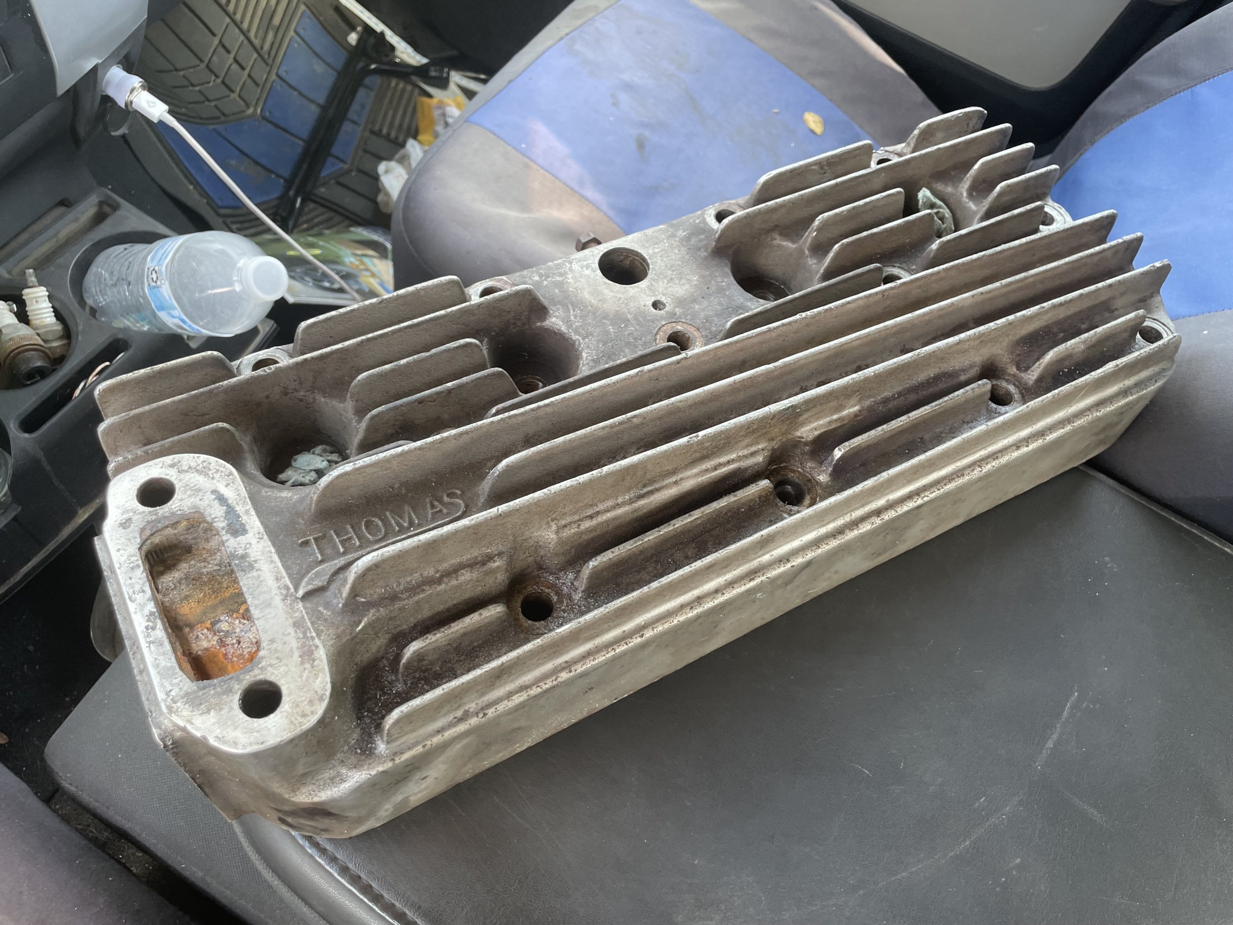

    Slight diversion- I'm sure I'm not the only one who is constantly gathering parts for future projects. I just got a Desoto 291 hemi. I don't think I want to put it in this car or in Sid's coupe, but it runs pretty good so I'll keep it in the back of the shop until the right body comes along.

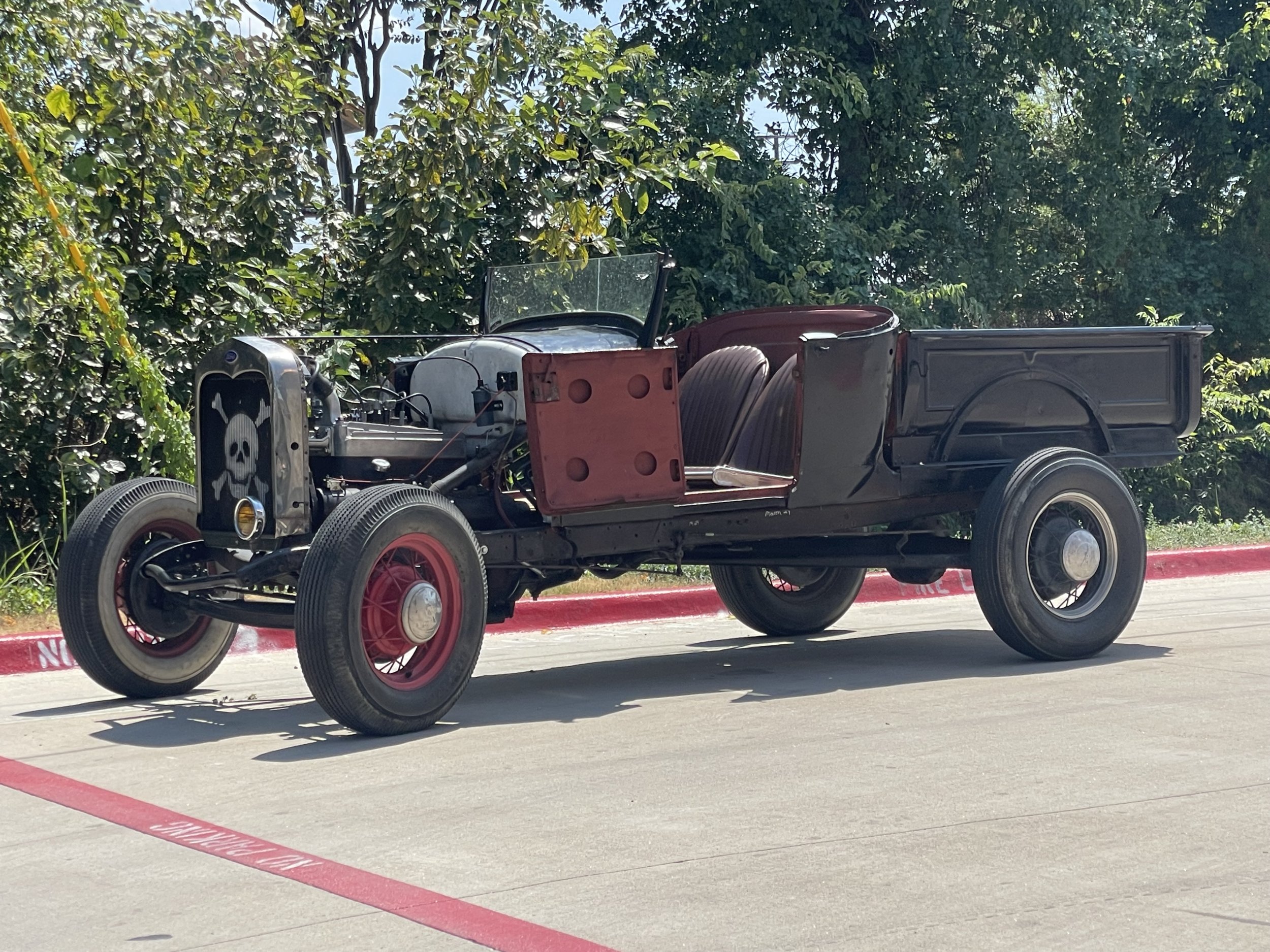

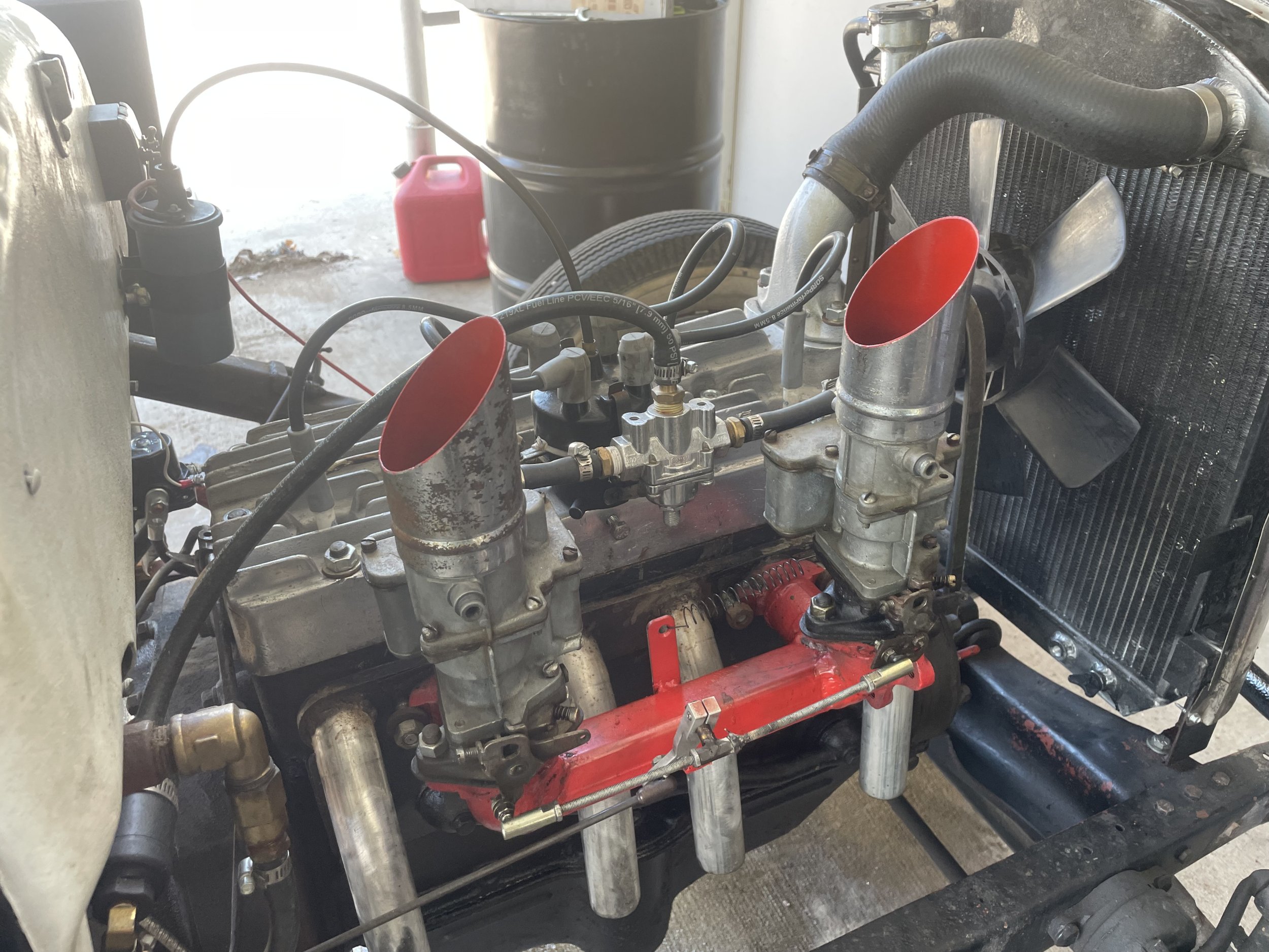

    Need to figure out the throttle linkage. It's too flexible.

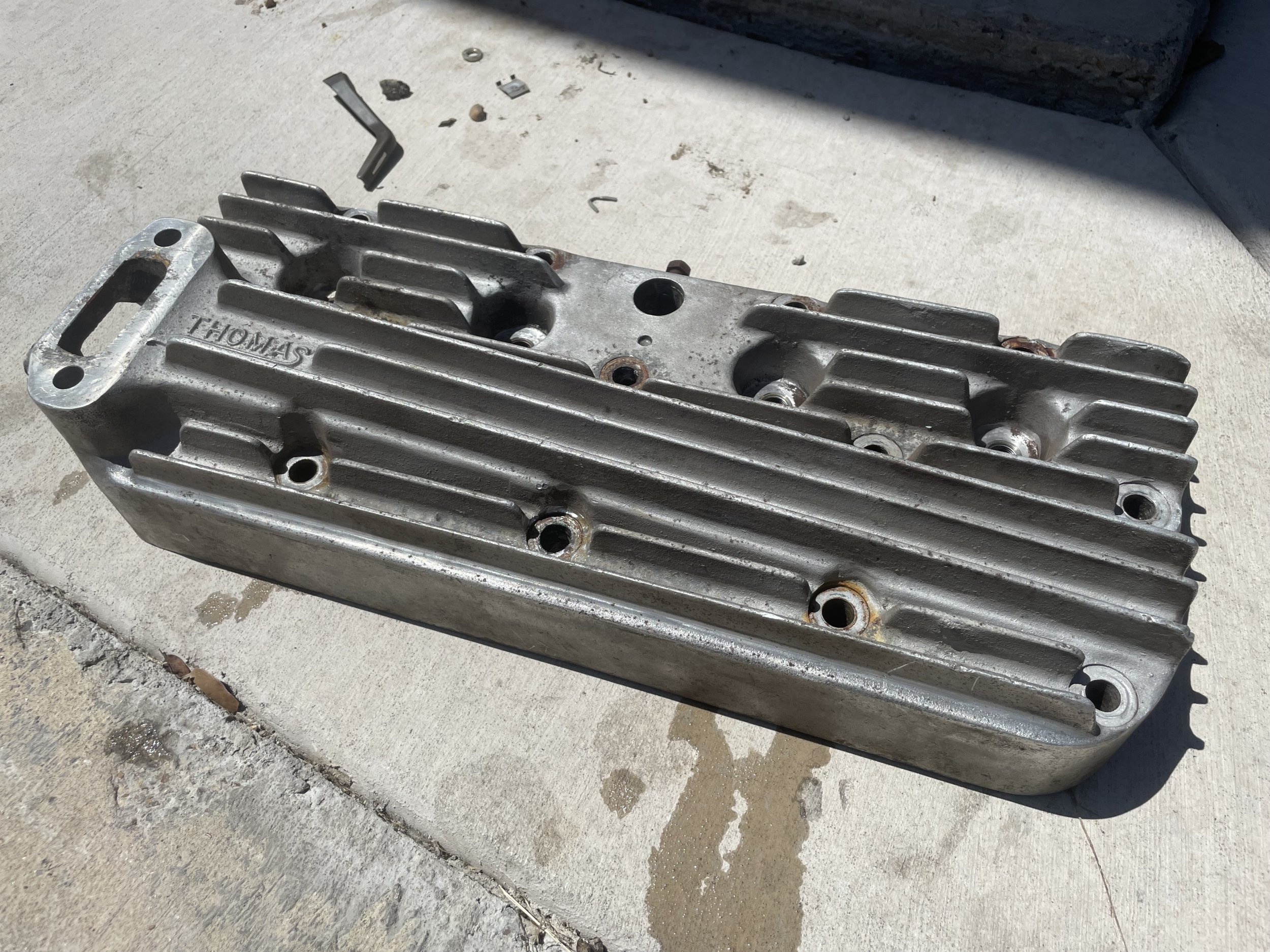

    I wanted to do a bunch of other stuff to it before putting the Thomas head on, but I learned it is not as high compression as I thought, so I'm not super worried about it. As an original head it is only about 7.5:1 unlike the later runs. I will still be incrementally upgrading the rest of the engine, of course... and this frees up the old head for my friend who needed a good one.
    It is super well behaved. Runs ****er smooth & ice cold. Soon I am taking the turtle deck to work so we can start trying to finish it up.

    High compression head on an A engine is the single best thing one can do to them in my opinion! Makes EVERYTHING about them better.

    The torque bump is incredibly noticeable. It pulls hard in third and does not bog at all. What really surprised me was how quiet it got & how much smoother it runs... like, balance a nickel on the head smooth...
