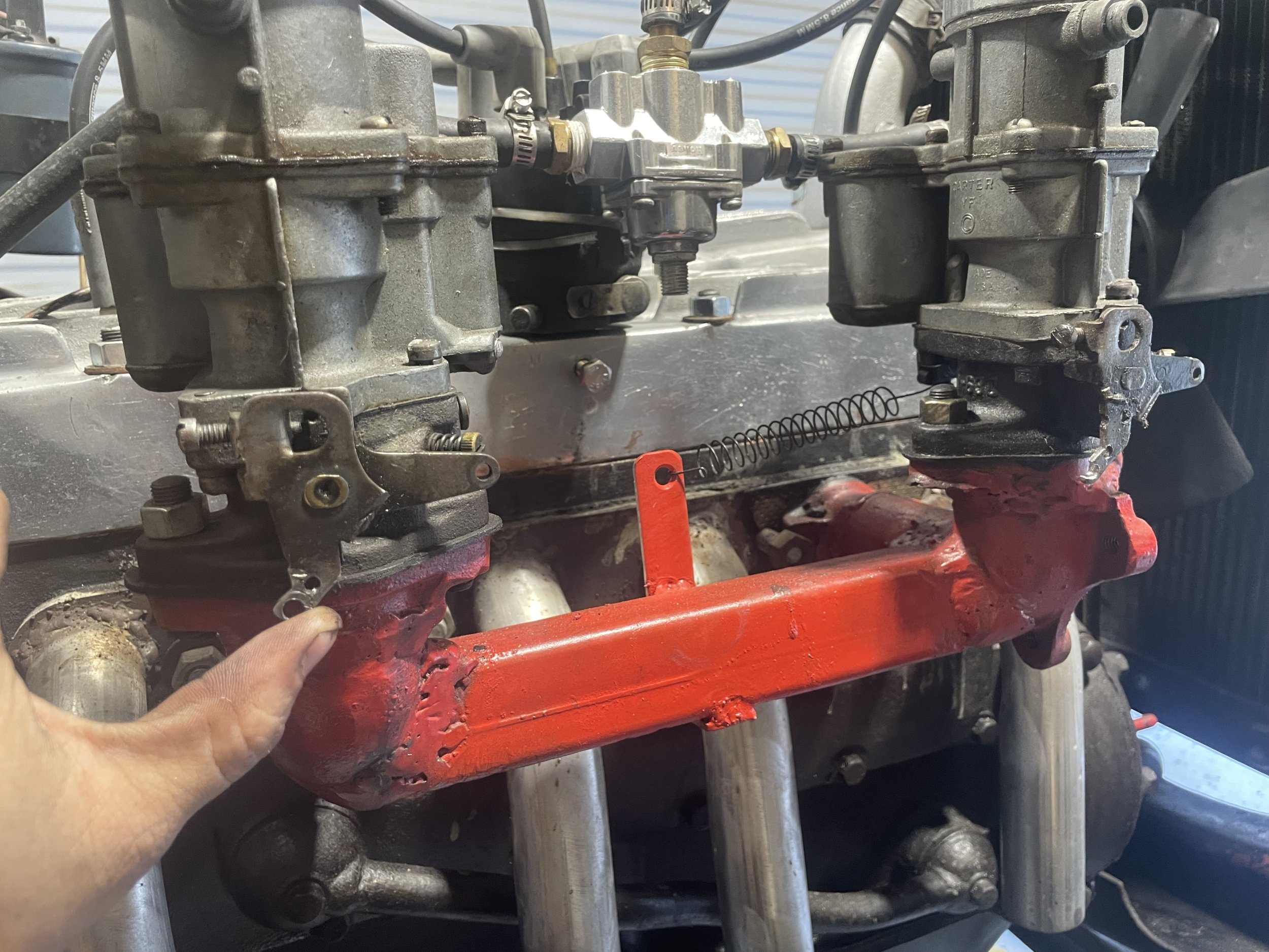

    Throttle linkage broke again today. :confused: I was getting ready for a cruise in and it wasn't having it. Spent a couple hours and 3 trips to the hardware store to try to come up with something stronger but no dice. We pulled the tarp off the AA and drove it up there just 'cuz so didn't miss out but it was a bummer not getting to bring the hot rod.
    This is what I had before, I booger welded it (don't judge, I loaned my machine and got it back with no tip) last time it broke but it just broke in front of the weld.
    This linkage ****ed, it worked but it had too many pivot points and the little arm that hangs down, when you hit the gas, wanted to flip sideways before it started opening the throttle and eventually that bends the allthread and it breaks from fatigue.
    Obviously I need some kind of pivot attached to the manifold but I have no idea how to start designing this. Any clues would help...
    I thought about just tying the two together and using a cable to open one but I don't like cables.

    You need to have it setup to pull, not push, to open one carb and a rod connecting the 2 carbs that will then pull the other carb open at the same time with spring return
    Texas36, trevorsworth and RMONTY like this.

    That intake is ugly AF....pull that thing off of there next time you come over and we will make it look good. I dont have anything useful for the throttle linkage dilemma, but Mr. Stevens makes a good point. Pulling is way less stressful than pushing. Hard to achieve without breaking your rule about having everything old school, kinda like that bad*** quick connect/release steering wheel from the turn of the century, just not sure which century it is from! :confused:

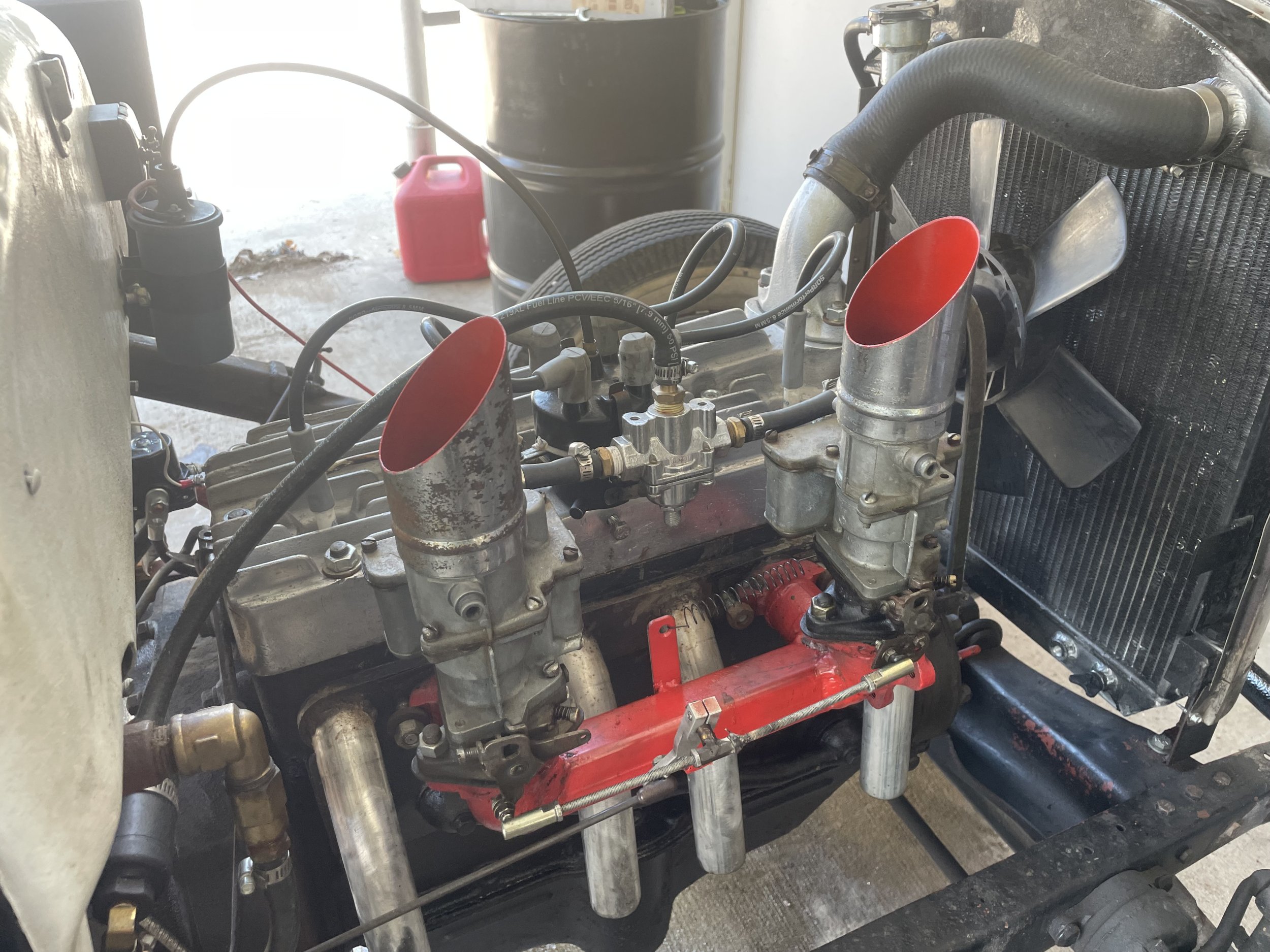

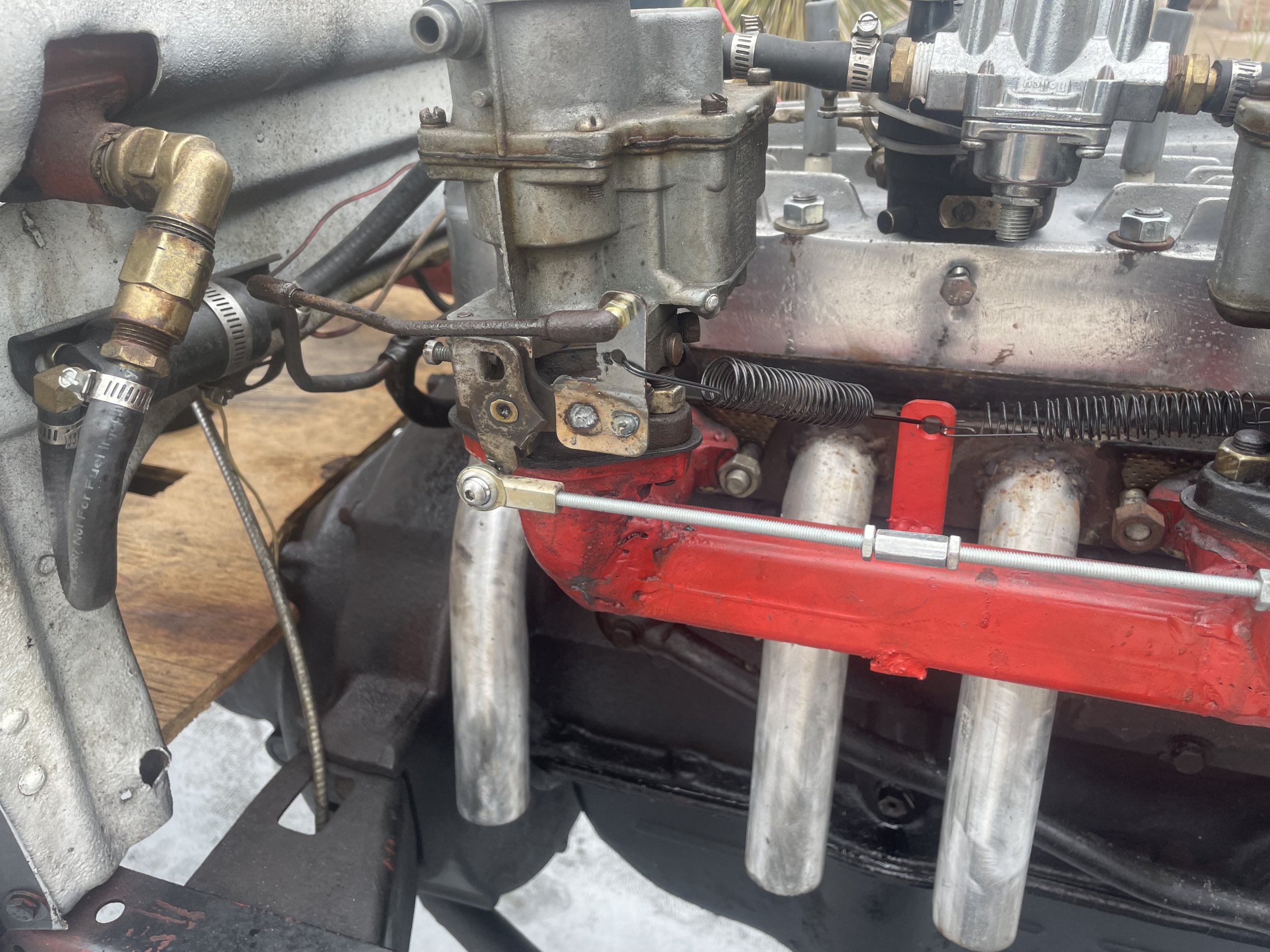

    Heated & bent the throttle arm to invert it (so it would push rather than pull). Bent up the linkage that used to run from the hand throttle to the throttle control and connected it to a plate I made & attached to the linkage on the rear carburetor. I need to fine tune the linkage between the carbs and find a more elegant solution for the springs, that's just what I had sitting around, but it works wonderfully and looks slicker than what I had.

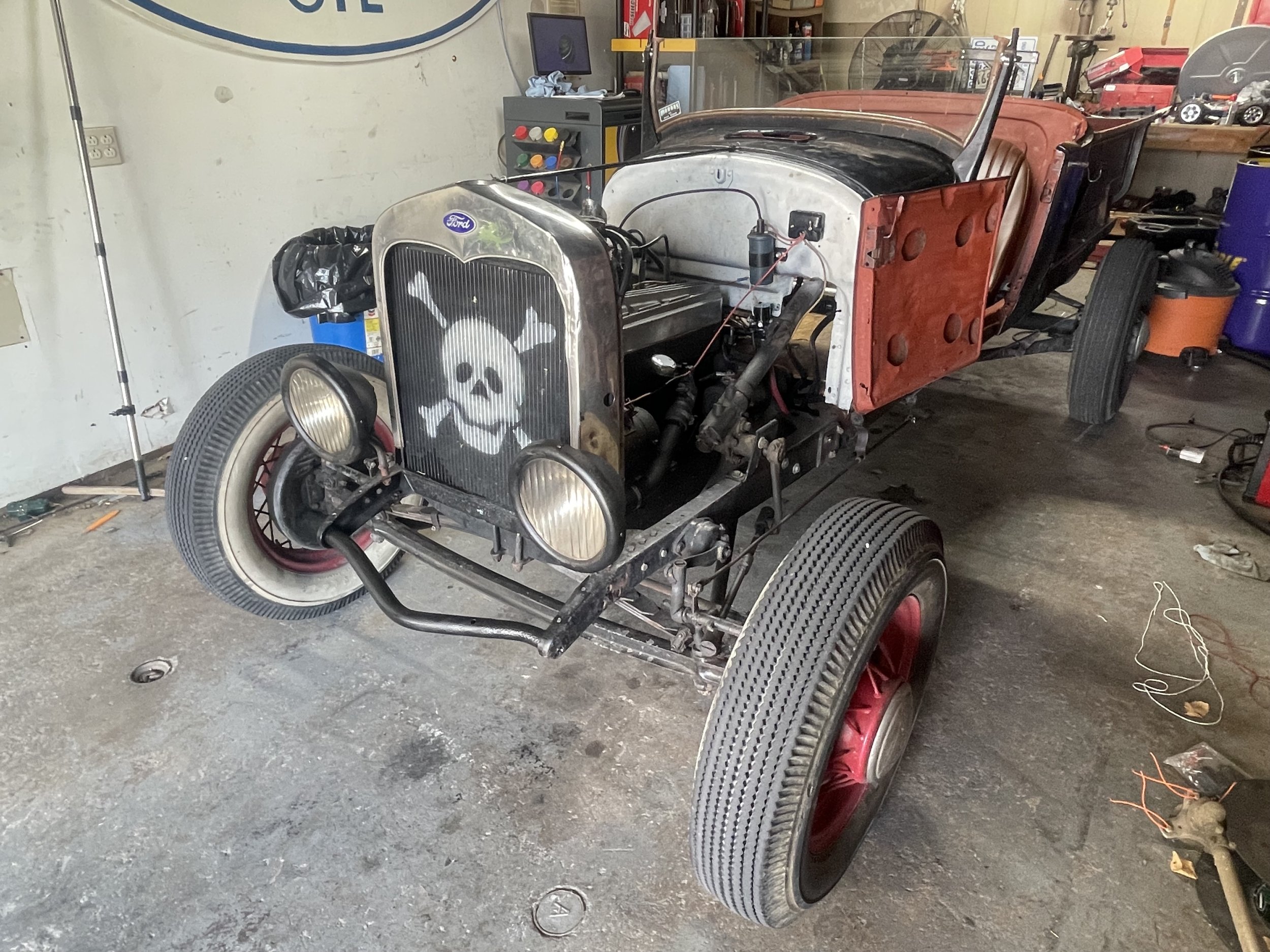

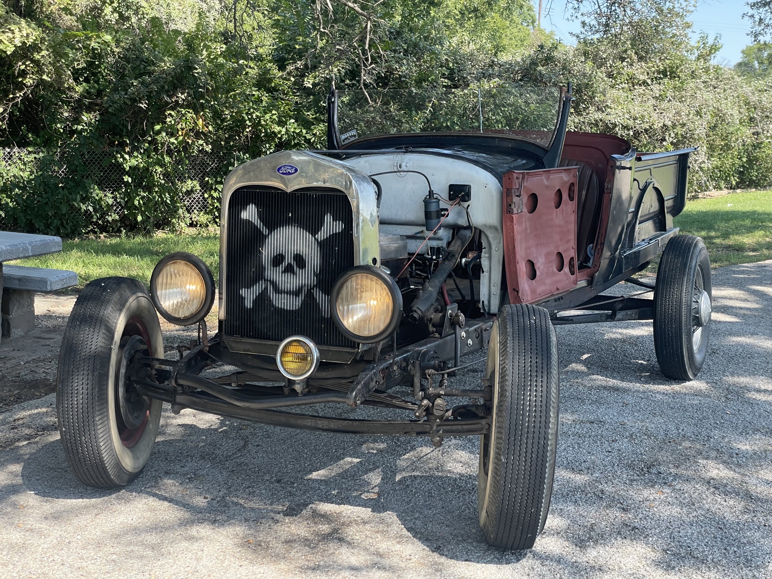

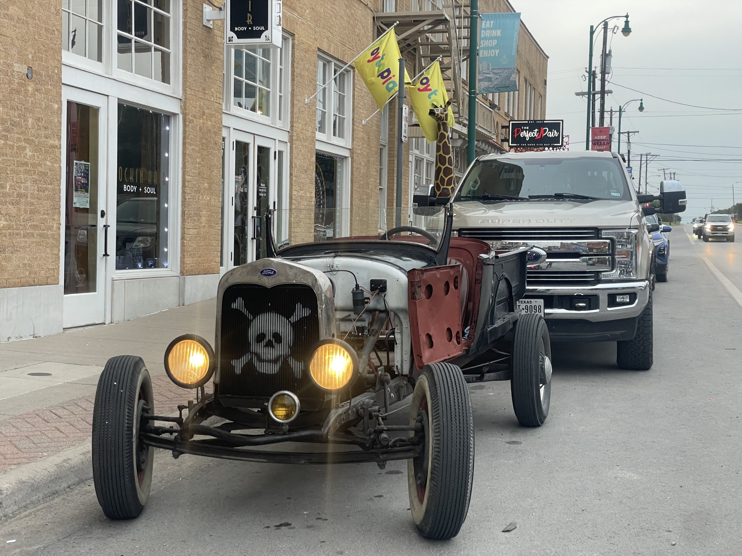

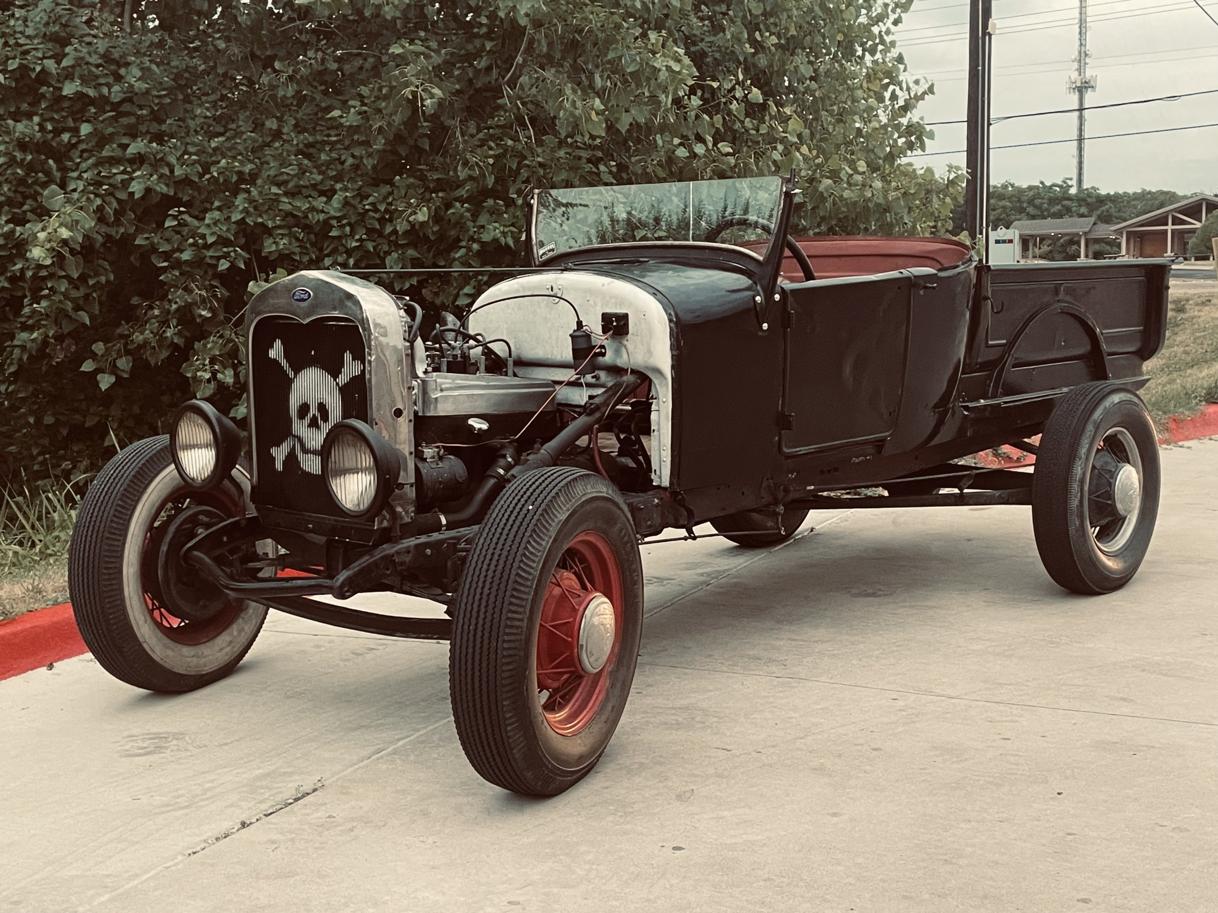

    Starting to experiment with headlights.
    Okie Pete, Deutscher, Tim and 6 others like this.

    I'm liking it...
    Debating on pulling the bed again to fix the sagging, since I'm working on the turtle deck and might have it ready to go on soon. Decisions decisions...
    Dannerr, Okie Pete, Outback and 7 others like this.

    Headlights are killer! In my opinion they fit right in with the build!
    trevorsworth likes this.

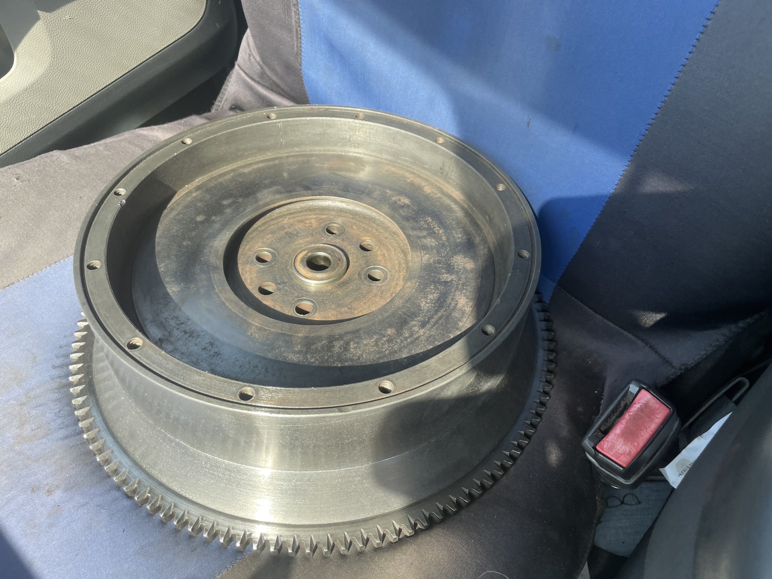

    Also got the flywheel back. 42 lbs, down from 63, and balanced. Not bad but I should have bought a Burtz flywheel for what it cost. Oh well. The Burtz would have had some "hidden fees" with other stuff I'd have had to buy for it.
    Okie Pete, Deutscher, Outback and 5 others like this.

    I coulda ground 21lbs off that flywheel with as many flap disks of mine that you've burned through since I've been helping you work on stuff!! They are cheap on Amazon! ;) It'll be interesting how much more giddy-up it's gonna have!
    alanp561, trevorsworth and patsurf like this.

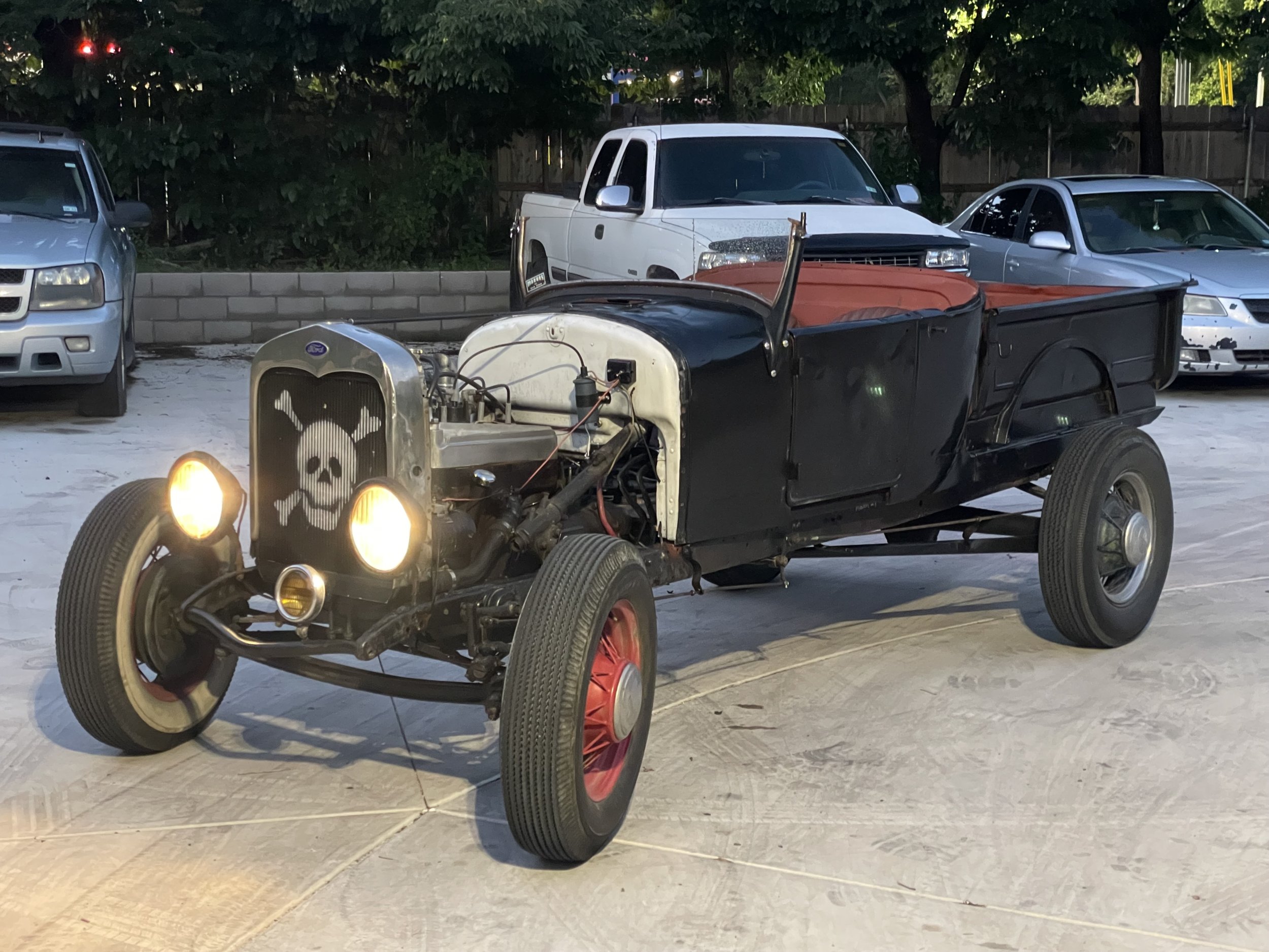

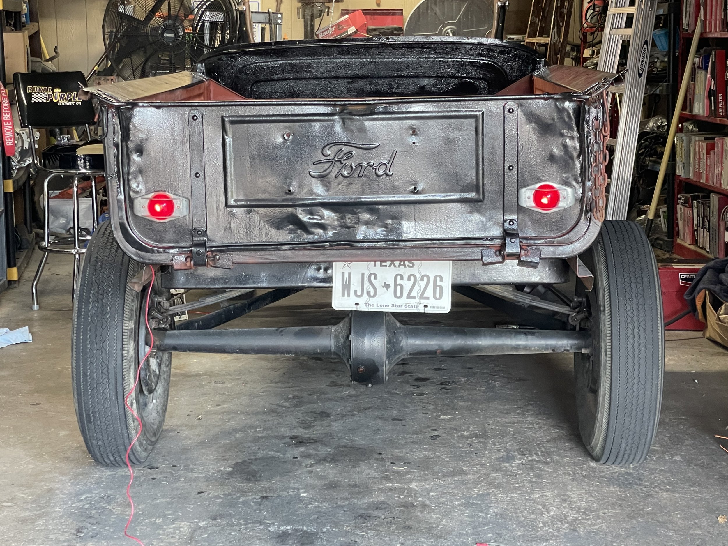

    Got caught in the dark the other day which ****ed, so I figured I'd quit kicking the can down the road and make the lights work.

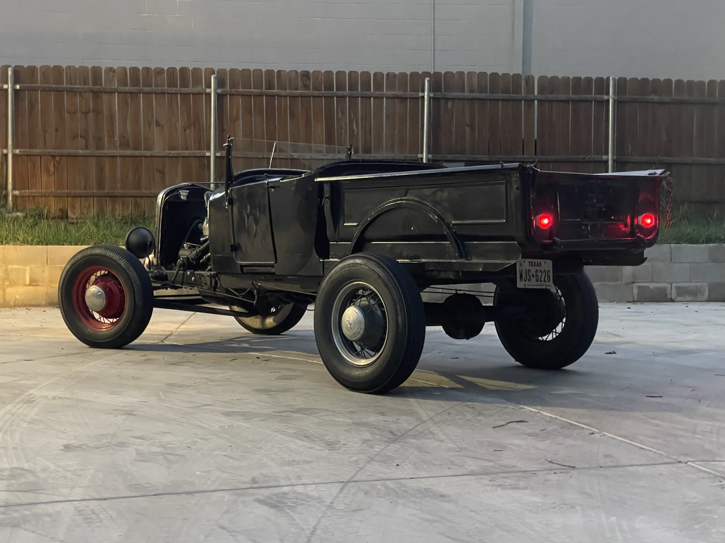

    Finally converted the tail lights to dual filament sockets and Saul got everything wired up for me.

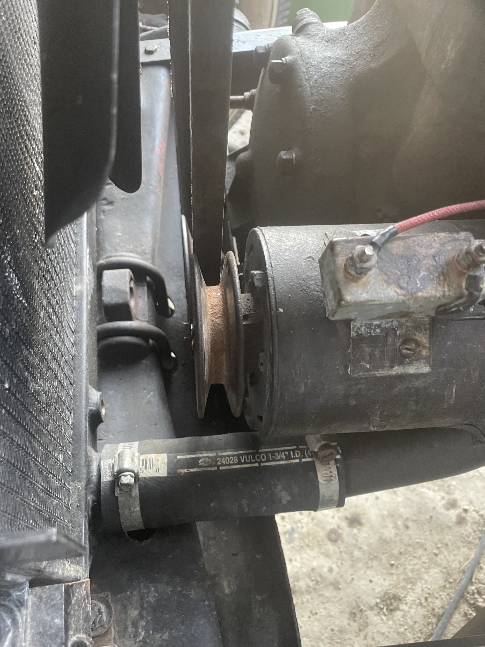

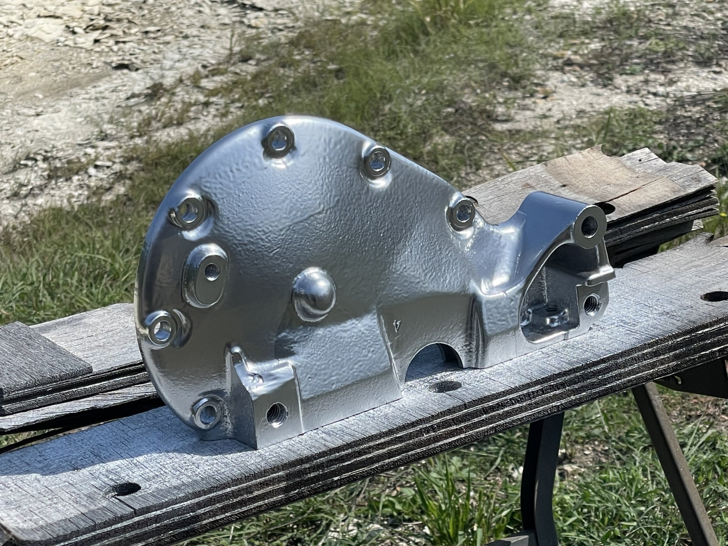

    She started running rough on me. The distributor hold down bolt was tapped directly into the aluminum. I had been going very easy on that bolt because the threads already felt kinda bad & I didn't want to strip it but I did notice it had gotten loose so I tightened it up and the engine resumed running fine only to start running rough again a little while later; threads are jacked, can't tighten the bolt, need to helicoil it.
    That's as good a reason as any to swap the B distributor in, which requires me to change the timing cover.
    A while back my friend George found this B cover in his stash and told me to come get it; it was pretty rusty. Here it is ready to install.

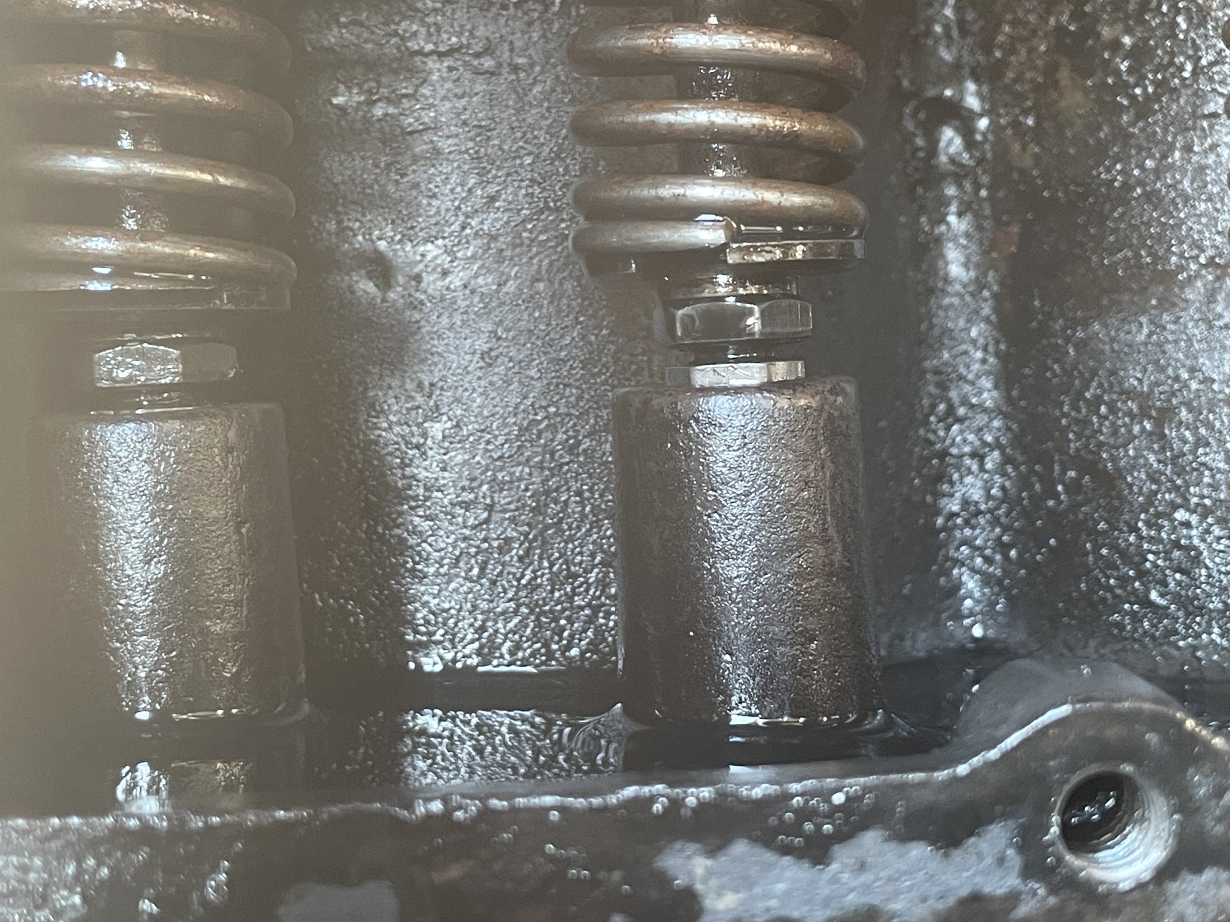

    Putting the B distributor in required me to remove the valve cover to get the Nu Rex timing gizmo out. I have been thinking about putting adjustable lifters in here for a while but I didn't really want to dig into this engine deep enough to do it. Well, somehow up til now I never noticed that it already has adjustable lifters, or if I did ever notice I have since forgotten.
    This was also a good time to replace the broken generator pulley.
    When I removed the old timing cover, the corresponding section of the oil pan gasket came with it, so I went to various parts stores in search of cork to patch that area with and by the time I found some, it was too dark to continue. Hopefully we will be in business tomorrow.
