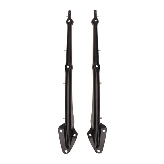

    Got a little excited, got windshield posts and a frame on the way.
    I was gonna just order the chopped ones from Speedway - but I learned that I wouldn't be able to run a top with those as they are missing the little finials at the tops of the posts, which the top hooks onto in the front. So I got unchopped ones and we will figure out how to chop them ourselves in a way that we can keep the finials.
    This is important, because I also got a super nice original top frame we will have to figure out how to chop. ;)

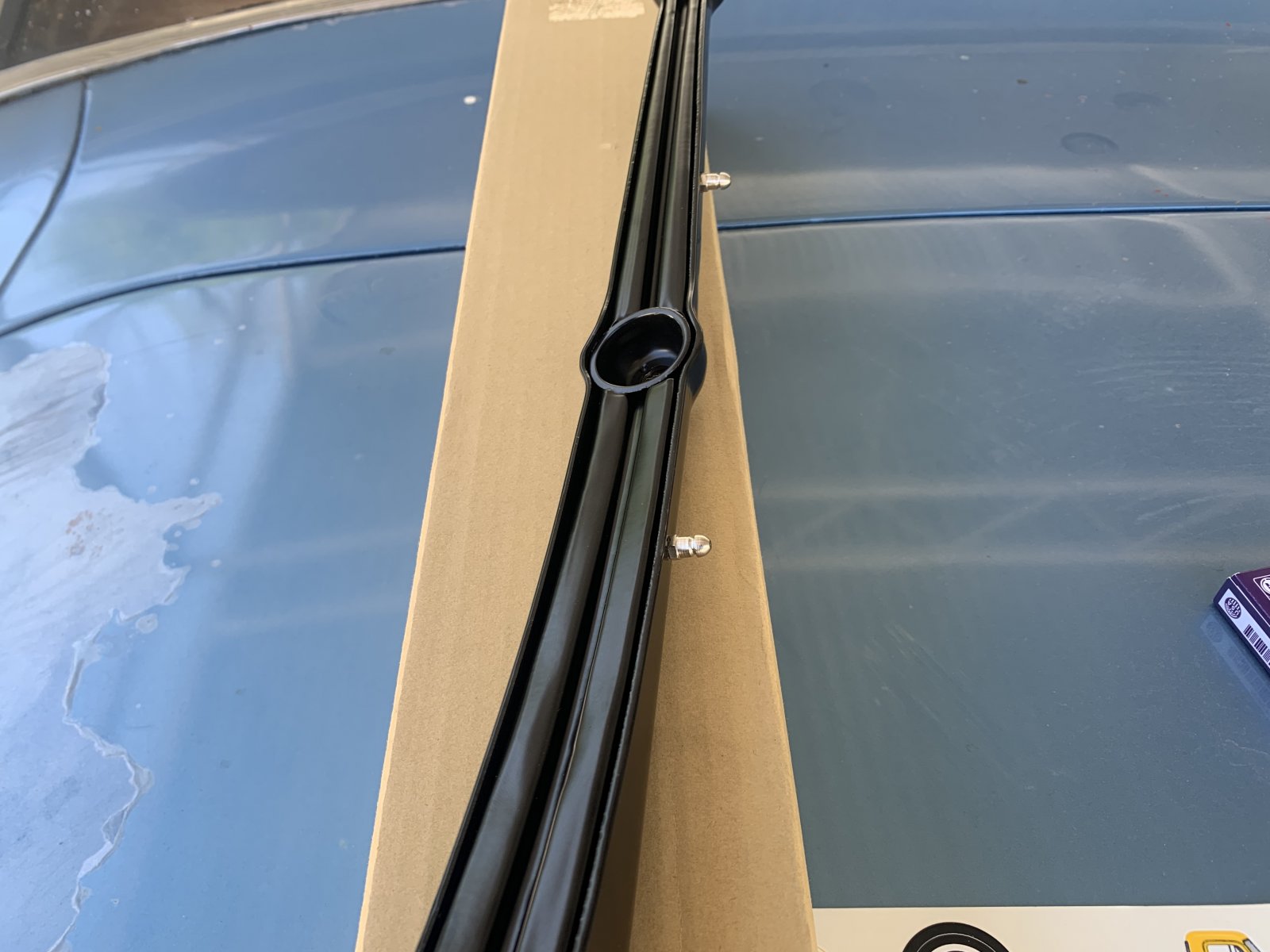

    Dropped the windshield frame off at the gl*** shop & now I’m looking at the stanchions. These came with snaps for side curtains which is cool - I hadn’t even thought about that. But chopping these to keep the finials for the top will be a challenge.
    There is no way the stock seat height is gonna work with a top, and I’m pretty sure the steering wheel will need to come down as well. I wonder what it will take to change the column angle.

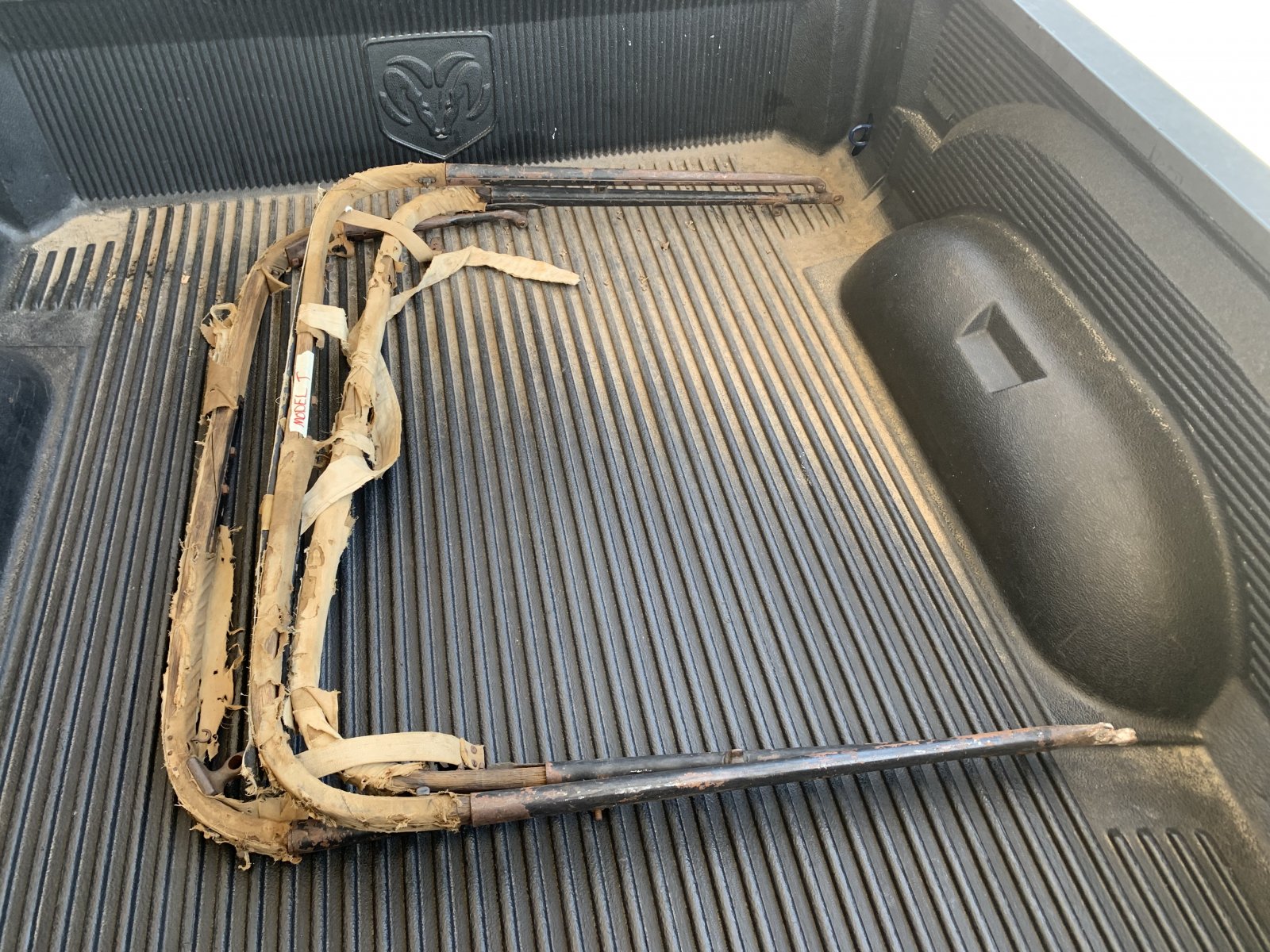

    Picked up the top frame today! Really excited to start chopping it up.

    I’ll try to do***ent everything we do to the top & windshield as extensively as possible. The stanchions will be pretty tricky… not sure about the top itself yet. I think it might be pretty straightforward.

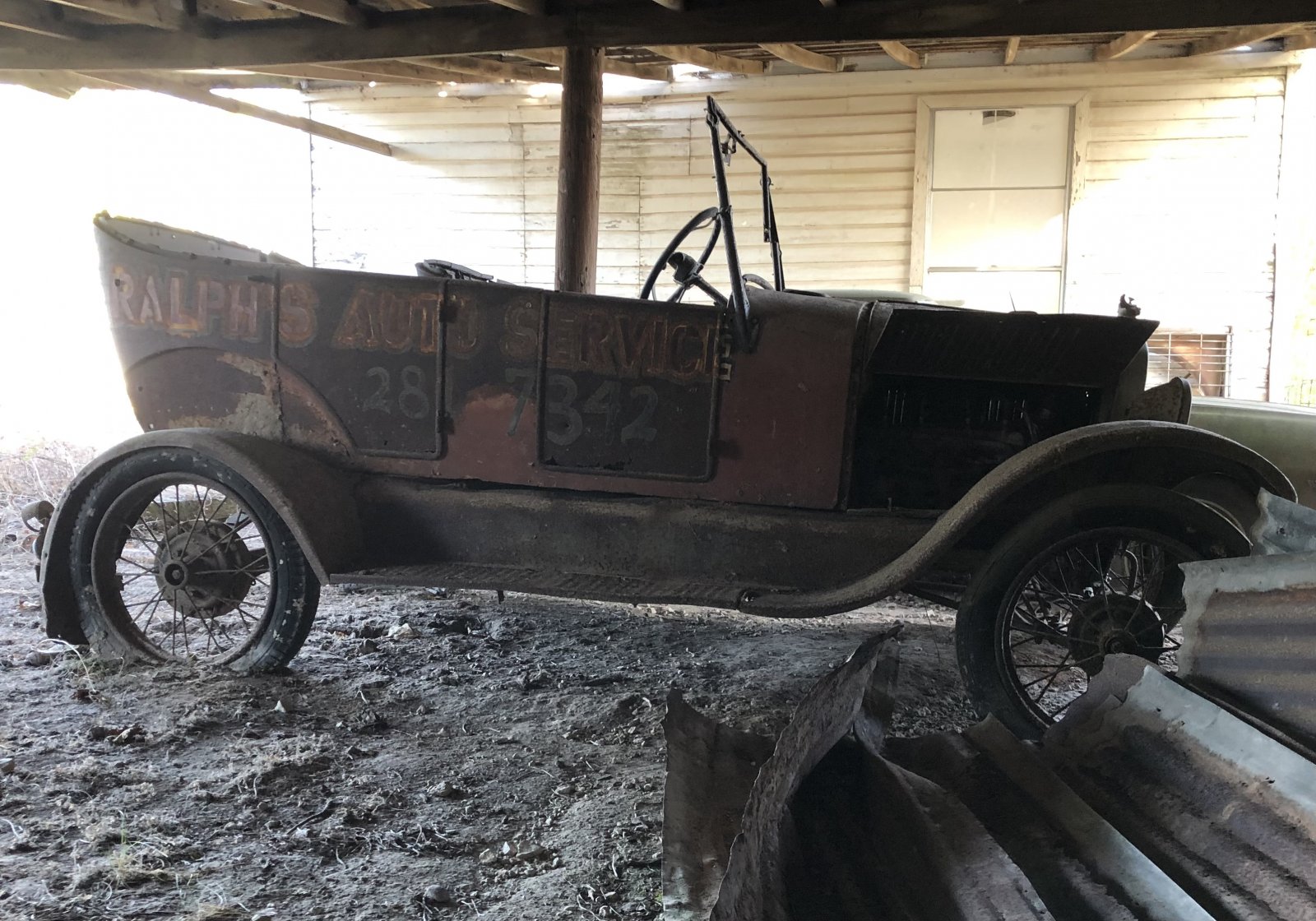

    Not to hijack your project but I found this yesterday out in the Texas backwoods. He won’t part with it
    (of course he is gonna do something with it “someday”) I want it, I want it
    Oh well…
    You can see that it is already trying to shed its fenders and turn into a highboy phaeton
    I’m curious, the stanchions on this car are cast iron. What is the material used on your replacement parts?

    My repro stanchions are two layers of stamped steel with little discs in them for the bolt holes. There were cast options available, but very expensive. Since I’m still hoping to find some originals eventually I didn’t wanna break the bank on these.
    I am thinking a chopsaw straight through the center of the two discs, cutting out all the steel in between, using the bottom half of the lower disc and the top half of the upper disc. The stanchion tapers as it progresses up but the two bulges are the exact same diameter right at the centers. That would be the cleanest way to do it, I believe.
  22. Depending on your windshield. If you cut out the bottom pivot and **** weld back together, then cut the top pivot off and lower it on the stanchion to your windshield height, that should work. I'm running a 4 inch chop windshield from Speedway. A stocker would be done different.
    Thor1 likes this.
  23. A stocker lower windshield, you would cut the two pivots in half, discard the center chunk, and weld the two halfs back together. That gives you a very short windshield.
    trevorsworth likes this.
