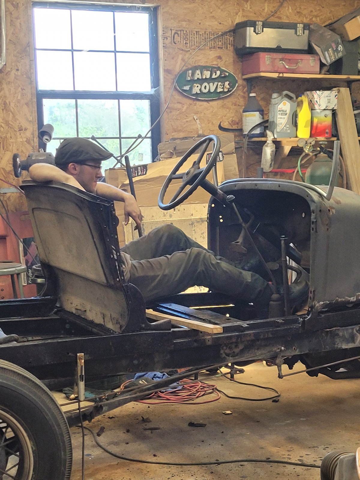

    RMONTY
    Trevor figuring out seating position.

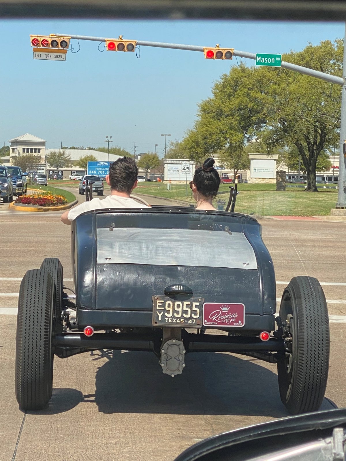

    MojoRacing
    Killer photo! Looks like it rolled right out of the late 40s early 50s, love it!

    I was wondering if we were gonna have to do that, but at 5'6" I might be a little too far back as it is hahaha. With the seat springs we made up, I think it will be exactly the right position once the wheel is dropped and the cushion is added for the back.

    You will also find that as you lower the seat position, the toe board angle becomes more and more ridiculous. Really should be changed to have a comfortable angle for your feet

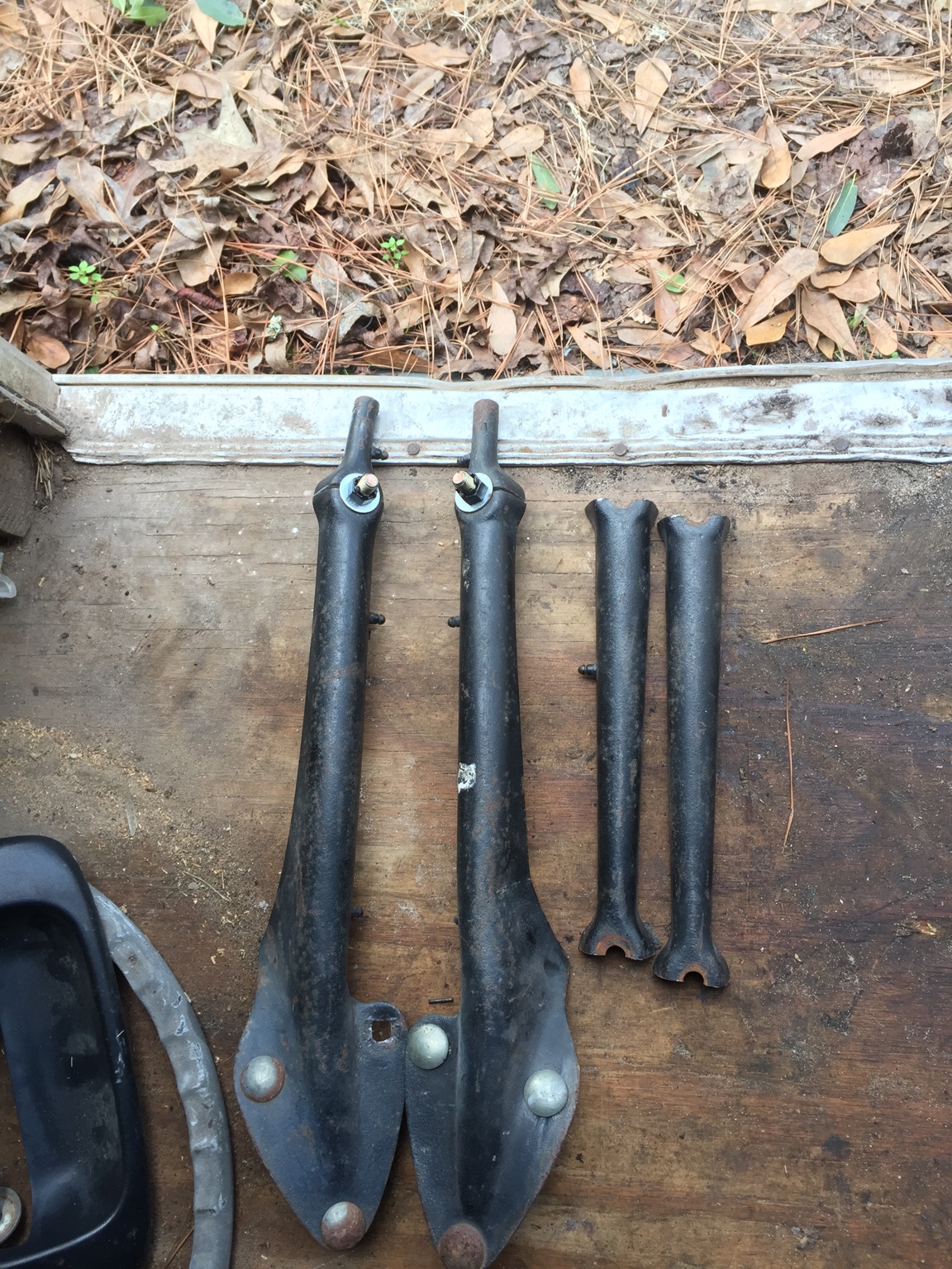

    Still in Colorado but need to make a note somewhere I will see it when I get home: I think we should try chopping the radiator ourselves. I can solder… worst case scenario, it leaks, we blow the bad solder off and do it again. The more I think about it the more I think it can’t be that hard, I think it’s a mental block.
    I have a junk 49 radiator with a damaged core that we can take apart to study… the Model A’s is probably pretty much built the same. If it works we know we can easily build a radiator for Robin’s AV8, and what a good skill that would be to have!
