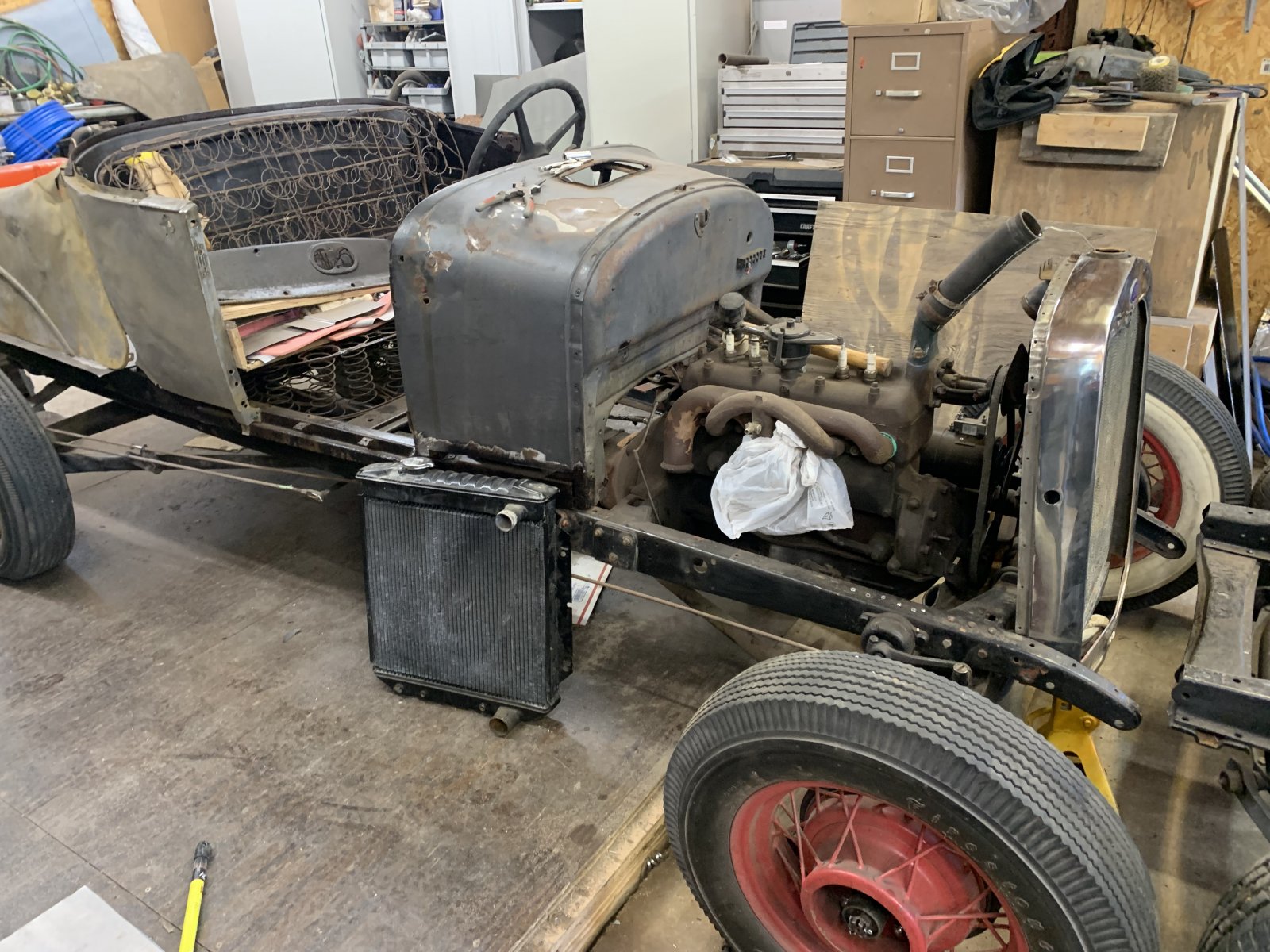

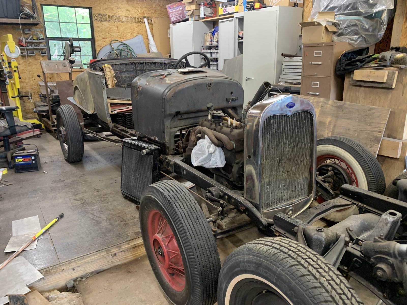

    Probably not gonna get too much else done today - we are working on a trailer for Robin. But I pulled the old radiator off & mocked it up with a 64 Ford radiator. @MojoRacing
    I need to trim the brackets so it will sit up in the shell properly. It will take some thinking to make the radiator hoses work… but I think it’s doable.

    Looking good Trevor! Do you plan on shortening the grill shell a little?

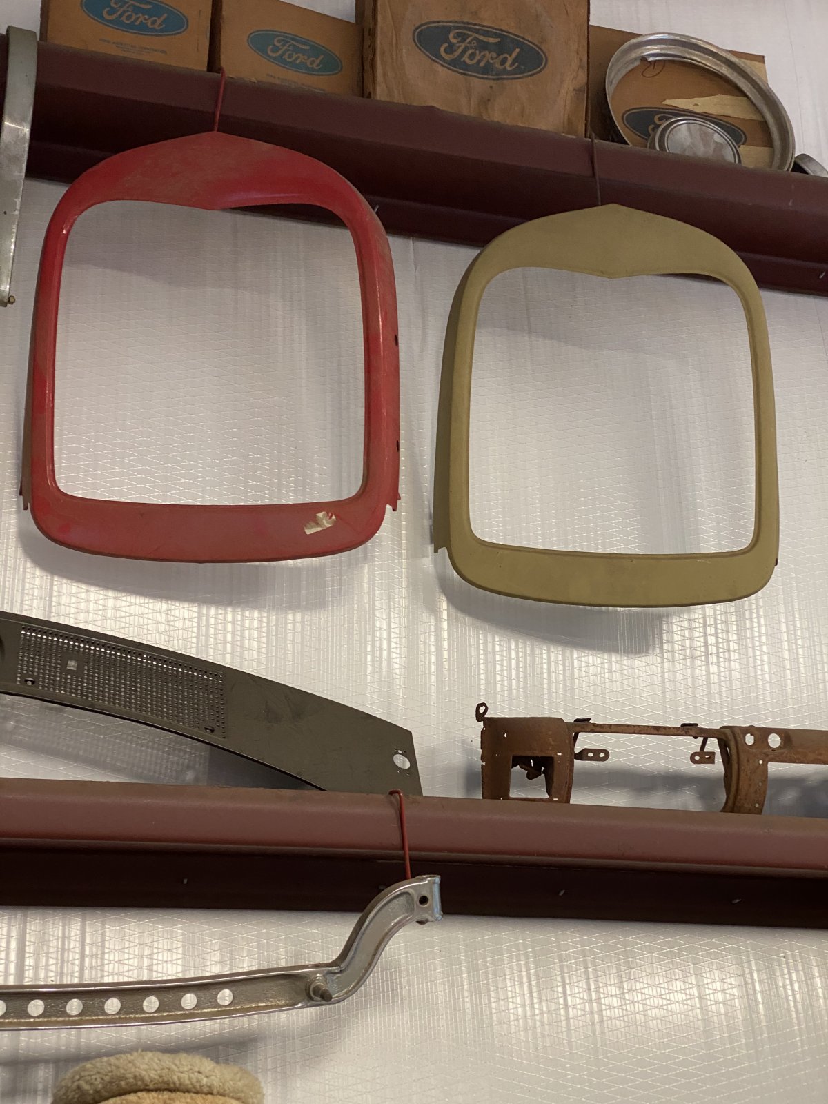

    Let me know if one of these will work both are aftermarket with holes filled . Frank CEF563CF-637C-40E2-8AB3-634B77A41599.jpeg

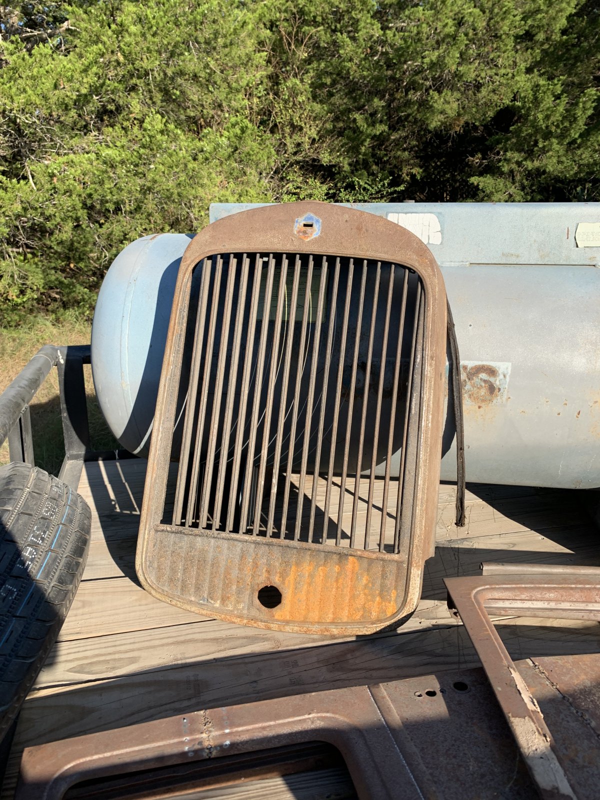

    I have three options right now… one, the ‘30 shell in the picture, shortening it was my plan… we have a junk repro stainless one to practice with. I also have a 28/29 shell and as of today picked up a cool looking winter front grill with slats, but it is probably too big. Haven’t tried holding it up there yet.
    Thank you Frank for the offer however!!

    Yep... we also got a 29 Es***. At the time we didn't think the grille shell went with the body but it turned out it did so it definitely won't be going on the T. ;)

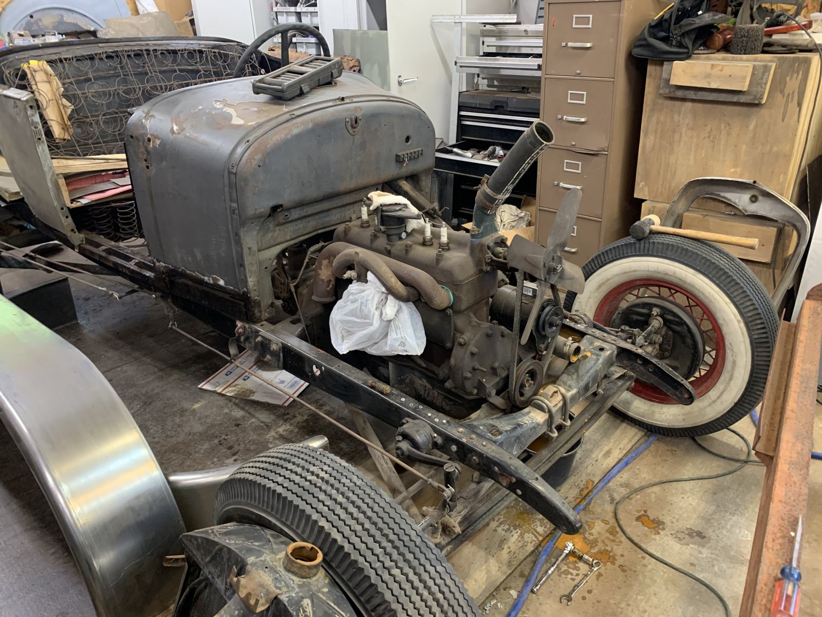

    Not working on it today but a little musing…
    D38D23F5-B2FD-4FEC-8D16-C15A5DD0B657.jpeg 9A6BD67E-D7F6-4DB6-83E6-8C0570518E88.jpeg

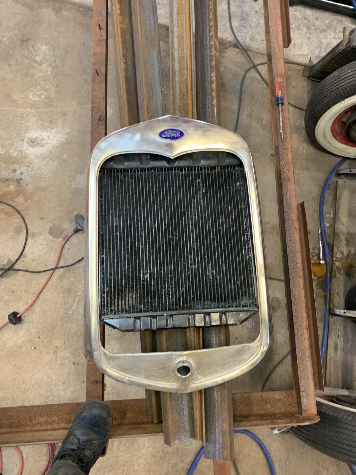

    By putting the rad in front of the crossmember I can avoid having to chop the rad/shell. But not sure the proportions are gonna work. I tend to think the rad should be directly above the front axle. Still have to find fan clearance either way.

    You also need a '28-'29 water neck on the head. They are a lot shorter.

    I have one with a place for a temperature sensor but haven’t installed it yet. Actually I think I forgot about it in a bucket of evaporust… for the past year or so… so it should be good to go!!
