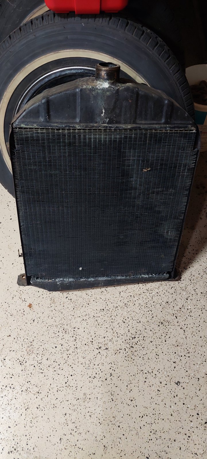

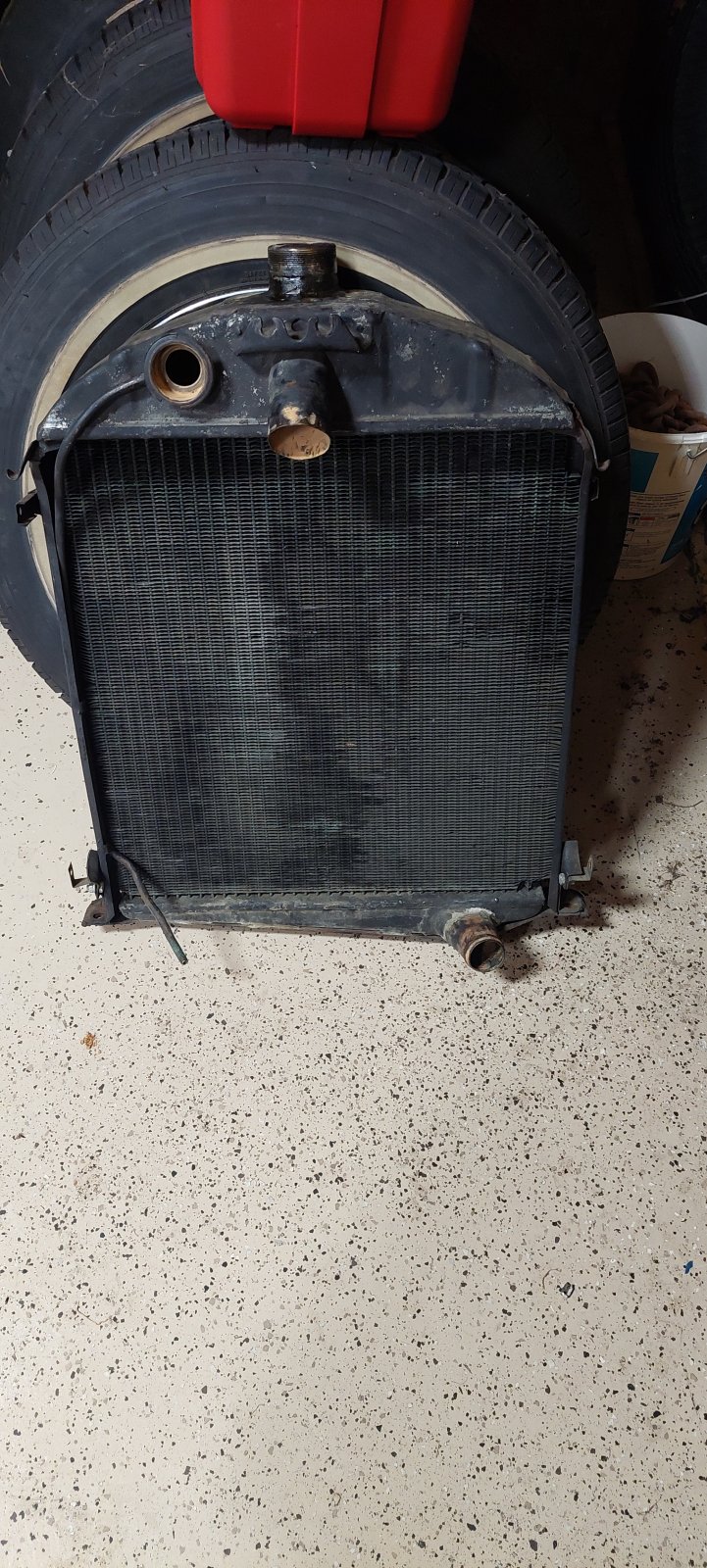

    We need to come up with something to go on the top (formerly bottom) of the radiator to extend the cap several inches up through the grill shell. I guess a good start would be a cut out of an old no good Model A radiator and then we can figure out what kind of extension we can make for that. Anyone got a clapped out Model A radiator they could cut up and sell us the neck and cap off of?

    I have a good cap. We could probably use the outlets too…

  6. Trevor, are you aware of the new replacement cap and necks available for repairs through many suppliers? Just google it.

    I have a cap, but wasn’t aware of replacement necks. I see Br***works has them, I will probably order from them. Thanks!

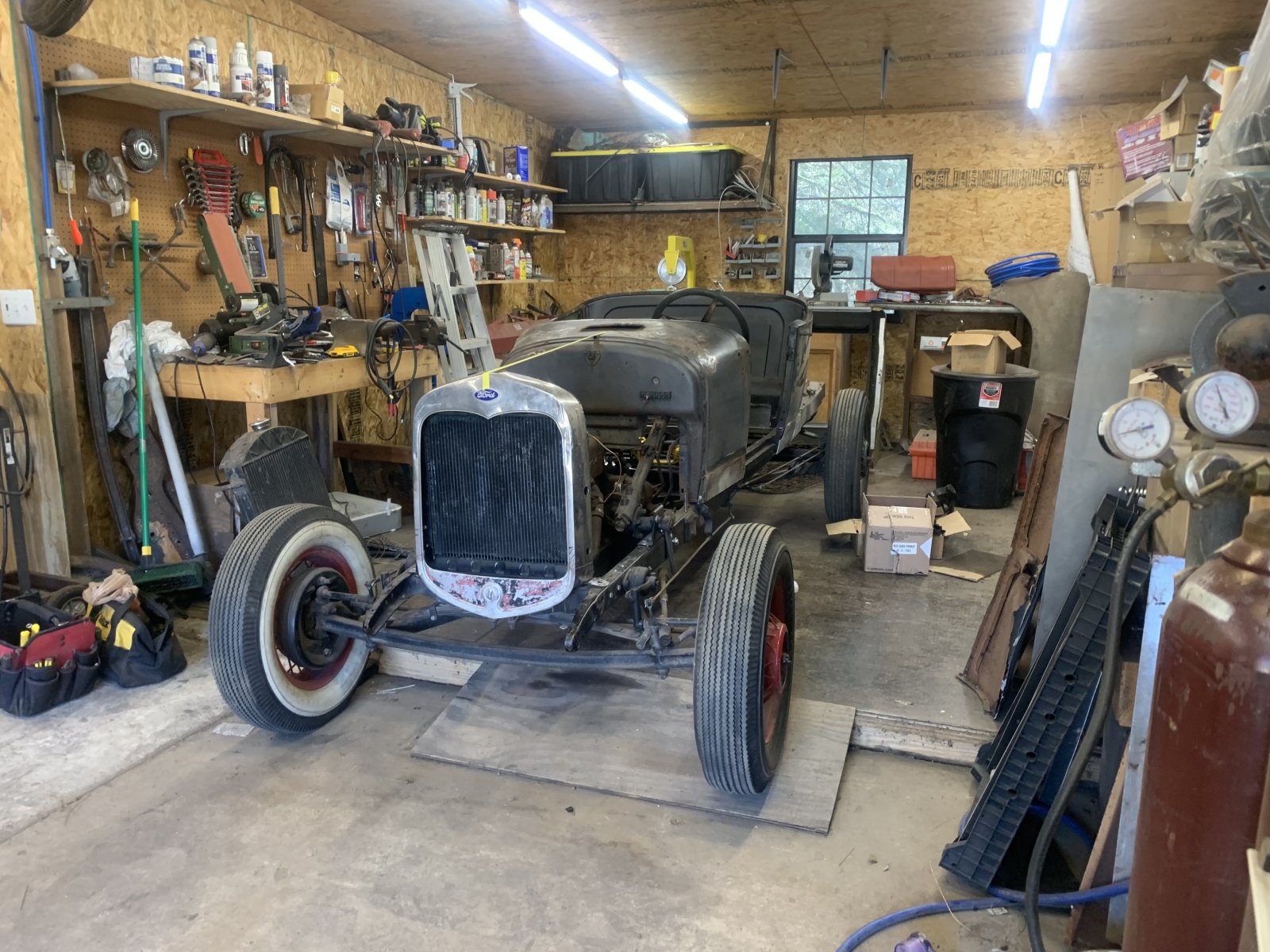

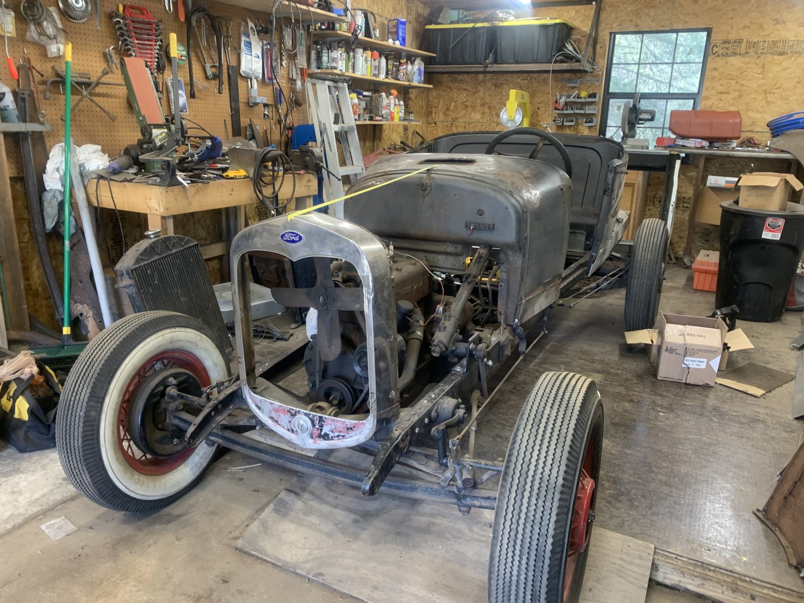

    Thanks for the offer man. We decided a 28-29 was just a little bit too tall for the cowl, so that's why we're making up a custom rad.
    Today we popped the drive shaft in @RMONTY's sedan delivery, then got to messing with my T. I decided to make a battery box and figure out how the cables are gonna be run. Didn't take long before I decided to just start wiring the car too, and before long I figured if I could wire it I could fire it. So we bolted in the gas tank, ran a rubber line and lit her off.
    It's been a long time since it ran but it started like I parked it yesterday. Timing and all that will need adjustment but we're getting so damn close. Next week, we're gonna try to get the radiator finished so we can yard drive it.

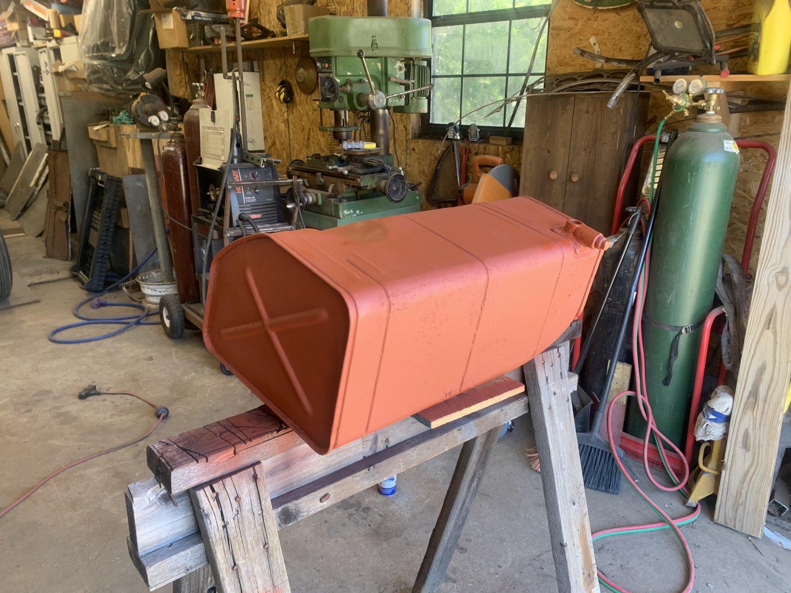

    Long time no see! I've only been over to Robin's a couple times since my last post, but we've been picking away at little stuff each time. I think the most important thing from the last month or so is that I got the T dash cut to accommodate the A instrument cluster & just need to figure out how to tie the two together. The wiring and all will clear the fuel tank which was a concern of mine. Somehow I didn't get a picture of it finished but here's what I've got of that.
    Decided to ditch the bench seat and got some Model A bucket seats.
    Today we started working on the turtle deck quarters. I've been dreading doing these because of the relatively complex geometry and curves here (even though it looks practically flat from a few feet away, it ends up being a pretty complex shape for an amateur to make/match). We had made a few abortive attempts at this before to no success but today we found our stride on it.
    Aaaand that's as far as we got on that. To be finished next time... then we'll get the sill plates I made fitted and fix the doors.
