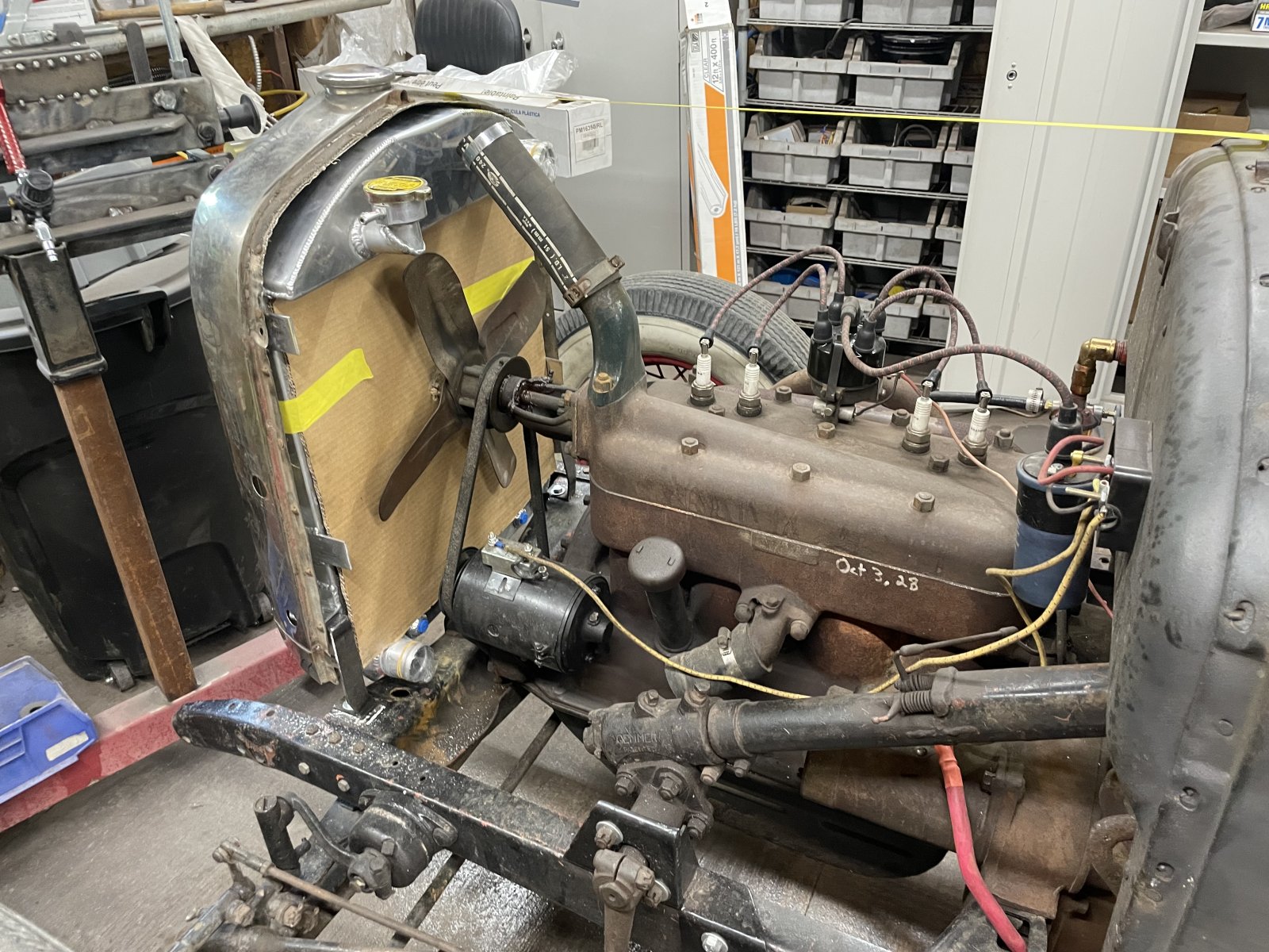

  4. trevorsworth
    Joined: Aug 3, 2020
    Posts: 2,056
    trevorsworth
    I know, I know, nothing traditional about an aluminum radiator. But once I paint it black nobody will know!
    This is a T-bucket radiator, the Mustang rad was posing too many challenges.
    Got to add some reinforcements to the brackets I made & that should be good to go.

  5. alanp561
    Joined: Oct 1, 2017
    Posts: 5,591
    alanp561
    Trevor, I hope you realize that yellow tape isn't going to hold that too long. ;)

  6. trevorsworth
    Joined: Aug 3, 2020
    Posts: 2,056
    trevorsworth
    Should be good for one trip around the block at least!

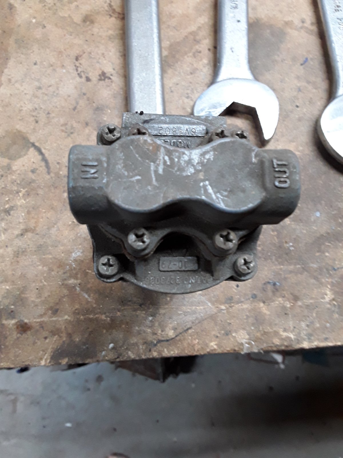

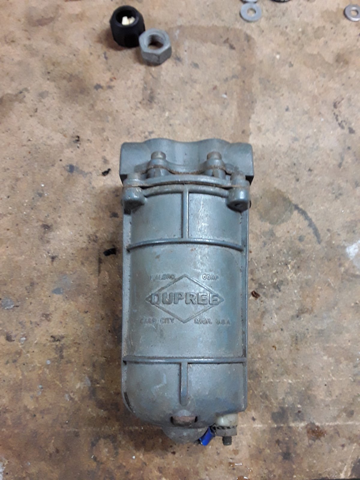

  21. MojoRacing
    Joined: Mar 24, 2013
    Posts: 174
    MojoRacing
    I thought it was a Bendix pump, turns out it a Dupree model 6v-802 4-6 psi. I hooked it up to my 6v charger and it pumped a bit but its crusty inside with old fuel. Needs a good cleaning and a kit. I found new bellows and gaskets for $18. Think about and let me know.
    P.S. I should have mentioned, it's yours for free.

  22. trevorsworth
    Joined: Aug 3, 2020
    Posts: 2,056
    trevorsworth
    I can't find anyone saying not to run a fuel pump off a reducer, so I'll rebuild it and see what happens. At least let me cover the shipping?
