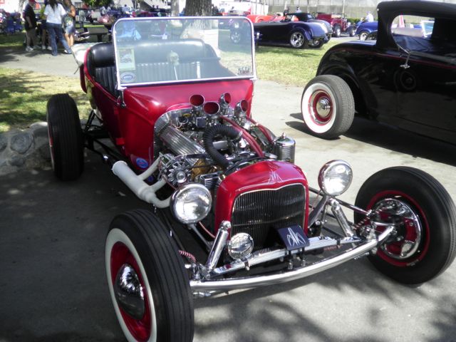

    And still it could have been simpler with only two headlights and no blower. I am always stopping myself from putting something dumb on mine. I thought real hard before I put the motorcycle horn on it. Still not sure I really like it. SANY0092.jpg

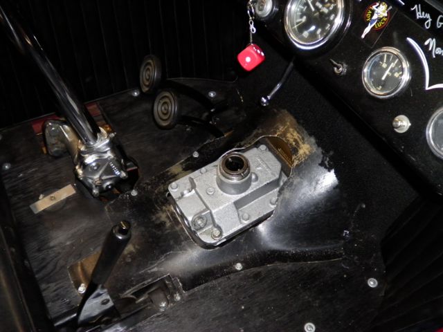

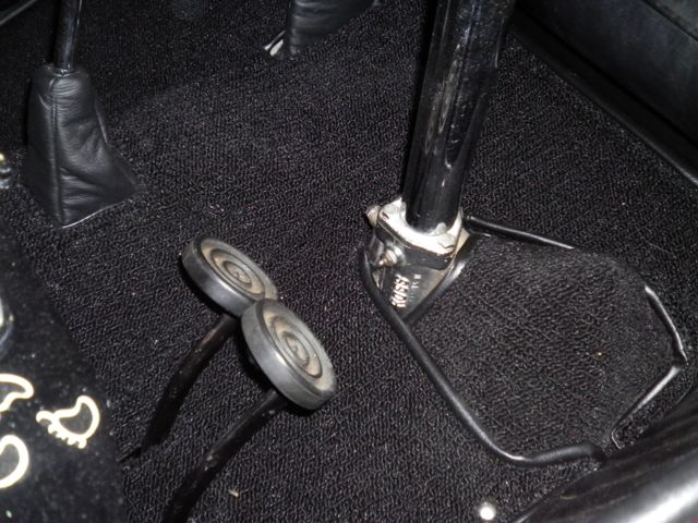

    By tiller steering do you mean a vertical or near vertical steering column? No real trick just mount the box between your legs and make a longer steering arm. The reason for doing it is more foot room in the confines of a T body. Really pretty comfortable to drive too. I kinda lay on mine. If you think of it, many trucks and busses have their steering in the same place.

    Gary...Rebel that you are, that steering angle (7*?) is right on. (exact!) The vertical ones are horrible to drive, (I removed a Corvair vertical from an old Andy's Instant T, replaced it with an aluminum Dodge Saginaw, 7 degrees tilt, 32" high at mast) The customer loved it. Norm Grabowski said his was out of a milk truck...That gave instant 'permission' to T builders to go near-vertical with masts.

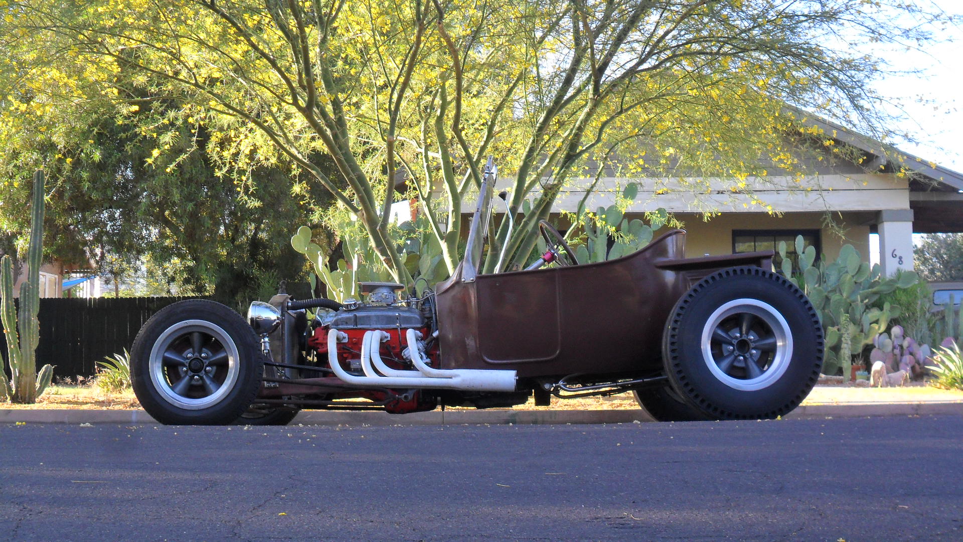

    Last but not least, I have over exposed this picture a bit lately, but I just love looking at mine.... SAM_6169.JPG

    Ha, IMO, you are overexposing the wrong pic! That one is just good, Its the rear 3/4 thats F&*%ING KILLER!!

    Well, I'll tell you what Gary, between what you had to say, and looking at old photos of the Penry and Thompson T buckets, I'm sold. When I do mine, its gonna be about 5 deg. off verticle, and through the floor, not the firewall.
