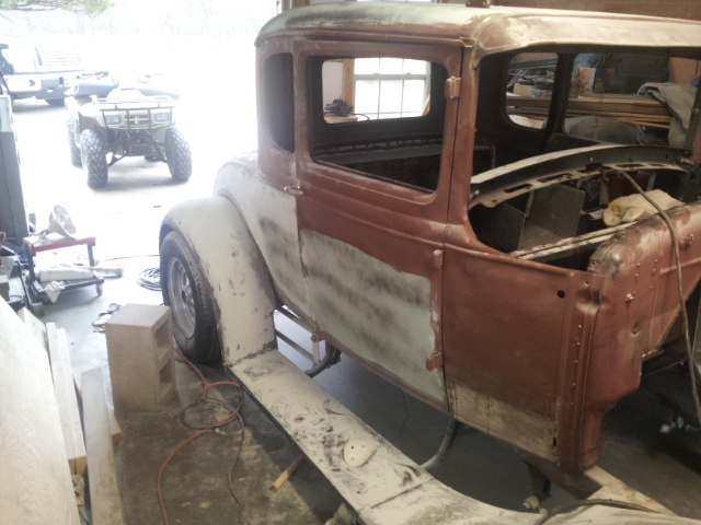

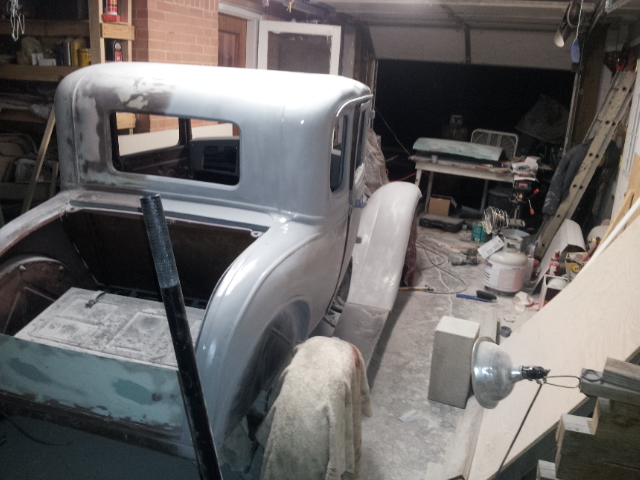

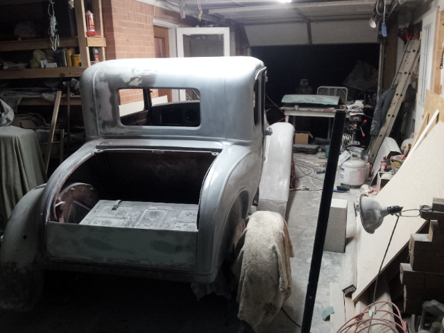

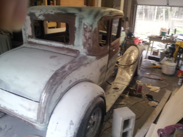

    Well, I straightened her out as much as I could, then, went and got some RAGE, pricey but nice to use. I also tried some z-grip, also from evercoat. The rage was better over all, but the z-grip was thinner and eaiser to spread, but didn't sand as good. but it was also half the price. I also got some of the evercoat body putty, pretty awesome stuff. Goes on super smooth ans self levels. Well, thanks for the info, I appreciate it. Here are some pics of what I have so far., jon

    Looking good. Dents everywhere?

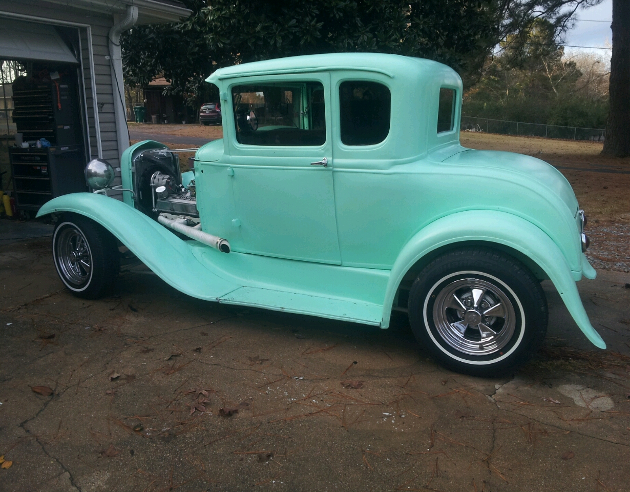

    Well, a couple years.... two babies..... and 800miles on her so far!

    2015-02-21 21.33.31.jpg And the body work...... it's perfect for what it is. I drive her daily an hour each way to work, smiling the whole way! She is a 10 foot car, but she is the best looking 1930 model a in the parking lot at work! And it just makes people happy. Kids don't wave at me and people don't come talk to me at the gas pump or the parking lot at Wal-mart when I drive my pick up truck! She may not be perfect, but she is perfect for me! Thanks for all the help guys! 2015-02-21 21.33.31.jpg

    10 footer sounds generous but if your're happy.... Like the color and the Cragars.
