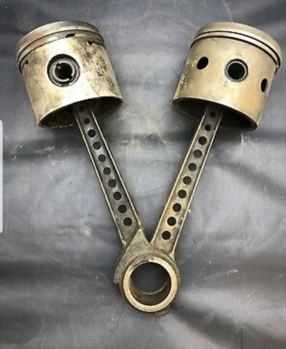

    ... sure they did. Old school JD engine rods, with pistons, nearly 100 years old. Screenshot_20191019-042802_Google.jpg
    ... and still do.

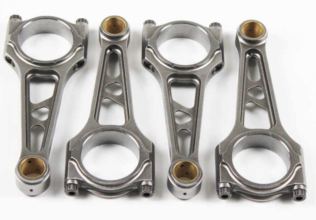

    Interesting! I stand corrected... What are the newer rods for?

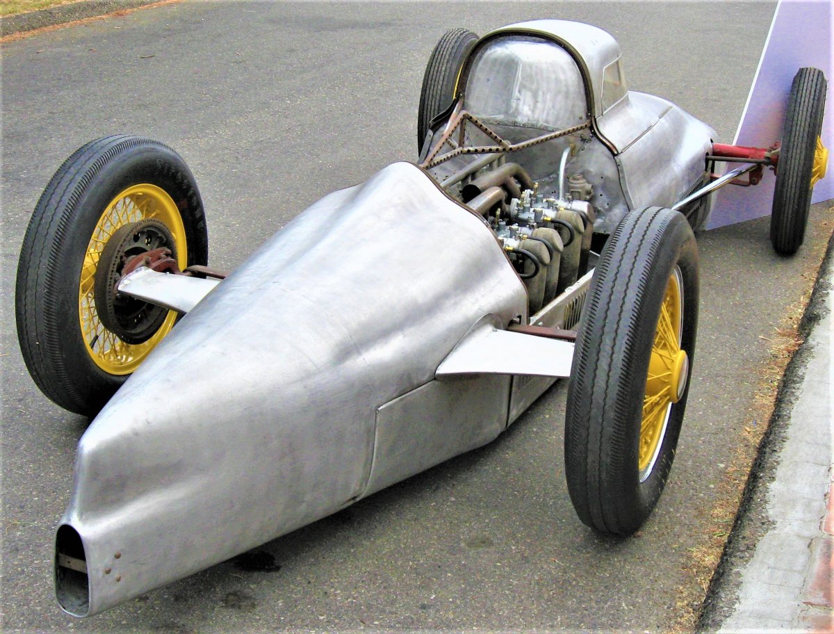

  6. Unless your life in lived in .001 second and you are lightening everything else drilling your axle is for looks. If you like the look drill it. its not a 10 minute job but if it floats your boat its worth the labor.
    Here is the thought, my current project was first a land speed car then lived the rest if its life as a dragster. It does not have a drilled axle.

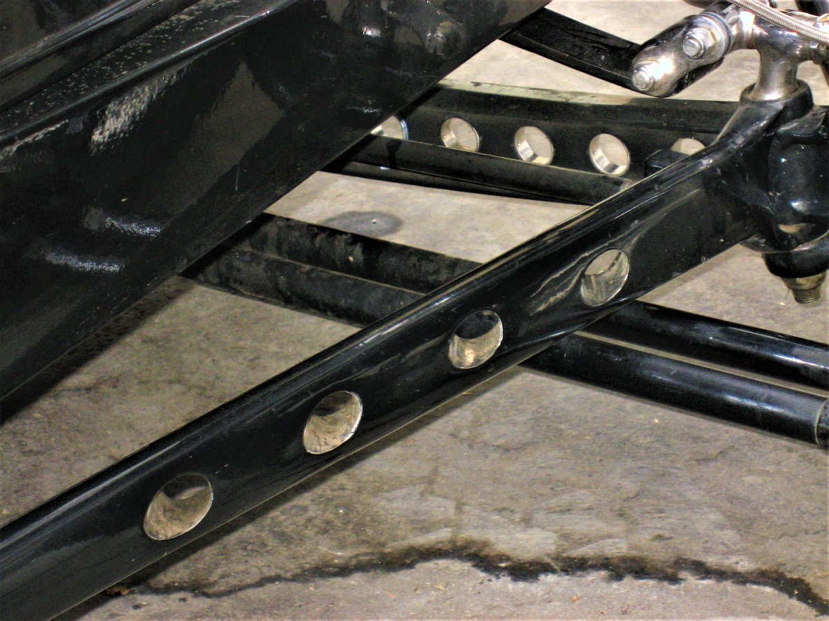

    And I am sure you are correct, that being said, I shot the photographs, only to show what the car owner had done, the car isn't mine.
    neverdun likes this.

    He didn't say why he did it. It's more of a look then a function. Personally I like it.

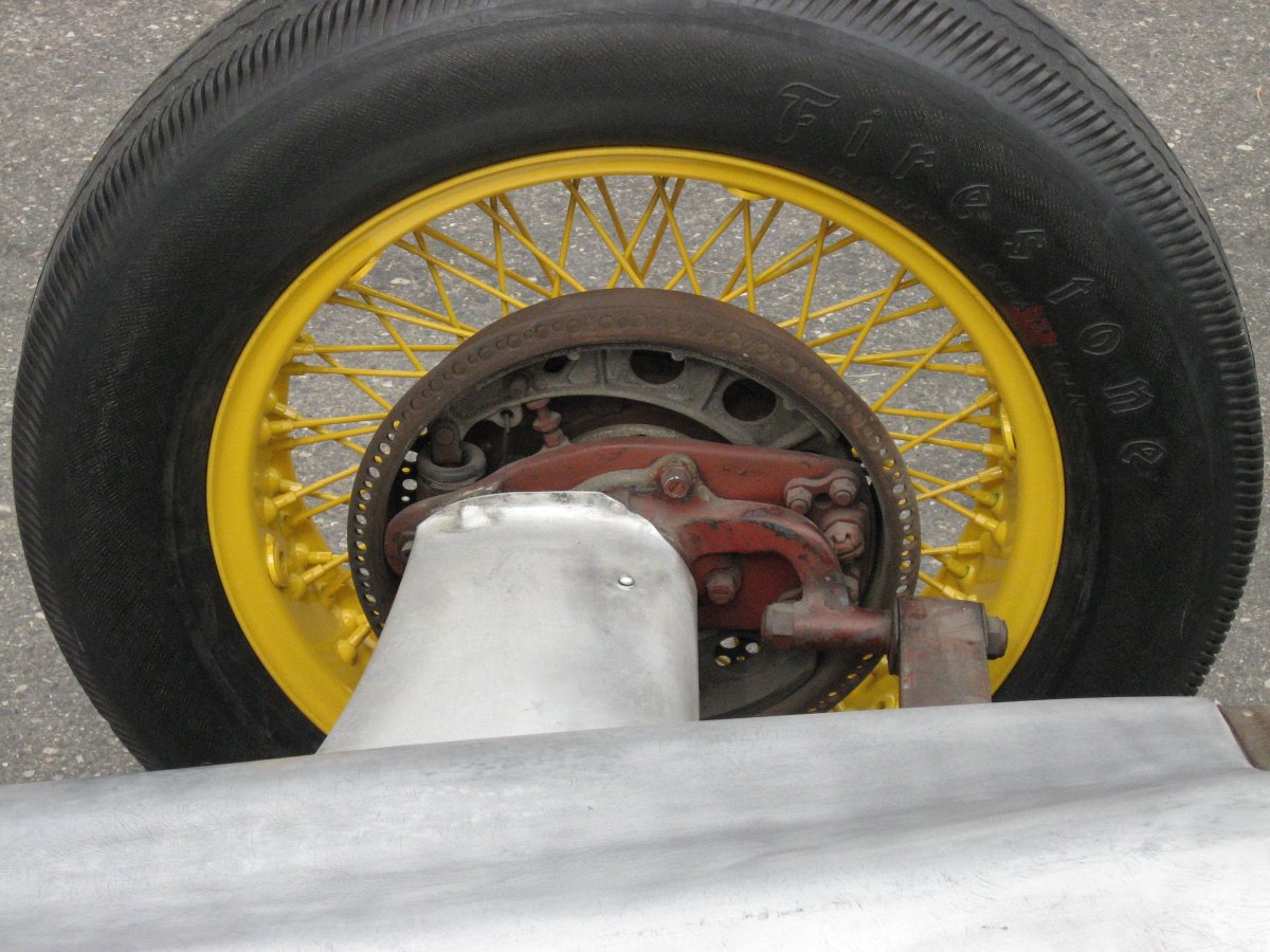

    Drilled by a friend of mine. I like the extra holes, less wind resistance![​IMG]

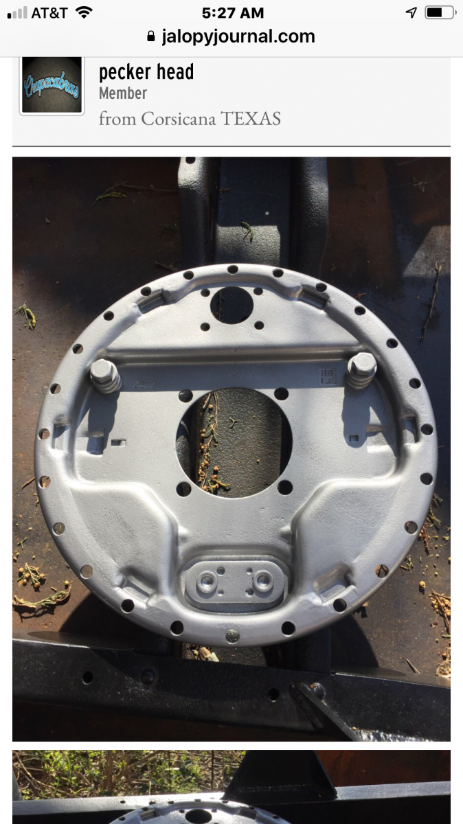

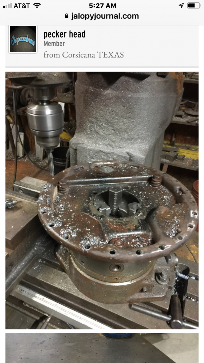

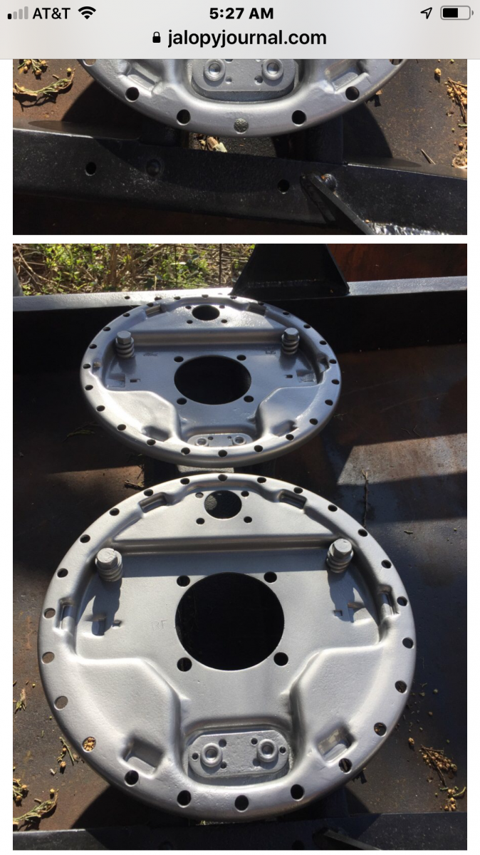

    While I'm in favor of holes, I Don't understand why you would drill holes in brake backing plates. Seems that would be detrimental for stopping when it rains.
