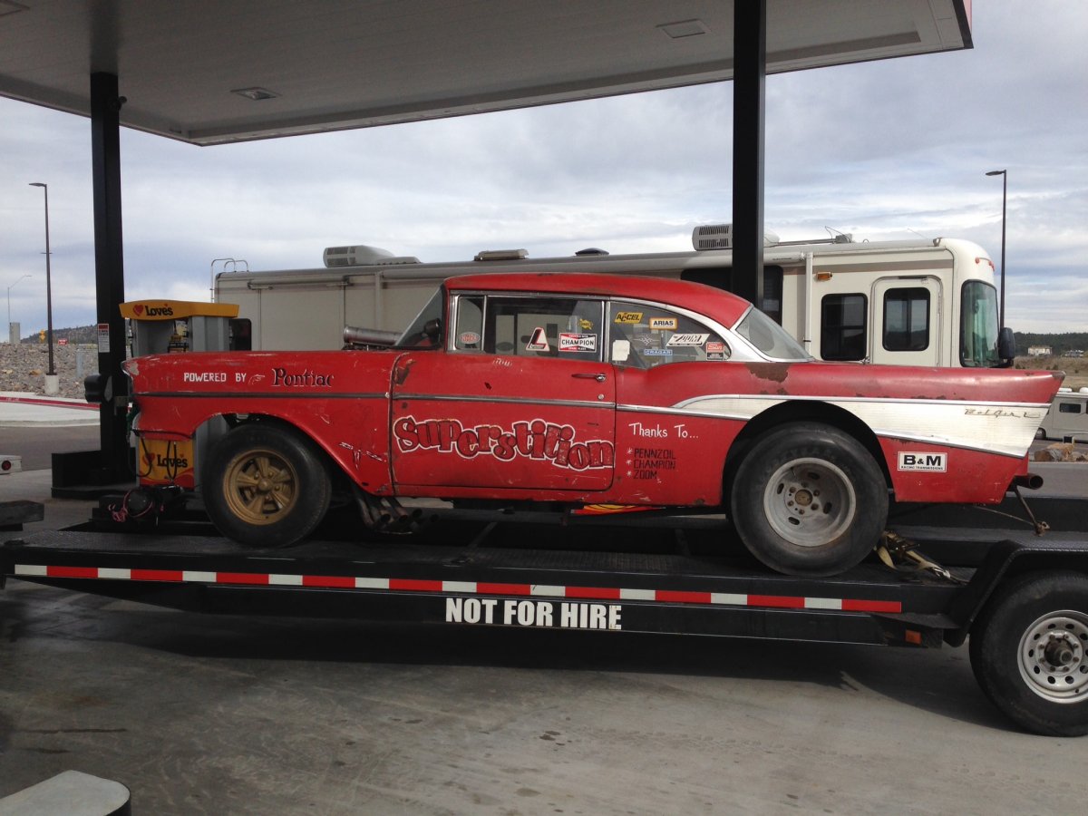

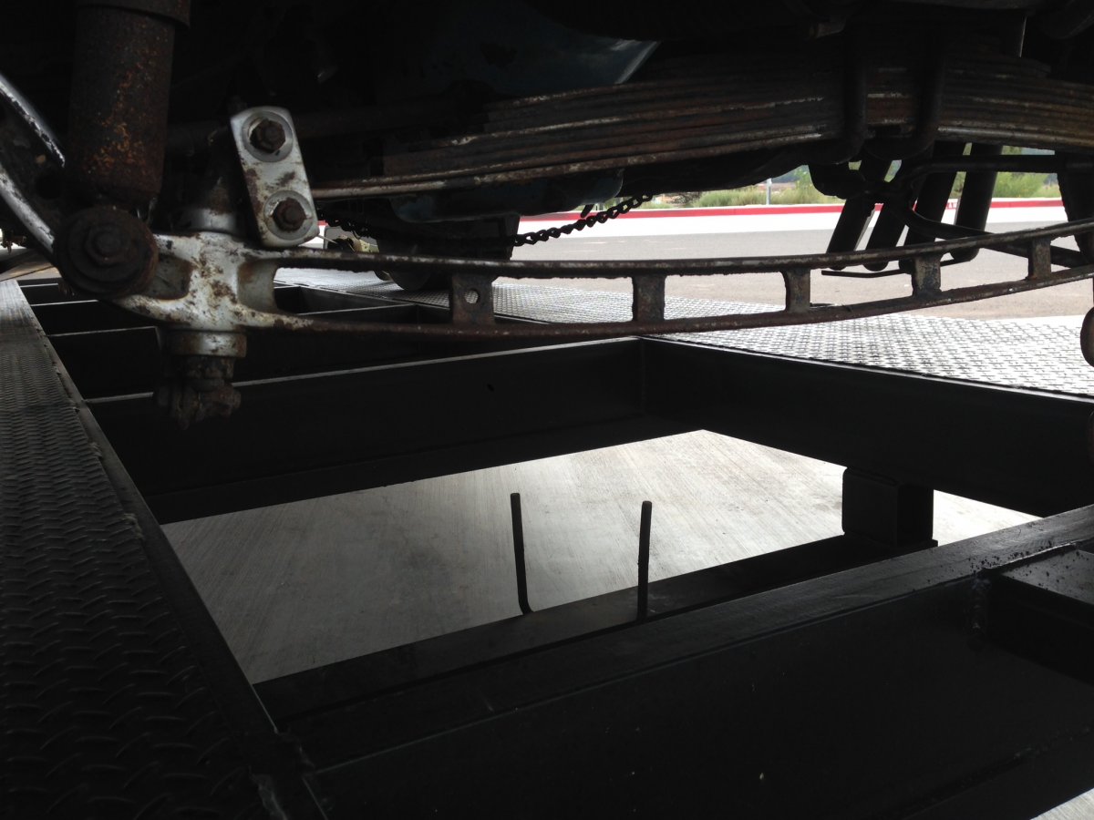

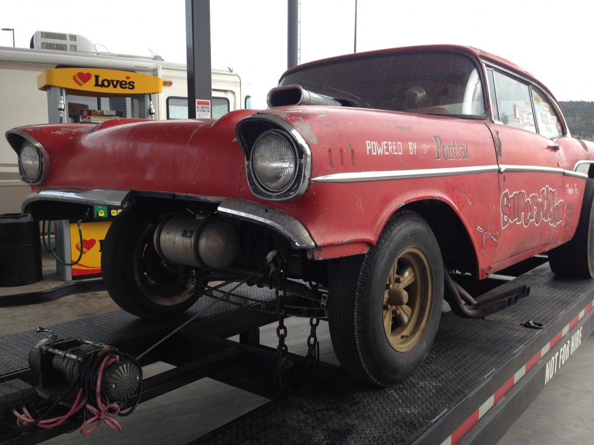

  7. BC52374C-55EE-4DD0-9E83-FB06B8101B94.jpeg BC52374C-55EE-4DD0-9E83-FB06B8101B94.jpeg 7073583D-A3BF-410A-83D6-B5B8687DD2A4.jpeg
    Saw this back in 2015 on a trailer at the Love’s in Williams Az, probably the most “Lightened” front axle in history. Doesn’t look like it had any issues....
    Stock Racer, Jet96, -Brent- and 2 others like this.
  8. Sweet & Low
    Joined: Feb 13, 2014
    Posts: 300
    Sweet & Low
    LOL tell me how that spring works?

    Whoever did this is just downright stupid...............

    You'll notice it sits just fine on the trailer. Lippy

    Properly done there is no real reason that a lightened axle creates a safety issue. Since some companies sell them with holes drilled in them, they must feel that its not "unsafe". The axle in the 57 Chevy picture looks to have been cut out with a torch and left undressed. Lots of places for cracks to start, and it generally doesn't "look" strong enough .......but thats a subjective opinion on my part. The shocks are extremely rusted as well as quite a bit of rust on the other components, so I'm guessing this is a vehicle that was built a long time ago and has been sitting somewhere. To me, the thing about building a car is that the components that are selected serve a purpose and compliment the "theme" of the car. Everyone has their own ideas about what looks right or good, so my opinion is worth no more than theirs..........but I think when all the components on a car compliment or establish a certain "look", everyone knows it. Its kinda like the old saying about not being able to completely define ****ography......but I know it when I see it.;)
