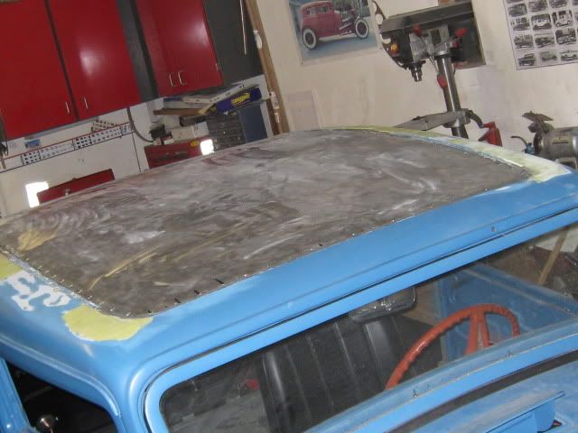

    I like the race car look of 18 gauge Aluminum insert with a nice crown..... 20160927_124120_resized.jpg

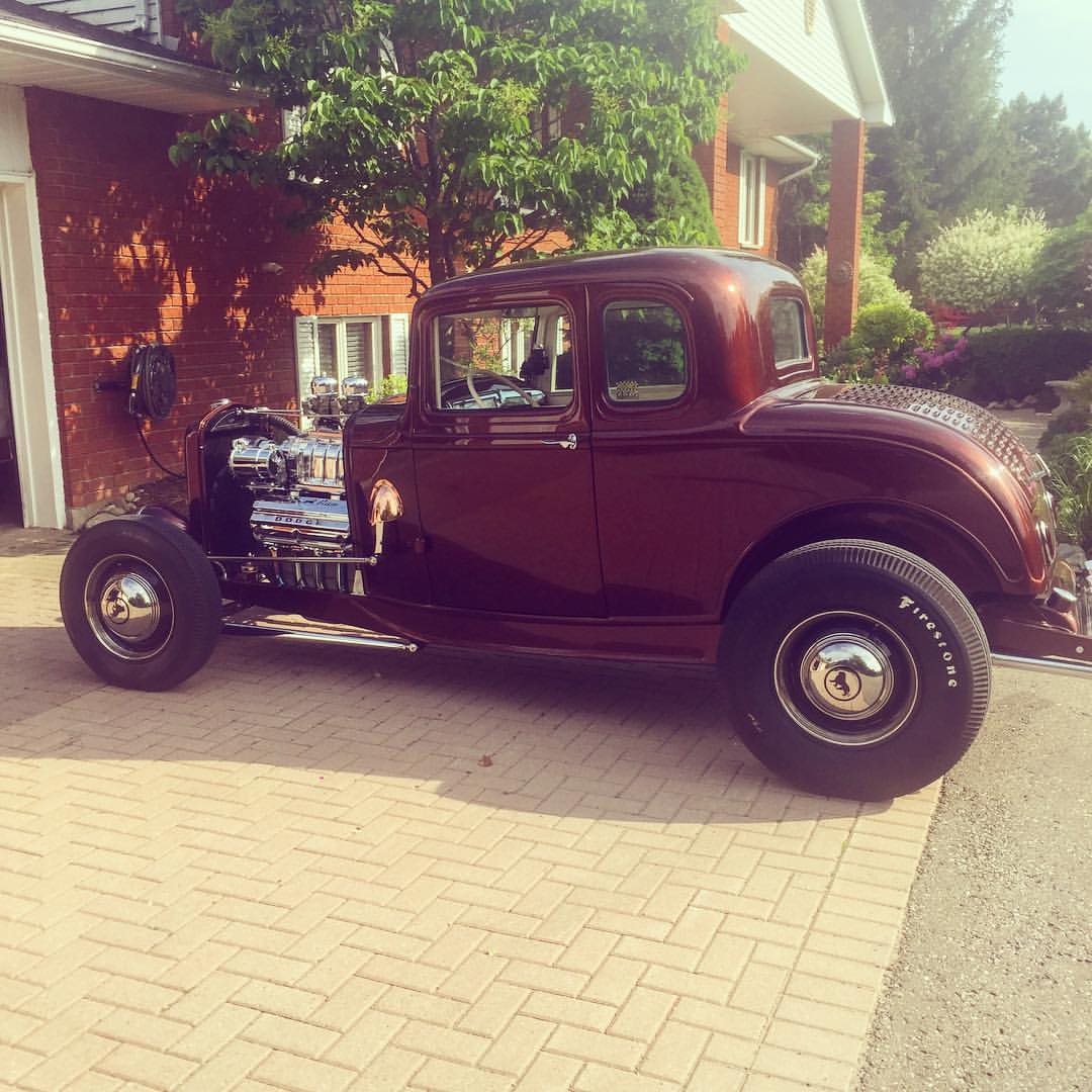

    Fill like a Boss....
    all depends on the era and style your building(IMHO)
