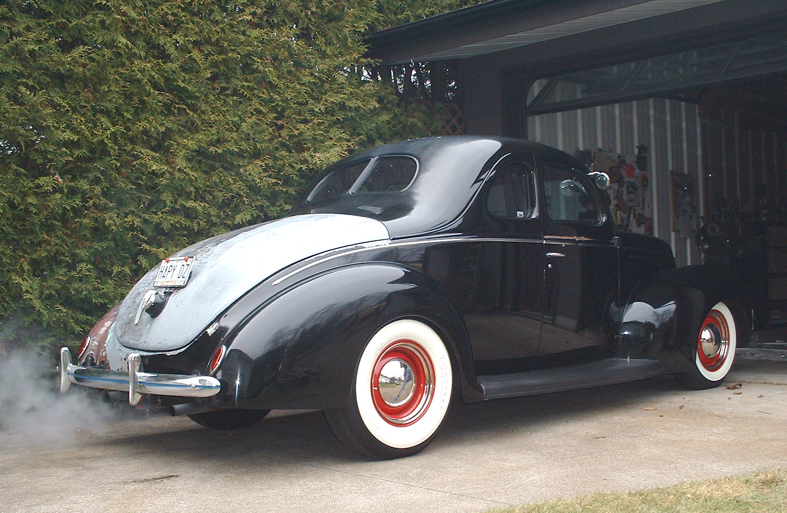

  1. I would not repaint it from what I can see in your pictures. I like clean, yet not perfect cars, and that's what I see. My opinion is, if you do repaint it, it will look a little bit better, at a lot more cost/aggravation to match the improvement. If it were mine, I would only paint it to change the color, so the next 22 years has a different "look" from the past 22

    Since you're asking, I think Deuce Roadster is totally correct. It's nice not having to worry about every little stone chip or scratch. Just be sure to do what makes YOU happy.

    like many have said, do what will make you happy and still have a car you will drive with out worrying. from the pictures it looks good as is.

    Ron ,
    Thats a beautiful car and a wonderful ride to enjoy.
    No offence ,but to me I would not touch the car's paint ,
    I love black on a car ,
    BLACK AND SHINY IS BETTER.
    Do you want to spit shine it all the time ,
    will it make YOU happier....
    I Hope you enjoy it for another twenty two............

    First, fix the windshield leak, that will rot away your entire car. Then, have someone with sharpie or something mark all the spots you can see while sitting in the driver's seat. Fix those, leave the rest, and go put some miles on 'er!

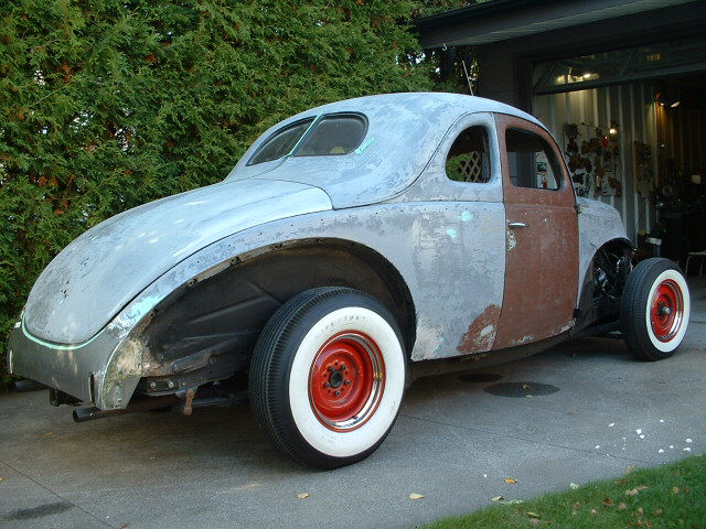

    The car looks so much better in the photos than it does in the flesh. I hate driving it looking so sad so I purchased the paint stripper on Saturday. Thanks for your input guys, I do appreciate your comments !!!!

    Well, there is no going back on it now..lol. I'm going to try it get it all stripped by the end of Dec. (of this year):)

    So you've already found out that paint stripper doesn't work as well on lacquer as it does on enamel?

    You are right on that one ! A little warm up with a heat gun and a stiff back razor blade in a holder is working great !!!

    Wow, it took two and a half years just to strip the trunk? Hopefully you have her back on the road in her new dress sooner than that. :)

    Ya , that is a long time ! It was not a priority while I was building the roadster...

    If you're using the razor blade, make sure you take it back to bare metal (any old body work will have to be redone). Leaving the original primers will make for an uneven surface for the next paint job. I don't think there is any grilled openings on that car (like in front of the windshield on 60's/70's cars) so you'll save yourself that education, but if you've punched any louvers you can kiss your fingerprints goodbye. I would suggest working one panel at a time, and primering it as you go to prevent surface rust. Obviously if you do that, you need to work from the top down to prevent stripper from destroying the new primer.

    First time in almost a year for the 39 fired up and taken for a spin out of the garage and back. It almost looks like it should have a number on the door... Getting closer....:) 39 track.jpg
