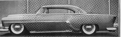

    I disagree, I believe chopped and sectioned cars can look exceptional.
    Here is Dave Johnson's Spokane, Wa. based 53 hardtop that was built in the early sixties. 3" chop and 31/2" section, the pontiac trim certainly gives it a distinctive look as well.

    I'm reading everything I can on 49-54 Chevy top chops, before I attack my '50. The problem with sectioning one of them as I see it deals with the "hips" or rear quarters. Keeping the concentric curve of the front of the bulge is the critical part.

    Notice the car Mick posted doesn't have the "bulge" part of the 1/4 sectioned, or not sectioned as much. It's sectioned in front of it but I suspect that 1/4 panel is near stock height and the trunk area dropped in between the fenders.
    Way cool! [​IMG]
    How much was Billy G's "Copperhead" shoebox sectioned?
    It's pretty right on.

    i think yer right Doc. it looks like it was sectioned without sectioning the quarters. now THAT is a hard trick to pull off.
    i stil agree that MOST sectioned cars do not look right but it is possible with a little restraint, vision and skill to pull it off. i still would'nt bother though. why open that can of worms? a chop and drop will do wonders for it.
