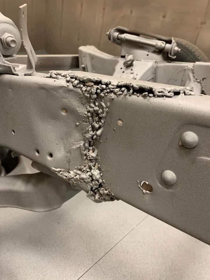

    Hey man, welcome to the Hamb. Lot's of good information to be had here, and also a lot of opinions and humor. Bear with it; it's worth it.
    Coming back to the job at hand, yes, you need to patch it. You've got two metal surfaces coming together there, filler just can't bridge that for any length of time/miles.
    I may be stating the obvious, but it looks to me like you need more than one patch:
    That's at least 2 patches, and maybe 3 depending on what's happening on the other side (can't really tell from photo). Which is a good thing. In my (amateur) experience, fabbing several small patches is actually easier that making one complex patch to fix everything at once.
    The job will become clearer when you cut the bad away and ***ess. It's probably not as complicated as you might be thinking.
    After that, it's just like @twenty8 said, make your patches and then go slow with the welding so as not to overheat and warp the metal. Tack, cool, tack, cool. Finish patch #1, grind smooth as needed, and proceed to patch #2.
