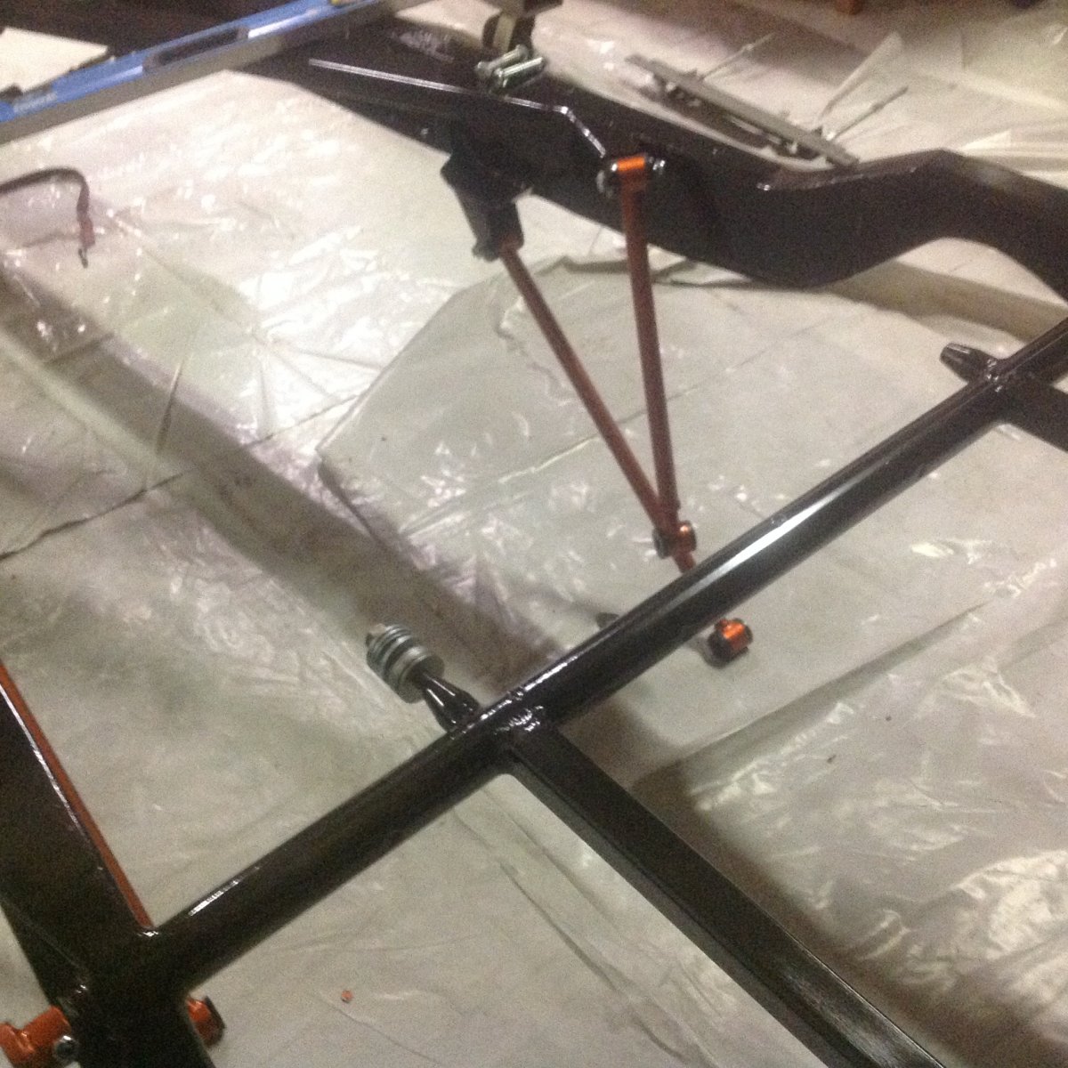

  27. I don't think this would be offensive to anyone.
    It's down to girly work, thinking, and pretty stuff.
    I got something pretty cool planed for the gas tank straps :D:p
    I hope it works.

  28. Got a dumb question.
    I didn't have the correct answer on a 4triangulated 4 bar setup.
    Can the upper bars mount wide on the axle tubes and narrow on a ch***is x member side.
    loudbang and 31Vicky with a hemi like this.
