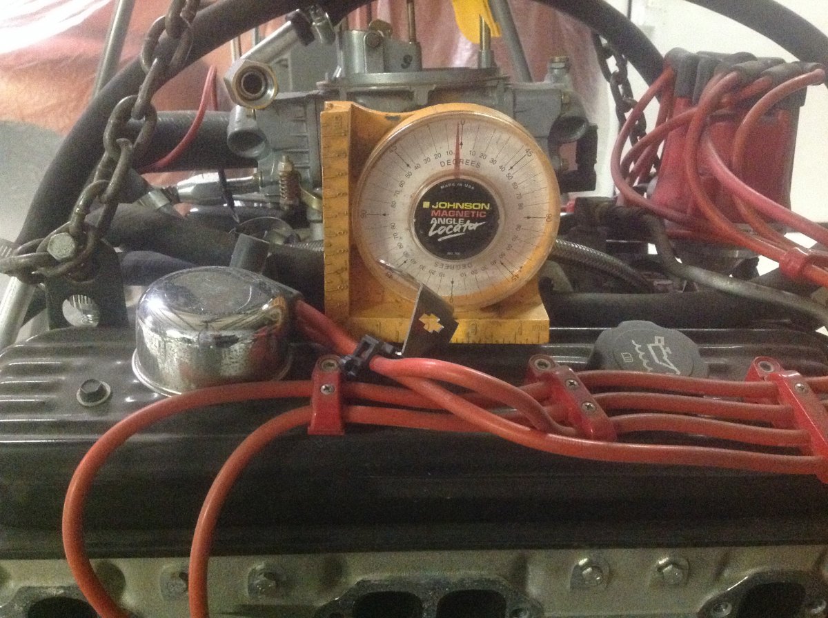

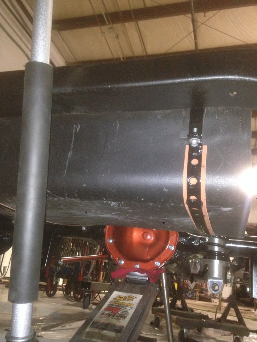

    To get there, I went up on the Trans as much as I possibly could, I fought for a 1/16 here and another there and got myself an entire inch. The limiting factor there is the bell housing to the beautifully finished flat floor in the truck. (Spatial recognition)
    Upfront inSwapped to the smaller balancer and then let the engine go down in the front as close as I would dare let the balancer get to the rack. Not enough still to much angle on the engine. (Geometry)
    Then I let engine go down to touching the rack. Not enough
    Then I unbolted the rack and let the engine go down some more completely violating the space once occupied by the rack- By an inch and a half.o_O
    ( Spatial issue)
    Sorry No pics of that issue here.
    To satisfy spatial issues and geometry:) (are you all catching the title yet)
    One thing I'm contemplating is a small body lift or cutting the floor.
    The body lift would let the Trans come up let the front come up and save the trim guy re-work,,,, and kinda sorta but not really save me rework up font. The body lift would really jack up my perfect ride height and make rework there front and back any way. I'm guessing the trim guy is gonna see this again at least for a Trans tunnel cover. The other is to throw some rework up front and get the crazy OT front end stuff to fit and work as it should with an oil pan nip and rear steer.

    ^^^^^ Been there. I had to put a 32 Ford firewall back together because the person before thought bolting the trans to the aftermarket frame was easiest. It to was 7 degrees up and high.

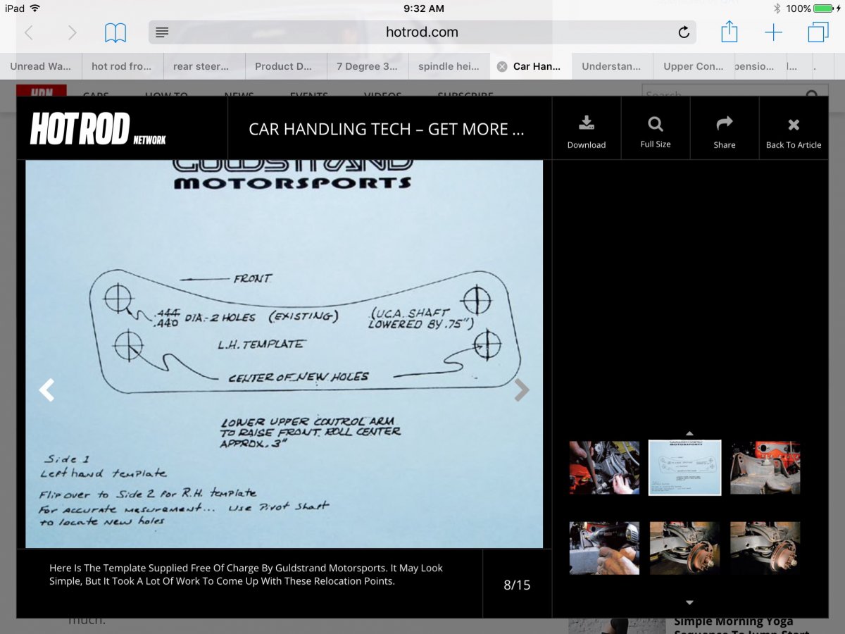

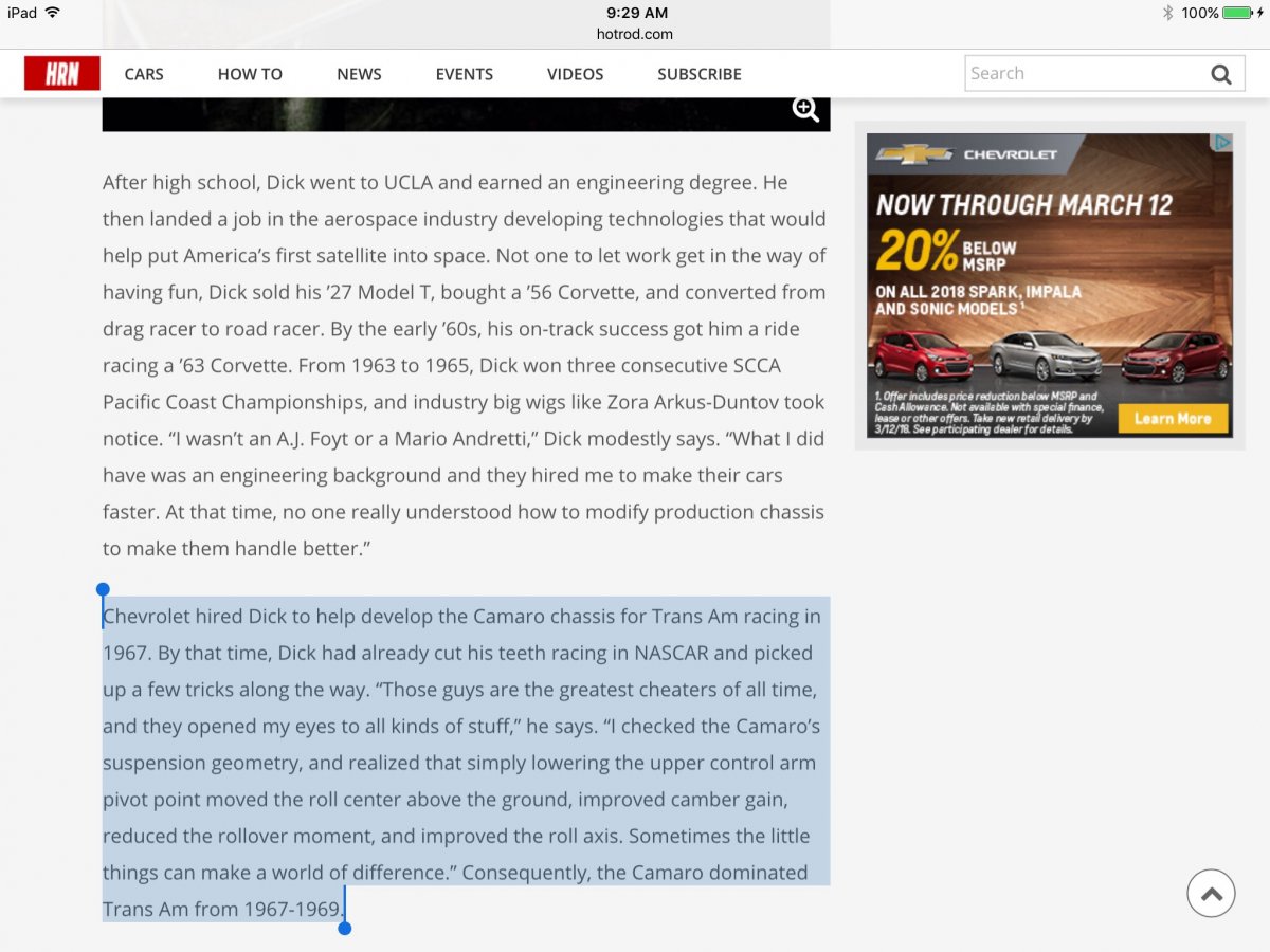

  25. I said was just going to stick to the milk and baby food and leave the meat and potatoes out , but If you're up for a read, check out the link.
    So one might begin to wonder,,, if 3/4" of a move in the right direction means this much, well what the hell happens if it's moved 1-1/4 in the wrong direction ????? My first guess would be that it matters greatly -
    3/4" + 1-1/4 is 2" right?
    http://www.hotrod.com/articles/0607phr-car-handling-tech/
