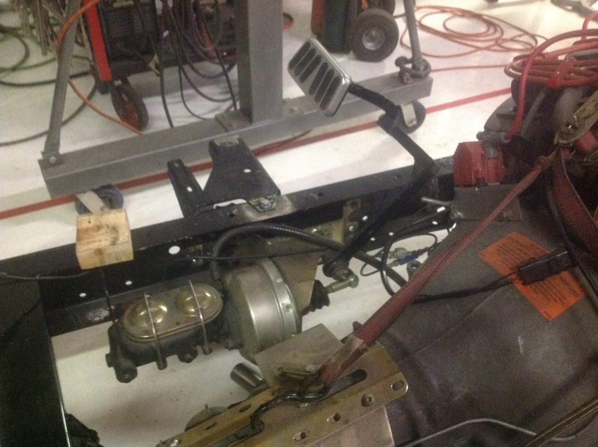

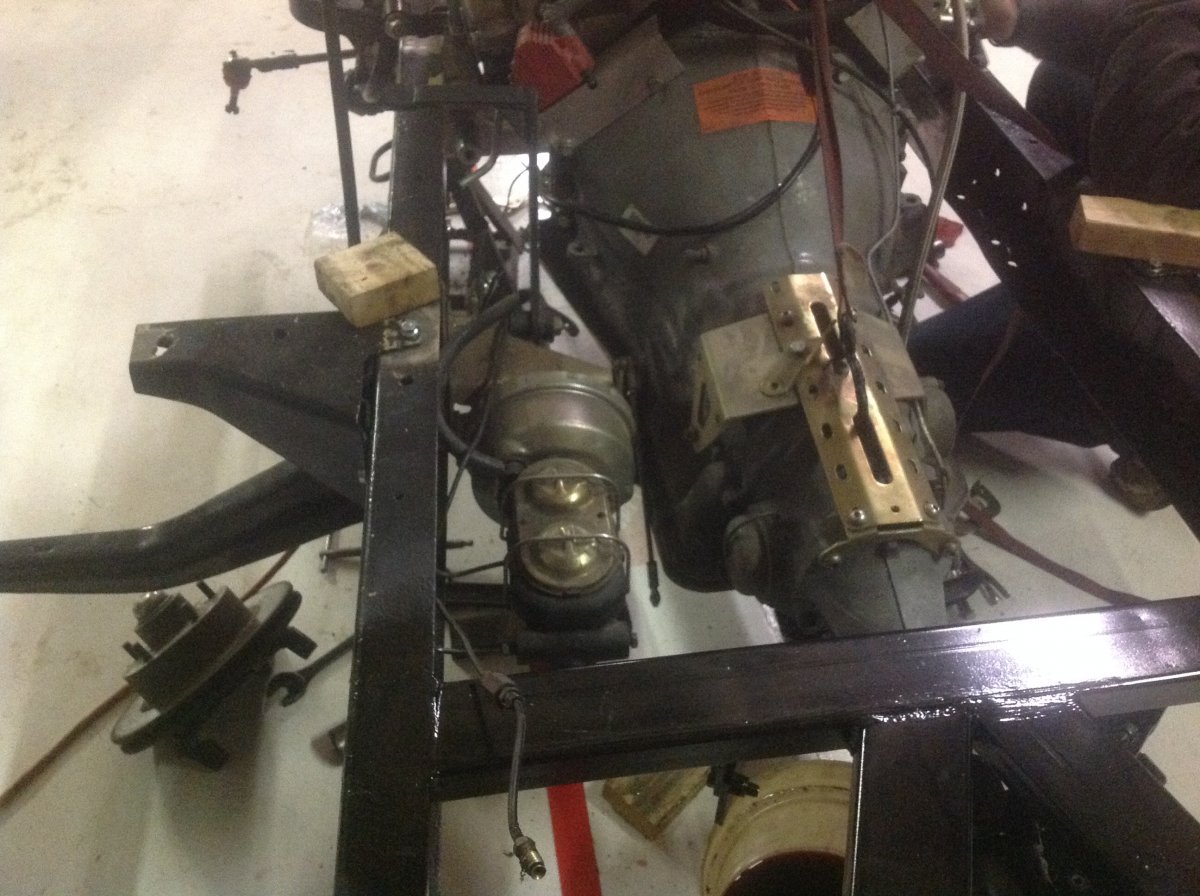

  1. Now here's more geometry- brake pedal set up
    And
    More spatial awareness - exhaust vs brakes.
    What to do?
    What's right?
    What's easier?
    What to leave?
    What to change?
    You can see there's no room for a pipe thru here
    So they went under the booster with a really low hanging pipe.
    Repeating That option is out furrrr show, noamsain?
    I could go around the front and run both pipes down the the p***enger side then cross the tail pipe back over like a late model, Seem like a lot of extra pipe right?
    Lots of fitting & cutting , really particular work to snake it around up front. I'm guessing it results in at least 200 rounds of hot rod aerobics ( get on the floor under the frame get out and get back up - that's one)

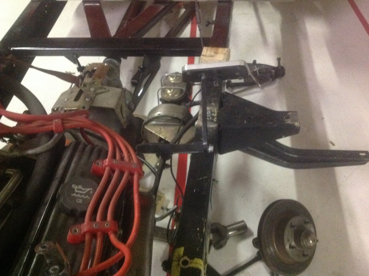

    Then we have this mad scientist's misjugjment and minagurupartshanger's menagerie that plays like the sweetest carcophony music I've heard in a while.
    WTF really??
    I could redesign the brake pedal & booster. Slide the pedal over, reduce the ZBar, Move the booster back and run a long rod to it and hang the master there. That puts the acess under the seat Which apparently is a problem (thanks seat guy) Then the pedal would be right, room to bring the pipes thru, and the brakes pretty damn close to OK.
    Or I could mount a booster off the firewall and really make some changes.
    Probably not much harder than moving everything.
    You know, for ****'s sake all this **** really matters.

    That brake pedal, whatd they do just stick s**** together until it got to where it should be? I bet it flexes nicely when you try to stop. And the angle iron coil mount, well not unsafe, but really not pretty at all. Gonna have to go back and look at the rest of the pics now.
    Didn't seem so ****tacular up until here.
  3. ****tacular :)
    Lots of info and ****tacularness has been removed. There's a whole bunch of ****tacular stuff that's off topic here but worthy of the highest honors in the realm of ****tacular.
    That coil bracket is dumb as hell, but the least of the issues.
    loudbang and Johnboy34 like this.

    Did the brake pedal feel spongy when you drove it? :confused: Bob
    31Vicky with a hemi likes this.
  6. Like I said, it sorta stopped ok, but the pedal stayed down. You had stick your foot under the pedal and pick it back up. However I could not get up to enough speed to really get a good feel on the brakes.

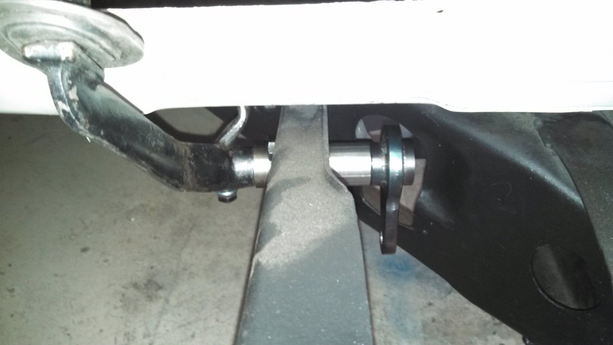

  10. Anybody ever seen a brake pedal mounted out side the frame rail?
    I haven't seen it, I could do it, but I am not sure it's the best thing to do.
    Apparently they do it in Australia
    But the bushings in the frame rail, put the little end and rod inside the rail, big end and little end on a splined shaft. Doable
    loudbang and VANDENPLAS like this.

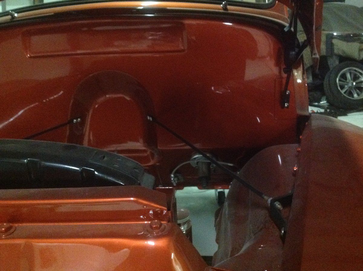

  11. Wow !!
    Like I say it has to steer and stop, it’s nice if it goes and looks good while doing the other 3.
    The fire wall looks nice and clean
    What about a small booster painted body colour ?
    Or a manual master only?
    Sized right they stop well, as I’m sure you know.
    That brake setup was an afterthought
    They needed to get the “ pretty” right first ! Lol

    i can't see any problem putting it on the out side of the frame. jeeps did it with the clutch pedal for years.
    loudbang and 31Vicky with a hemi like this.

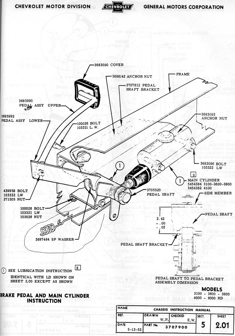

  14. Well I just got word that "I'm not allowed to **** up the firewall" . The nerve of some people I tell ya :p:D

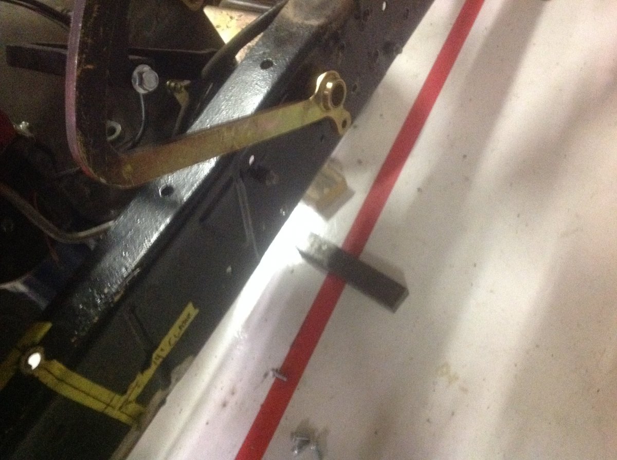

    So here's the pedal plan
    If you get it without the fancy cad cartoons and multicolored animations you're doing well because my chicken scratch is bad especially when I'm in a hurry.
    VANDENPLAS likes this.

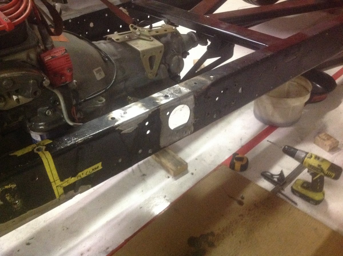

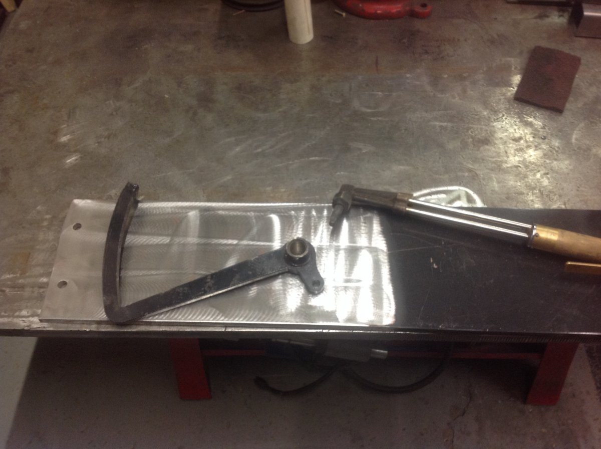

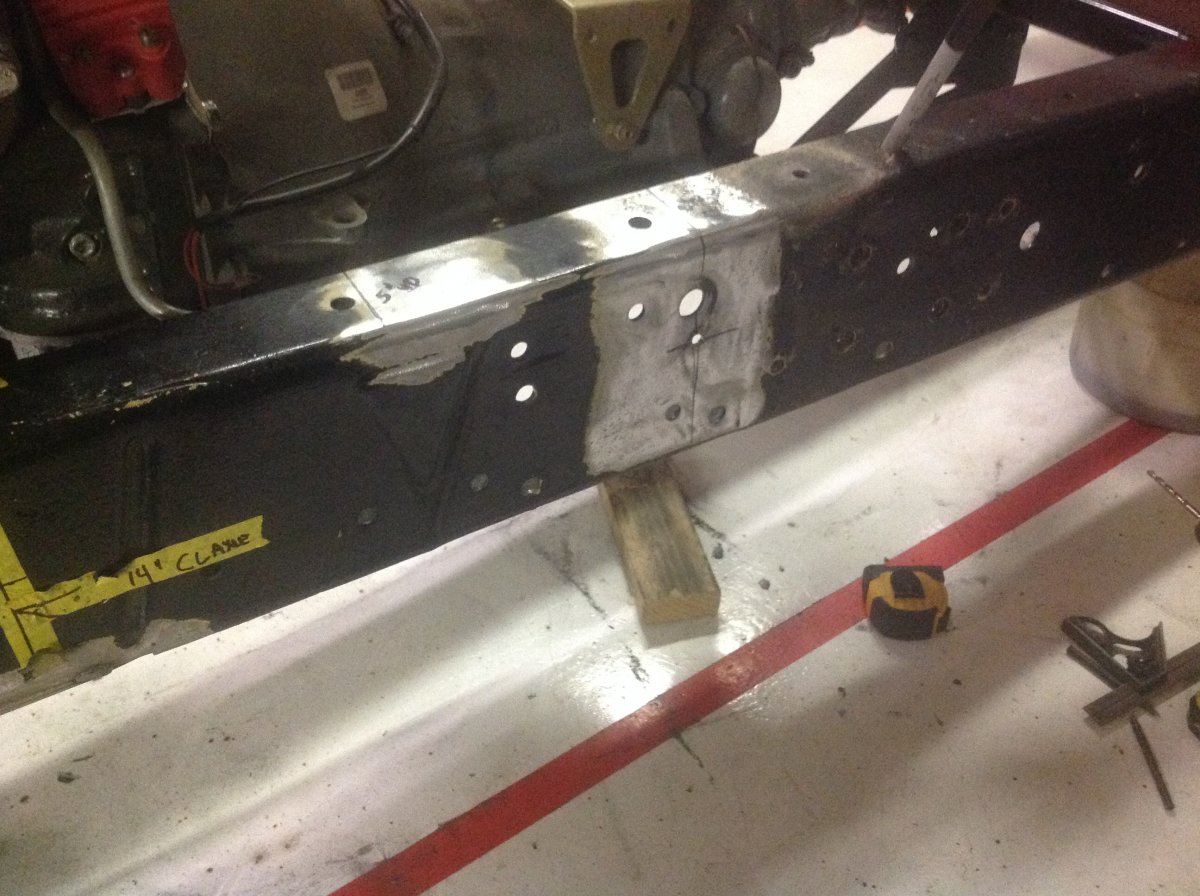

  15. Here we go!
    Got some reference marks, and a plan, parts ordered..
    Right where it's going is a bunch of extra hole, and lots of irregular change in the shape of the frame rail due to stamping.
    So get rid of it
    I'll weld a flat piece in there that has the change the way I need it to pull this off.
    Since the frame is tapered & I'd prefer it paralle to the ch***is center line at that point that's what it's going to wind up.
    Since I have a plate, a pattern and a torch,, I can make a brake pedal. That will in the moarming since I'm getting drunk and not making sparks.
    If I do this right it should have full swing without crashing into the frame rail.
    They had the Z hitting the frame rail.
    loudbang, VANDENPLAS and Dick Stevens like this.

    Ford produced 15 MILLION Model T's with an outside hand brake, concept is the same. Were did GM place it on all those AD trucks? Bob
  22. tb33anda3rd
    Joined: Oct 8, 2010
    Posts: 17,583
    tb33anda3rd
    outside also
  23. Did they really?

  26. Apparently it's so old it's new again!
    I thought sure as **** I could go 1-800-hot rod on a thru frame brake pedal shaft dealie.
    Nope and I tried. I even tried to get all the parts at one freaking place. Apparently it's not normal ( there's that word again) to put those parts together.
    SOOO It was 1-800 bronze bushings - 1-800 DOM tube, 1-800 steering shaft coupler, and 1-800 tri 5 replacement steering shaft. 4 places and parts are coming from all over the country for a ****ing brake pedal. Now,,,, should I burn the whole pedal out of 1 PC tomorrow or lop off the end with the big hole and just weld on what I need to one of the pedals I already have??? Decisions decisions. Hold my tequila and watch my next trick :)
    I'm gonna invent something
