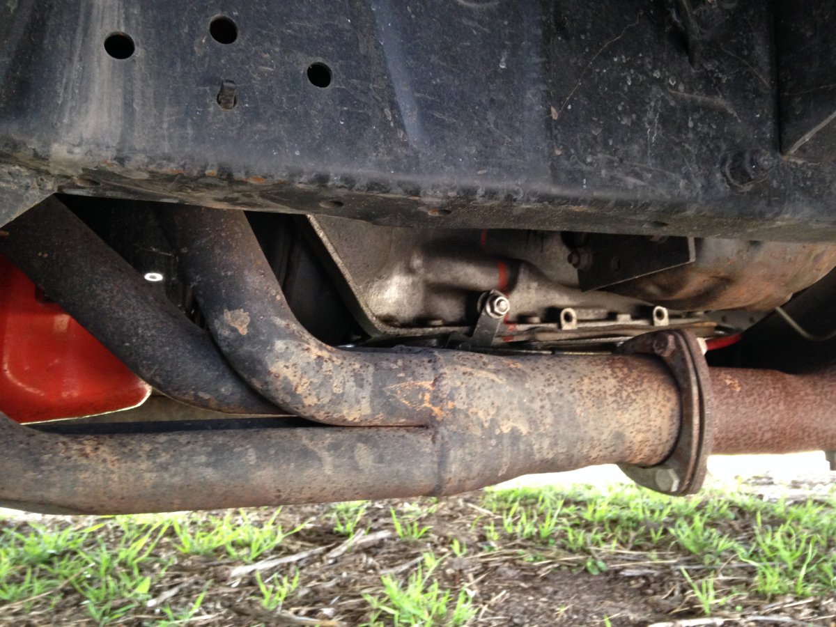

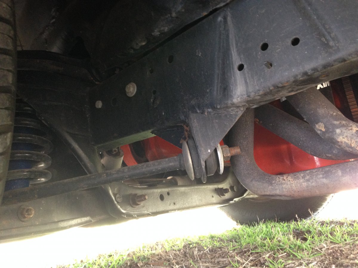

    IMG_2253.JPG IMG_2254.JPG Yes, the exhaust does hang down pretty low. Under the frame rails, under the booster. 52 Chevy truck built by me. Engine sort of in the right place. Normal headers connected to engine. Stock brake pedal on stock bracket. Very small hump in floor to clear th350.
    Oh, 2in drop spindles and blocks in the rear. It's pretty low.

  17. Thanks for the pics
    Looks like a stocker crossmember and parts.
    I wish I knew how to red line pics and ask you for a few measurements.
    Like what's the distance from control arm pivot to control arm pivot.
    And what's the ball joint spread on the spindle.
    Where's the engine's oil pan rail in relation to the frame rail- above, below, even & how much.

    Don't mind measuring what I can, but, be warned when I did this my knowledge level was about a 3 on a scale of 1 to 10.
    It does stop, go, and look pretty though.

    Oil pan rail 3 in. below top of frame rail measured at back of block
    Control arm pivots 10 7/8 rear side upper to lower
    Ball joint spread 9 1/2 " ( that one is kinda rough, where is center of ballpoint?) measured from the plate that holds the boot on. All that stuff is stock. No kit used. Good luck but I know you don't need it!
