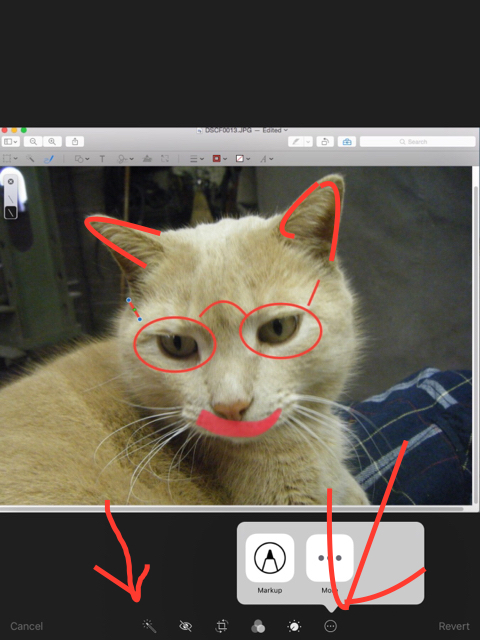

    Using the app? Poke the picture, lower left corner there’s a box, poke that, save picture.
    In iPad pics, edit. Lower edge, circle with three dots, markup.
    Then play with the pens to draw things.

    on the ipad what is the icon on the left for? and why does our ipad not have the icon on the right? [indicated by arrows] faabc7bb64627cad8bd78080c25211d0.jpg

    The magic wand looking thing on the left seems to fool with the contrast and brightness. You don’t have the markup option in picture edit? Dunno. Works on mine ok.

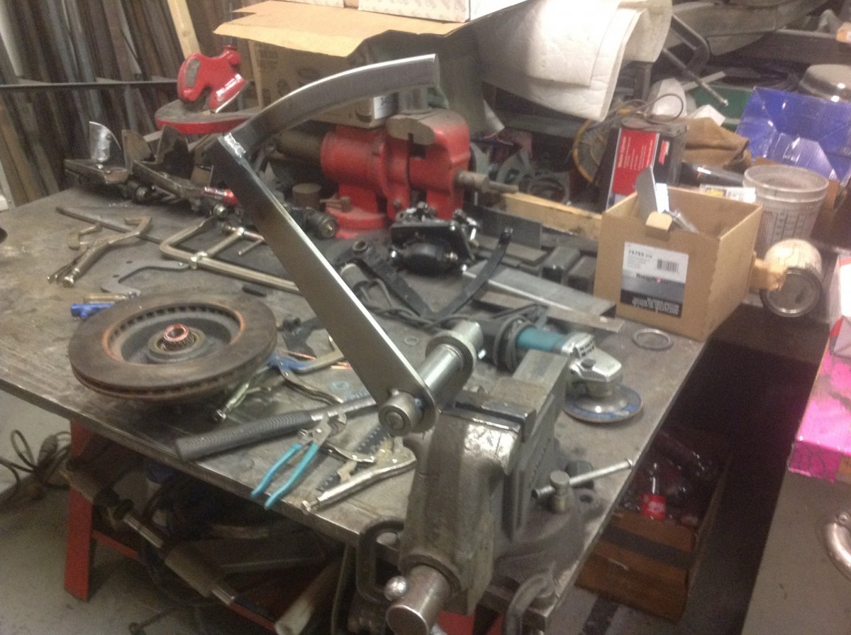

    I see why the big hole now, I think? If it goes the way I think it is, Awesome!
  6. It's still an open option at this time.
    I could switch it up to be on a 1-1/4 solid shaft and a solid 1 piece pedal and arm ***embly. But you'd never be able to change the bushings, the entire ***embly would be a service part.
  7. Johnny Gee
    Joined: Dec 3, 2009
    Posts: 14,368
    Johnny Gee
    from Downey, Ca
    True. But getting the whole ***embly in at what ever angle needed to be able to clear and fit thru (floor board) during the install would make installing a breeze.
  8. RICH B
    Joined: Feb 7, 2007
    Posts: 5,956
    RICH B
    On the other hand; If you made a "one piece" pedal ***embly; a bushing that diameter and width would probably never "wear out" under the use this truck will receive.
  9. hotrodA
    Joined: Sep 12, 2002
    Posts: 7,349
    hotrodA
    The 55-57 Chevy trucks had a big cast bracket riveted to the left inside frame that was a pivot and support bracket for the clutch and brake pedal, with an internal bronze bushing.
    When I built my 56, I ran a crs shaft through the bracket, welded a pedal arm to it with a tapered eye at the top for the stock brake pedal, in the stock location. A thick flat washer with a retaining bolt into the shaft end, on the outer end, kept it in place.
    If you could find one of these brackets, things would be easy. They were for me, and I'm not even close to your skill level. If I took pics, they got purged when I sold the truck
    Used a small booster, dual m/cyl and it all fit. SBC, 350 trans, Cutl*** front clip.

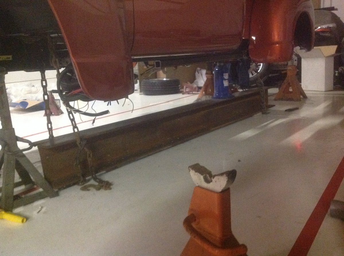

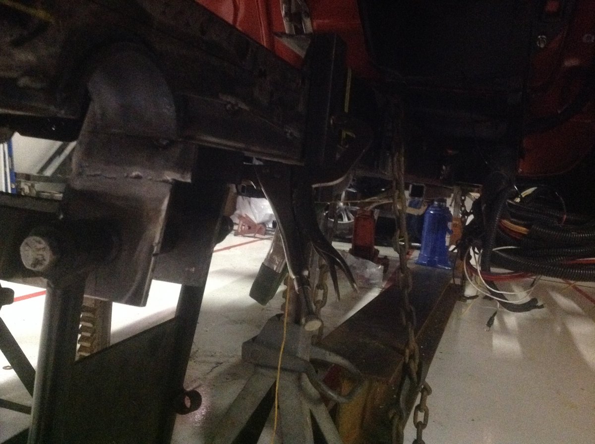

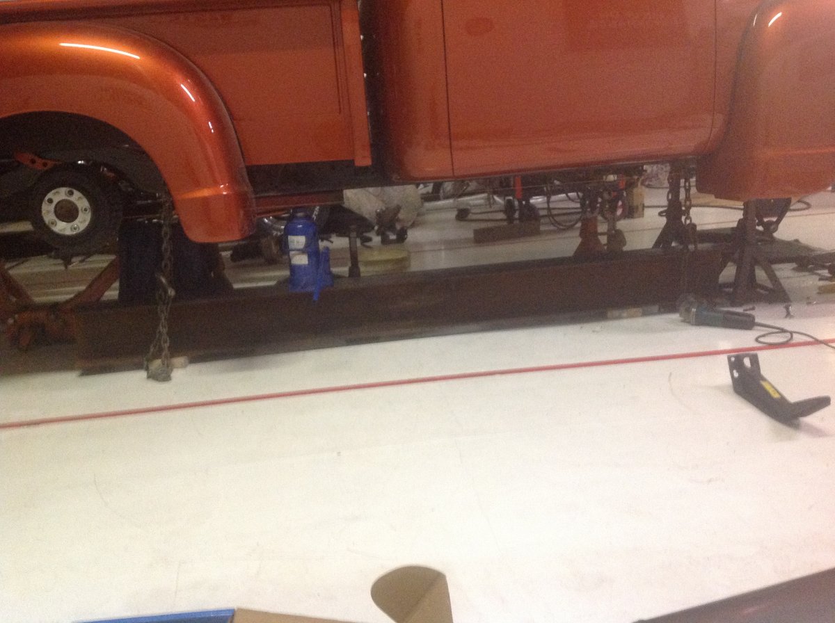

  10. The adventure continues:
    Had a couple hrs at the end of the day to mess around with the truck.
    Let's do something easy, at least get an idea to to sleep on and ponder.

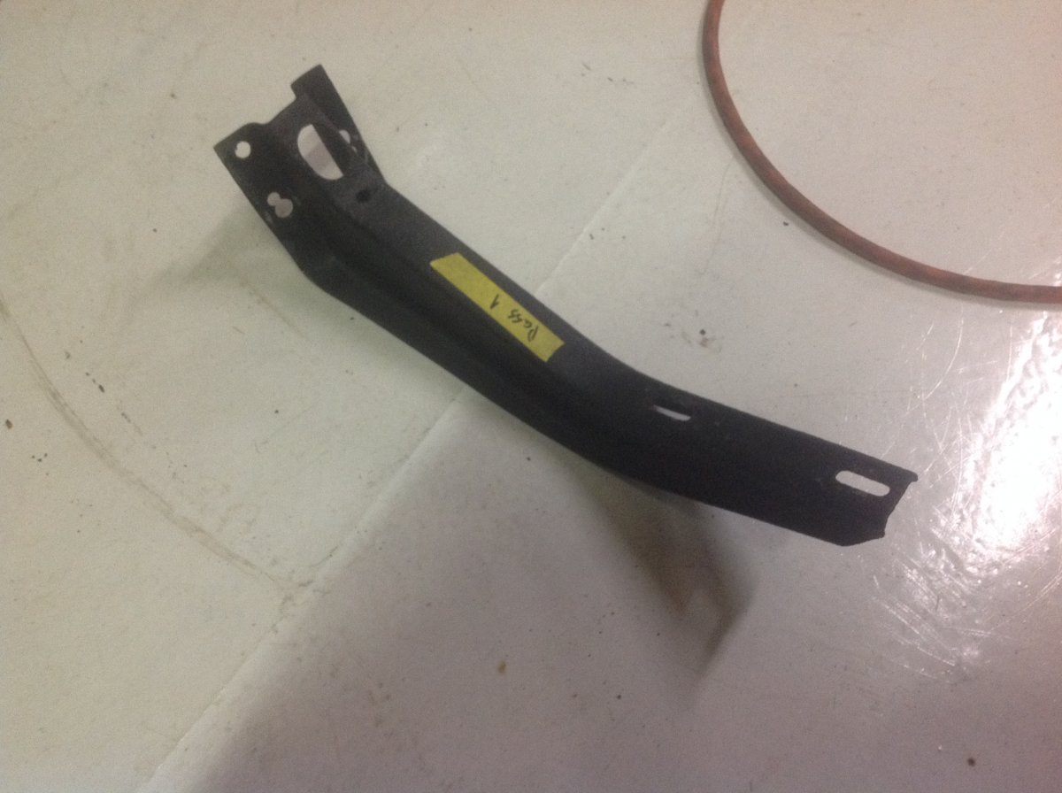

    Was mocking up the exhaust and needed this running board bracket.
    Started wondering why the holes were stretched out. So I grabbed the running board and started playing with it. Took me about 2 mins to figure it all out.
    Turns out the running board fits like it's supposed to and its in the right place.
    What's off is the frame isn't where it's supposed to be.

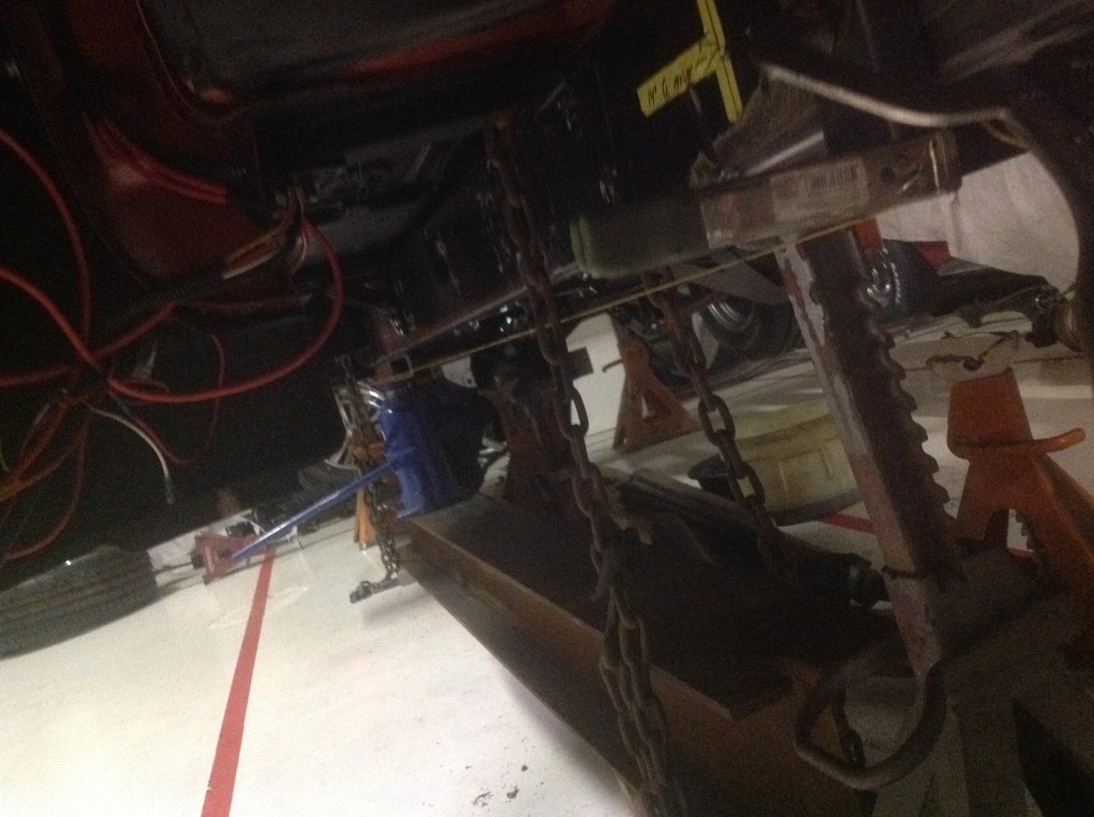

    Ran a string line and the frame is sway backed 3/4". Not quite sure how I missed that before, I even thought I might have done it, then you go back to that running board bracket and it wasn't me.
    Ok great, something easy to fix and fits my time frame.
    Couple hrs and the frame is no longer sway backed.
    I'll probably end up boxing the whole thing.
    This little set up should be in everybody's shop.
    A heavy beam ( that's a 8x31 I think about 9'), couple good chains and a 30 ton bottle jack. You can straighten or bend just about anything you want or at least figure out how to rig up. Just make sure you have a good lifting chain, not a big box store bulk chain.

  18. this is why Im glad I have frame equipment
    I have a floor anchor system at home with unibody attachments and a floor mount puller
    frame machines make nice welding tables
  19. There's a frame machine across the parking lot that I have visitation rights to. They own it and don't know how to use it. They tell me it won't do what I make it do lol. Pulled some goofy stuff that supposed to be impossible. Phffft :p
    But I'd be kinda ****ed getting that truck over there let alone up on the rack with out the front suspension in it. This is great portable bender un bender set up. We straightened all the cross bars on my trailer with it too, couldn't do that on the frame machine.
