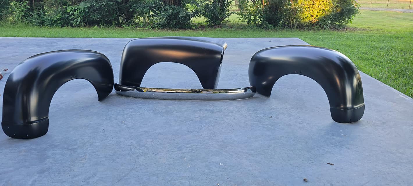

    Well....have you ever accidently purchased something? Or more to the point, some things? I can now say I have. Several weeks ago, while on work business, of all things enroute to a jail to speak with a parolee, I sailed past a metal building that had a huge sign "Toad**** Cl***ic Chevy Parts" hanging on the wall. I'd p***ed it before many times, but never noticed the sign; however I HAD noticed the many Camaros and late '60s, early '70s C10s. This date, though, there was someone mowing the yard. I couldn't resist. I busted a u-turn and pulled in to the drive. A short conversation later, I discovered the lawn mower was the owner, and while he specialized in Camaros, he could provide me with parts for AD trucks. In fact, he was building an AD Suburban for his wife. It developed that he could 1) match prices with the catalogues/websites and 2) could save me shipping. He said he ordered enough in bulk that he didn't get charged shipping and could help out a fellow car nut. As I'd prefer to buy local anyway, it seemed perfect.
    I explained to him about Sam and the fact that we needed two rear fenders, a front fender and a bumper. He agreed to call me when he made another order so I could potentially order some parts, took down my number, and that was it. I figured when he called, I'd order a fender here, then next time a fender, and so on..
    Then came Pe*** Jean, and the swap meet. I rounded a corner and there was my new friend. His eyes lit up. "Hey! I meant to call you!" Turned out, he'd placed an order. He had needed a few more items to fill out the load...yep. He ordered Every. Single. Piece I'd mentioned that I wanted. "They'll be here Monday".
    I immediately wondered how on earth I'd tell my wife. I'd already made an appointment for $250 worth of gl*** work, stashed some cash back for the swap meet- but not THAT much.
    He told me he'd sell them to me a piece at a time if I needed, and apologized for not calling. Shoot. I was overjoyed, if a bit overwhelmed. I screwed up my courage and admitted to my wife that I had "accidently" bought $1300 worth of truck parts, fulling expecting that I would be enjoying the comfort of Sam's newly recovered seat for a few nights. Thankful for the foresight to buy extra padding, I prepared for the banishment. My wife....laughed. She scared me. She didn't holler, or get mad. She just laughed and said I did the bills, I needed to figure out how to pay for it. She said I was gonna buy it anyway, might as well get it out of the way. I'm still worried. No telling what this will cost me in the long run...
    Today, the all important info hit my phone. The order was in. My wife came along with me to pick the parts up. Probably to keep me from accidently ordering something else.
    A truck load later.....and we headed home. The painted front bumper had came in chrome. I would prefer the painted due to the fact Sam is a Korean War truck; however, given the fact that it might take a bit to get the painted bumper in, we took the chrome one. I figured if my new friend could get a painted bumper, I could always sell the chrome bumper.
    I couldn't resist a pic of Sam's Christmas in July, aka my accidental purchase...after all, we had to check for damage, right?

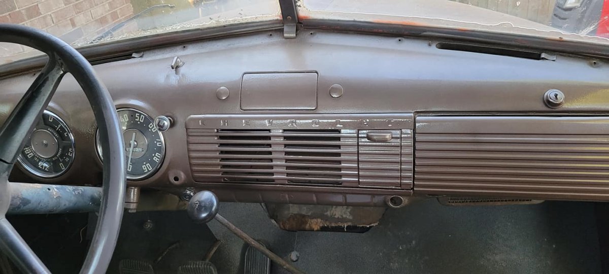

    Finally had time to do a little bit of playing with Sam. I dug out the headliner and the inside windshield trim. Took 3 trips to the local hardware store to find the right screws, since I was hard-headed and kept grabbing the wrong size. It would've made too much sense to find one, test it, and buy what I needed the first time. Me being hardheaded, I wound up stocking up on screws.
    And Sam had to fight me, as usual
    Headliner is in...but if one looked close, all is not well on the p***enger side. On the LAST screw, I was using the cordless drill as a screwdriver, knowing better. Just a bit more...blam. It slipped and now I have to replace a cracked p***enger side windshield.
    I wanted to scream and throw a hammer through it. :mad:

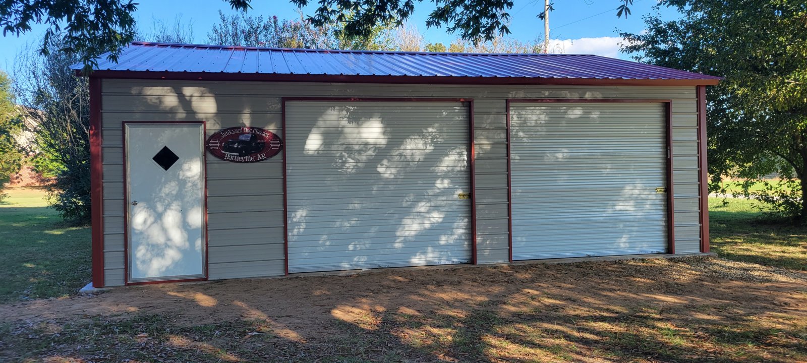

    Been too busy working on wiring the shop and getting it up to snuff to do much on Sam. But, lest anyone thinks I've neglected and forgotten the old truck- we got a little gift in for him.
    As is obvious, Sam is a Korean War year truck, which came with little to no chrome. Painted grill, bumpers, hubcaps....
    Much to my surprise, there is apparently no one re-popping painted hubcaps. On one of the facebook groups there was a guy buying a new set of chrome repros and wanting to part with his original, slightly battered painted caps. Never mind the fact they have been re-painted white at sometime in the past instead of the factory thistle gray, I spoke up and asked to buy them. The man was a real stand up guy- shipping and $10 got me the set. (Pics are from the seller, and on the bubble wrap package used for his new reproductions, thus the labels you see). I'm thinking they'll look grand on the old guy, and may repaint them. They are no doubt originals- very thick, good metal. hubcaps.jpg

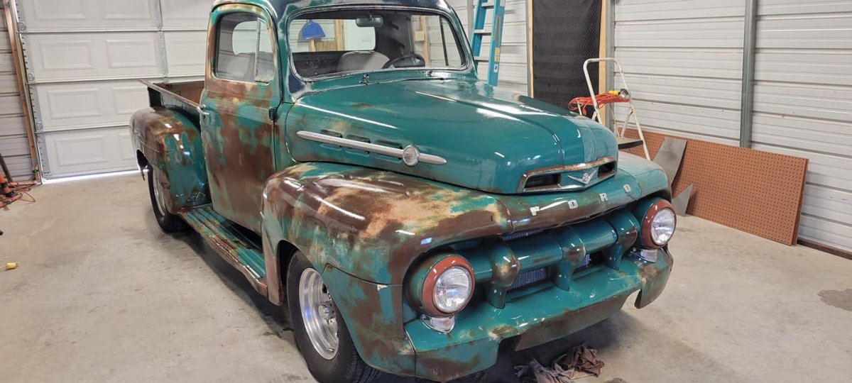

    I had a '50 Ford Truck and was the same color except the paint was completely blistered/pimpled. A friend of mine and I went in together and bought a '50 Chevy that was near mint and original, '50 Ford Truck and a '66 Ford truck. The same man has a AACA"Senior" Black '49-'50 Ford truck. The '50 Chevy was used in the filming of The Last Ride. As far as BBQ I go to the Shack at the Morgan exit. lol See you guys a Pe*** Jean.

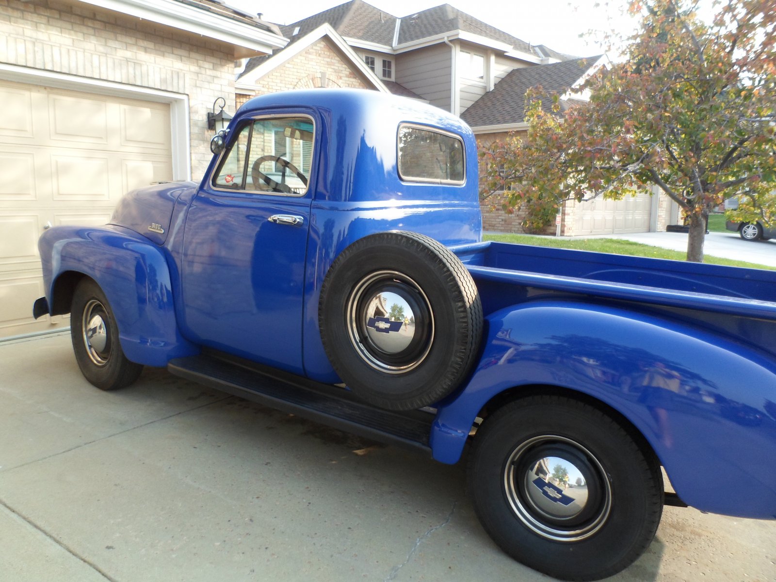

    Great, great story. And what a great day it was for Sam! My grandfather had a '48 Chevy truck and
    as kids spending our summers with him, he drove it all over Arizona, with a pint of whiskey down on the
    floorboard and a snuff spit can as well. I have owned my '54 for 30yrs, buying it from the original farmer
    in Wyoming over the phone, sight unseen. I have driven it all over Colorado and Wyoming with never a
    problem. These trucks never let you down. Thanks for your story and take care of your legacy. Bob

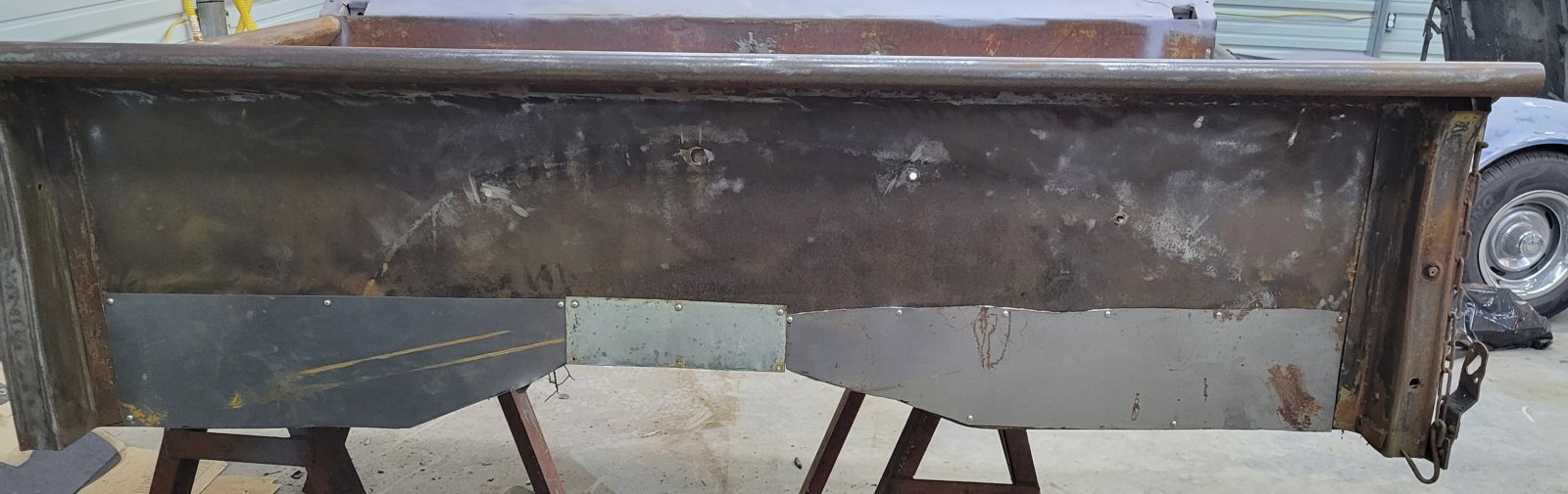

    Had a few moments today. I spent a bit of it stripping rust and "patina" from the bedside of Sam, then ***essed the damage. Old Mr Sam had previously cut a patch about 6 inches tall by around a foot long or less, and used it to cover a rusted through place on the bed side.
    His repair, held on by 6 panhead Phillips screws, had worked for him for 40 years.
    I removed it, and ground the rust away.
    Since the inside of the bed will be bedlinered, and keeping in mind that this is a budget build with little budget available, I decided I'd do a farmer fix. Besides, the majority of this patch will be behind the fender and will get a coating of bedliner as well. I took cardboard and made a couple of templates. Transferred that to spare steel I had. Then I used the dreaded cut off wheel which I still have fear of, and cut out the patches. I then drilled holes and temporarily affixed them with some of Mr Sam's favorite items, the aforementioned Phillips screws.
    So here we are now. I'll epoxy/ 3m bond these the next time I get a chance, then grind down the edges. Then the screws come out, and a thin layer of body filler to smooth the transition.
    Hopefully, once that is done, I can spray some primer on it and move to the next phase.

    Not bad. I took my trusty carpenters pencil and carefully traced the inside radius and the outside.
    My plans, hopefully no later than next week, are to spray a coat of primer on the bedside. On the inner part of the bedside, in the fenderwell, I plan to liberally apply some rubberized bed liner. That should protect the bedside and the somewhat thinner aftermarket fenders a bit.
    All in all, not a big step forward- but a step forward nonetheless. Life is grand.

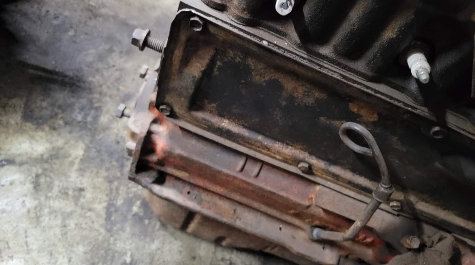

    A few posts ago, I referred to a 261 my brother in law had. We had been negotiating price, but to be honest Sam's other costs were draining the hobby budget and the 261 was placed on the back burner.
    My brother in law texted me a few days ago, after I'd gifted him some tires I didn't need.
    "Come get the 261. It's yours. Don't worry about money, I don't need it"
    After making sure he was serious, I fired up Rusty and went to pick it up.
    I got it home and called one of my close friends, Robert, who is a bit of a Chevrolet straight six guru. He was happy to come over and look, since I had some roller wheels he needed to borrow for his project '47 sedan.
    He gets here and begins to look.
    No doubt 261, casting numbers seem to indicate a 1961 manufacturer date.
    But the serial number..
    " That should start with an F. Not a W9"
    He pointed some other oddities out as well.
    He laughed and said sarcastically "Probably a Canadian Pontiac 261".
    We laughed at the absurdity of a Canadian engine being in rural Arkansas.
    I'd never heard of Pontiac using them and Robert filled me in.
    I begin to try my google-fu.
    Shortly on a chevy talk site, I find a thread where a now deceased member who was evidently very knowledgeable had posted this
    " The Canadian Pontiac 261 had serial numbers beginning with W, and W9 in the case of a power glide equipped car "
    Ladies and gents-
    We couldn't help but laugh. Ole Sammy has to be unique, down to having what is likely the only remaining Canadian Pontiac 261 in Arkansas..
