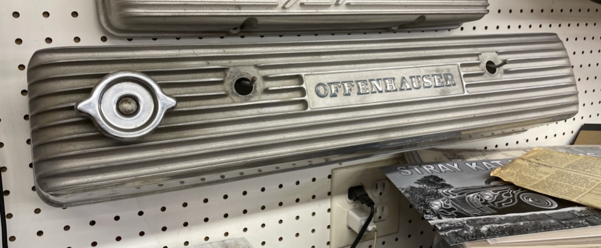

    Lookie here at Dave's generous donation to Sam's resto. It is much appreciated and Sam will truly be styling with this on his engine. 678937404(1).jpg
    Only problem I see is now I'm gonna be looking out for all things finned. This gift has the potential to cost me more than the motor rebuild will, since I am slightly obsessed with the finned look.

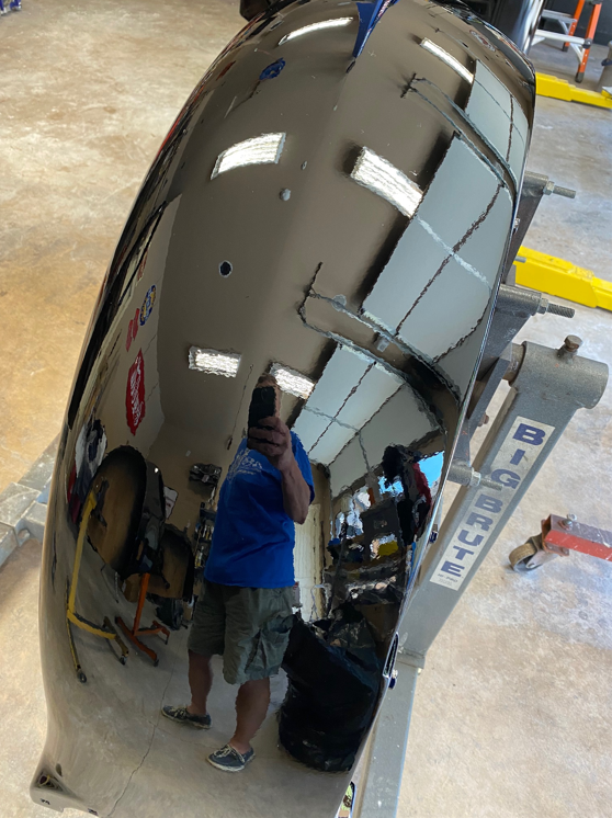

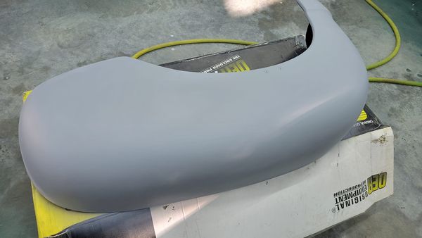

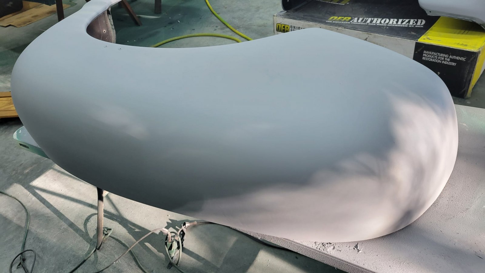

    Well, since my last post, I sprayed the other fender and had a terrible oops. Apparently, I thought I'd grabbed a clean tack rag, but wound up grabbing one with solvent on it. Big mistake. Paint wrinkled up terribly. After trying to fix it twice with poor results, I got mad, stripped them to bare metal, and primed them today. Maybe this weekend I can try to spray them again, for the last time, I hope.

    I can definitely relate to that. About 25 years ago, I just finished blending in the repairs including fixing the flames on a Harley fender. I finished unmasking the flames and went to grab wax and grease remover to make sure I got all my fingerprints off prior to clear. This was sometime after midnight and I accidentally grabbed the lacquer thinner...and wiped most of the flames off... I was sick and still remember that one.

    Try to paint panels in the orientation they are on the vehicle. Doors standing up as well as fenders and tailgate. Otherwise when everything is bolted together the panels will appear to be different shades. (Tradesman panelbeater/spraypainter)
