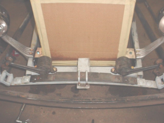

    heres a pic of StevieD's front end of his T sedan, we finaly decided on how we were going to put the shocks on the front, they are 46-48 ford rear shocks mounted sideways.

    Looks like a good choice.How late did Ford use those shocks?
    I hope your running the tierod behind what looks like a '40 axle.

    It not acualy StevieD's car its his wifes car!!!
    fors used the same shocks (style, smoe mount diff.) from 28 up to 48, and it is behind the axle or it will screw up the ackerman theory!!
    [/ QUOTE ]
    Right.
    And it looks better.
