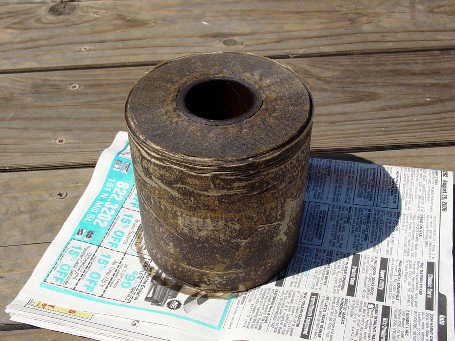

    Funny this post came back.
    I just changed my first TP roll after 2500 miles this morning. - See picture.
    I plumbed mine in parallel with my Wix full flow filter, instead of draining it into the crankcase.
    The flow is slower, as it depends on the pressure difference of the inlet and outlet of the full flow filter, but it still works perfectly. I just don't have to change the TP roll as often.
    Changing it is easier than the full flow filter. A couple of minutes and no mess without one drip of oil.
    The only time you hear someone poo-poo this filter is when they use it as intended and without having any personal experience with it in oil filtering.
    The engine's oil system is no septic tank with enzymes and as you can see, no paper fiber has been dissolved.
    This is with Rotella Diesel oil, which has 50% more detergents and 100% more dispersants than regular motor oil, so the oil should be darker on the dipstick, even with my new engine.
    Before I used the Frantz, the oil was almost black running the same distance.
    I get the TP directly from Frantz and the couple of dollars per year are like a minor donation for their efforts over the last several decades.
    This is not intended as adverti*****t - I am just reporting my personal experience and of course I am happy with the results.
    I like simple things that make sense and work well.
