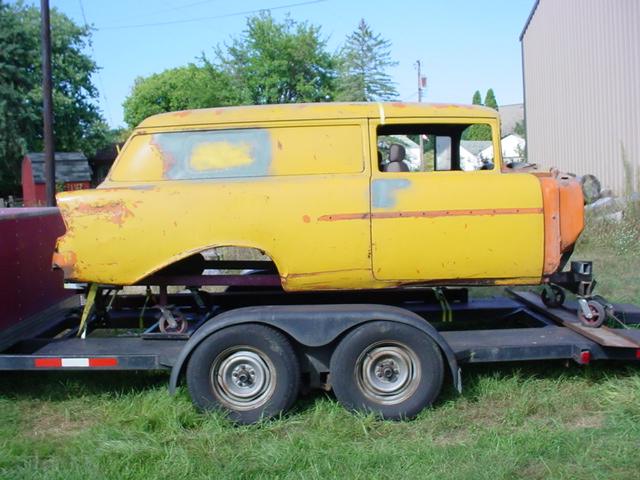

    What is the story with the 64 Mercury in the photo? PM if deemed off topic thanks!

    It belonged to a young guy and he sold it for a Demo derby car. It had actually sat to long(I Know the guy who bought it). The frame was roached from sitting to long. it had mice in it BAD and their nest's/ remnants held moisture and destroyed it.

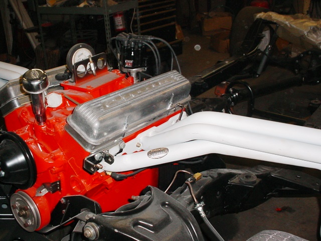

    The 57 Olds rear is in. My buddy Bill had a set of Caltacs off of his old Nova stocker and with a few modifications, they’re on. I may make a set of ******* bars for it if these just don’t fit the look, but I’ve used Caltracs before and was always happy on how they performed. So far Bill has offered a motor, Caltracs and hopped up the Powerglide for the project….Thanks Bill!

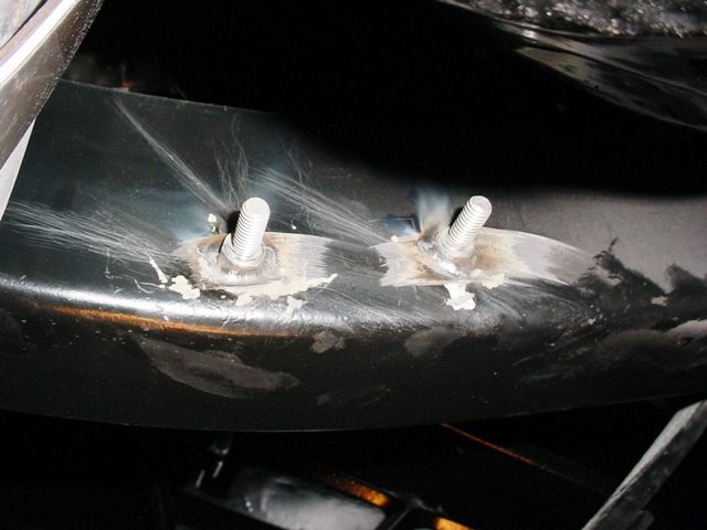

    Another hand me down.....my friend Eric updated the fuel system in his race car so he dropped off his Holley black pump and regulator the other night and donated it to the project........THANKS Eric!
    Welded a couple 5/16" bolts to the frame and mounted the pump on the frame behind the tank.. I'll open up the drain plug and pull fuel off of the bottom of the tank.

    I don't think it will p*** tech if you draw off the bottom on your race car. Gary

    Thanks, never thought of that. I have the original sender in the tank, but was concerned about the pump pulling the fuel. I think I'll hook it to the sender and do a pump test.
