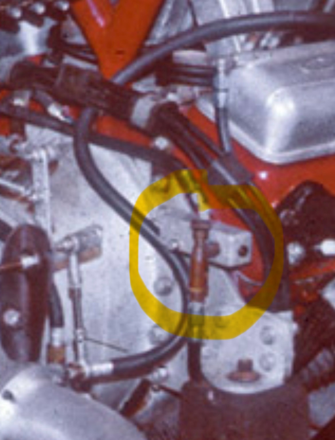

    Tom had the rocker oiling covered @bchctybob , he metered the flow with this valve. He no doubt used the minimum he thought necessary. I’ve seen a couple black and white photos previously but these give more angles and show much detail.

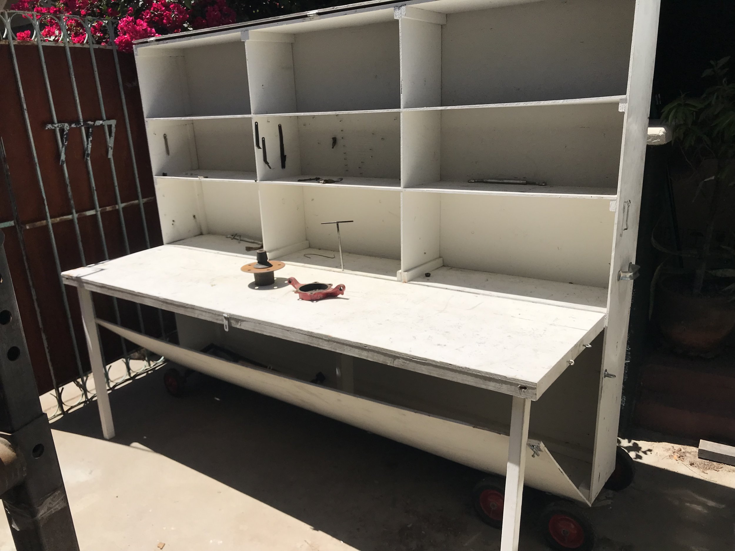

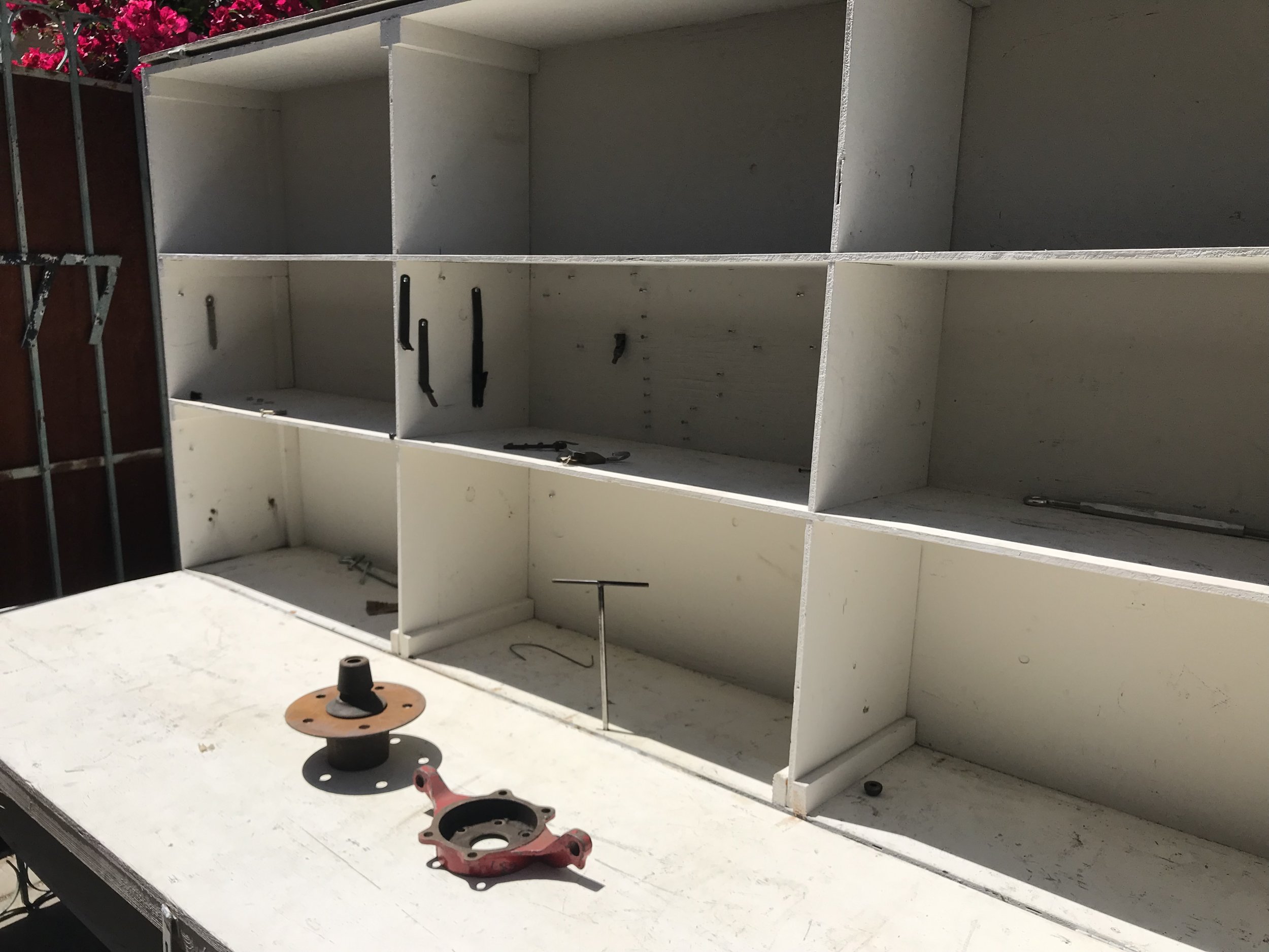

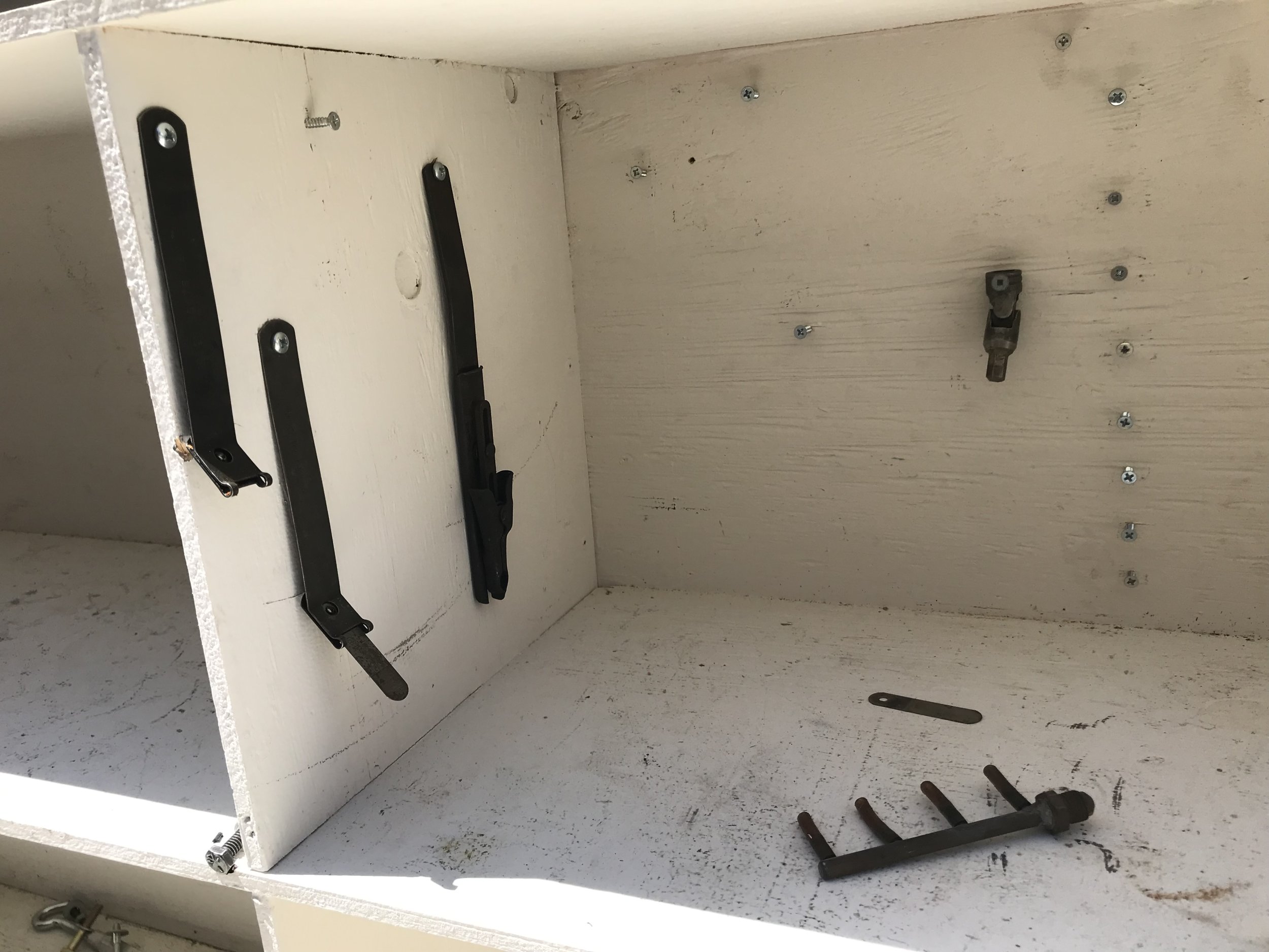

    Here’s the portable work station that Tom built for Bonneville. All the necessary engine tools were stored in there. I have most of his tools and his Bonneville pit tool box as well as his Lathe, 1940s delta machinery and drill press. A lot of Jack Engle custom blower camshafts and handmade radius lifters. Loads of aircraft hardware, his entire AN fitting collection. Tom handmade everything. He had money and could buy anything at anytime but he chose to build a better mousetrap.

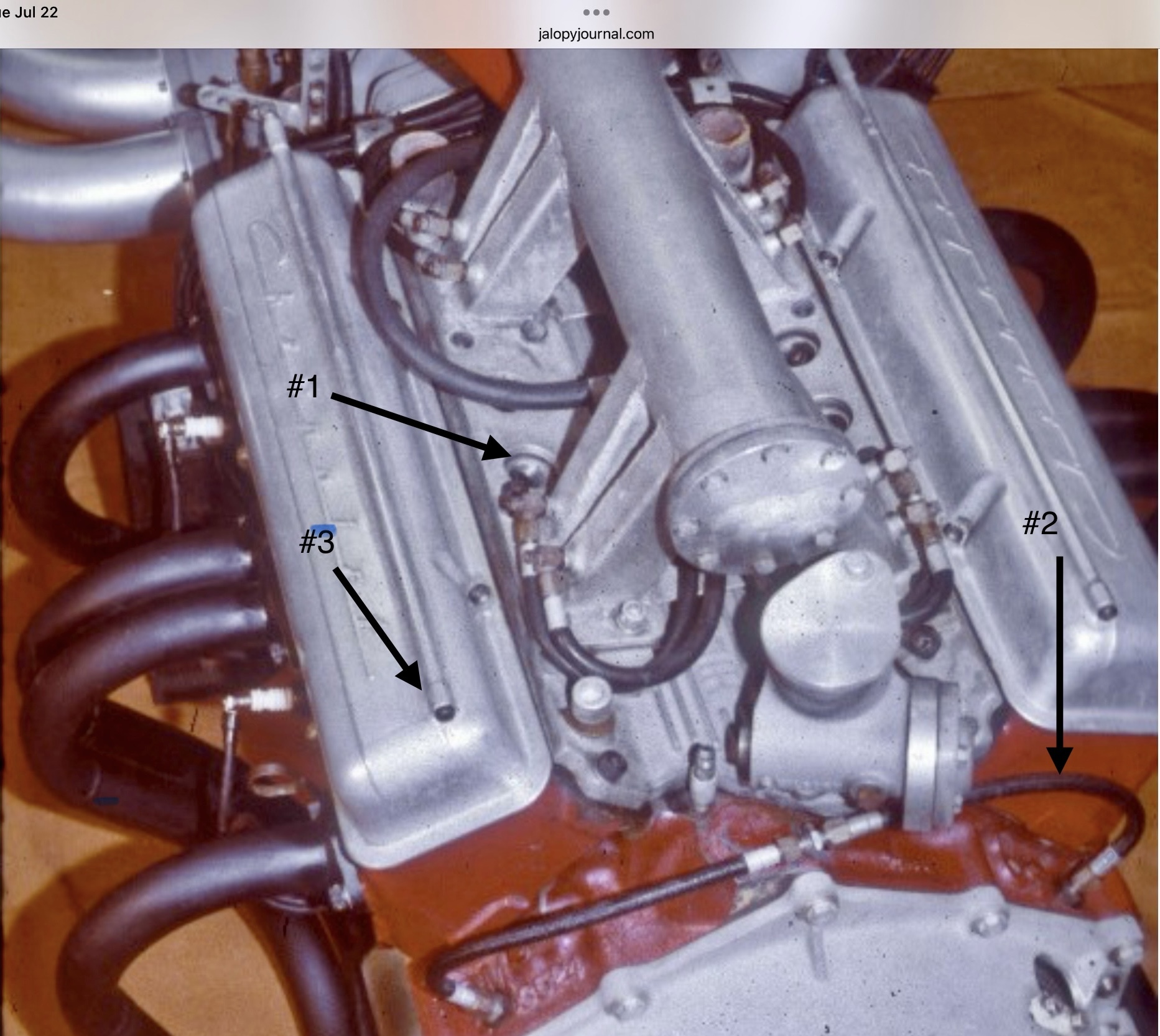

    I think that number 3 in your picture is nothing more than a very precise throttle pivot..... having the support spread over the whole distance of a valve cover takes almost all of the "jiggle" out of the linkage...
