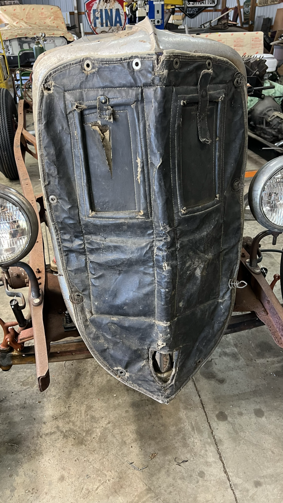

    Scored this killer winter front cover..... a friend found it on eBay and sent it to me. I couldn't pass it up, it came from Canada. Doubt I'll run it, but it would be cool to try it in the winter!!

    Super neat! Was any form of manufactures i.d. or logo attached?

    Not that I've found yet. Was from Canada.

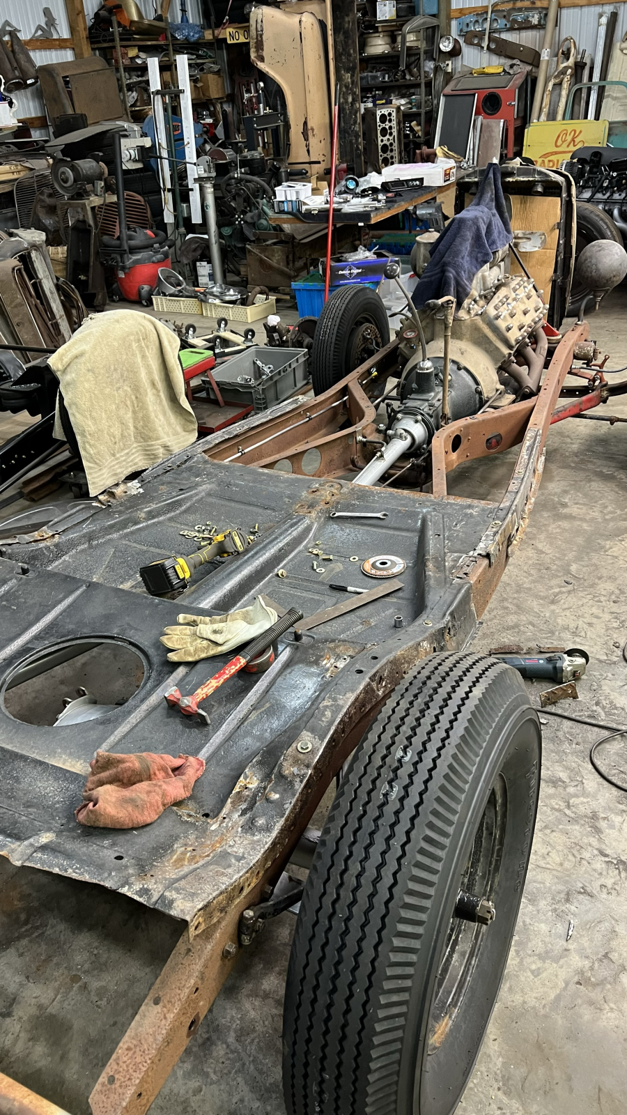

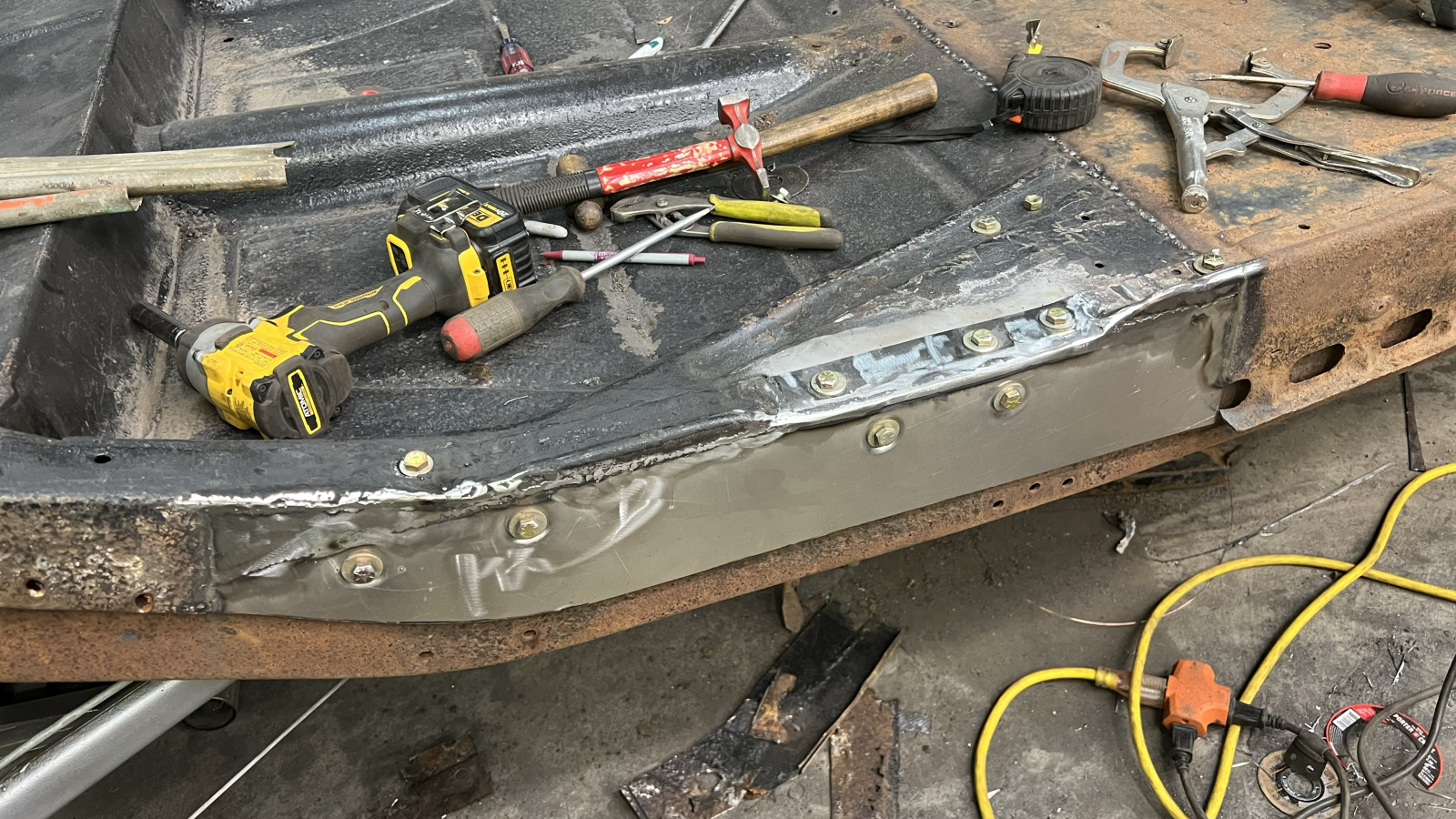

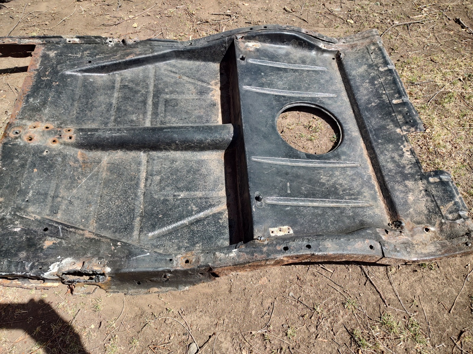

    Getting the floor worked out, found some pieces in the classifieds (thanks @2deuces64) and also had a front section that came with the car.... Makin chikin soup outta chikin poop!! :D
    tempImage49WNKt.png tempImagea8BhL7.png tempImagenOWbSE.png tempImage70OXbV.png tempImage2pxjJ7.png tempImagevneMm7.png

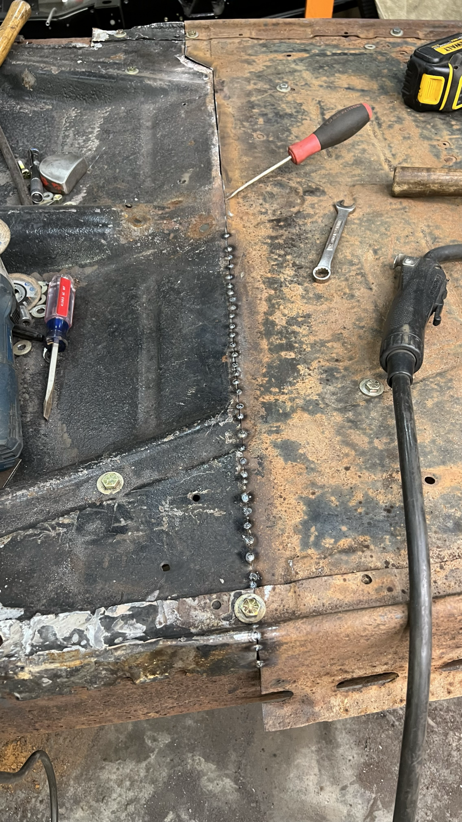

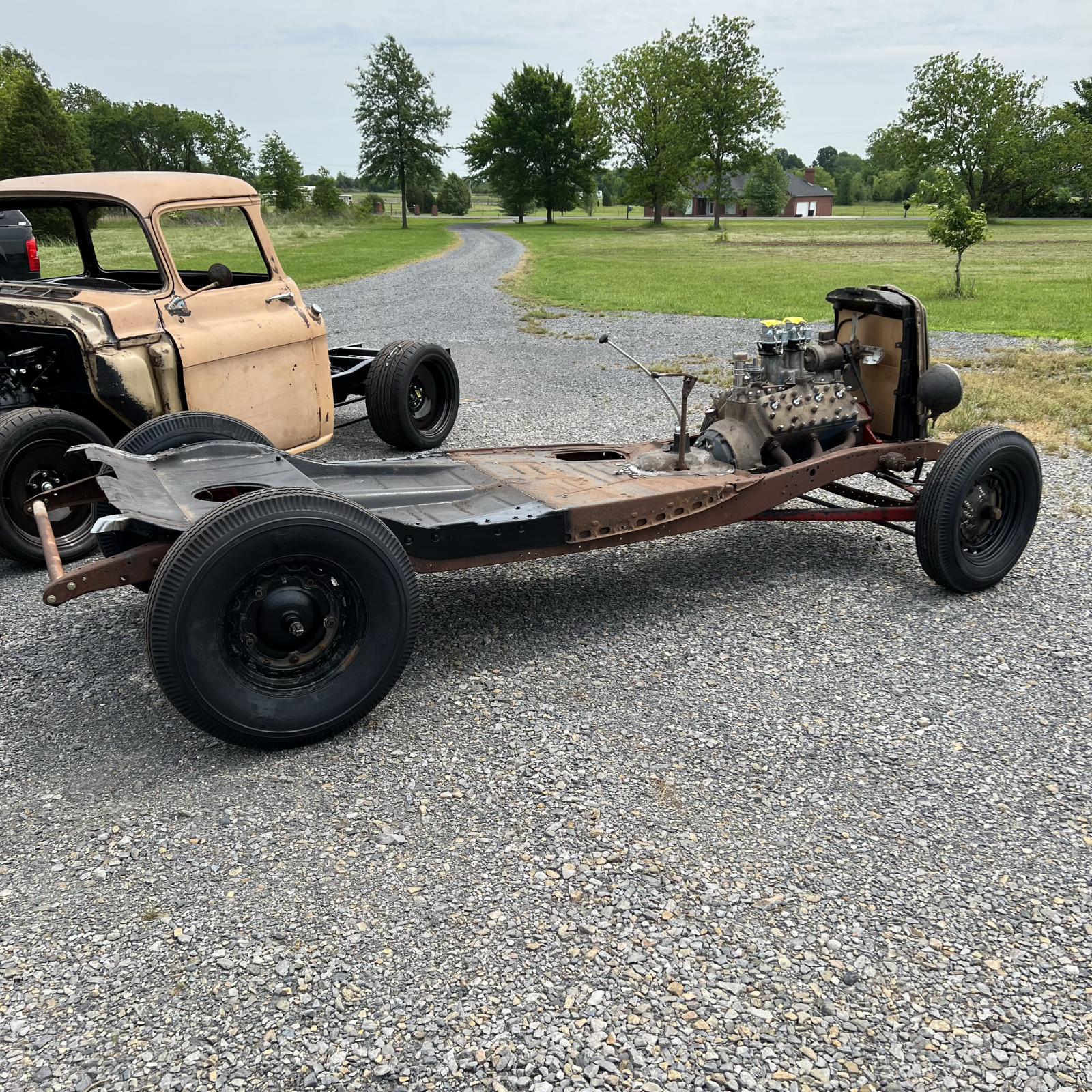

    I just started bolting it down to the frame in the stock location and made my cuts and tacked it together... keeping it bolted so it wouldn't move. I patched all the sides also... still need to do the rear panel across the back but wanted the body on so I could get the right height so it would meet the tail pan.
    tempImageyArlTQ.png tempImageZHJ9IS.png tempImageaKp8CV.png tempImagedETi93.png tempImagemmaJ7C.png

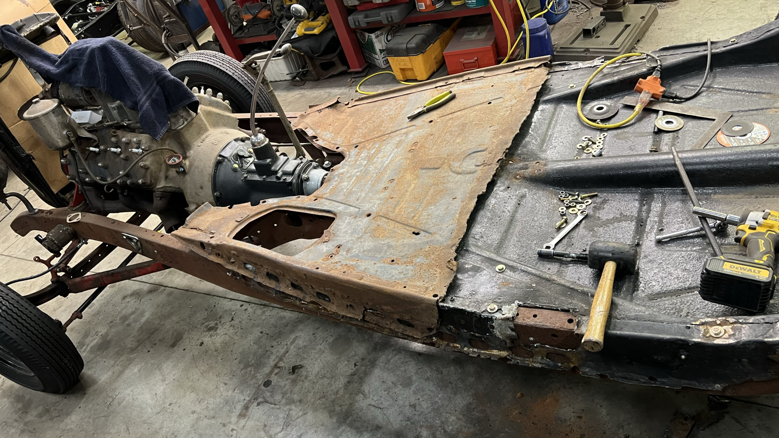

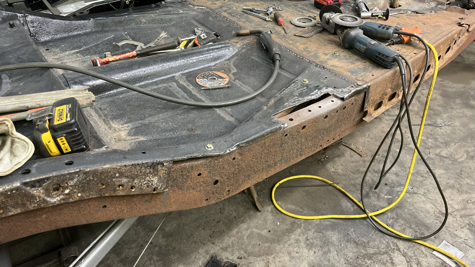

    Onto the firewall and cowl sides... I had a few pieces I snagged from some buddies so gettin that gapping hole filled up. Had to deconstruct some inner toe board parts from a 33 cowl I had to get the new cowl sides to work and for the floor to mount to the frame in that area. Looks like I'll have to make a recessed panel for the fuel pump.

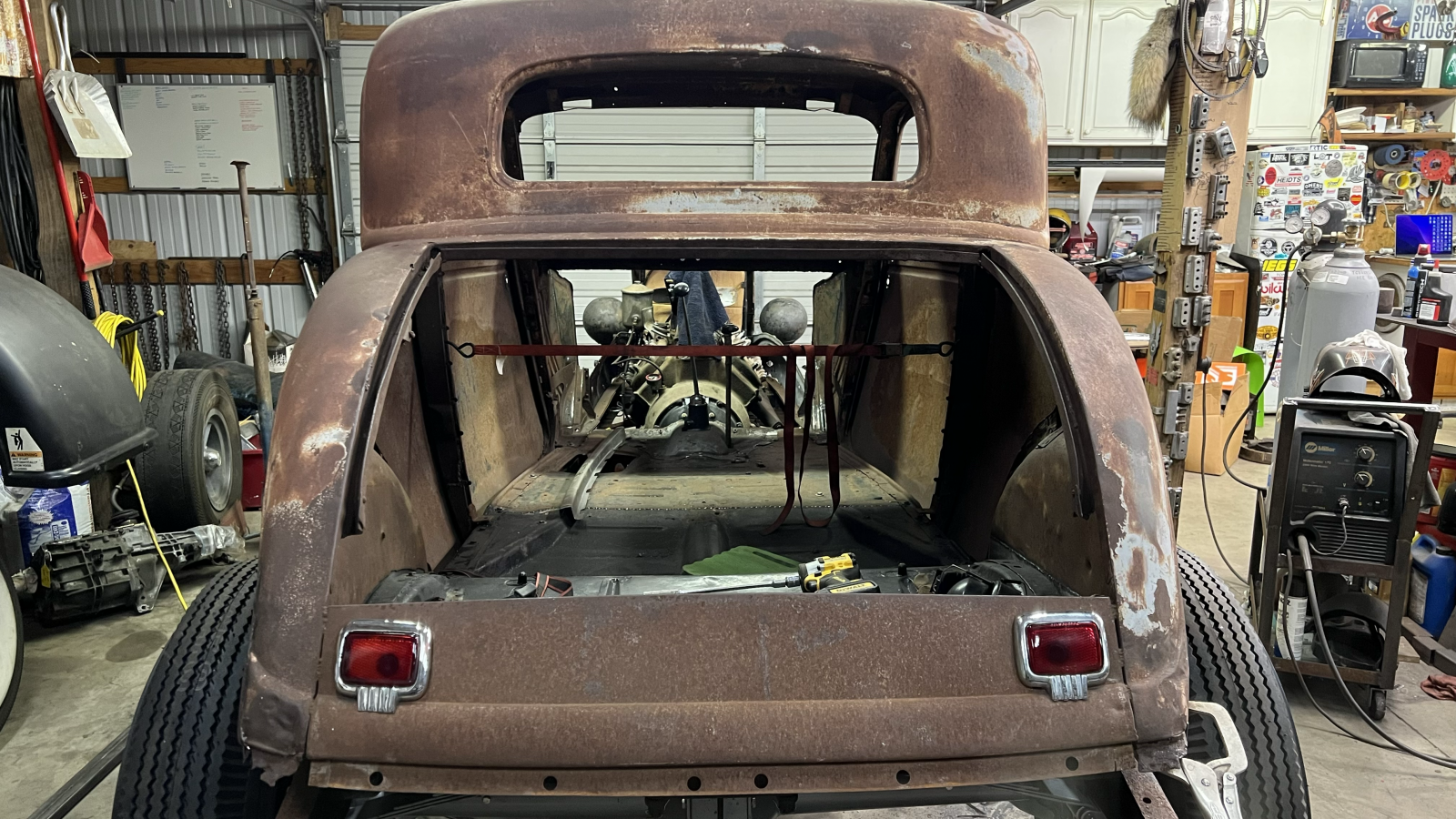

    47 Hudson tail lights... different!
