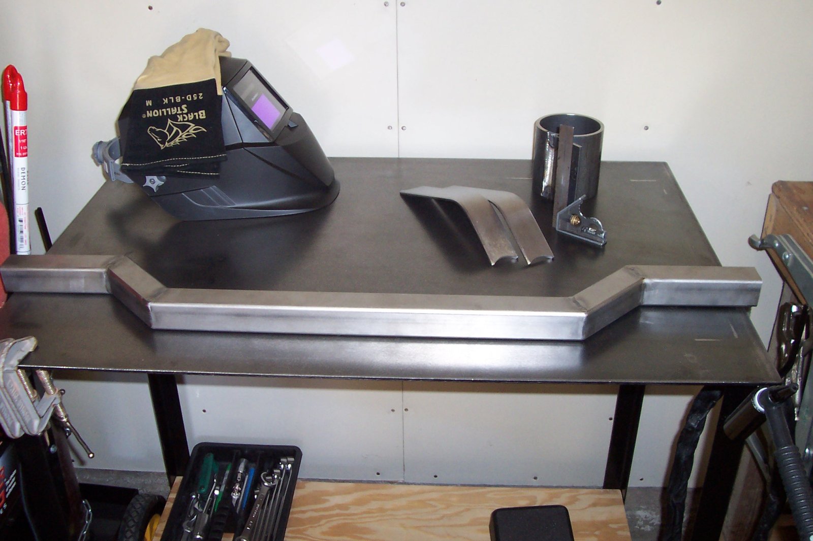

    One of the first things to do was to find a TIG welding machine. I have a Miller wire feed MIG but didn't want to deal with the splatter. I found a practically new Thermal Arc 185 complete with bottle, regulator and cart on craigslist for $600. It does everything including pulse and being an inverter it is small.
    Next was build a small welding table. This was done with MIG.

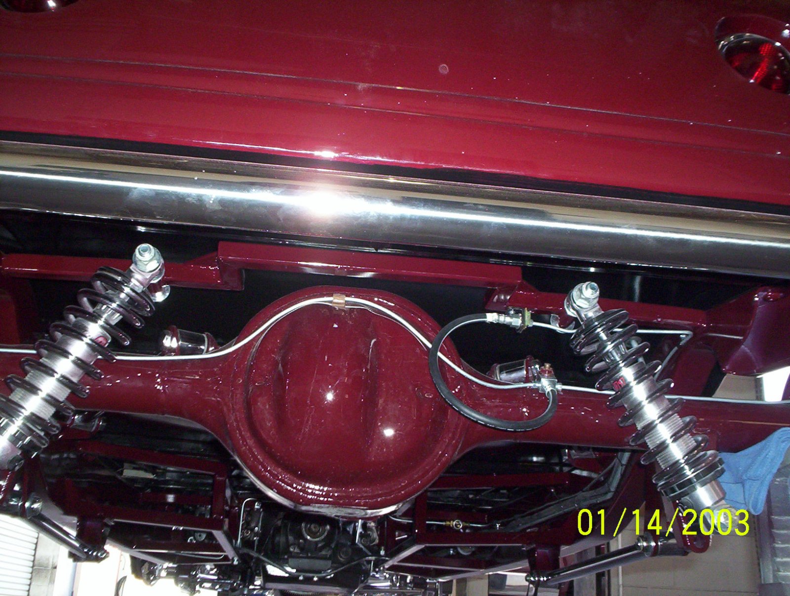

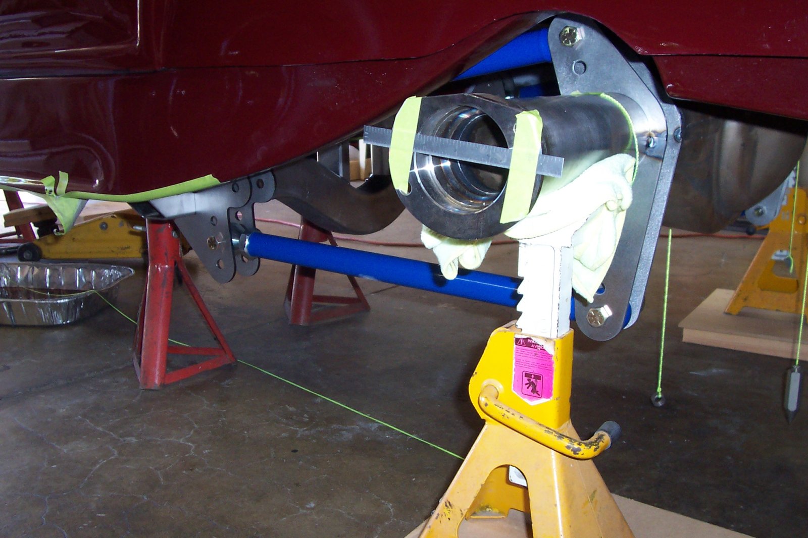

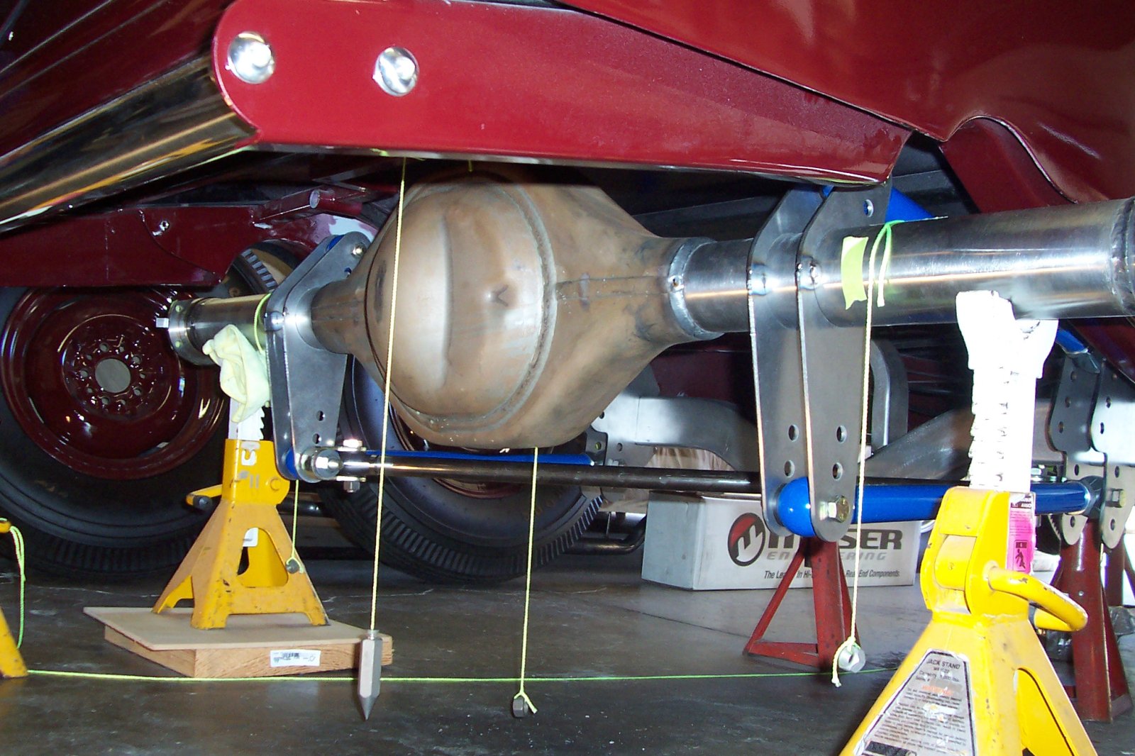

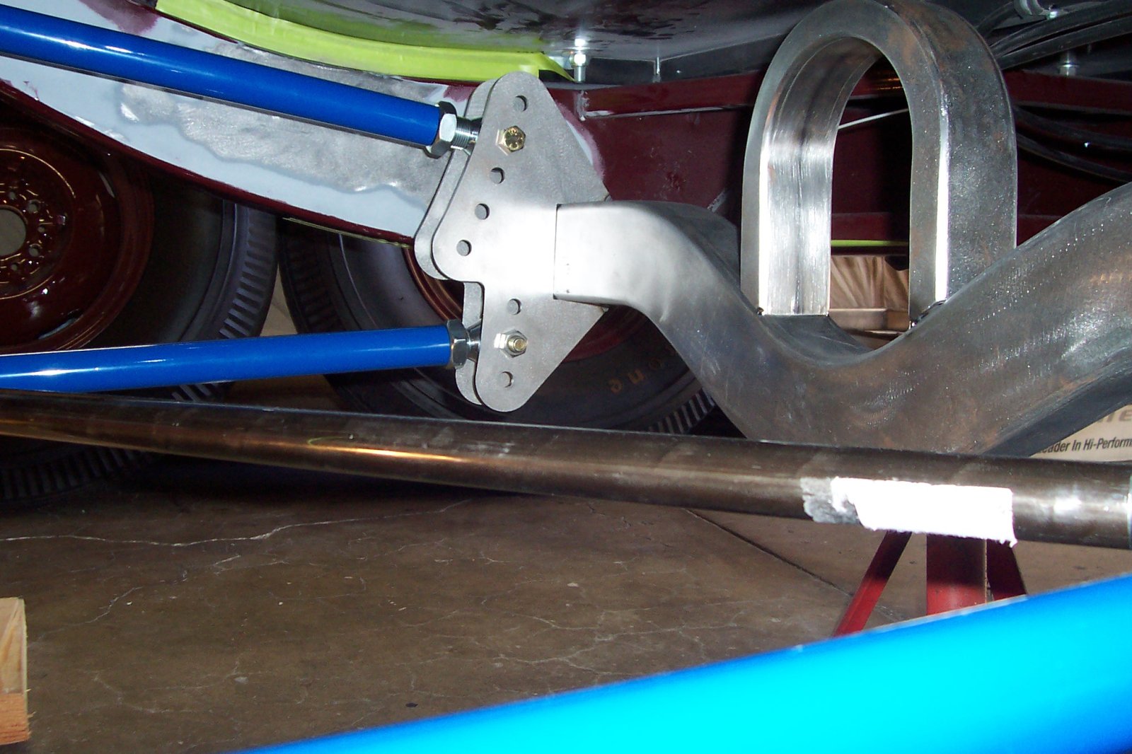

    While the weight and everything was still in the car I decided to cut out the weak 1" rear cross member and all the triangulated 4 link stuff and mock up a new rear suspension using the existing coil over shocks and a new heavier 1-1/2" square tubing cross member.
    This included installing a new heavy duty Moser 9" housing with 31 spline axles.
    After weighing options like the Pete & Jakes ladder bar set up I decided it looked a bit too weak for a high powered car so I decided on this parallel 4 link set-up.
    I wanted something more adjustable, something that does not bind up and something that has some potential to hook. Not full drag race but, something stronger yet still street able. I was thinking I just might want to take this to the track some day.
    I know I might catch hell from the traditionalist's for doing this. :eek:
    Suspension Mockup1.JPG Suspension Mockup2.JPG Suspension Mockup3.JPG Suspension Mockup5.JPG Suspension Mockup6.JPG New rear cross member.JPG

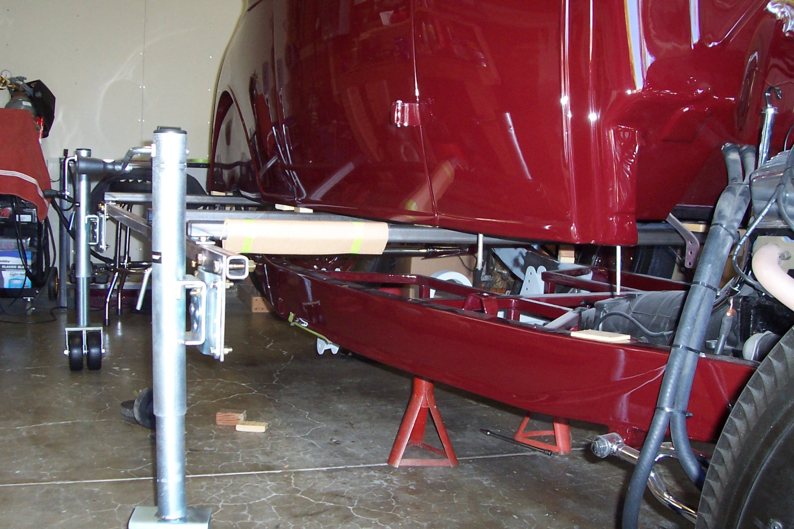

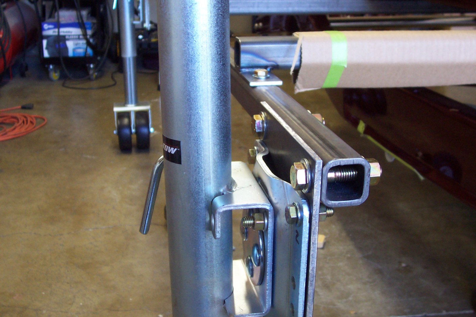

    The next thing to figure was how to get the body off the frame. Some 1-1/2 x 3/16 wall tubing and four trailer tongue jacks, some grade 8 fasteners, a little cutting, drilling, and welding, and walla! It's a one man job and is now on wheels.

    Very ingenious on the body lift.
    I’m going to keep watching. Thanks for taking the time to share.

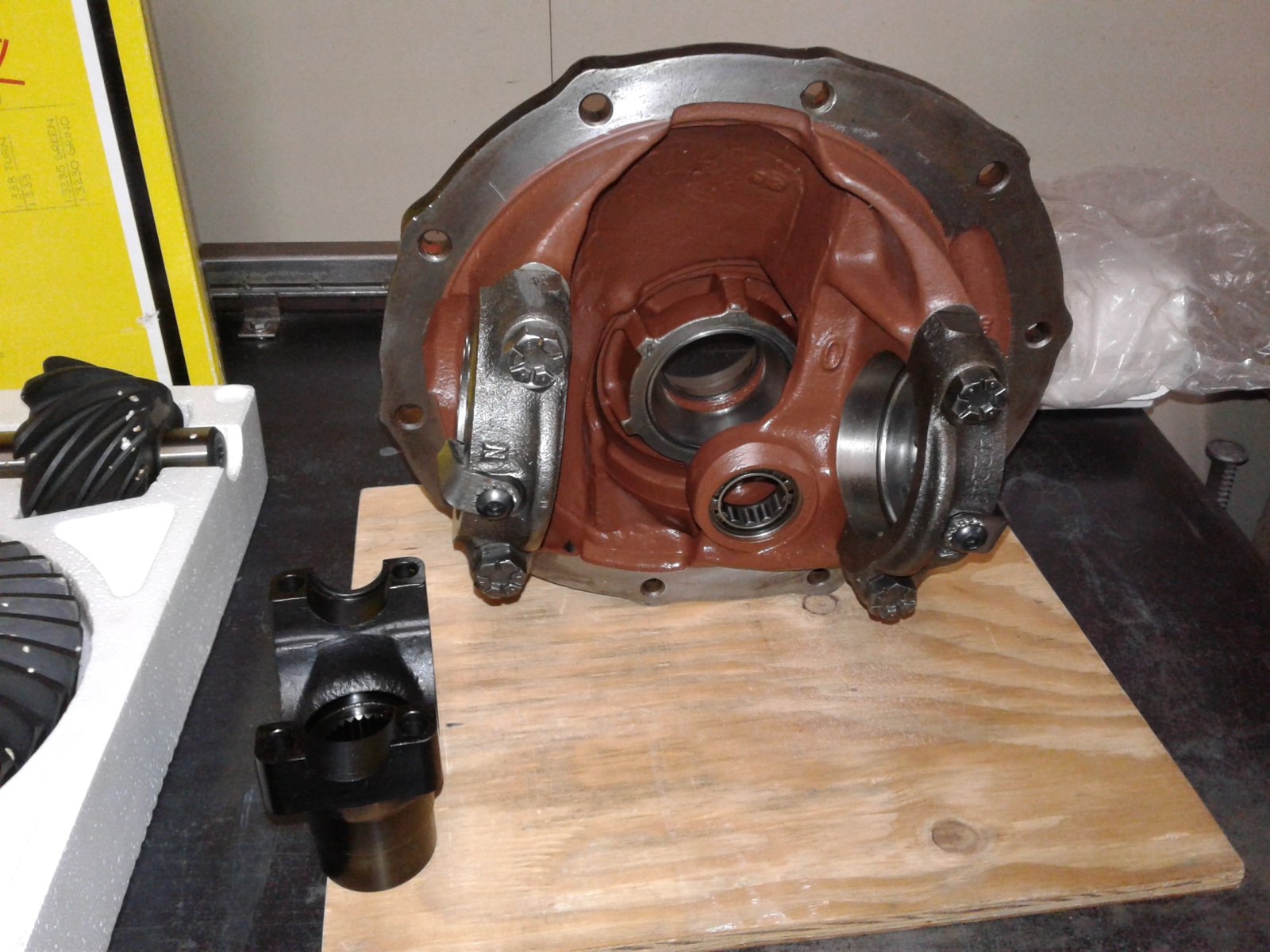

    Here's a few things I've collected to fill the rear axle housing,
    20230216_150552.jpg 3.75:1 Ring and Pinion.
    Factory Nodular Iron Center Section with Daytona Pinion support and a Billet steel yoke. The original Daytona yokes seemed hard to find and were too expensive.
    31 Spline Moser Axles
    Yukon Differential. It's a similar design to the Ford factory traction lock, but better. I debated long and hard about whether to use a Detroit Locker or one of the other designs out there. I didn't like the driving characteristics of them for this application and besides I got a nice deal on this. Now all I need is the bearings.

    I was very impressed with your roll around body cart:) what I really like is it's adjust-ability. On the last two projects I "jury rigged" roll around body carts that worked fine but yours is a step or three better than either of mine:)
    Sharpone, Stogy and alanp561 like this.

    Thanks vtx1800, The rafters were not going to handle any weight and I needed to make it a one man deal. It's a little tricky inserting the cross supports and later removing them but it breaks down and takes up less space. I have to go around and around turning the cranks so it's a bit slow.

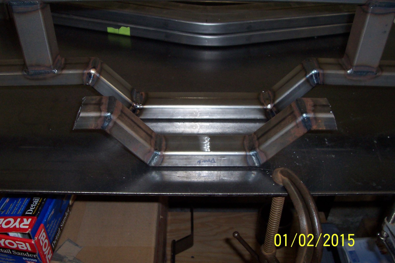

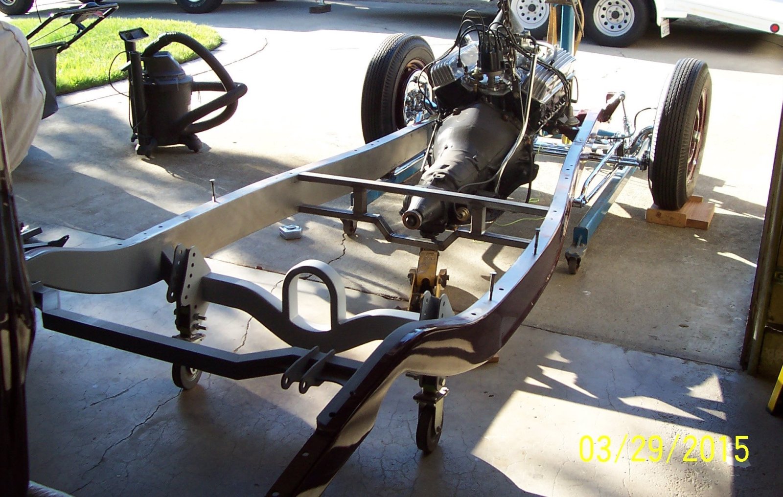

    Options for the new frame center section were rectangular tube, round tube or possibly an original type X member. I settled on a "kit" from Speedway using 1" x 1-1/2" rectangular tubing. So that is the starting point. They have round tube kits but from a fabrication stand point rectangular tube offered more options. Some modifications are needed. Crossmember Mod1.JPG
    Sharpone, deadbeat, Stogy and 7 others like this.

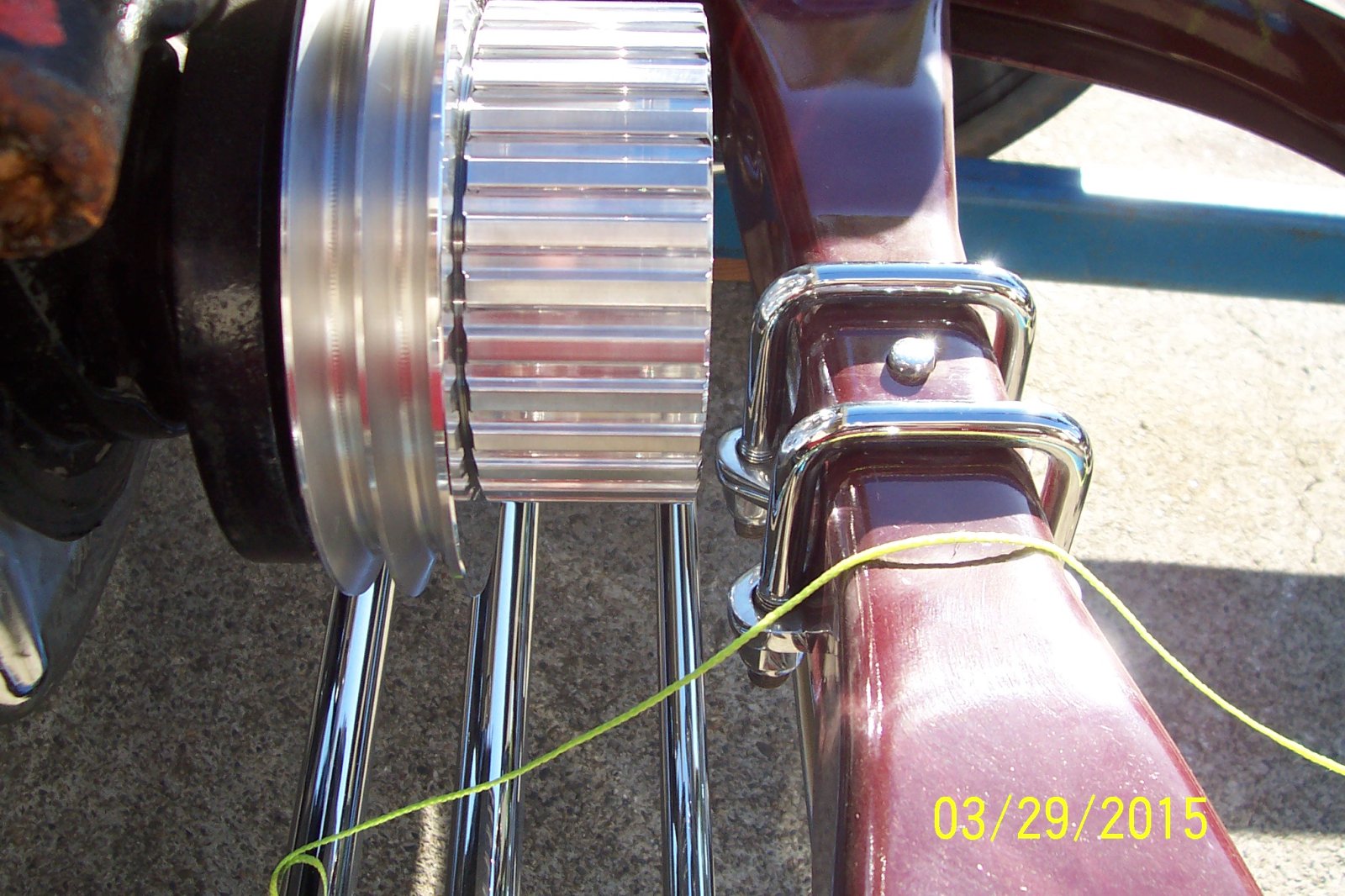

    Rough engine/trans mock up completed. Engine/trans will get lowered a 1/4" and moved 1" rearward for better weight distribution and more clearance for the cooling fan and that funny looking pulley. Motor Rough Mock upe.jpg

    Got rid of that drive shaft loop, Cut and fit some more tubes by hand with a hack saw no less (wish I had a chop saw) and broke out some blue imagineering tape. Tricky fitting as the rails curve inward toward the bottom.

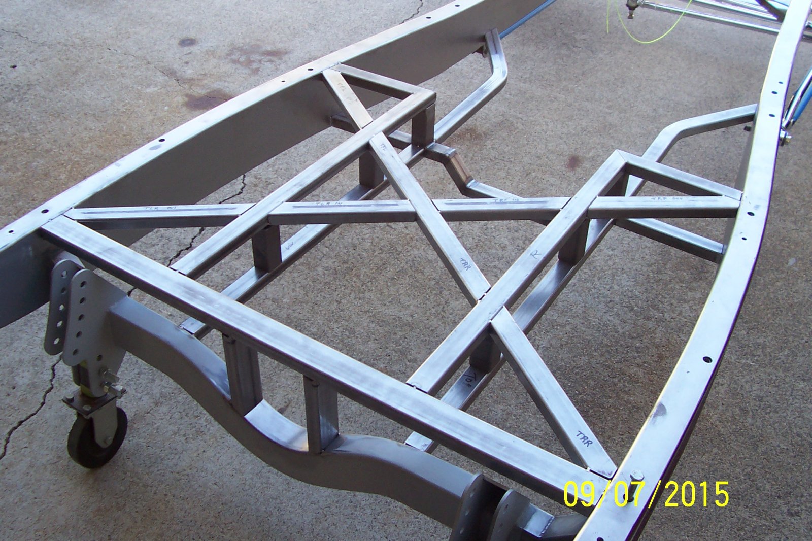

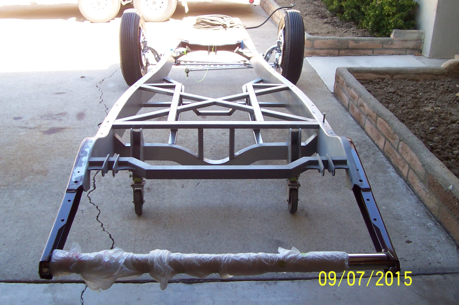

    More tubes and new motor mounts tacked in place. Some tube are intentionally left out for future work. Front Shock mounts deleted.
