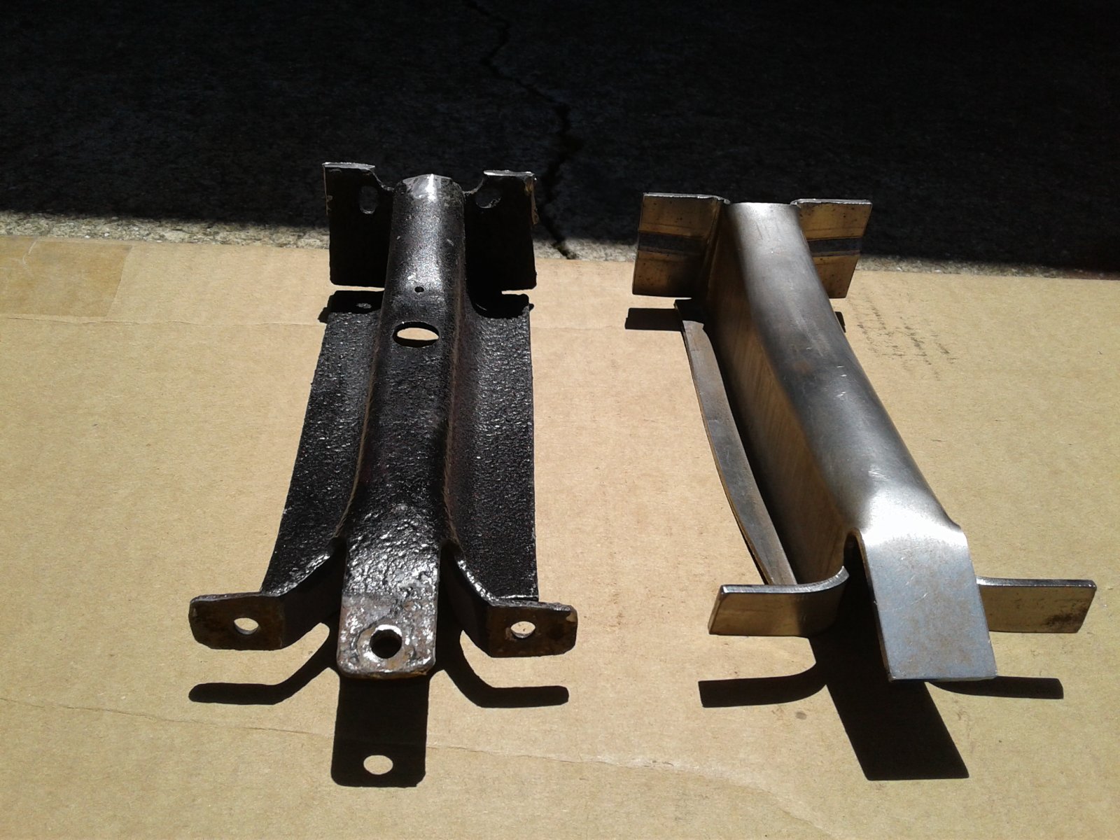

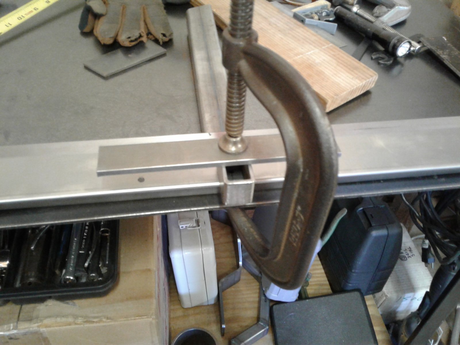

    Rotten Onion update; Sprang for some fresh metal from Brookville which seems to be the better quality stuff around. Fitted new tail panel and heavy rear cross member. But... not every piece comes with the necessary features.
    I had to make some tooling out of some s**** tubing and press the recess feature and drill the hole for the spare tire support bracket as well as the holes for the angle attachment piece.
    Then.... press fit and tacked some nuts in place.
    Then.... Drill for and fit some more Model A style nuts.

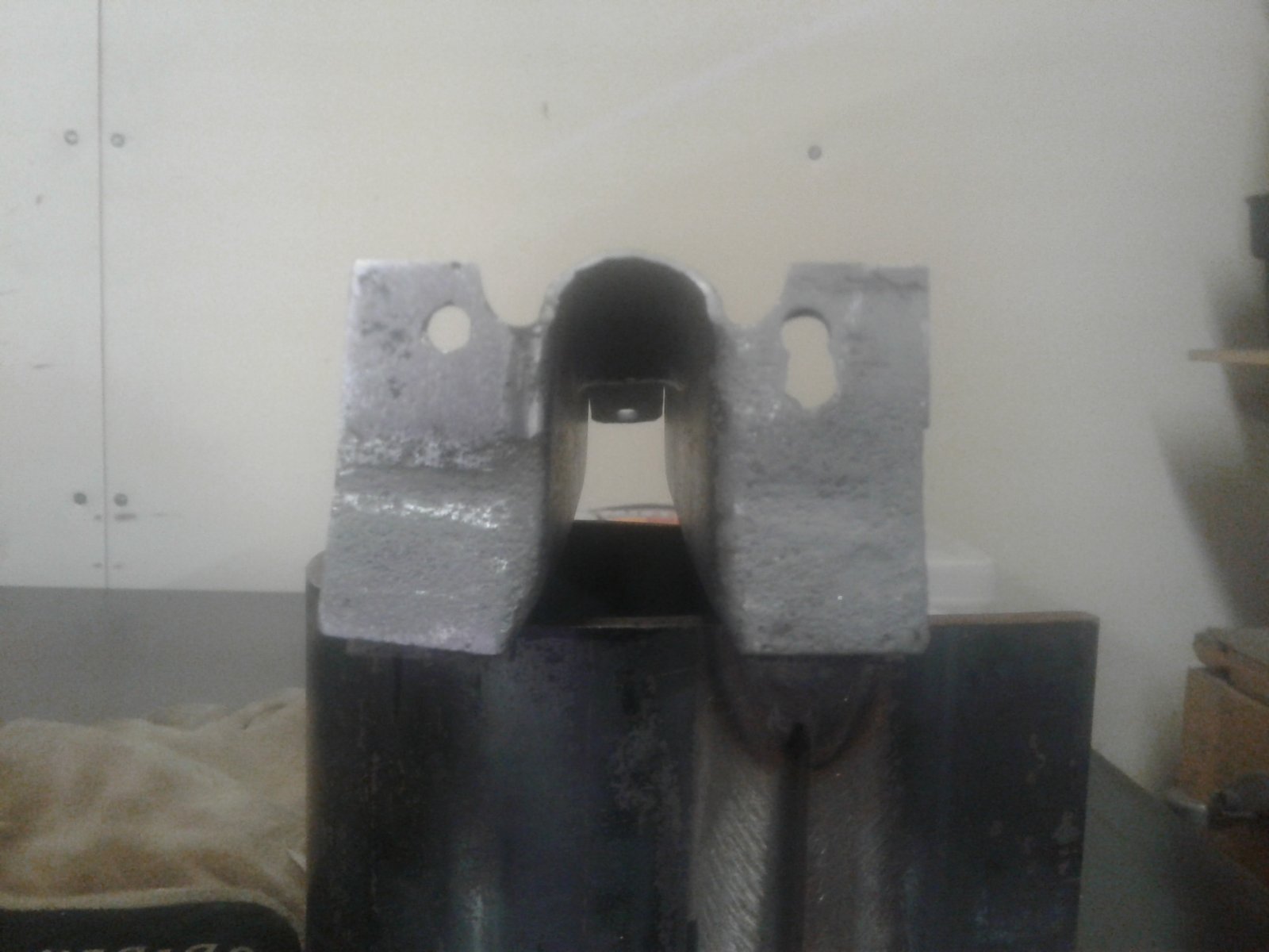

    And of course the re-pop spare tire support bracket (right) don't fit for $hit. Not even close! So I had to restore the original (left) which meant repairing the boogered up holes.
    One hole repaired;

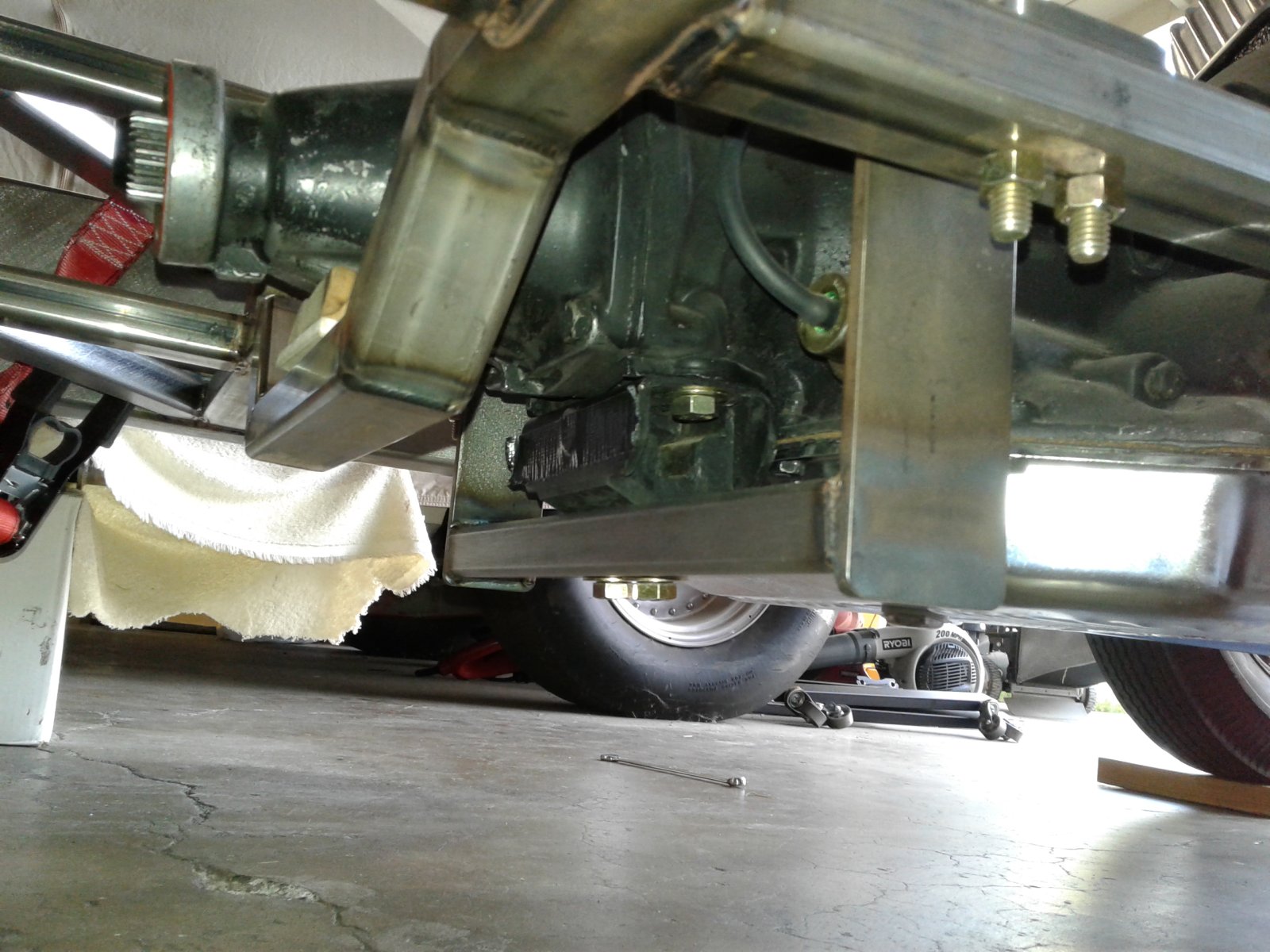

    With the frame set at ride height. Engine angle is set and transmission crossmember fabricated. I need to weld some sleeves in the bolt holes so the tubing doesn't squish. Going to build in some transmission options just in case I want a 4spd or want to run my B&M Turbo Clutch.
