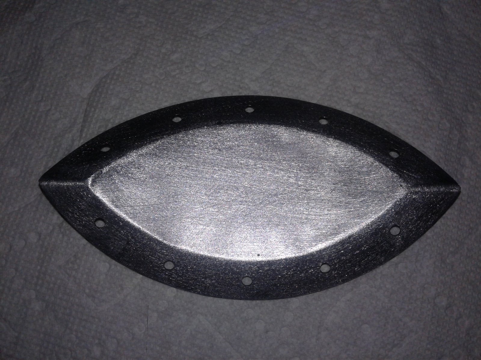

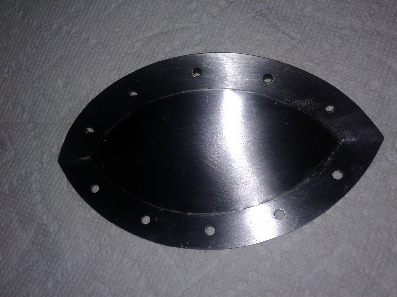

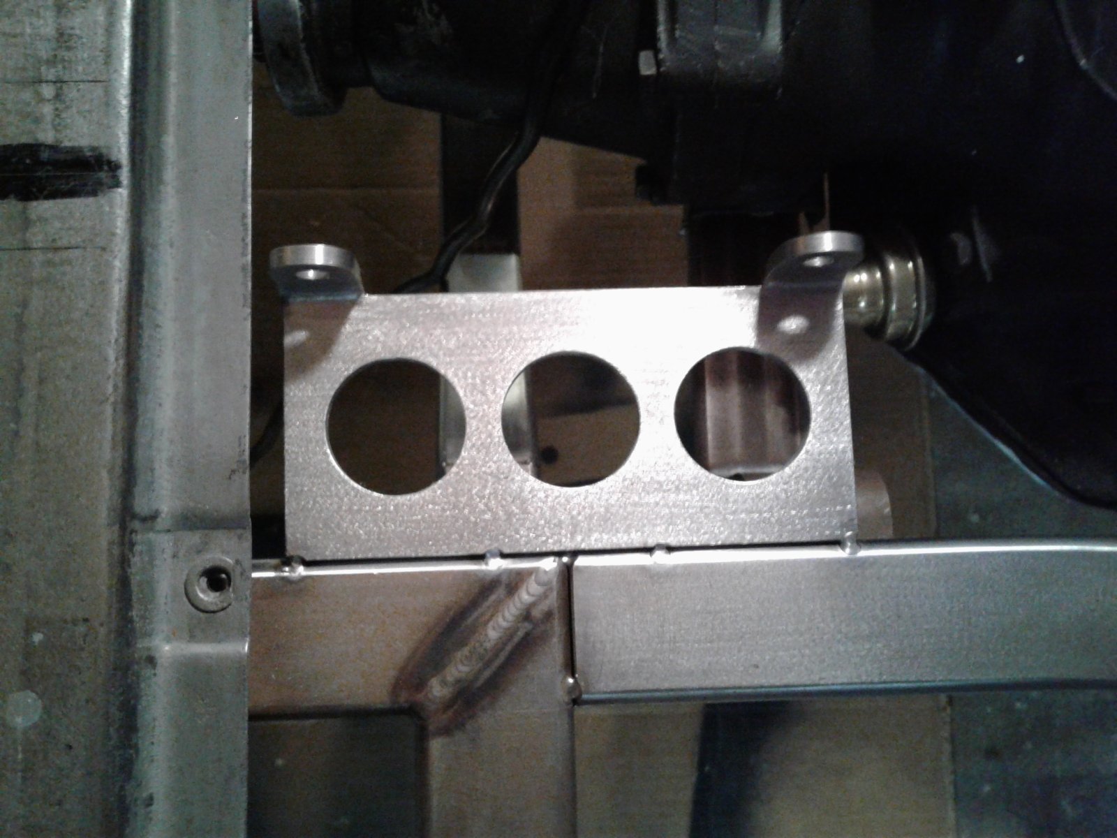

    Floor to transmission clearance was an issue as is over all floor space. Fabricated a small blister which gave me about 1/2". I'm not 100% convinced it's enough, so maybe a larger one is needed.

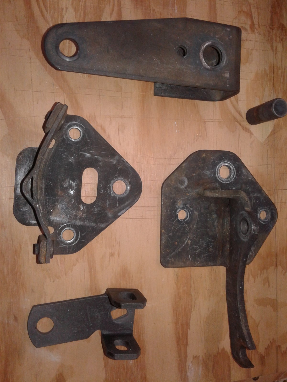

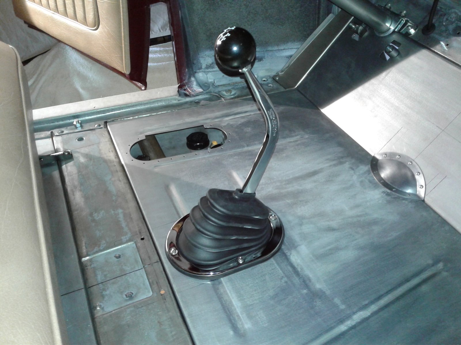

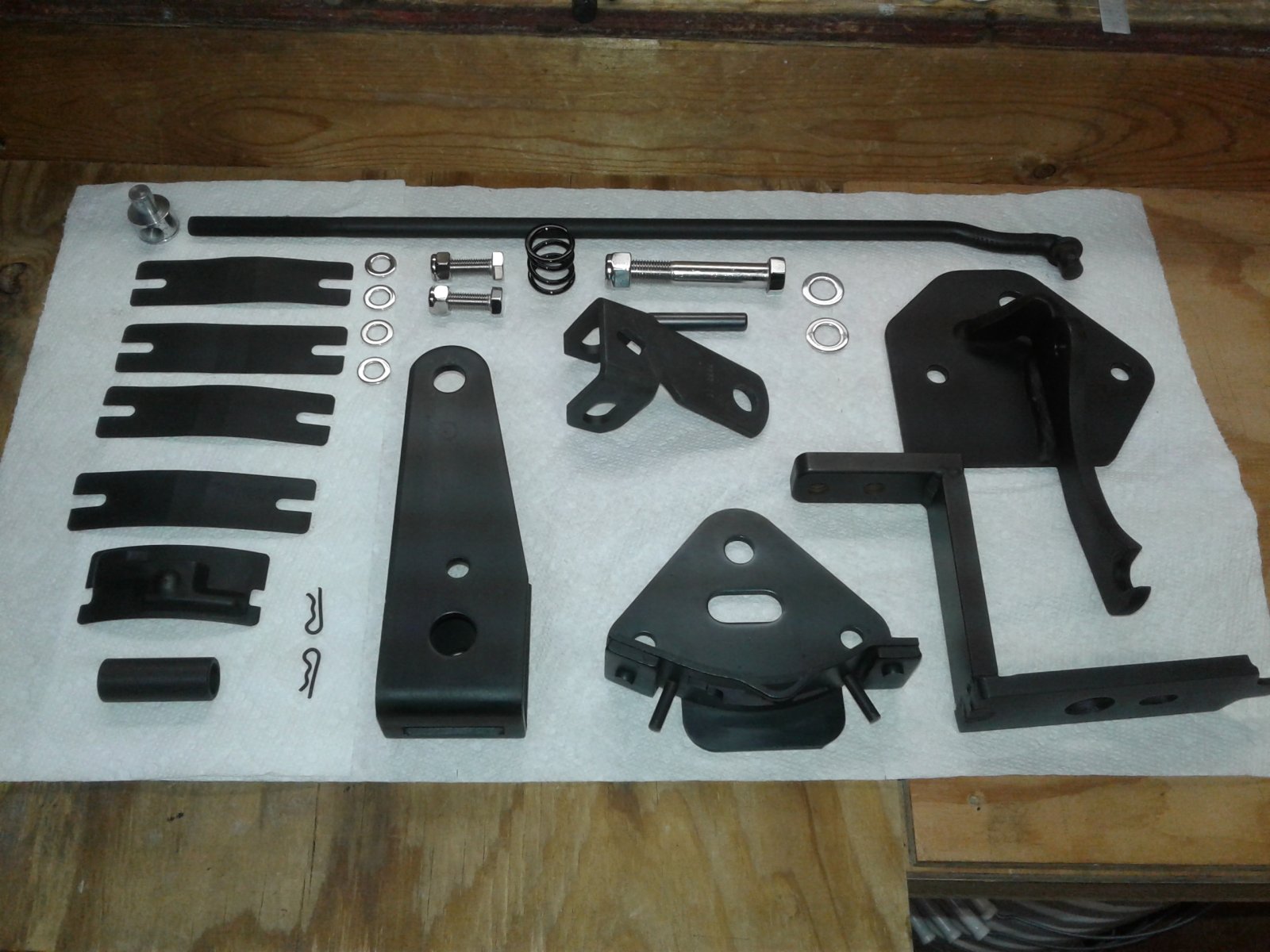

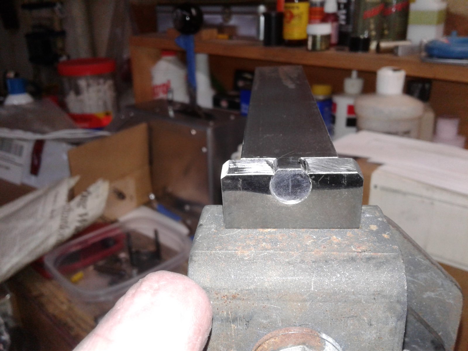

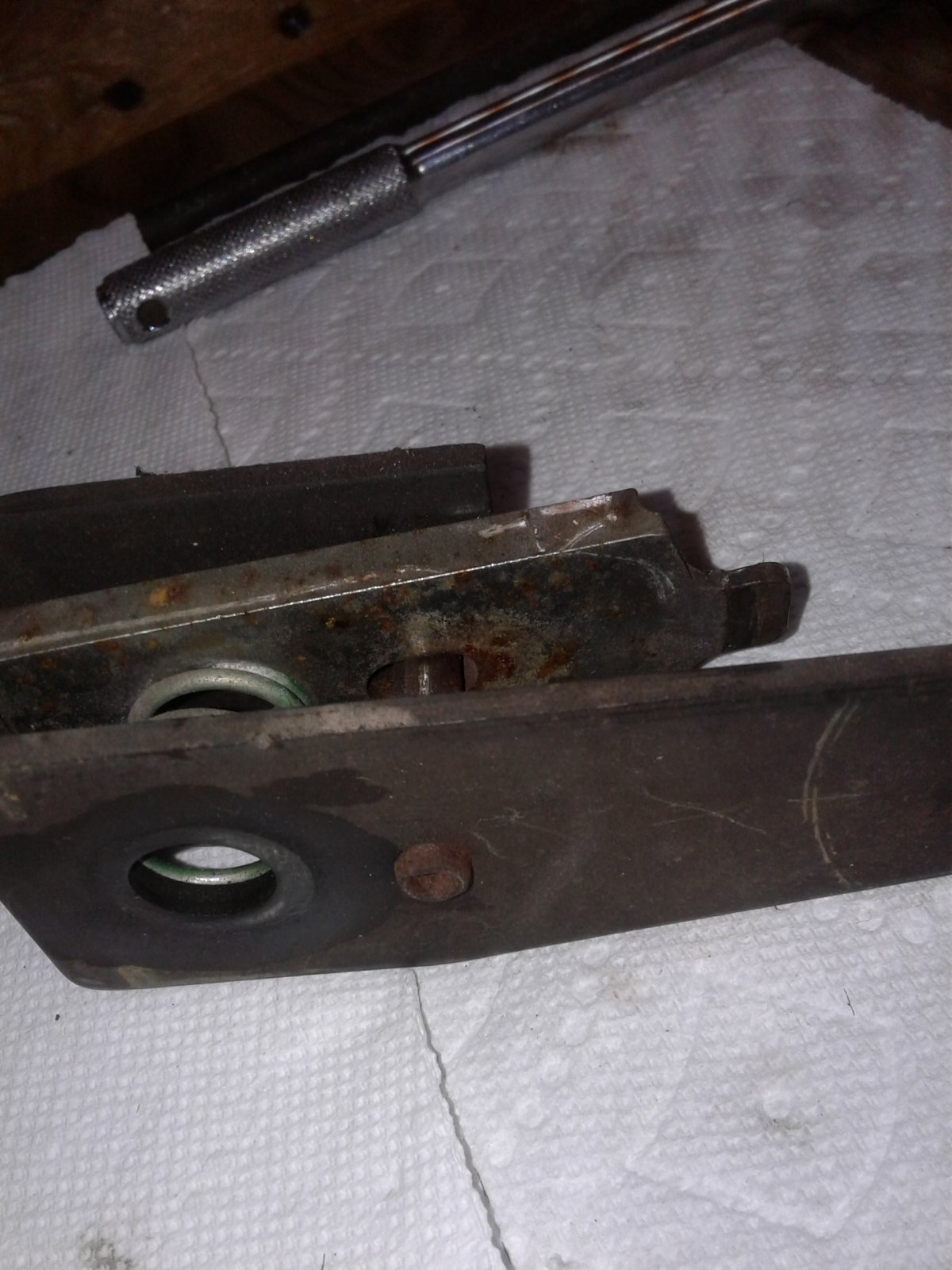

    You would not think installing a shifter would be a big deal. I wanted something that had a period look but, starting off with a TH350 which obviously came later, the choices were pretty limited. I’m not a big fan of what’s on the market today and I’m not ready to sell off the brand new B&M street/strip TH350 w/Hole shot converter that I practically stole (1/2$) in favor of a 4 speed just yet.
    Luckily, is was able to buy a Hurst Auto Stick 1 from a fellow H.A.M.B. member. Unfortunately the shift lever would come through the floor right under your leg so in order to make this work in the Model A some modifications as well as some restoration work had to be done.:eek:

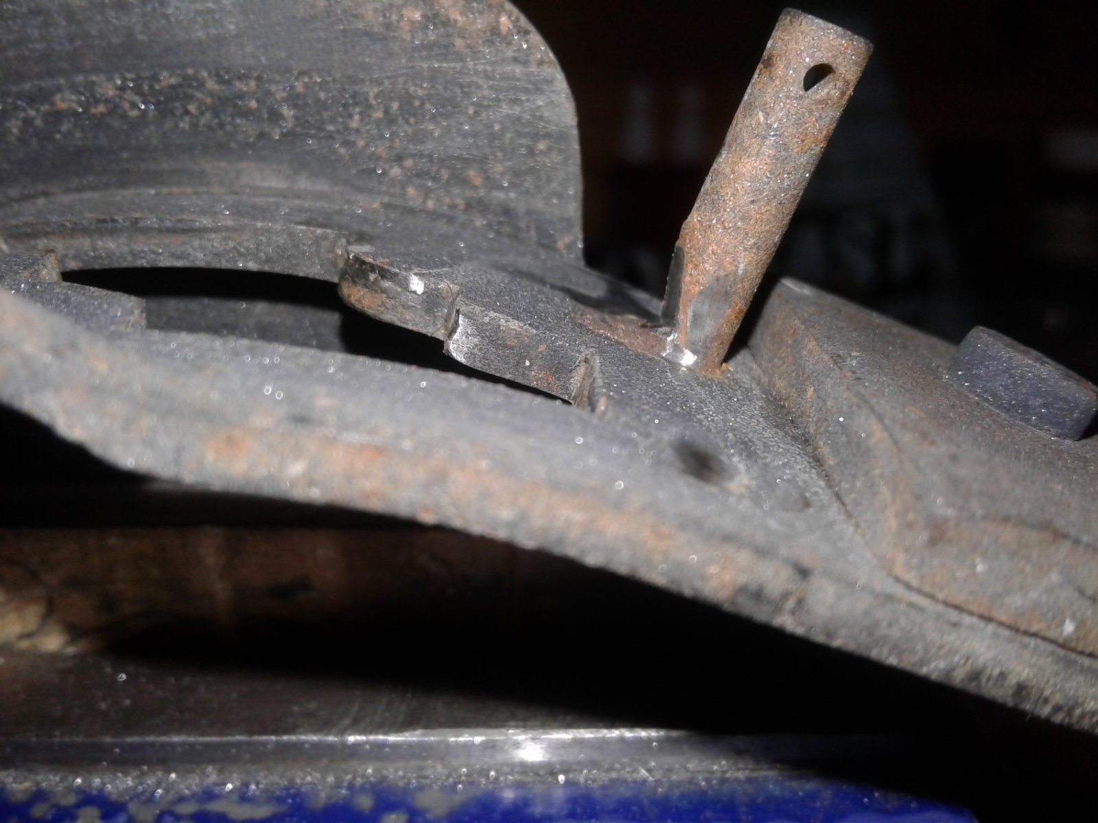

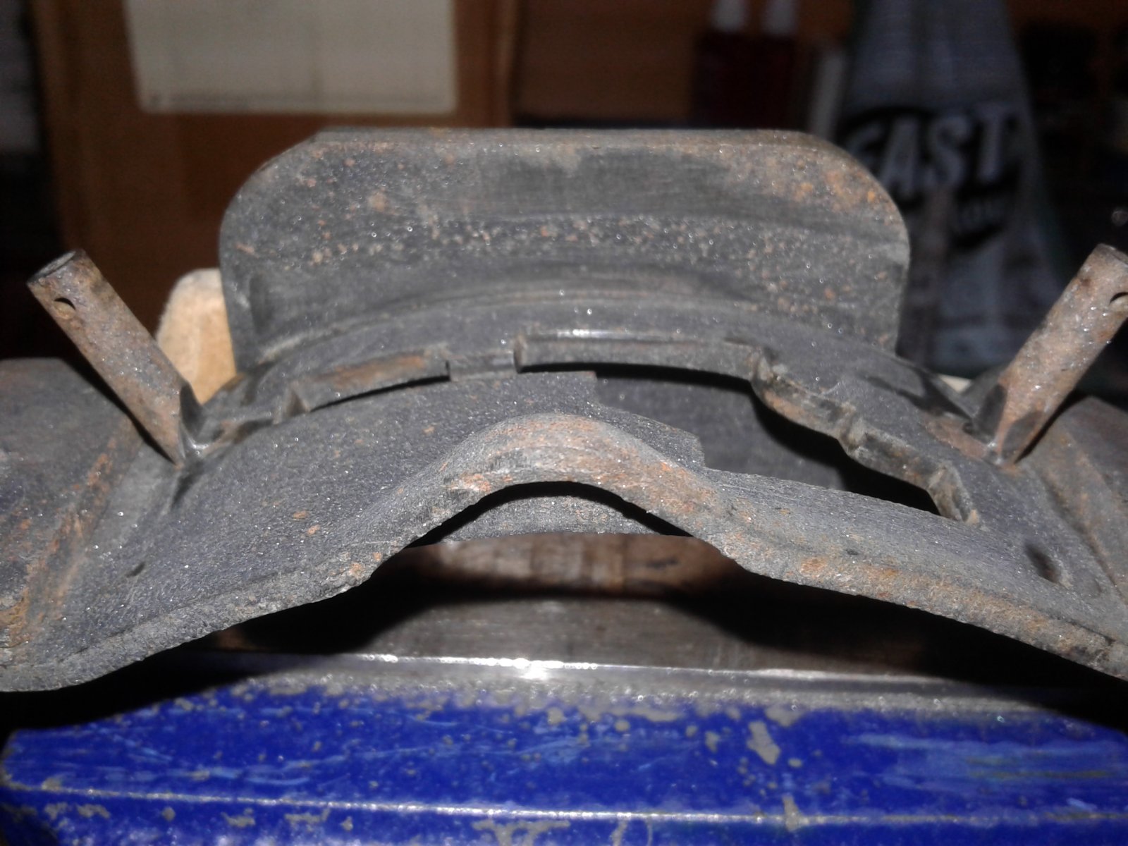

    Here you can see the pins that retain the grease cup and leaf springs have some pretty bad notches worn in them;

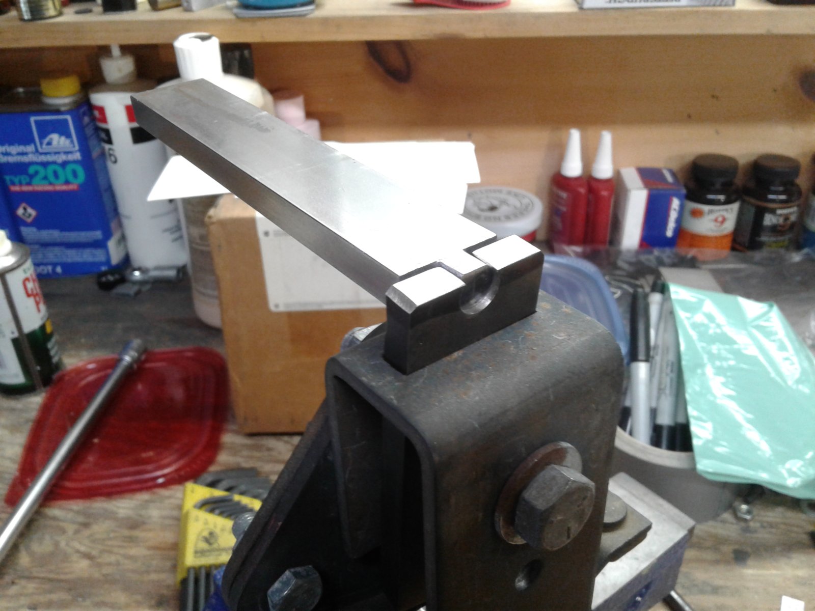

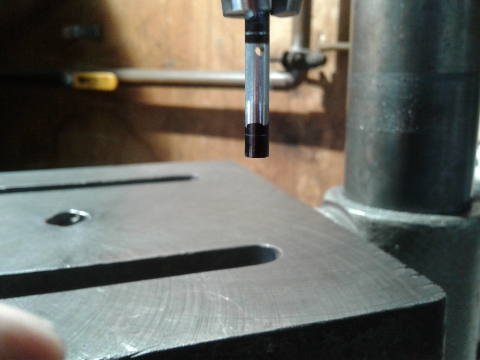

    Using my trusty drill press I whittled down some 3/16" clevis pins into new parts;
    The welded on chrome lever had to be chopped off as short as possible to clear the floor underneath. The chrome plating on what was left had to be sand blasted off. The idea here is to offset the shift lever to the center of the floor. Of course there's a hole right at the cut line but I was able to file a lug onto a piece of bar stock that fit the hole. This would strengthen the weld joint.
    After mocking this up and finding the length at the center of the floor I made another piece that would allow a typical bolt on Hurst lever. Here is the finished part welded and blasted;
    All parts were blasted and the new pins were pressed and peened into place.
    All parts were then gun blued and sealed. The coil spring was painted and, the bolts were replaced with stainless steel fasteners that I just had to polish:rolleyes:
    Final ***embly;
    The shift rod bushing on the shifter just barely hit the frame cross member when in park position so that dropped section of the frame had to be cut back out and new pieces made to give more clearance. BIG PAIN:mad:
    These shifters originally came with the Hurst "Super Boot" which is way too large for this car. I tried a Hurst B4 boot but that didn't have enough flex for the Auto stick, so I found this boot used in 66-76 Mopar A bodies and it works perfectly:D
    dwollam, winduptoy, deadbeat and 14 others like this.

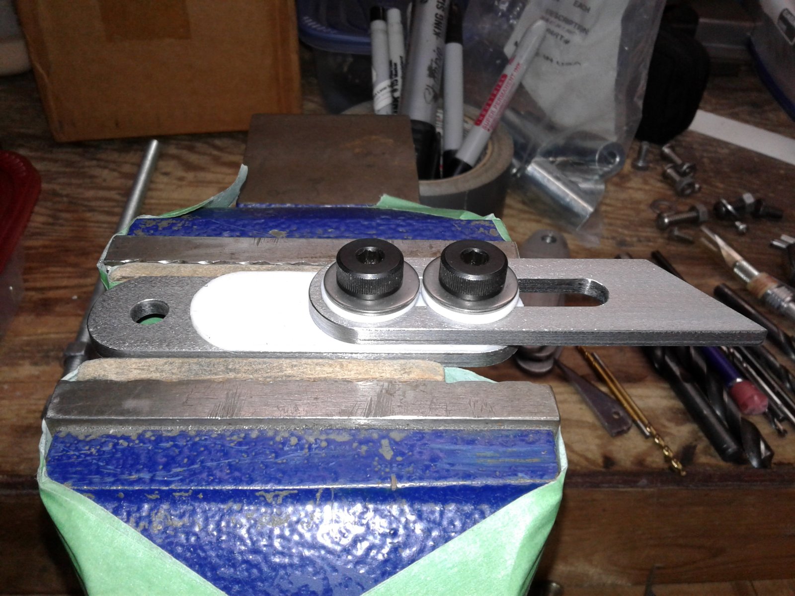

    Waiting on some fuel system parts so, I'll bore you with another update;

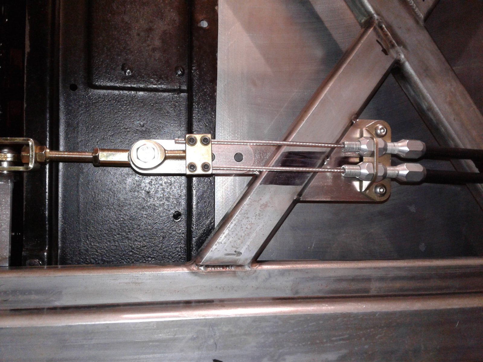

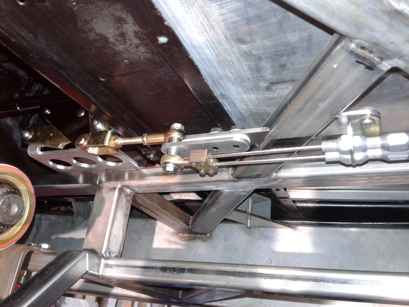

    So, my car came with one of these expensive 1-800, I would say “street rod” type parking brake levers and cables. I wanted to put a chrome plated Model A lever in there but, I could really use the money elsewhere, and since I had it, I used it. It's pretty well made and hopefully won’t be too much of an eye sore.
    Most of these things just get mounted to the sheet metal floor which never made sense in terms of strength so, I made a 3/16" thick bracket and will mount it to the frame.
    Mounting to either the floor or the frame was still a problem trying to get the cables lined up. I needed to find away around the “X” part of the frame. Couldn’t raise or lower the handle so, I sort of invented a sliding bracket using some 1/16” Teflon sheet, some 3/16” steel, a couple shoulder bolts and, a couple rod ends. Hopefully this does the trick.
    Hell, it's look 'n kinda ***y next to that Auto stick.

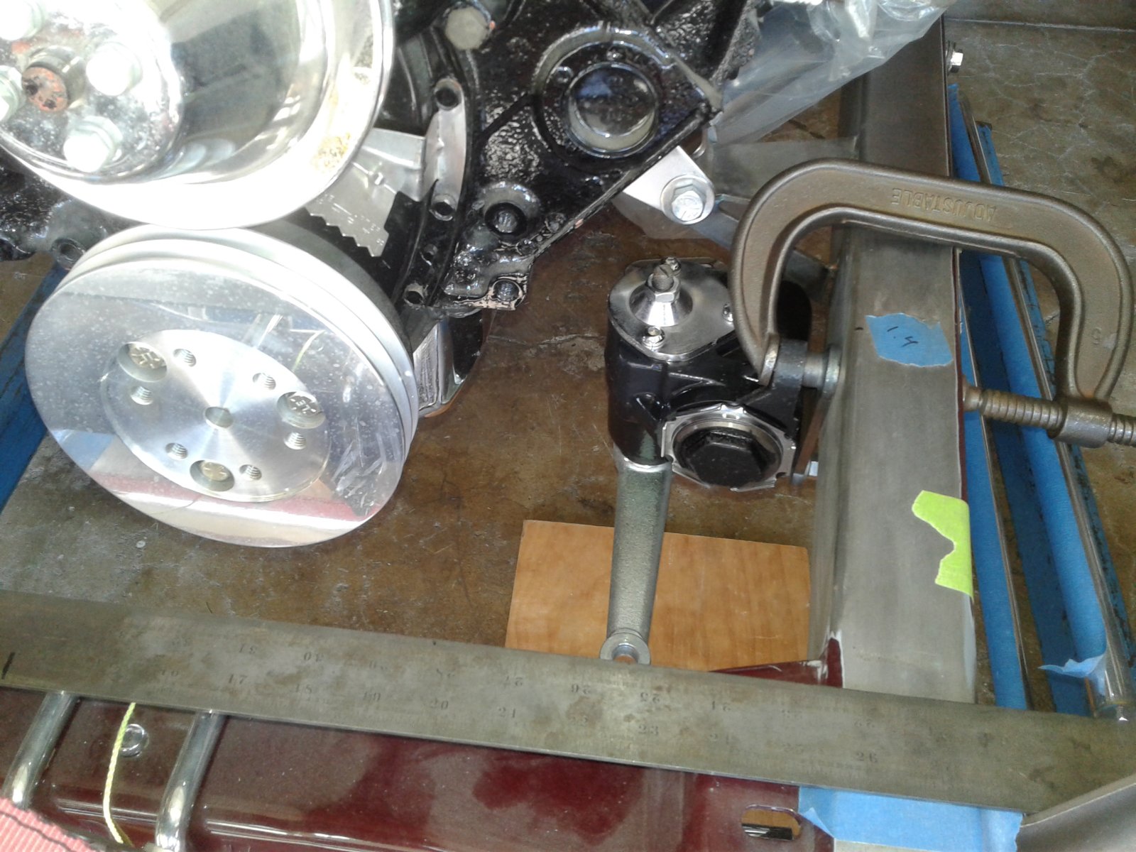

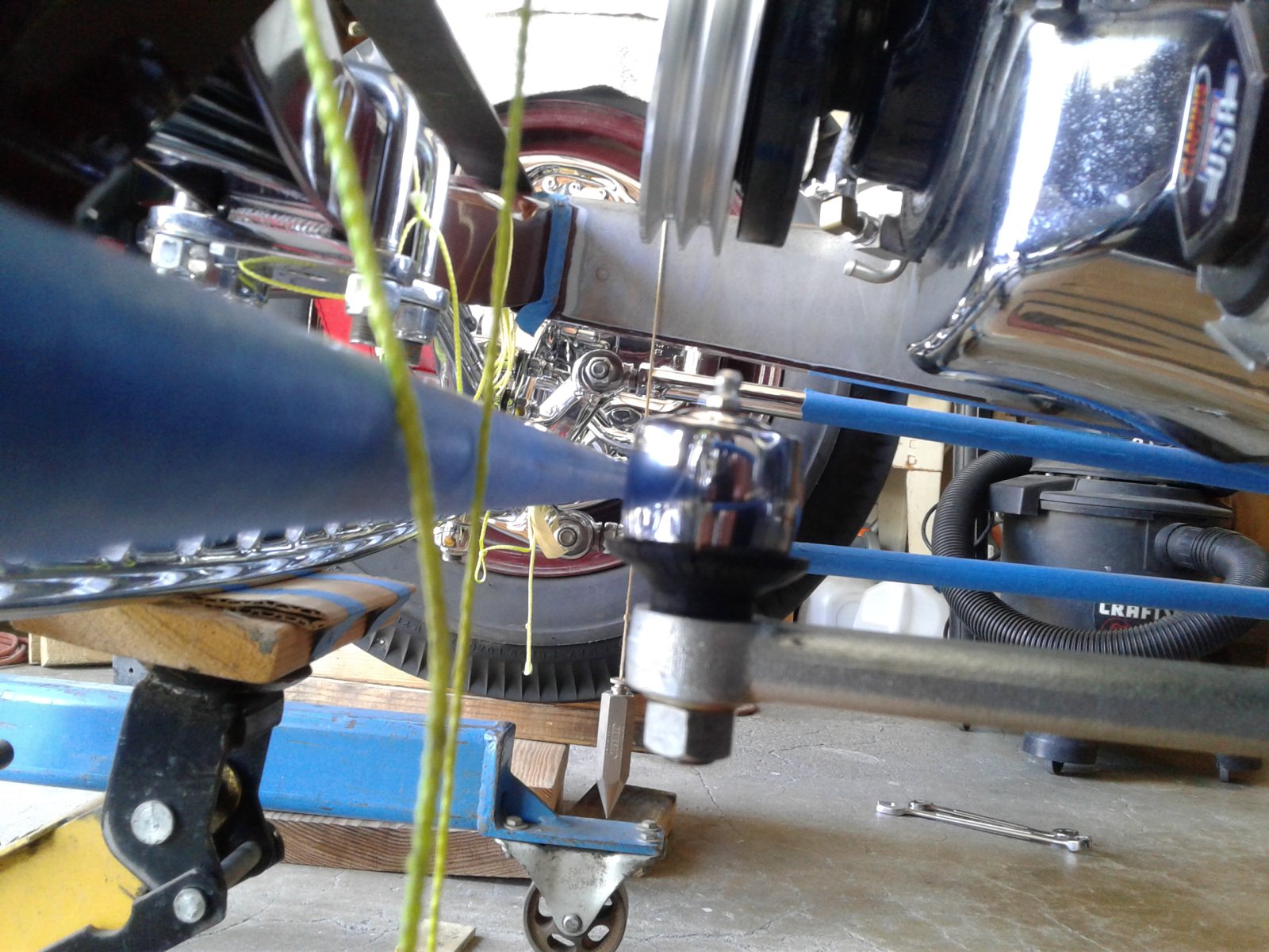

    Mocked up the steering box mount with most, but not all the weight on the front suspension. My thought on this set up is to get the drag link parallel to the tie rod in both height and plan view. I’m thinking this should minimize bump steer in both bump and rebound. Ideally, I would have all the weight in the car but it’s not practical to ***emble the entire car with every piece including fluids to get the box mount perfect. I may have to make an adjustment to the pitman arm after the car is finished.
    There’s always going to be some bump steer. The question is, do you build in a bias and minimize it under braking, under acceleration, or split the difference?

  17. X38
    Joined: Feb 27, 2005
    Posts: 17,498
    X38
    I always set things like this without a full spring pack, to compensate for lack of weight. Just the main leaf if on a bare frame. I guess that's an experience thing.
    But it looks pretty good and your desire for parallel in both planes at ride height is correct.
    My one concern is the steering box. I fear it is an aftermarket but non Borgeson one. That will be your biggest operational issue. I'm sure you've seen the recent/current thread on the subject.
    bchctybob likes this.
  18. tomcat11
    Joined: Mar 31, 2010
    Posts: 1,148
    tomcat11
    Thanks pprather. Yep, I think it will be fine.
    Seems even setting it up without a full spring pack is still only going to get you in the ball park. Yes I've seen the feedback on the various Vega boxes. The box in the picture I believe is a cheepo Speedway box that came with the car. I just used it for mock up. I got a great deal on a 16:1 quick ratio box from Flaming River but have heard mixed reviews on them too. If it goes south I'll buy a Borgeson.
    I really appreciate your input. Thanks again, Tom
    winduptoy, deadbeat and treb11 like this.

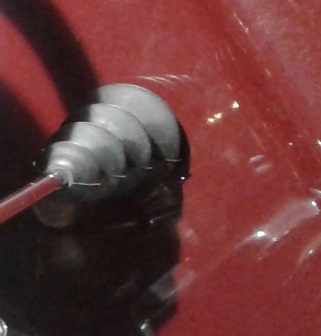

    After some careful measuring I cut a 1" hole in the firewall. The reproduction rubber boot is for a M38 Army Jeep and is slightly modified.

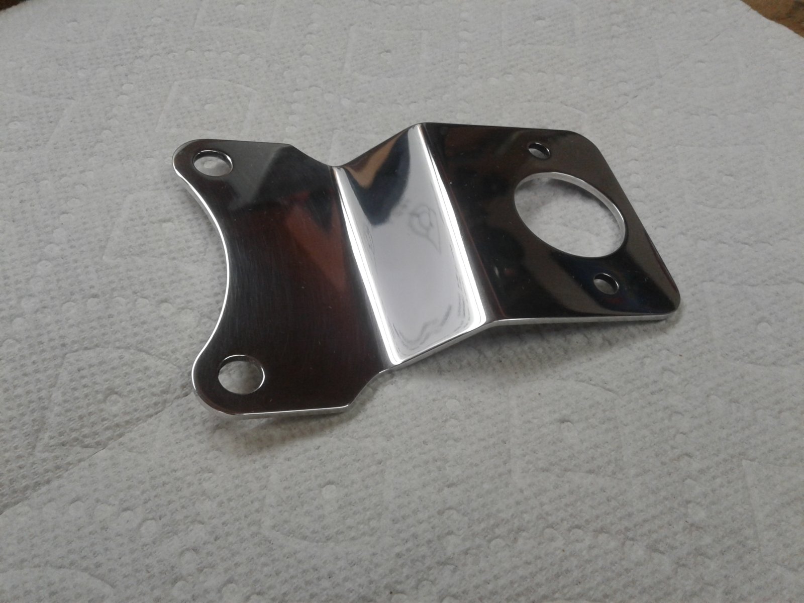

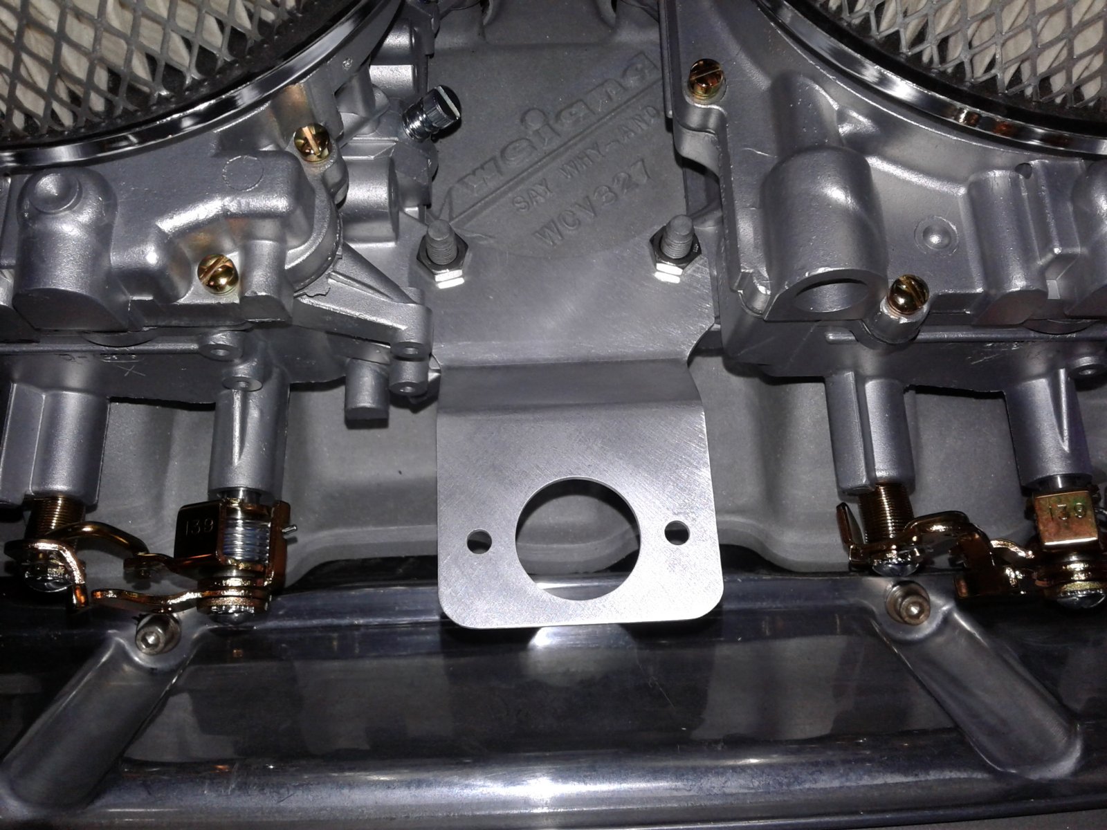

    Fabricated this bracket from .090" Aluminum to mount the fuel pressure regulator.
    Here's the bracket after some polishing.

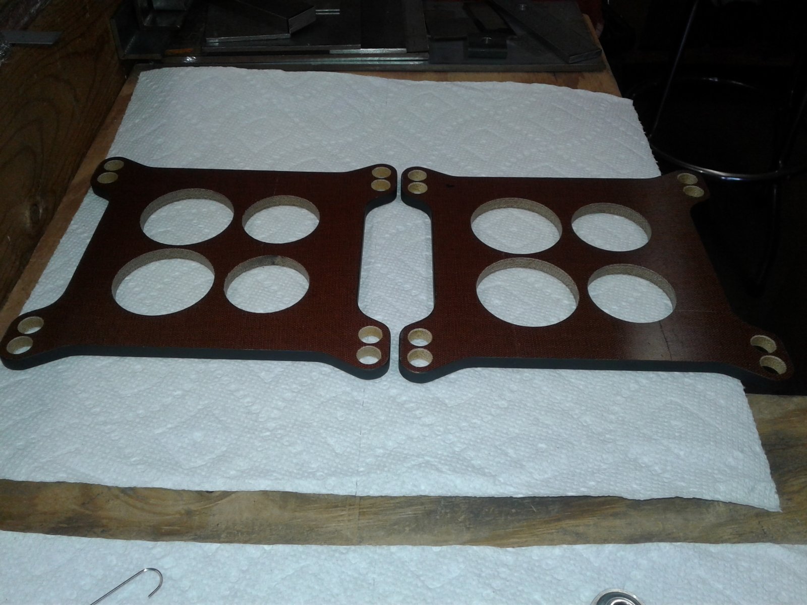

    The extended kick down stud now hit on the intake manifold runner. I bought two 1/4" thick Phenolic carb spacers which fixed that problem and will help insulate the carbs. Phenolic is kinda ugly so, I masked them off and shot the edges with flat black Rustoleum.

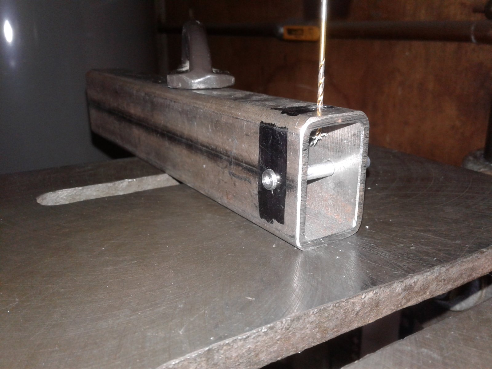

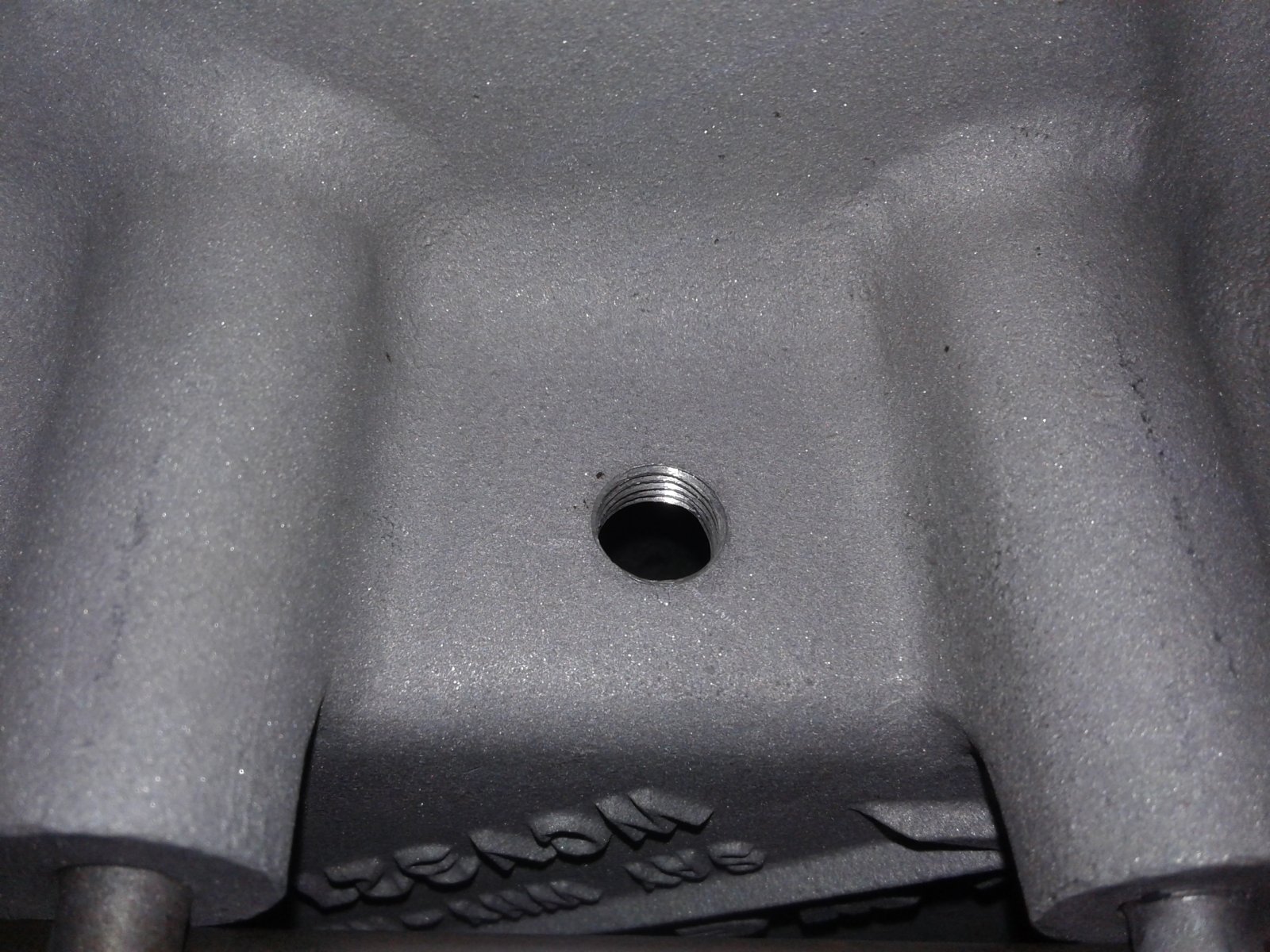

    Forgot I needed a vacuum port for the TH350 Modulator. These carbs have no vacuum ports anywhere. Drilled and tapped the intake for 1/8" NPT. This will hide under the fuel regulator bracket. Some how I missed the centerline by .030" or so, oh well:oops:
    Borescoped to check for burrs and depth.
