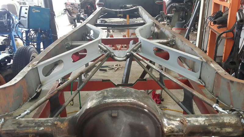

    Had a couple buddies come over today and we tinkered on the car....and consumed burgers & beer! ;) I had to pull everything out of the garage just so we could work around the frame table. Fortunately, it's a pretty fast and easy process.
    First up, I wanted to put some primer on the inside of the rails and on the inside of the boxing plates. This is to help prevent any rust after the ch***is is fully welded. After we sanded them down to knock off any surface rust, we sprayed some weld-thru primer I picked up from Summit. Seemed to work well!
    We got the middle and rear boxing plates tack welded into place. They're inset about 3/16". We also got the front cross member tacked in. Shooting for a 107" wheelbase to help fit the SBC without too much hacking of the firewall. I don't want to stretch the wheelbase more than 1" beyond stock. I'm not a fan of a stretched wheelbase on hot rods.
    Next up is to weld in the front cross member as much as I can (access is limited), then I'll trim up and fit the front boxing plates and fully weld in all of the boxing plates. After that, I think I'll mock up the rear axle and ladder bars/cross member. Who knows, maybe I'll have a roller one of these days....

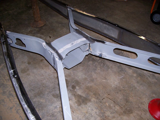

    I'm researching cross members. I'm trying to decide between a tubular design like Speedway sells:
    Or something like Ch***is Engineering's more conventionally styled crossmember (image highjacked from Bib Overalls):
    http://www.ch***isengineeringinc.com/page44.html
    I'm still up in the air about my pedal setup, other than I plan on original style, bottom hinged brake/clutch with the masters under the floor. Here's the deal... I don't have pedals yet, but I want to install the X member. I'm concerned about installing the X member only to find out the pedal ***embly is in a bad spot. Should I really just wait 'til I get the pedal ***embly and fit the body to the car before deciding where the X member should go or is it easy to adjust pedal positions later on?

    alot of things come into play at this stage. mine was easy because i used a 40 merc center x which made bolting my pedals and flathead trani super easy. it was just a matter of lining everything up per the engine in relation to the engine bay, and double check the pedals were in correct placement.
    i think the old x members and the ch***is engineering are the way to go.

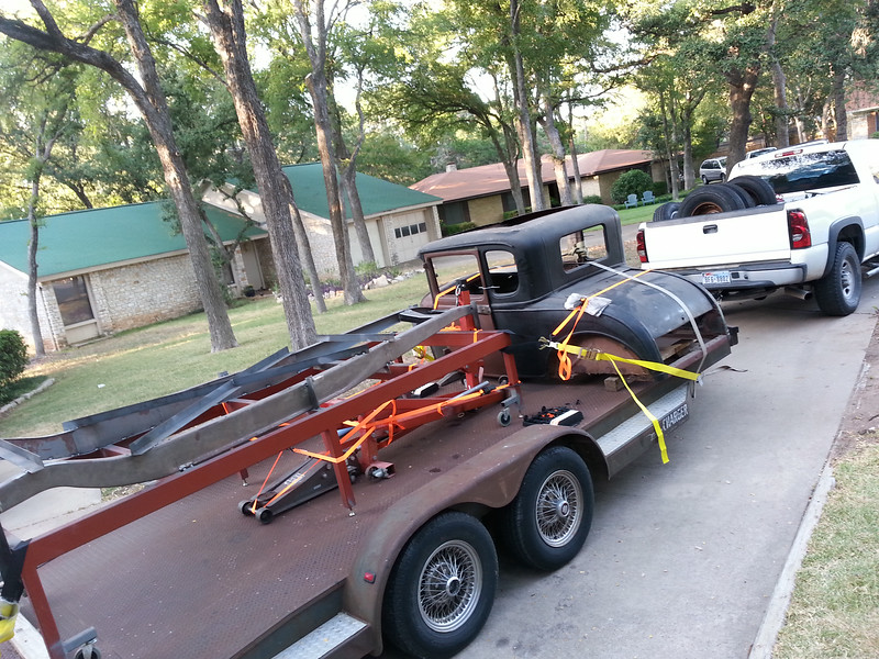

    Yesterday, Gary came down to Austin and we loaded up ALL of my hot rod parts....even the frame table. It's now halfway to Dallas and in the next few weeks Gary's going to start working on it. I told him I'm in no rush so I wouldn't expect a quick wave of updates. But unlike so many other times when I've said this in the past, updates WILL be coming this time. So please feel free to stay tuned if you're still subscribed to this build thread. No, this project is not dead. It's not forgotten. It's finally about to get a spark of life injected into it. And I'm very excited about it!
    For the first time in the 4 years I've owned the A, it's out of my garage. Sure does feel awfully empty in there right now!

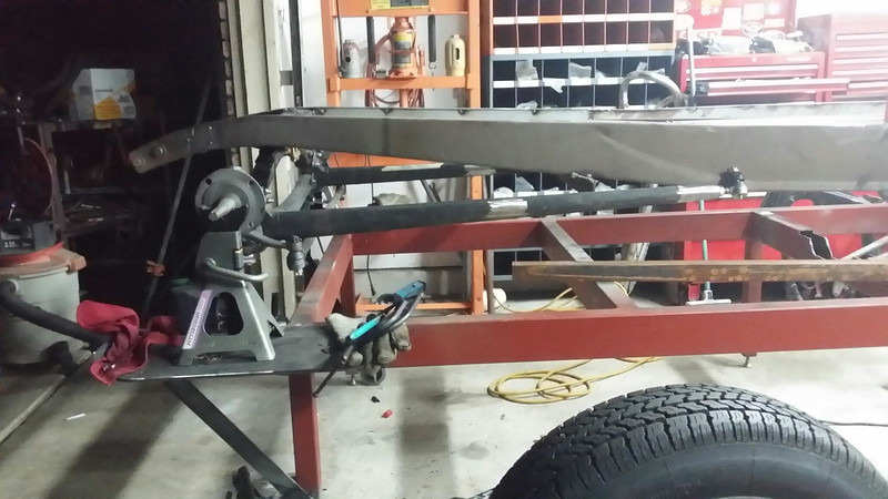

    Here's the Hurst style motor cradle. The white outer mounts were Gary's suggestion and I like 'em. And if you look on the left you'll see the newly completed split bones stood up next to the tie rod.
    And here's a little pic of the ch***is coming together. Center cross member tacked. Woo! :)
    I'm trying to not get ahead of myself here. I realize that even after I get the car back from Gary that there will still be TONS of work left to do. But in the back of my mind all I can think of is....."Is there any way I could get this thing running by the Round Up next year?" :eek: Don't get me wrong, I know how much work is involved in making that happen. But maybe.....just maybe....it's do-able?

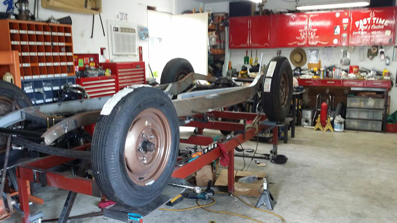

    The ch***is is coming along!!

    Got some more updates from Gary! :D
    UH OH!!! ;)
